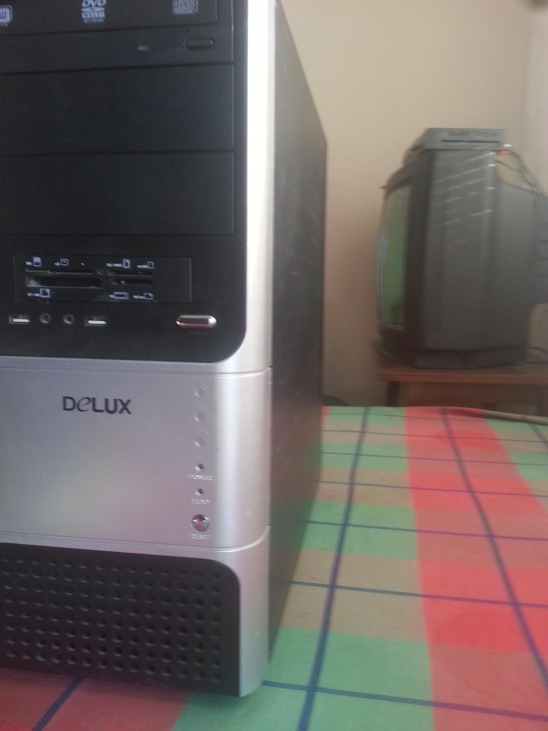

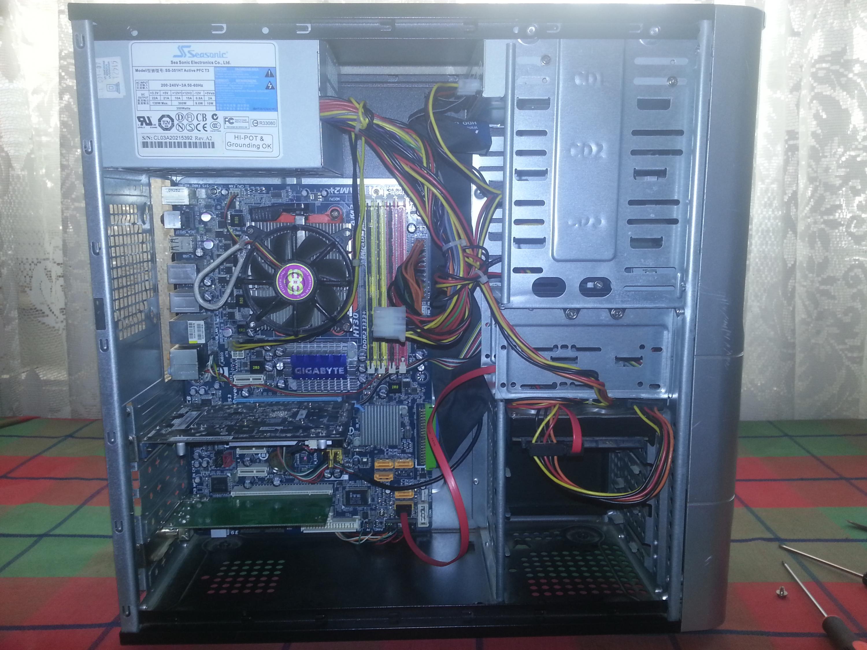

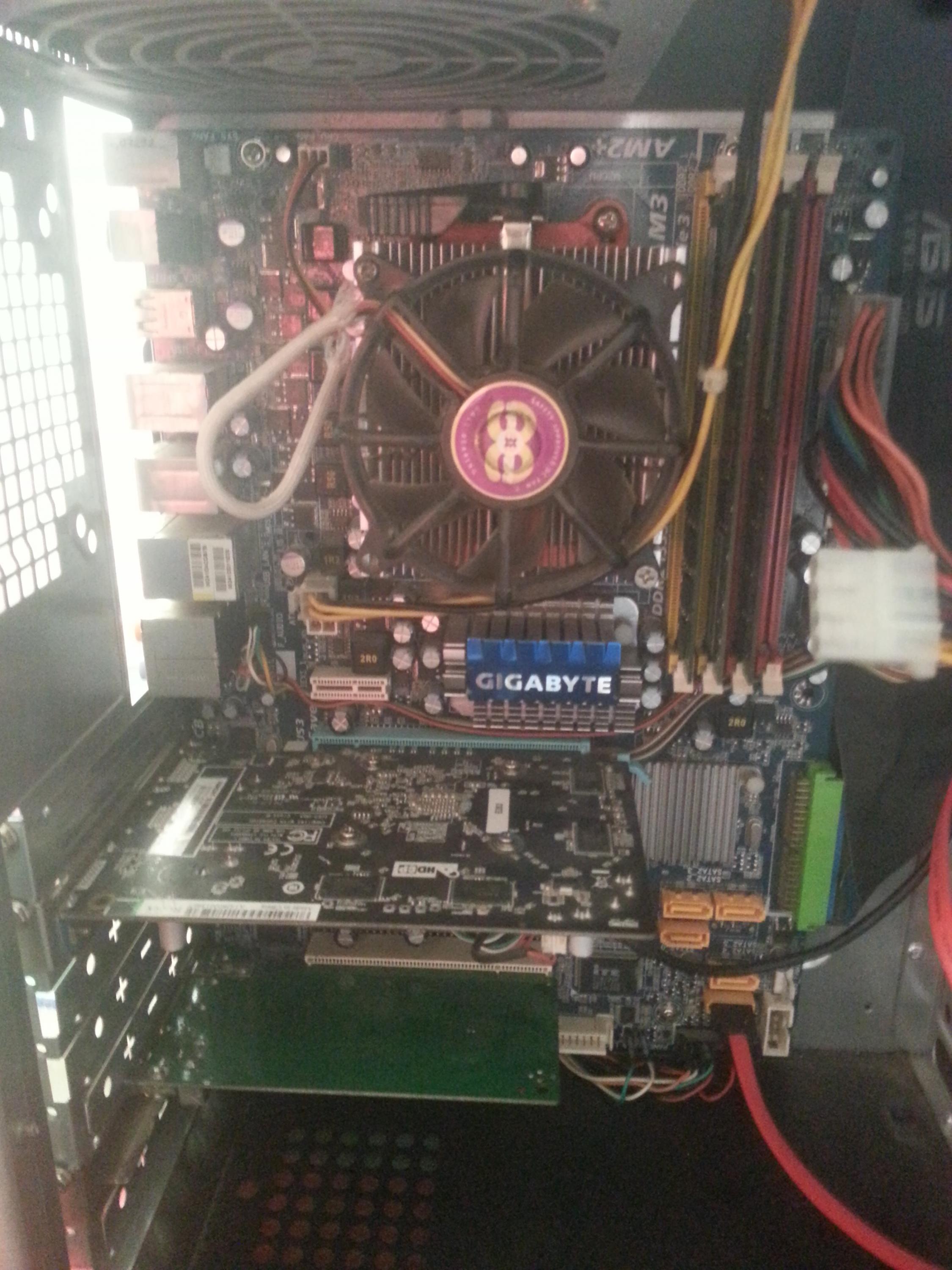

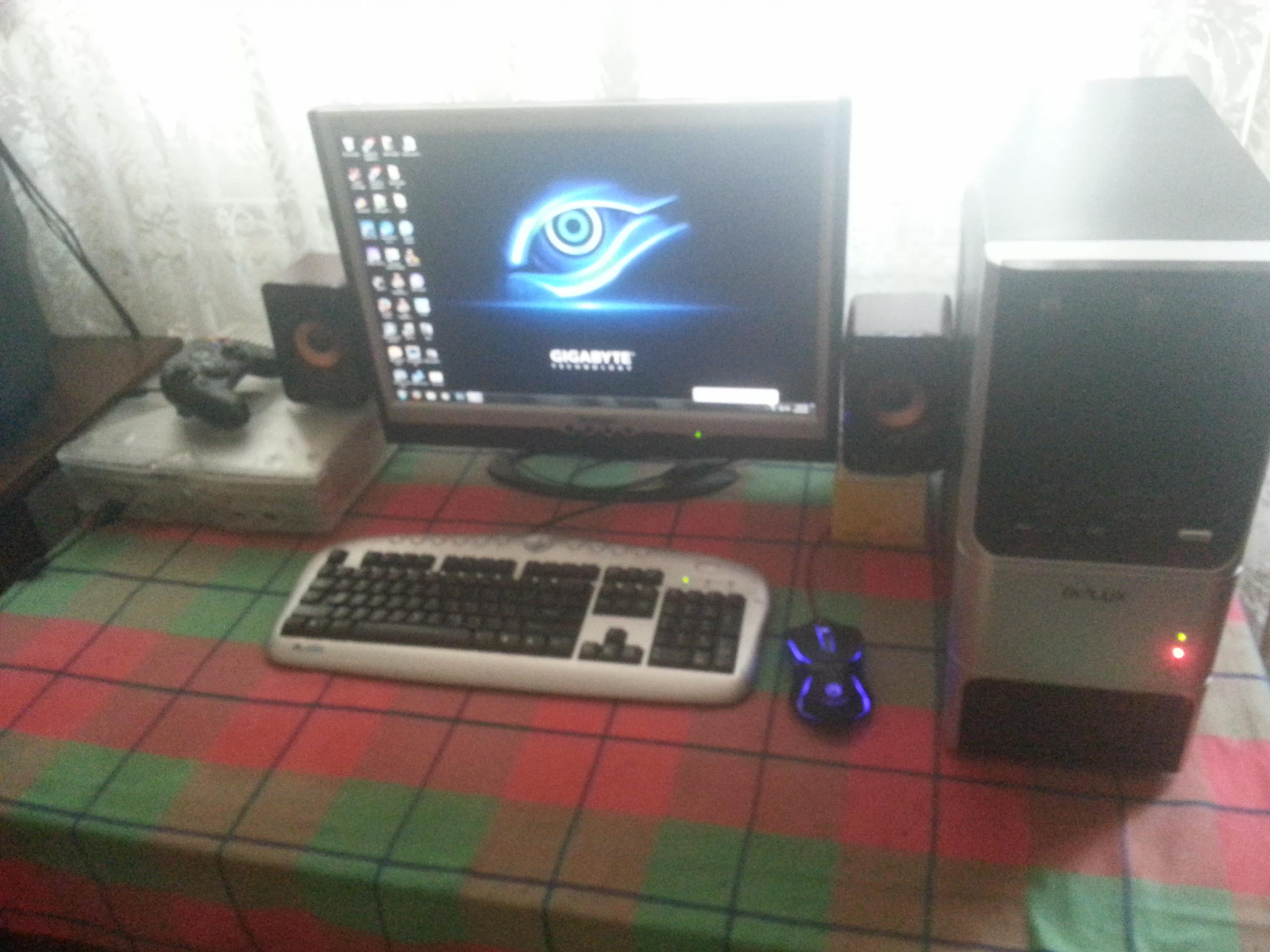

I finally took the plunge and upgraded:
Gigabyte GA-MA770-US3
AMD Athlon II X4 620 2.6GHz
4GB RAM
Windows 7 Ultimate SP1
Delux MT375 case
1x Lite-On DVD-RW drive
Radeon R7 240 2GB PCI-E
AVerMedia AVerTV M733A TV Tuner (PCI, Phillips based)
1TB Samsung HD103SI

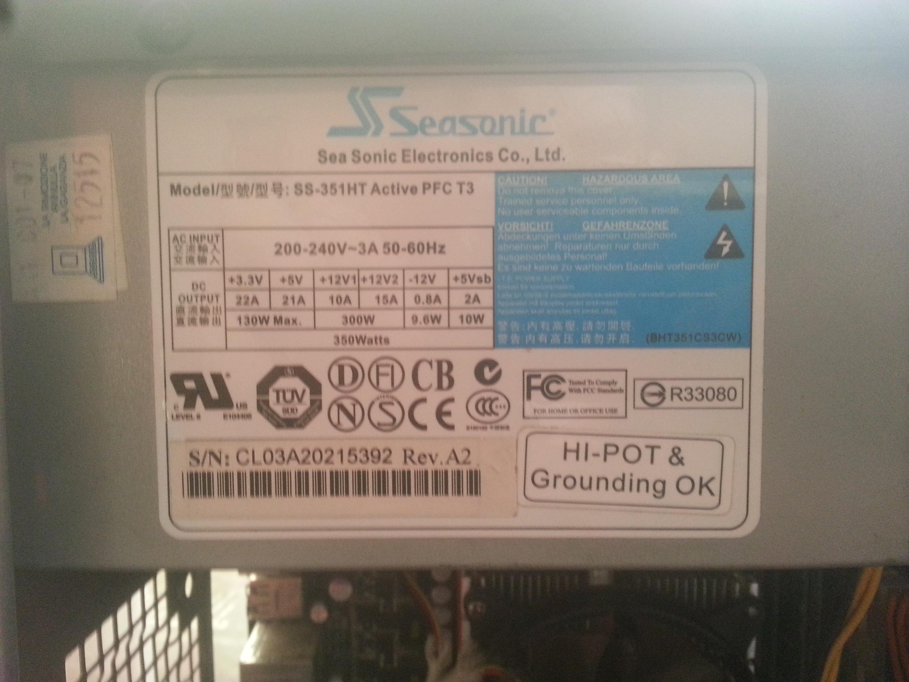

Seasonic SS-351HT 350W PSU - OST caps but none bulged - uses silent ADDA fan,120mm.

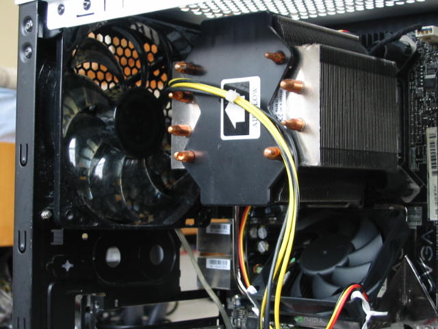

In the 2nd and 3rd pictures for example, you can see some telephone/ethernet wire strands going between a floppy connector and a fan connector – that's for the rear 120 mm fan, which is wired for constant 7V (positive wire to 12V rail and negative to 5V rail for 7V difference
Speaking of the GPU, and why I modded it – more on that
This is because the Dell cooler actually has spring-loaded screws.
) But at least my 70 mm NB fan runs more quiet than the stock 50 mm one. If one really wants to improve the NB/SB cooling on this motherboard, the stock chipset cooler needs to go. I'm not sure who designed it (whether it was EVGA or Intel, as this motherboard is made by Intel), but there are just so many flaws with it. It seems to mostly spread the heat around the board and not really actually remove it. I bet even a stock AMD Athlon 64 CPU heasink on the chipset will cool it better (and this is what I might actually do some day.)
