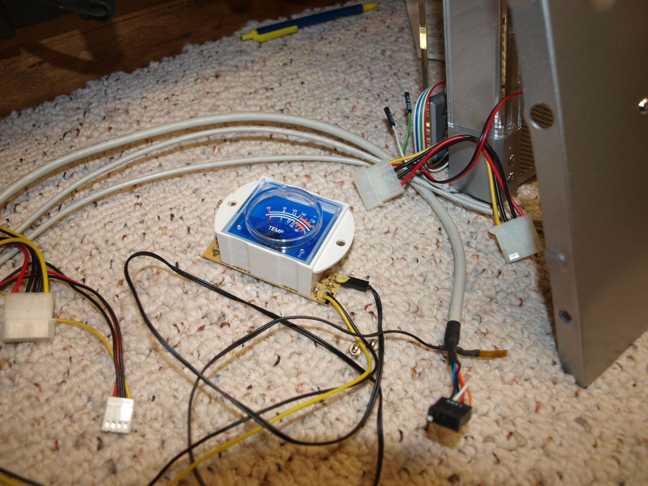

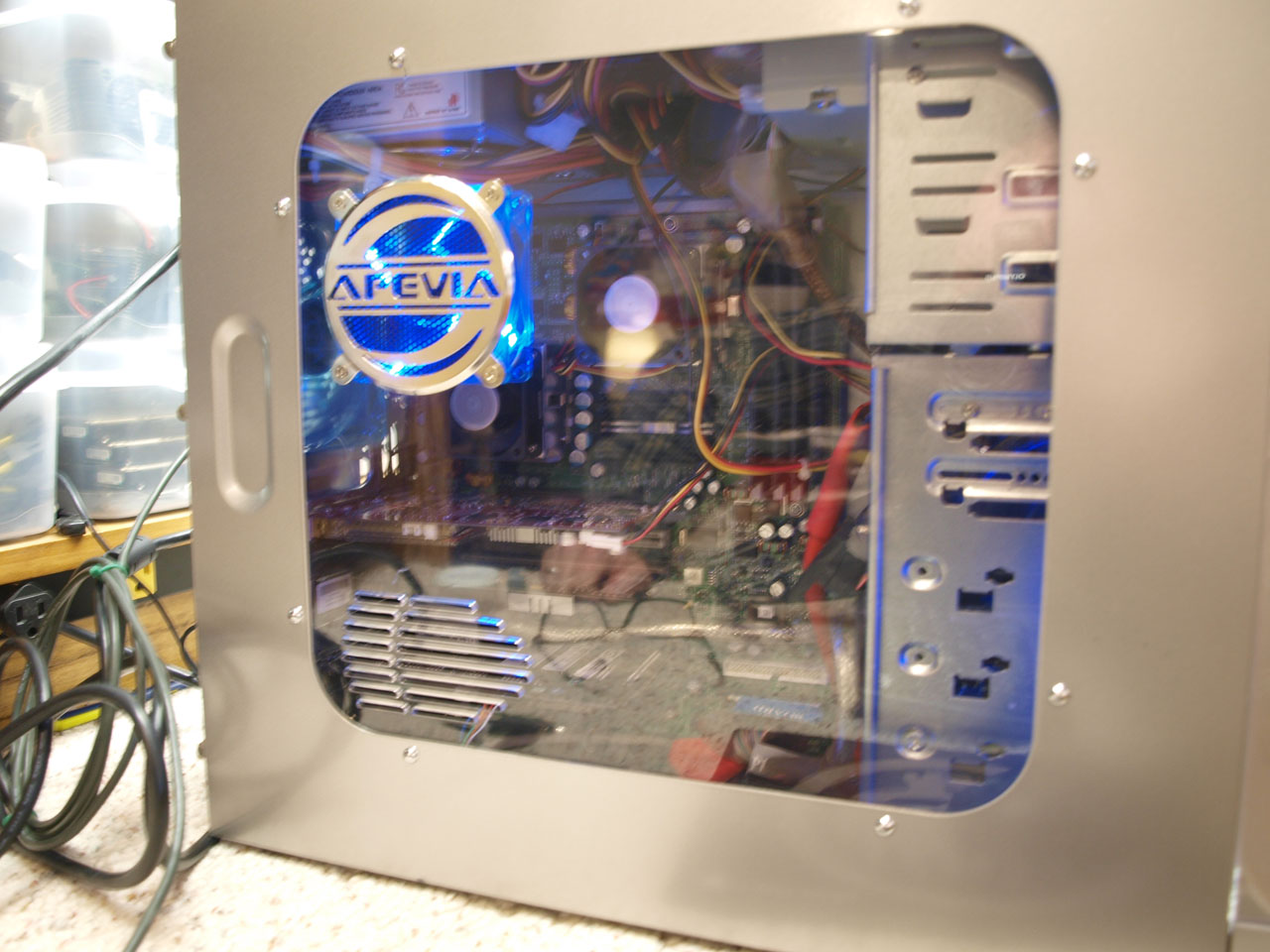

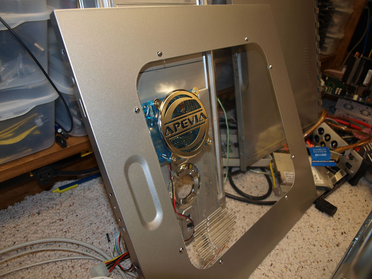

    To anyone wondering what might become of that Apevia freebie from the other thread......hmmm...maybe this will jog your memory:
    Yea, that is a temp gauge....and it seems to work. The sensor is just loose in the case....perhaps it was supposed to be stuck in the CPU heatsink....but ohh well.
    Nifty door....with magnetic latches...
    It currently has a t-bred XP 2600+ setup in it now.....kind of lame & boring......but I've got the cure for that! I was going to stick a Poly VP6 in it.....but something else came up a little more appealing, rare, and super cool!!
    Here's a hint (you AMD enthusiasts will recognize this right away):
    ...built on the latter revision of the Tyan S2466 (the S2466-4M model). I already updated the BIOS to v4.06, the final release.
    This will be a side project, and take a little while....but the foundation for a stellar completely period-specific retro gamer!

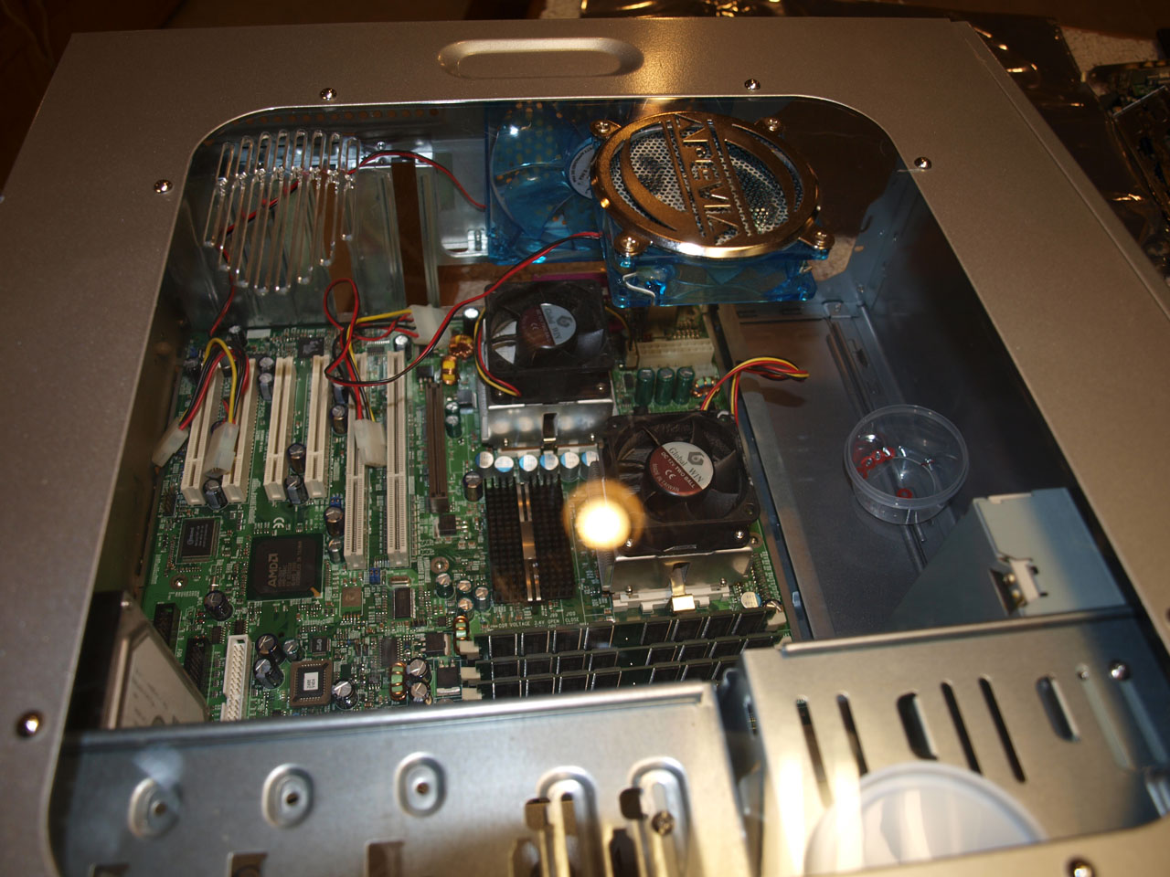

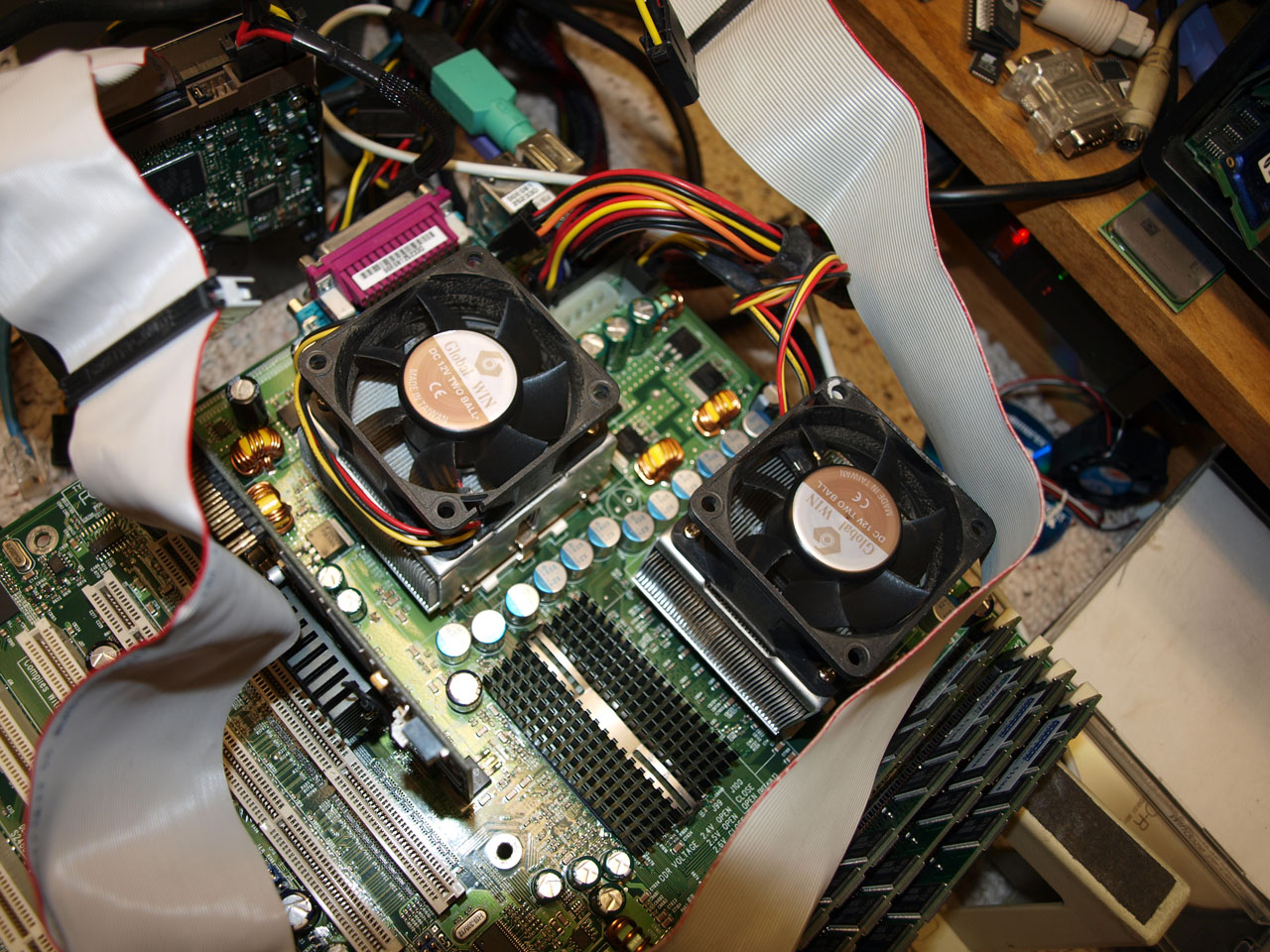

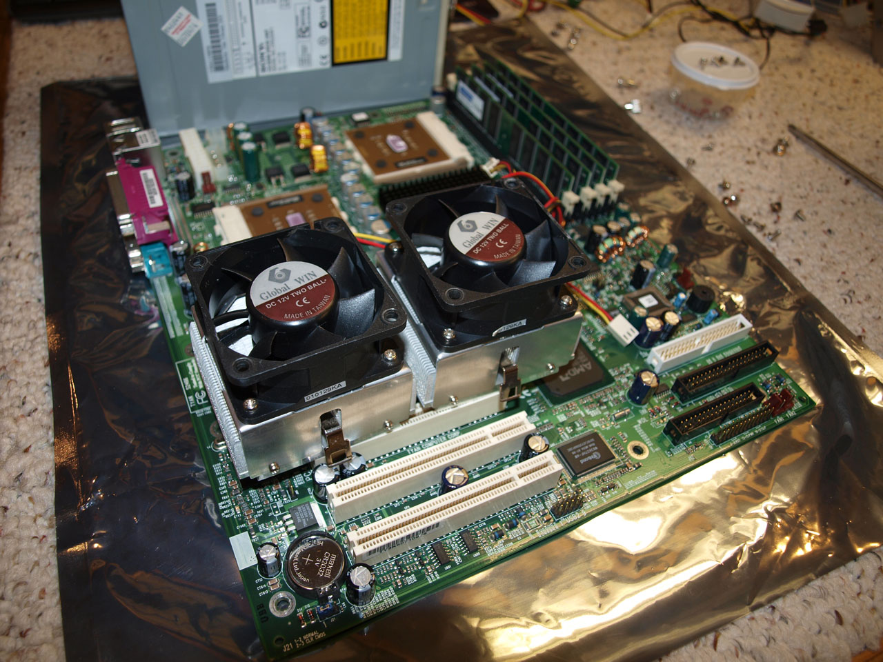

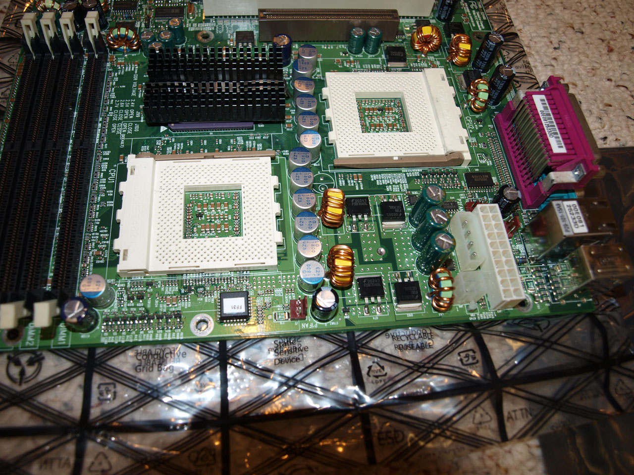

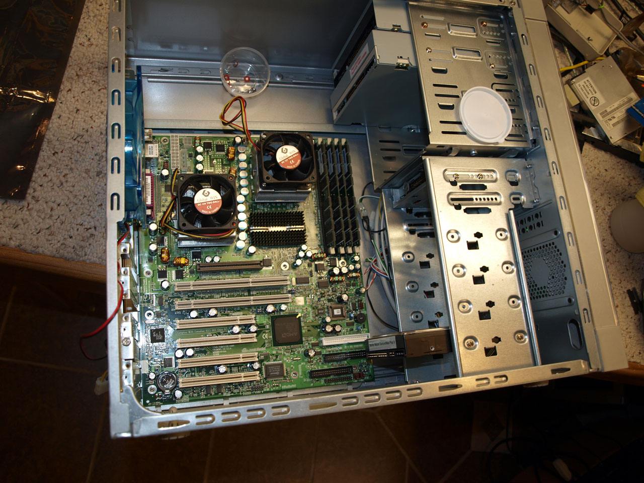

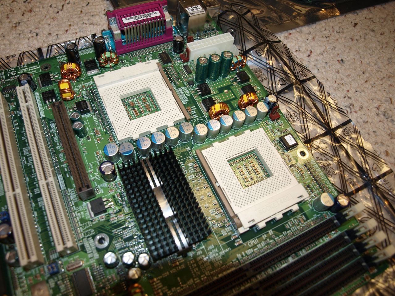

    I only did a partial recap on this board, replacing the higher load MBZ caps. The rest of the Rubies are YXG and some Sanyo SE; which will likely never be an issue. All the original Rubies were datecoded mid 2002.
    The fun begins with the VCORE caps; 3300uF 6.3v replaced with 1800uF 6.3v Nichicon LG Polymers. I replaced the VRM input caps with equivalent lytics.

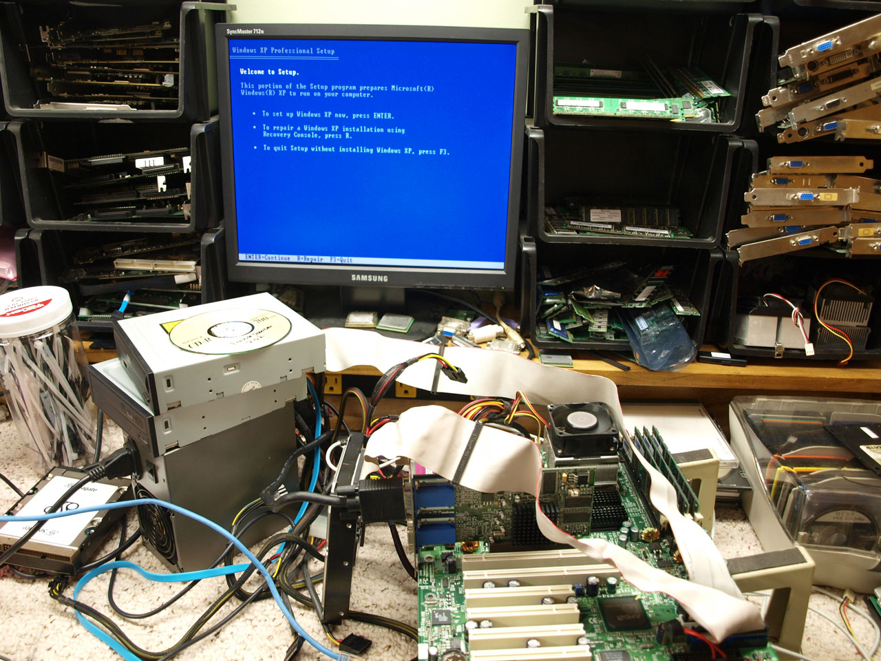

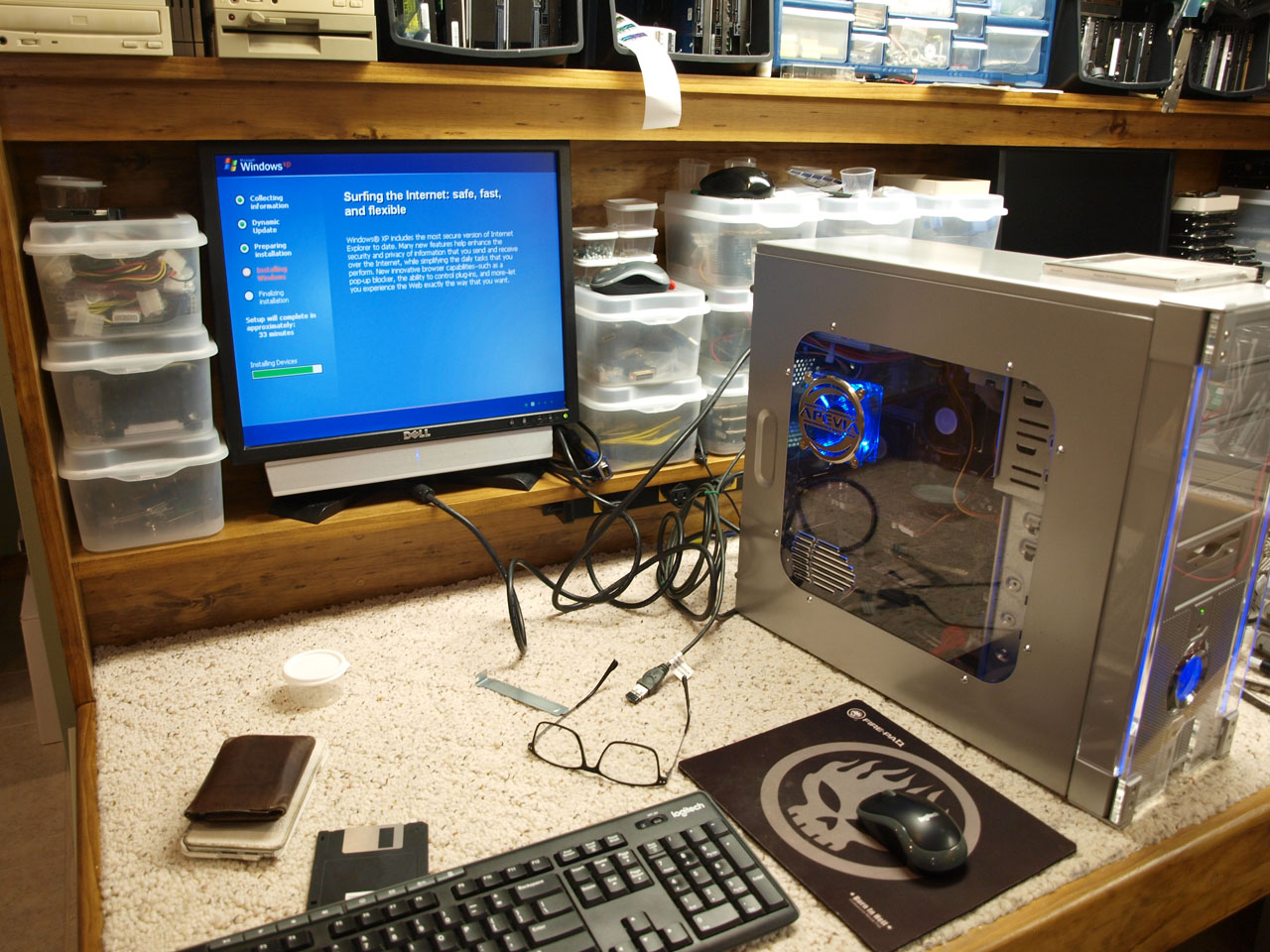

    Fired up....
    Passed hours of testing & memtest86, now time for the XP test...
    All is happy.

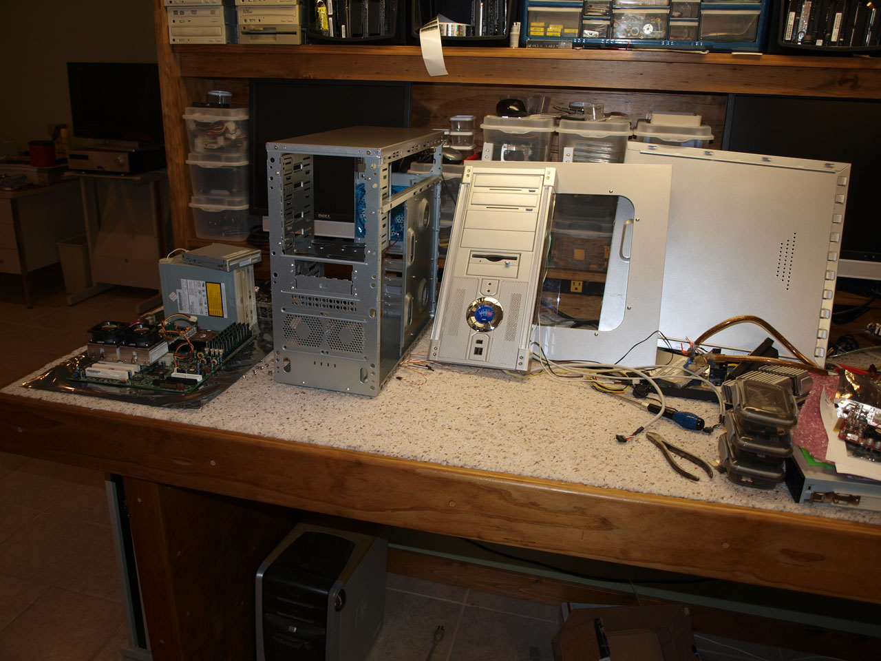

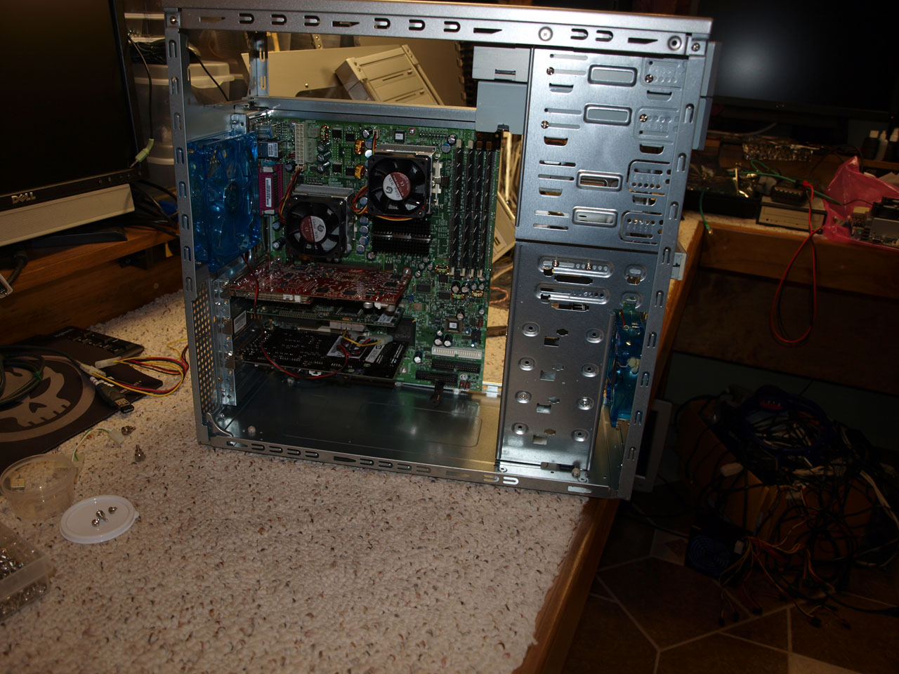

    Beginning of disassembly of the case and a test fit..... The Tyan board is about an inch longer. I didn't forsee any clearance issues, but I wanted to be sure before continuing. Fits like a glove!!
    Nifty winder!!

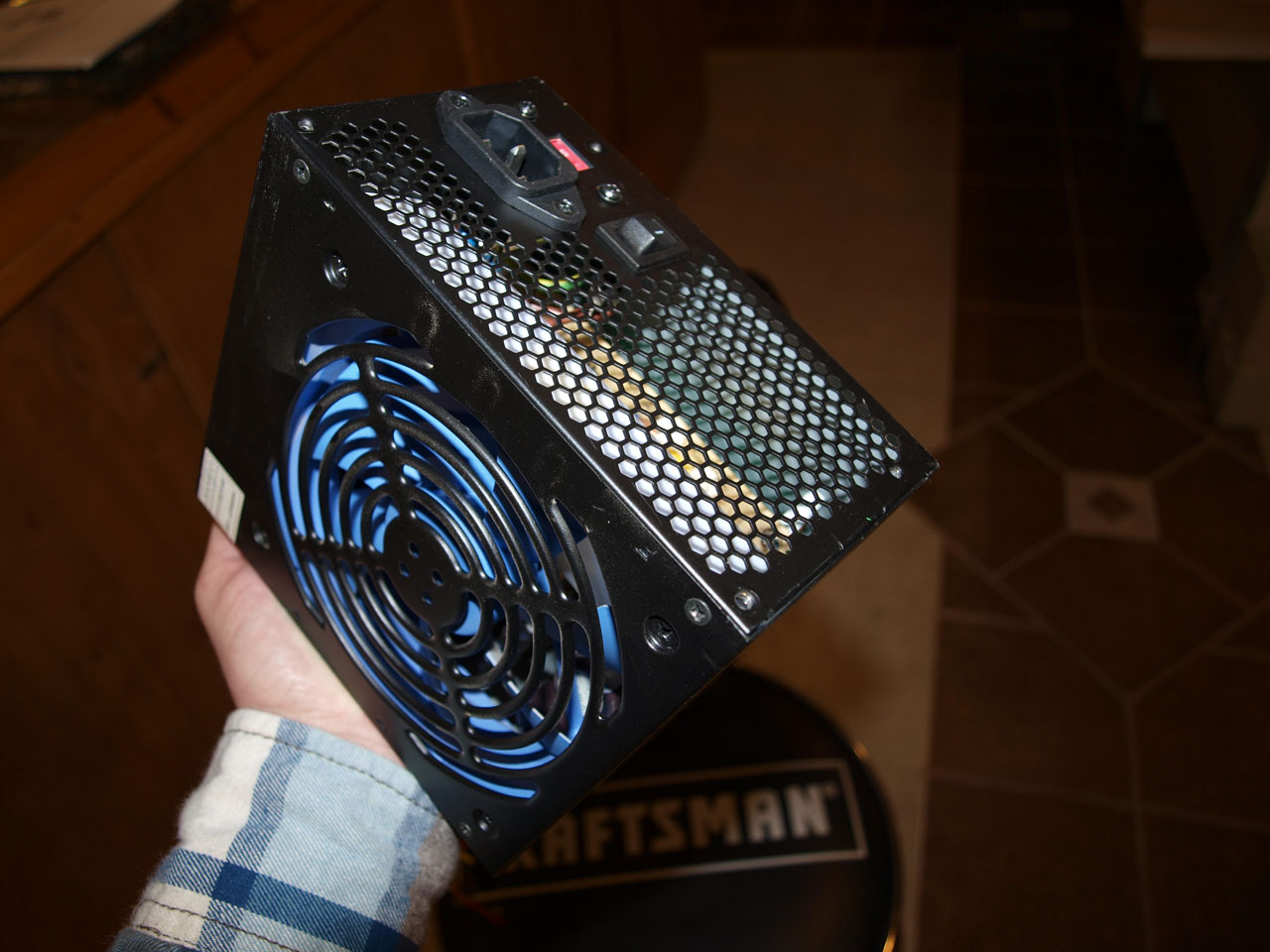

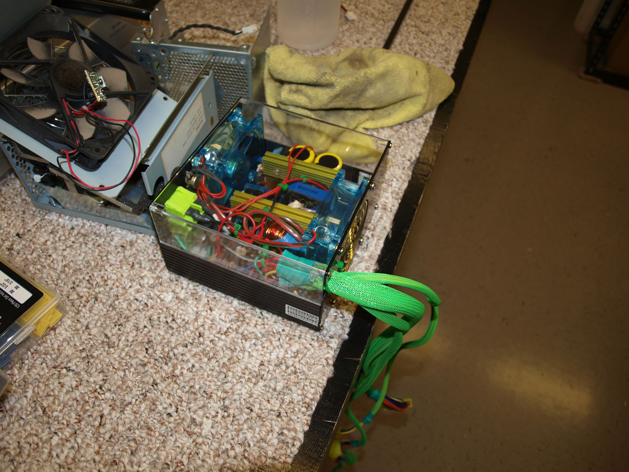

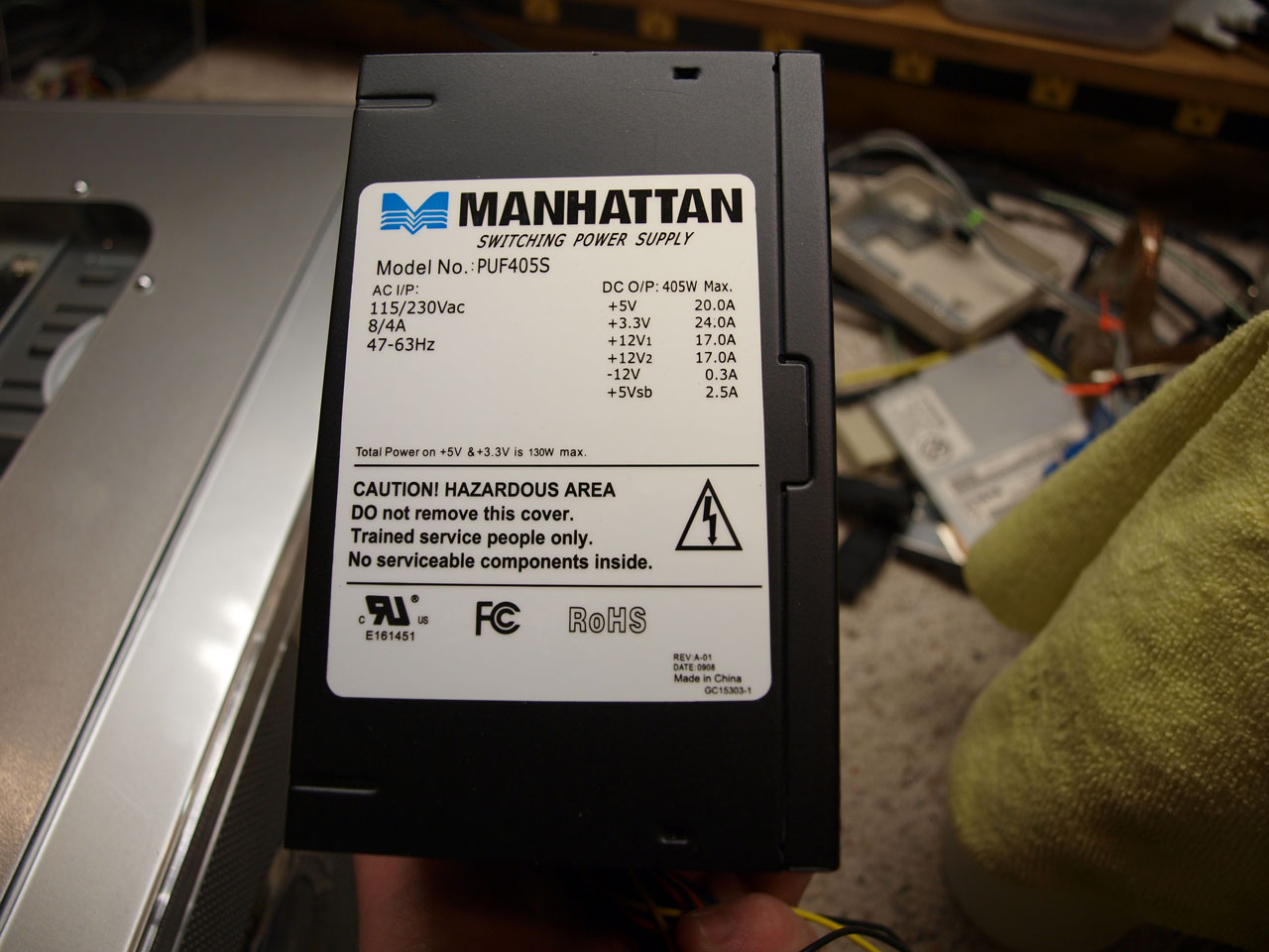

    Now for this cheapass Manhattan PSU... Allegedly 405W....how funny!!
    The PSU board consumes HALF the space in the enclosure....and it weighs less than a happy meal!
    Wires are thin & lightweight as well...what a piece of shit....it's going in the scrap bin.

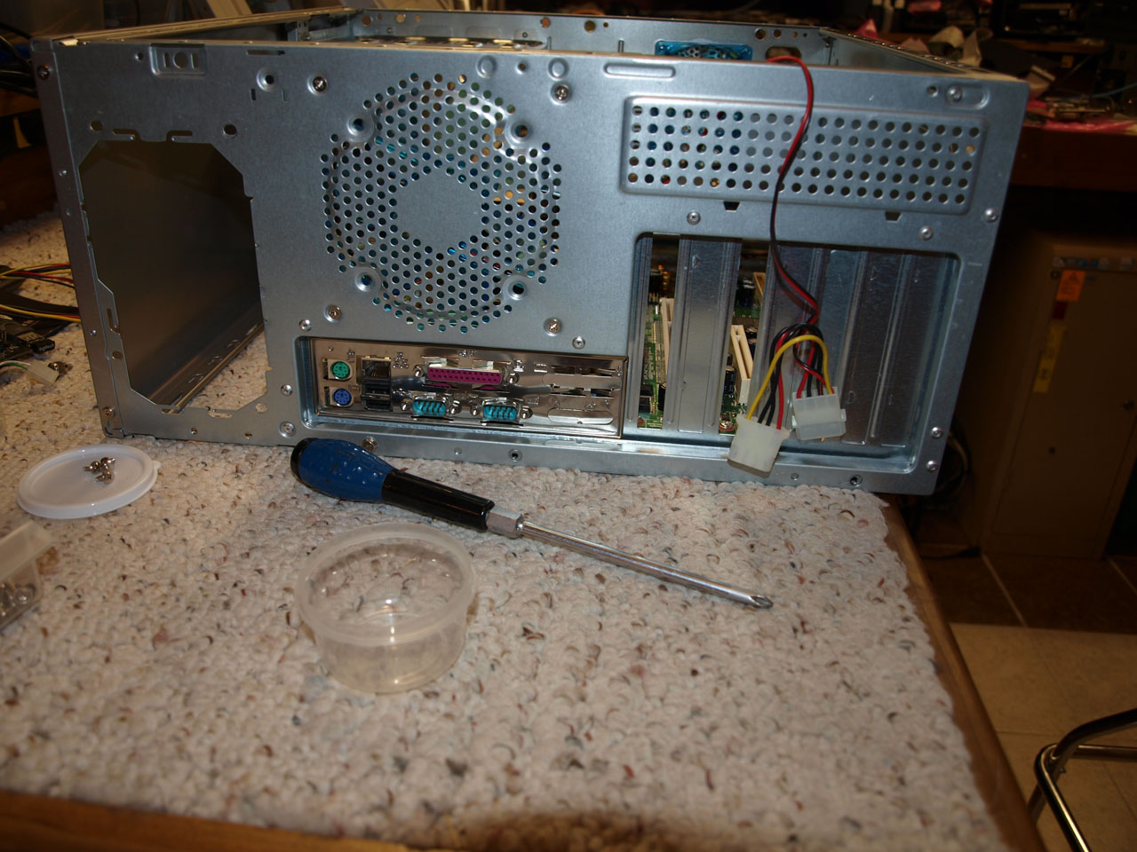

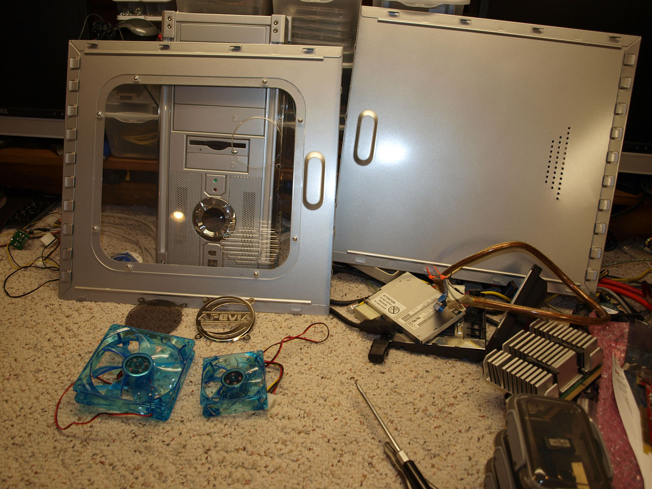

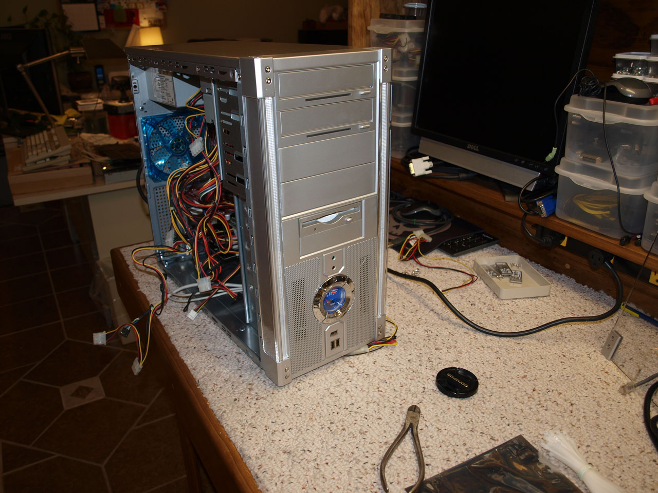

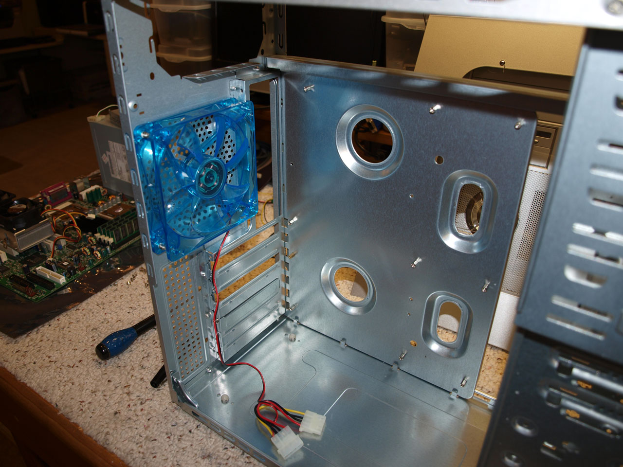

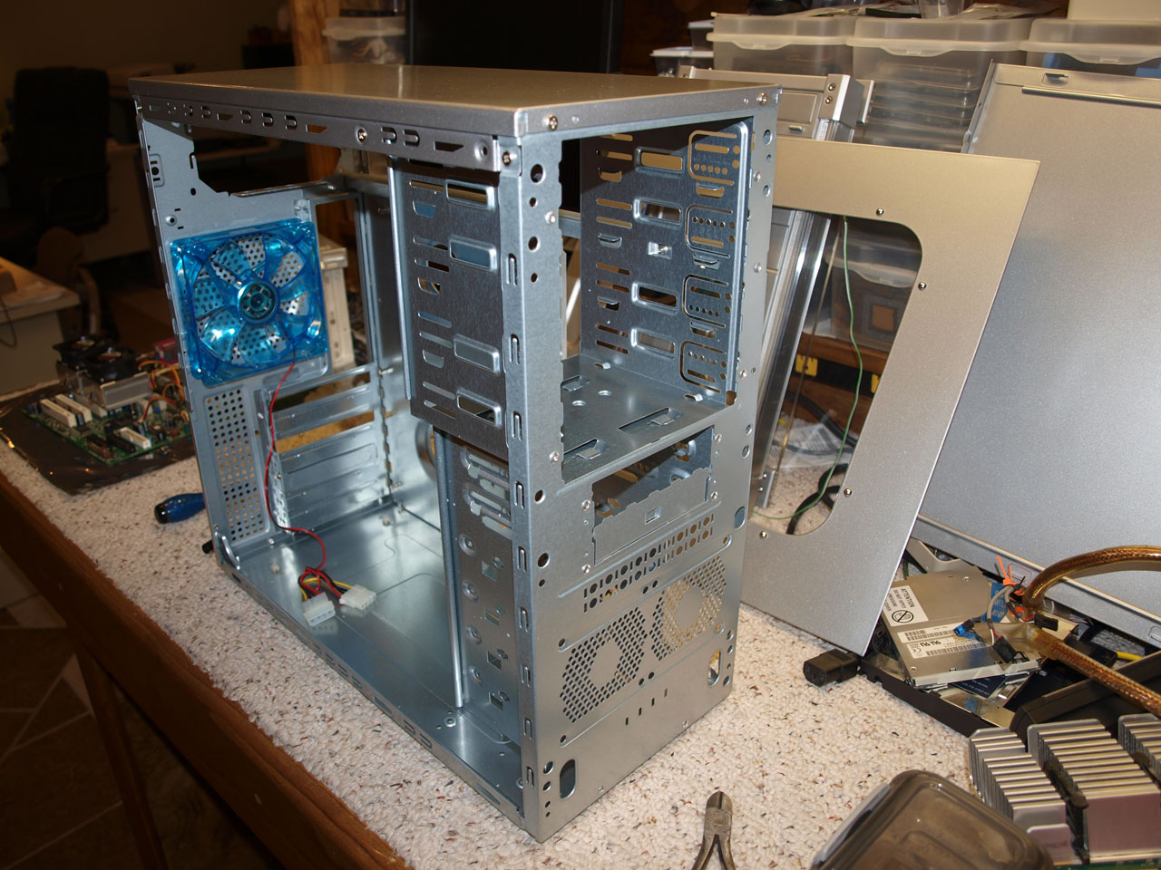

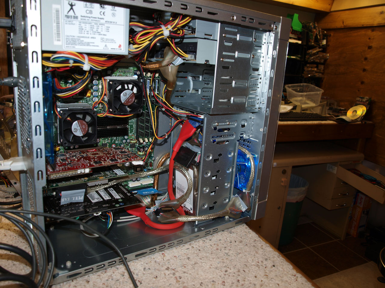

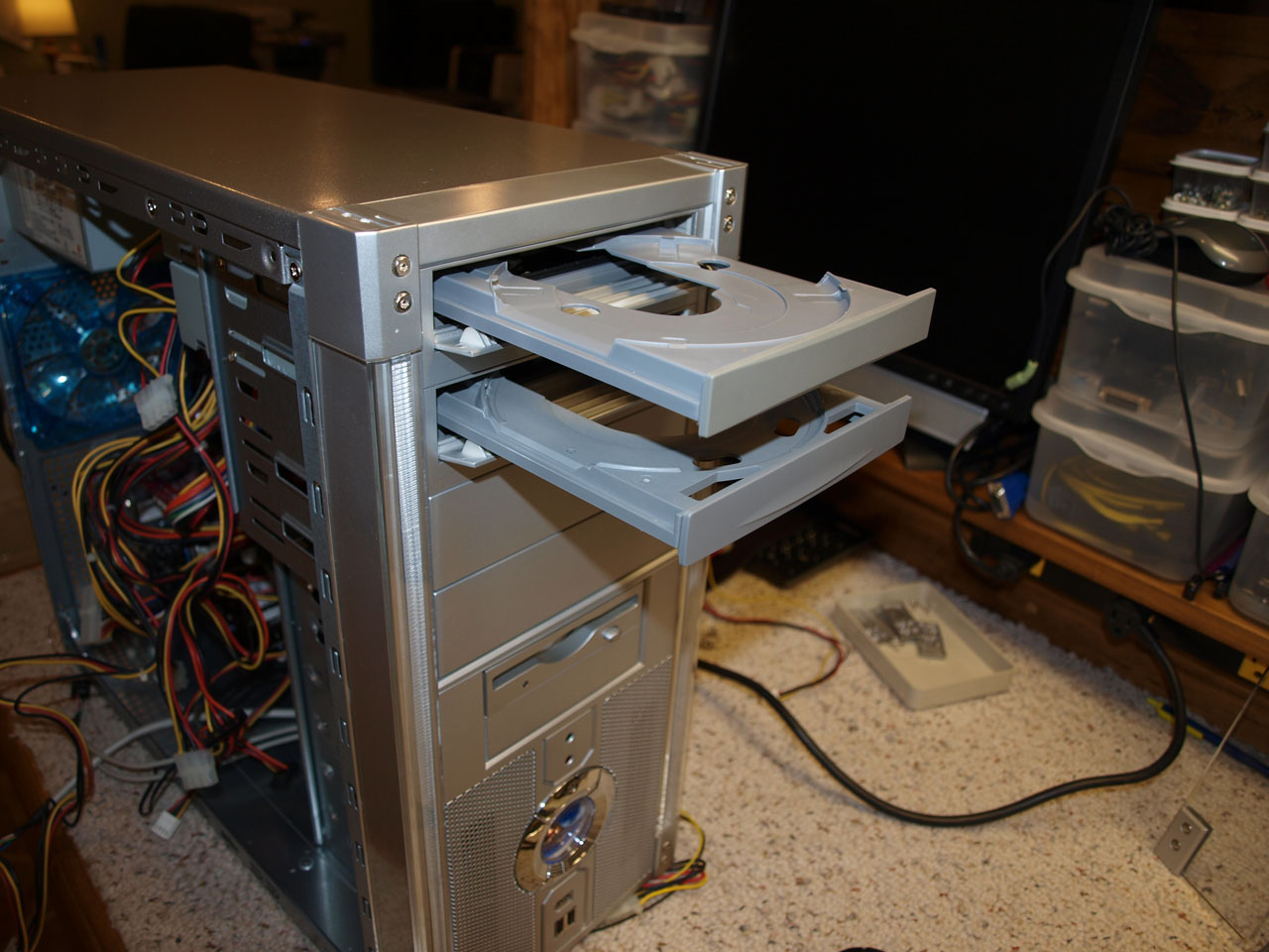

        I got the case disassembled & cleaned.... I didn't do a big to-do over the disassembly (reference pics), this case isn't that complicated like some I've done in the past....so just the 'aftermath' pics on this one.
        Sides, fascia & fans. I did completely disassemble, clean, and repack the fans with grease. That's one thing about lighted fans, they show every speck of dust!

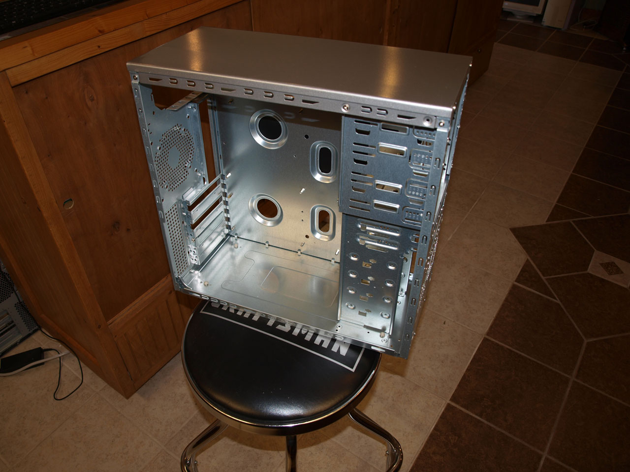

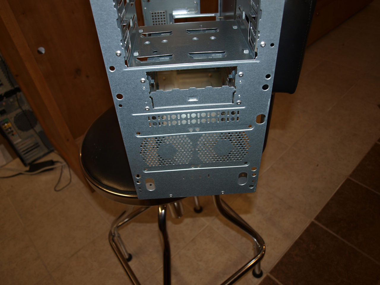

        Case body.....another one that's light as a Happy Meal when apart...I'm sure some of you are wondering why I'm even bothering with it....but I thought it was kind of unusual....so what the hell.
        2x empty 80mm fan ports in the front.... I bought a couple matching blue lighted fans for those openings, they aren't here yet...
        The floppy & optical drives... All of them are good, and will be reused...I will be going a different route for the HDD's. their slight color mismatch isn't important with the silver bay overlays...you don't see them. The floppy actually has an aluminum "bra" over the front for added appearance....yea, that really is aluminum with doublesided tape on the backside. Never seen that before.
        Now the fans below aree a little piece of history.... I bought these Global Win coolers new back in the day I ran P3's in a VP6 as my main system. They eventually got relegated to a Tualatin Server when I upgraded my main system, and ran 24/7/365 for quite a few years AFTER being used in my daily... After that server was decommissioned, they were used around the shop for testing purposes and so on...they had a lot of hours on them; definitely well beyond their useful lifetime. The point being, they were very crudded up and the double ball bearing fans were making a lot of racket. They got completely stripped & cleaned. Each bearing gets the dust shield removed from one side (it doesn't matter which), then soaked in Brakeleen to break down & remove the dried out cruddy "grease" they used. I then repack them with ZEP2000 spray grease (wonderful stuff) and reassemble with the now open end (the dust cover cant be reinstalled) on the inside of the sleeve and then fill the sleeve with more grease....then seal as normal. Quiet as a mouse now!
        Side fan reassembled.
        Rear fan reinstalled.
        That goofy temp gauge....I had to remove it....I thought it best not to get it wet, it's not sealed...
        ...and done for now.... I can't go any further until those front fans arrive...
        Till next time...

          Re: That Apevia Case from the Free Scores thread...Another Time-wasting Retro Build!

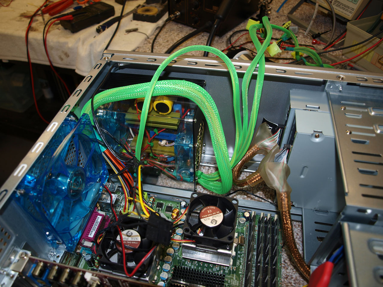

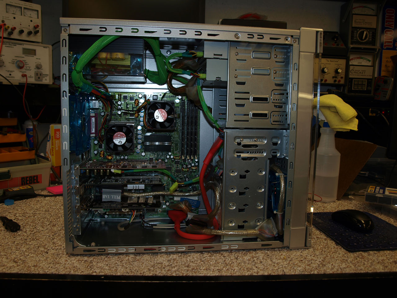

          errr really? the hard disk in the case looks like its colliding with and blocking off the ide ports on the board... i think u need to move the hard disk forward a bit onto its rear two screws.
          • Topcat
            The Boss Stooge
            • Oct 2003
            • 16958
            That image is deceiving, there's a good inch+ clearance behind that....but fwiw that's not the HDD that will be used. No worries.

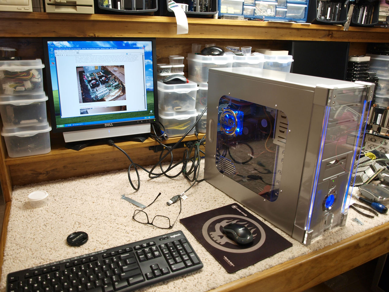

                I finished this build today, but silly me forgot to dump the camera.... It turned out pretty good! Of course I'll follow up with the pics.... Q3A plays fantastic on it.... Unreal Tourney is next.

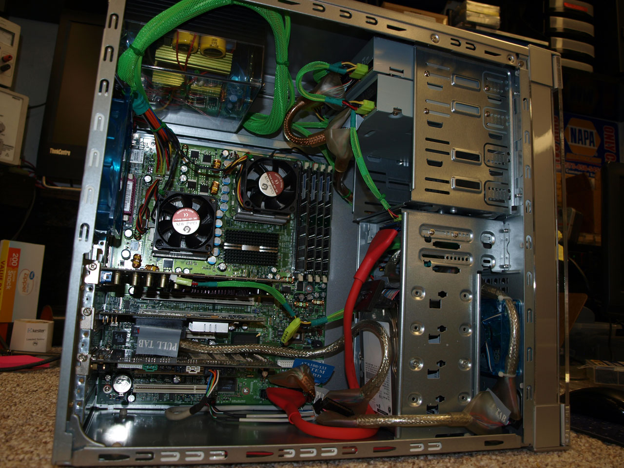

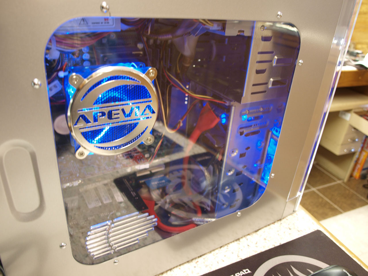

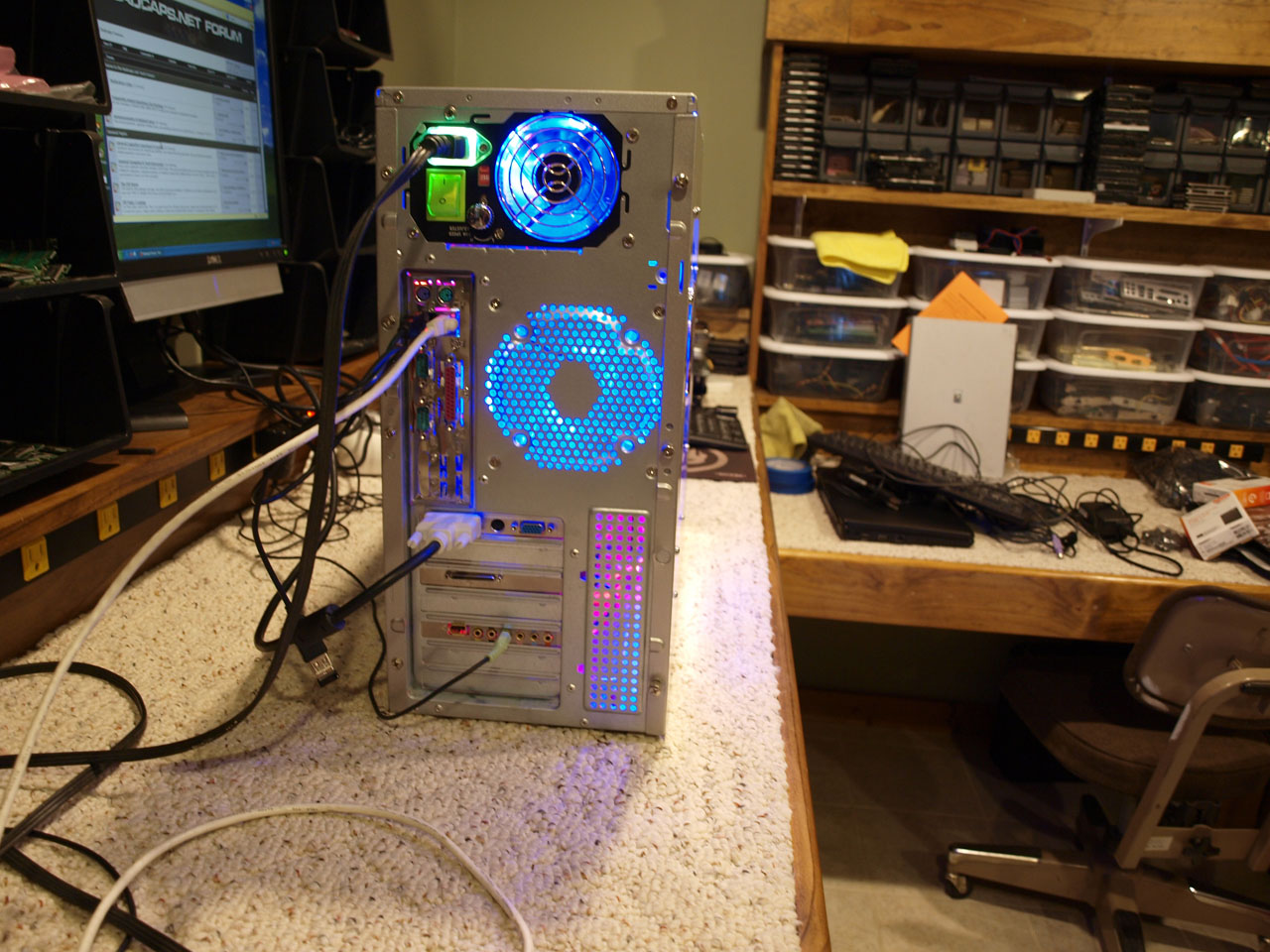

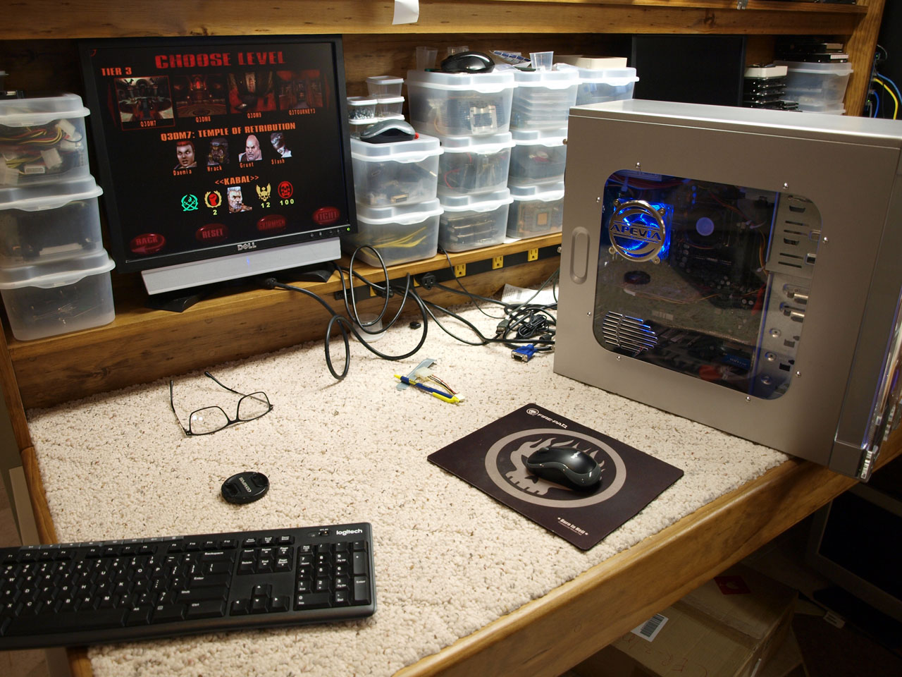

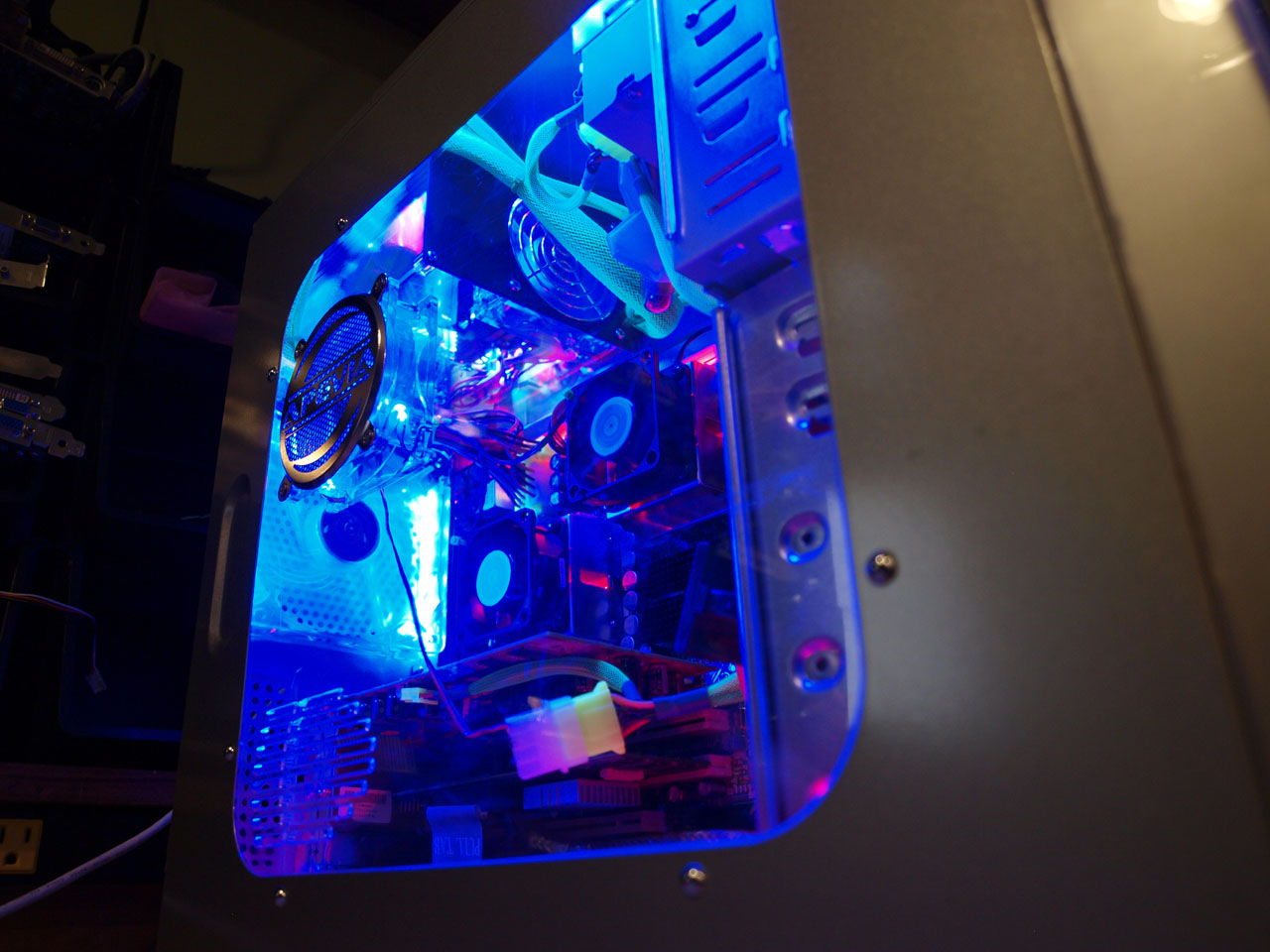

                  ....and here we are.....dumped the camera today, but all this joy occurred yesterday....
                  Front fans; ricey blue LED to match the others.
                  Ok, I lied....I didn't reuse the original opticals...I used some gray ones that I otherwise would never use. Great match for this beast! One is a DVDROM the other is a CDRW.

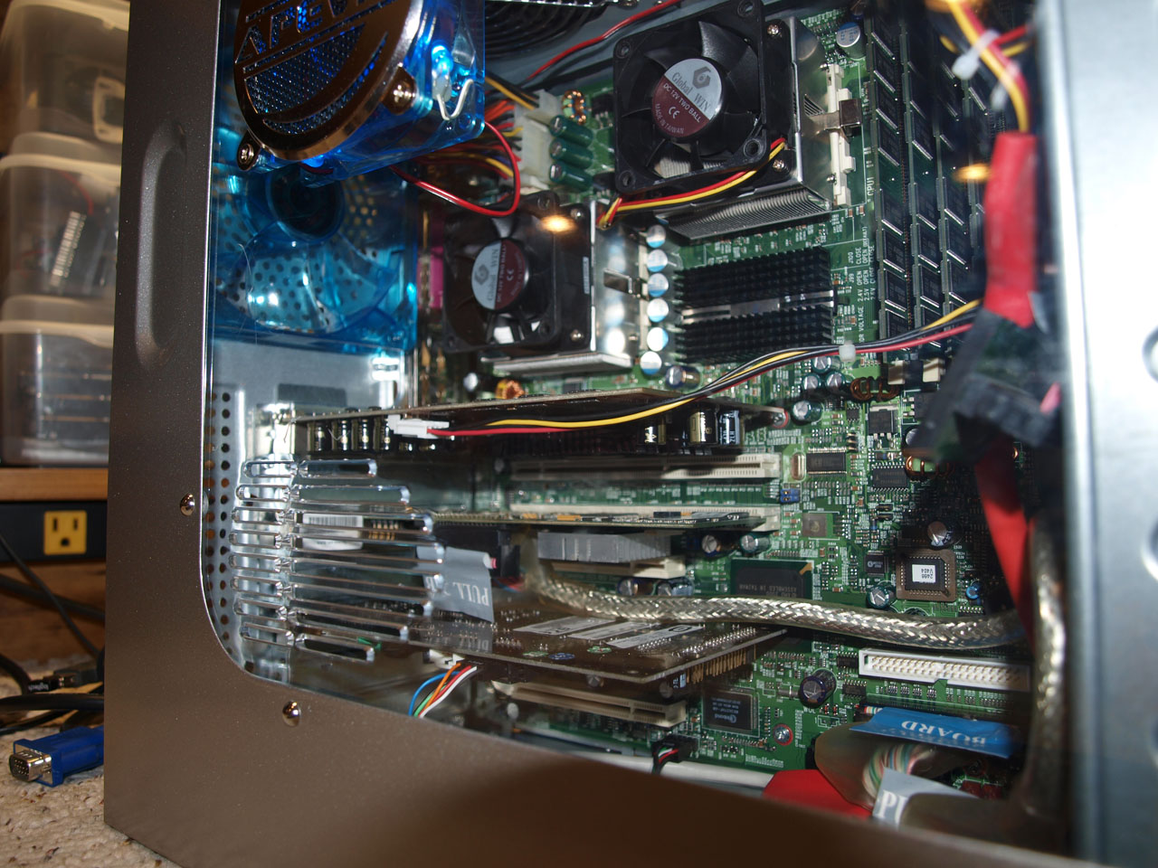

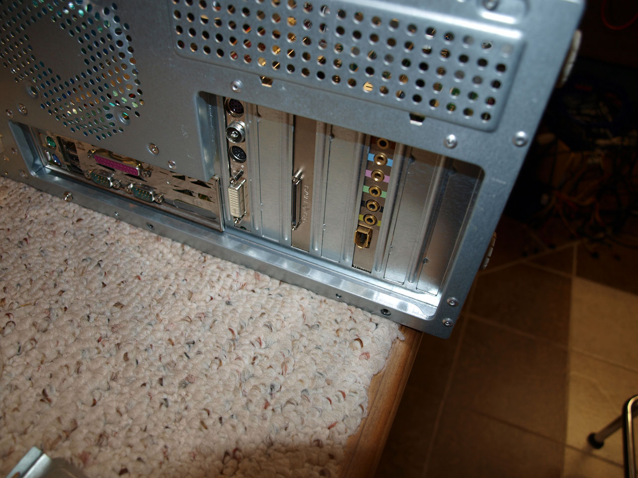

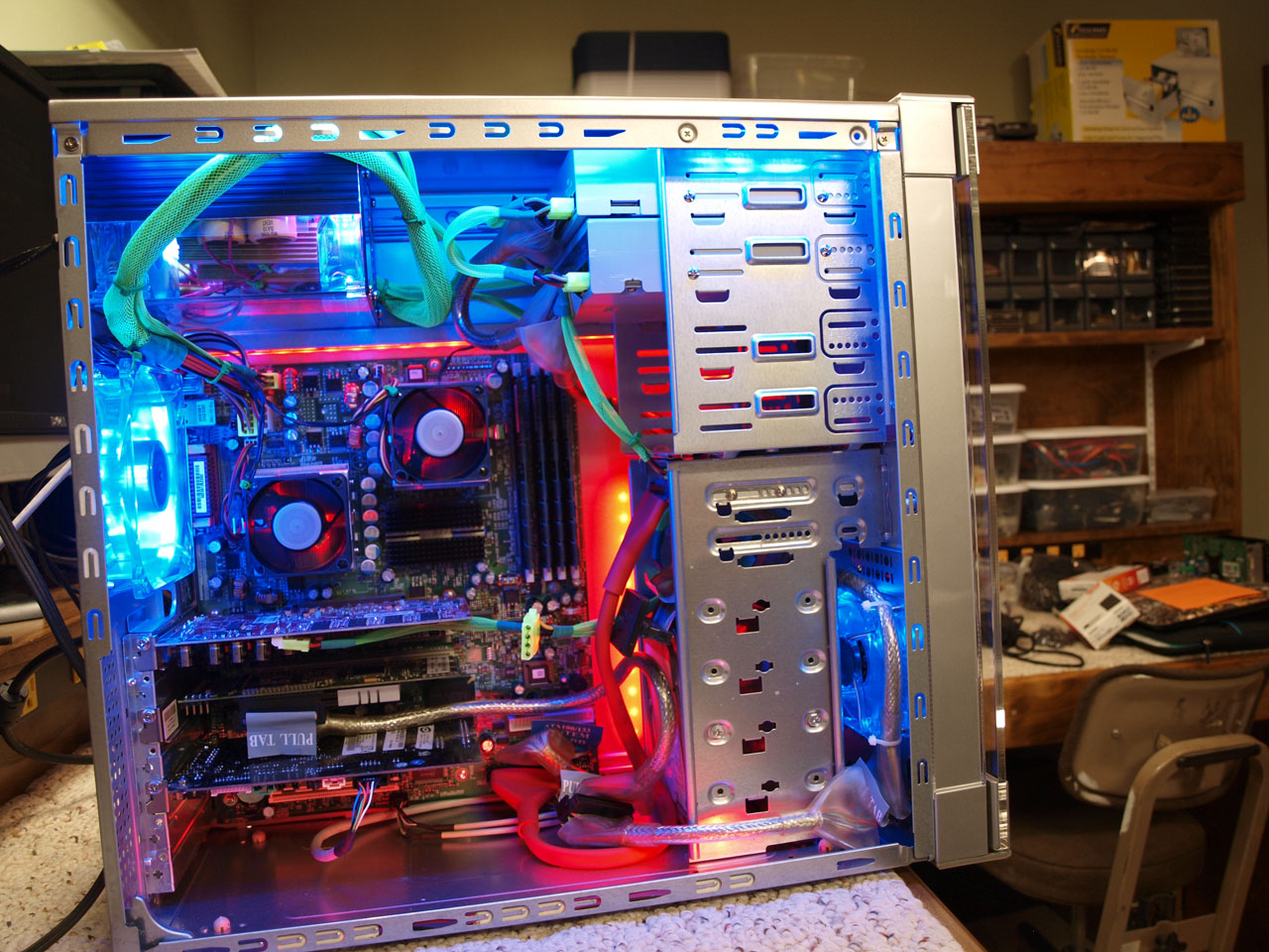

                  Now for the motherboard.... Mounted up....
                  Cards installed.

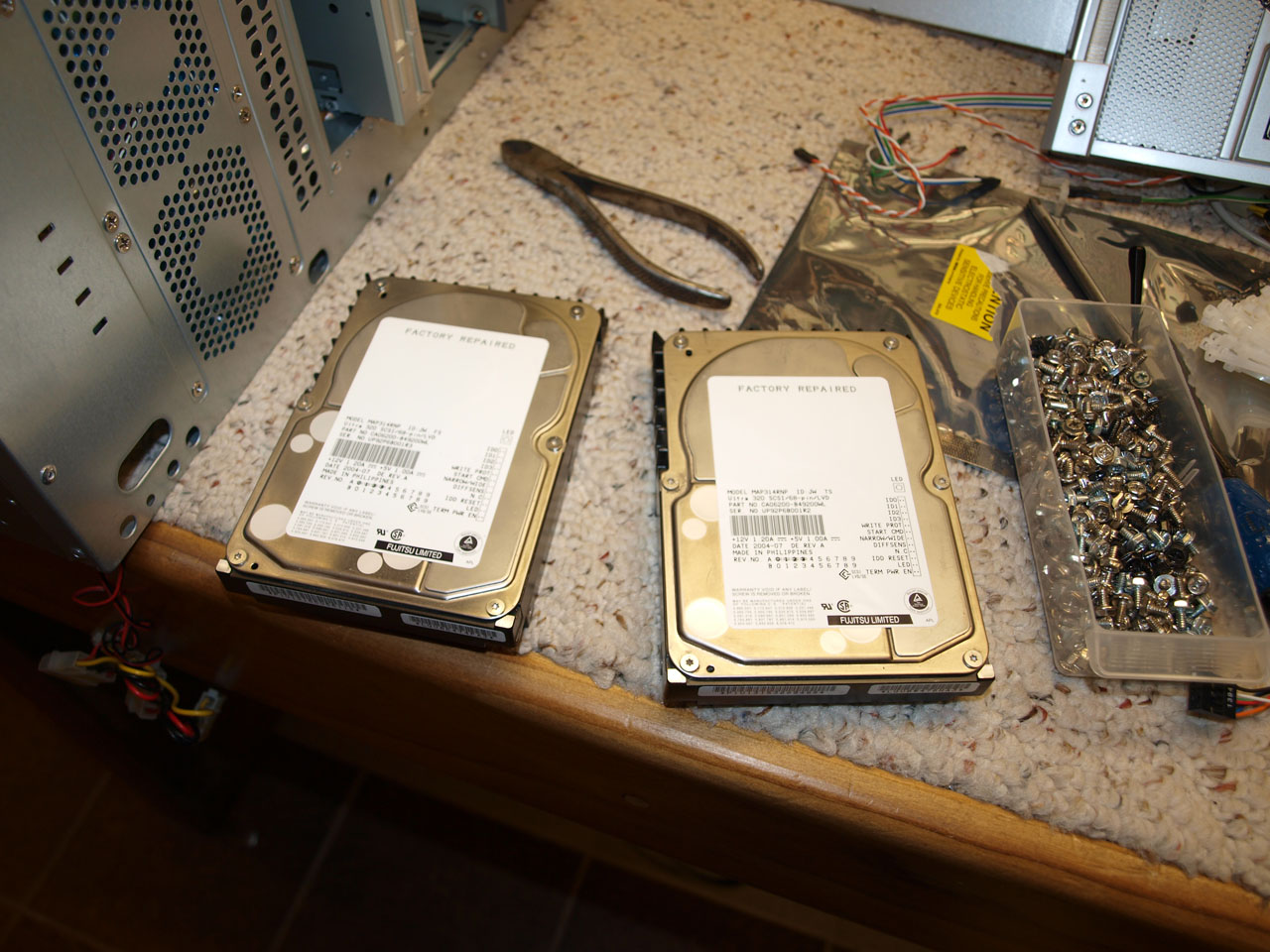

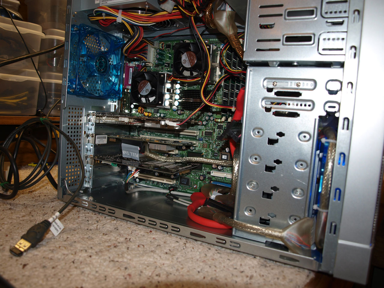

                  Now for HDD's...and anyone that knows my retro builds already knows it'll be SCSI (incase you didn't see the controller above). The HDD's are 2x Fujitsu 146gb U320 10k RPM in a RAID1.
                  Mounted vertically to hide them better. Plenty of airflow around them....and surprisingly, Fujitsu 10K's, don't run all that hot.
                  So far, so good!
                  Nice match!! Glad I did that!
                  PSU & cable routing time. The front panel USB header on this board isn't keyed, a full 10 pins, not the usual 9. On older boards, I always check them for grounds and +5v, as seemingly many of them back in the day didn't follow any standards...good thing I did....one port was wired normal, the other was a mirror of it; IE backward.....so the header cable end had to be depinned and wired reversed on one side, or I'm sure bad things would have happened when a device was connected. I've had to do this to many old boards/systems.
                  All rounded cables. All came with the case except the 68-pin SCSI, which I had.

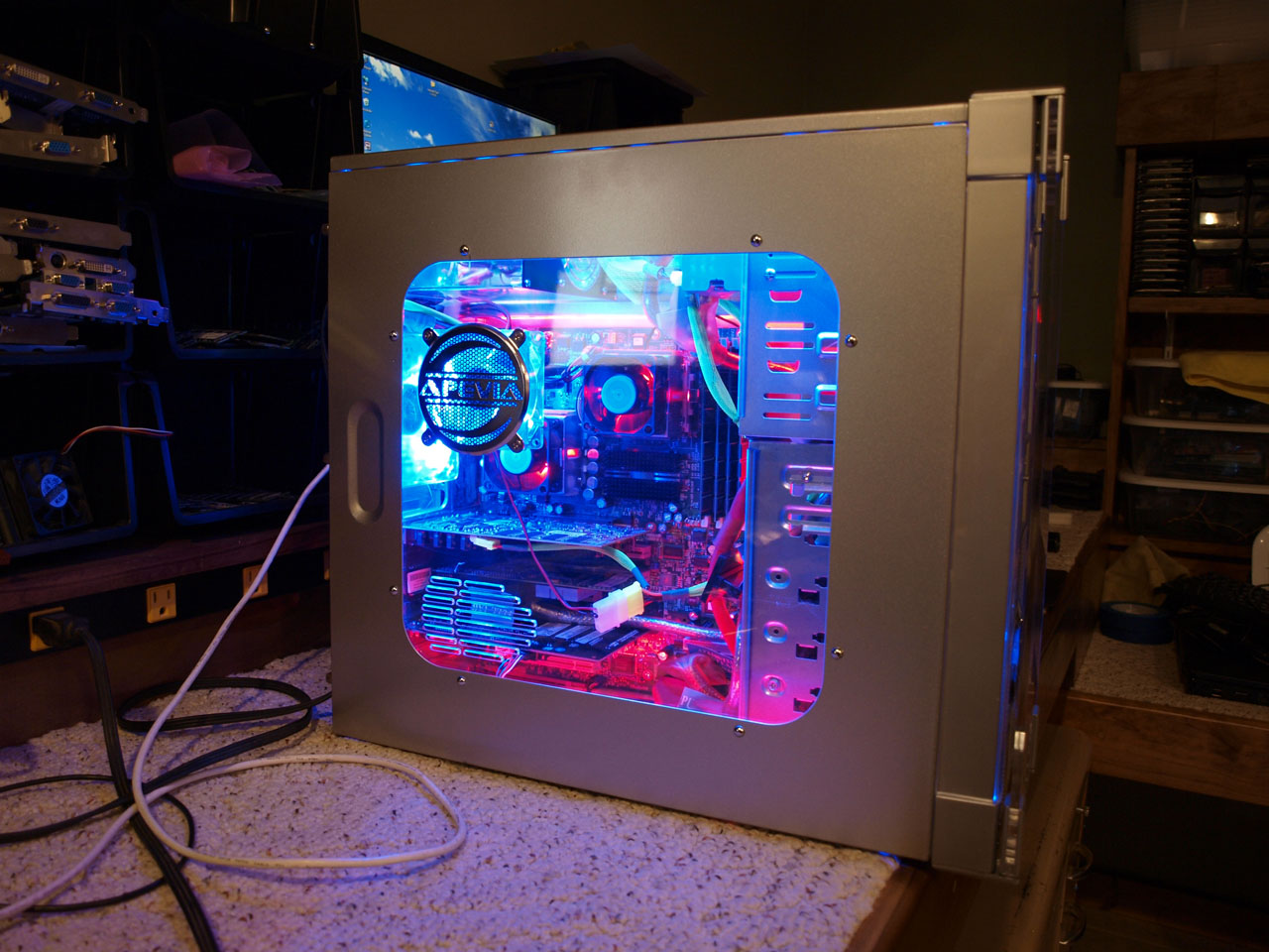

                  Door reinstalled.
                  Ricey glow!

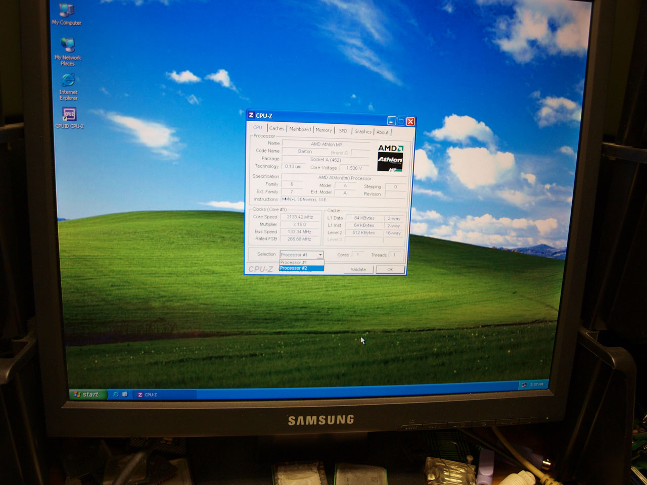

                  Great XP system.....
                  Firefox 24.8.1
                  Temp gauge sensor is properly installed in CPU1's heatsink louvers.
                  Specs are:
                  Tyan S2466
                  2x AMD Athlon MP 2800+ Big cache Bartons
                  2gb RAM (supports 4gb, 3.5gb usable but this is what I had on-hand)
                  ATI 9800 Pro 256mb
                  Creative Labs Audigy2
                  Adaptec 2120S U320 RAID controller
                  All the rest of the 'usual stuff' living in an Apevia case.
                  Yes, both USB's work!
                  Yay for a fun build that monetarily I have nearly nothing in!!

                          Am I seeing this wrong?
                          Looks like one of these is blowing towards the HDDs, but the other pulling air away from them?
                          Nice!
                          I bet those are pretty damn reliable drives.
                          I have limited experience with Fujitsu, but the few drives that I have seen/used seem to have been high-hours drives with always zero issues.
                          https://www.badcaps.net/forum/attach...1&d=1618452411
                          Fascinating!
                          Even though I have that same case (well, the base anyways), it never occurred to me to try the single HDD I have in there that way to make the wiring better. Thanks for the idea!
                          Specs are:
                          Tyan S2466
                          ATI 9800 AIW
                          Only thing that slightly worries me is the ATI Radeon 9800 card. The stock coolers that come with them never really did a good job of cooling the cards and the fans also failed after a while. If you ever run into a Zalamn VF-700-CU from another dead GPU, that might be a good starter upgrade. A VF-900 would be preferable, though. Some of the IceQ/Iceberg coolers were also popular with these cards and did fairly well (at least better than stock in any case.)
                          Otherwise, those specs are total killer for an early/mid-2000's Windows XP machine. I would have probably gotten my pants wet if I had one like that back in those days.
                          Instead, all I had was a droopy AMD Duron Applbred 1.4 GHz (T-bred with only 64 KB L2!!! ), 256 MB of DDR PC2700 RAM, ASUS Radeon 9200 SE (sucky edition 64 MB, 64-bit mem), and 1x 20 GB Maxtor HDD. To top it off (and to save money, as I didn't have much), I had that build in an old case with terrible airflow and re-used a PowMax PSU.
                          However, when Half-Life 2 came out (super big-deal at the time!), I was able to *run* it at medium-high settings (on very low resolution, though.), The framerate, of course, was a little beyond "artistic" (referring to what the movie industry says about movies still being shot in 22/24 FPS. ) But for the few years I had that PC, I was still very proud of it.
                          • Topcat
                            The Boss Stooge
                            • Oct 2003
                            • 16958
                            No, you didn't see that wrong. I caught it immediately after taking the pic and corrected it...strangely enough, no other pics show those fans well enough after that to reveal the correction....but it was caught very early and fixed....
                            Good catch though!!

                              Waking this one up over a year later.....as it's one of three cases I have here with a window in it....and I have plenty of red & blue LED tape left from THIS EXPERIMENT.... I heisted the Apevia power supply that I modded from THIS BUILD (don't worry, I have something just as goofy to replace it with) and put it in this case; Apevia PSU in an Apevia case; nice pairing and all period-specific of course.
                              Yay case!!
                              Yay PSU!!
                              I won't go into all the gory details....but the LED tape was strategically placed throughout this case to create an even ricier look than it already had....but with this case I have to say that it fits....and then add in the correct PSU that was supposed to be there.
                              ...and lit...with the side off.
                              ...and reassembled...
                              I'm just showing the aftermath pics this go-round... I took plenty along the way....but there was a LOT of them.... If anyone really wants to see how something was done, let me know which region of the case and I can post up the installation & how it was all wired.....but I otherwise wasn't going to waste everyone's time with that..... Also bear in mind that this kind of lighting is hard to photograph...it looks much better in person. The 'Ultimate P4 build' is the last case with a window I have left; still an open build...and that one will probably be my last one done up this way....which will have 3 goofyass cases with lighting in them; this is normally not really my 'thing'...but sometimes you have to make an exception for the right case & right circumstances! The first one was done for devious reasons, this was done just because I had the LED tape and this type of case. To do this and not have it look like it was done by a 12yr old, this is actually a very time consuming project. Placement is so very important as well as what color goes where to blend it.

                                If we are to turn back time and go in the early-mid-2000's, I'd say the above build would've had everyone drooling on their keyboards. A dream machine back then for sure. And the lights couldn't be done better!
                                Y'know, as much as we'd like to joke how "ricey" these early-mid-2000's cases are, I'll still take one of them ANY DAY over a modern boring case that has NOTHING interesting going on.
                                Well, on one of the last few pictures, I notice the holes for the rear 120 mm fan look bigger than what they were when you initially started the build. Did you re-drill them like I did on the Pac-Man case?
                                Old pic:
                                New:
                                https://www.badcaps.net/forum/attach...1&d=1653694540
                                Looks like I had some influence on the build too.
                                Looks good to me, even not in person.
                                Actually, if there's one thing I like much better about these older cases, it's the fact that they are silver/gray inside and not black. IMO, that makes the light "spread" much better inside the case. In contrast, the black cases just "soak up" / absorb everything, and the lighting rarely looks good. (Not saying it's impossible, but just not common.)
                                ... which is why I still have a much bigger appreciation for these retro builds - yes, even these "ricey" ones with the lights. Back in those days, it really took a lot of work to make a nice-looking build, be it with or without lights. And a lot of things had to be made from scratch or you just had to be creative. These days, cases are just boring. You slap everything together in 10-15 minutes and there's nothing else left to do. Hardly any room for real creativity and ingenuity. Almost everything can be bought. The art of building a PC is just not there anymore, IMO.
                                I think you can keep on churnin' these out, even if it's not your style. So far, they all came out superb.

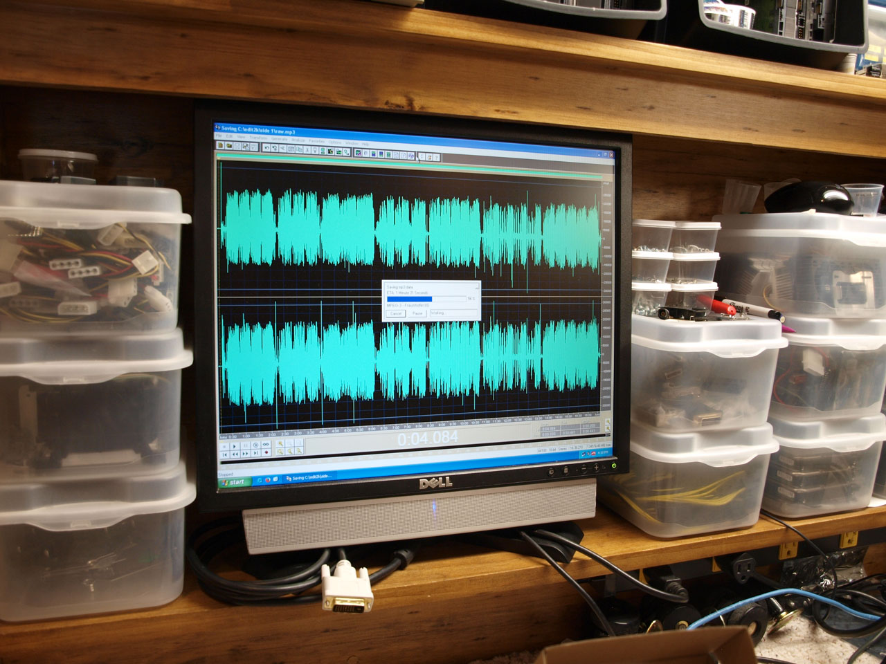

                                    Because of its analog capture abilities with nicer hardware, I actually wrangled this one several times doing some old school capture tasks...so hours of capture & compiling at high loads, it never missed a beat!!
                                    Sometimes these builds do get used for practical things that modern gear can't do.... I did take a few pics, but just never posted about it.
                                    I did not. I think it's just the way the lighting is reflecting/showing through the holes. I mounted some LED strip behind that fan on the inside to make it brighter. I used some diffuser sheet from a scrapped TV to hide the LED strips behind it and create a more uniform glow....but there's a lot of light behind that fan.
                                      nice! putting that creative soundblaster audigy 2 to good use converting analogue vinyl to digital compact discs! the late sim wong hoo will be proud to know his stuff is still being put to good use even after his demise.
