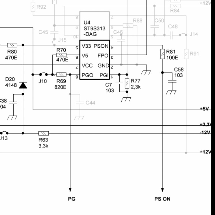

Trying to find a datasheet for 2 smd's and the schematic for SMPS made by APEVIA
  • LA1
    • Jun 2011
    • 23
    • USA USA USA
    I am trying to find two smd datasheets for an Apevia 1000w prestige power supply ATX-PR1000W the SMD's are ST9S313 which is a SMPS supervisory chip and a EST 915HP or XP48024 not sure which or both is the chp prod number and the schematic
  • kasfamily
    • Aug 2014
    • 765
    • Russia
    Show a photo of the chips
    ST9S313 =PS113
    https://www.alldatasheet.com/datashe...ITI/PS113.html
