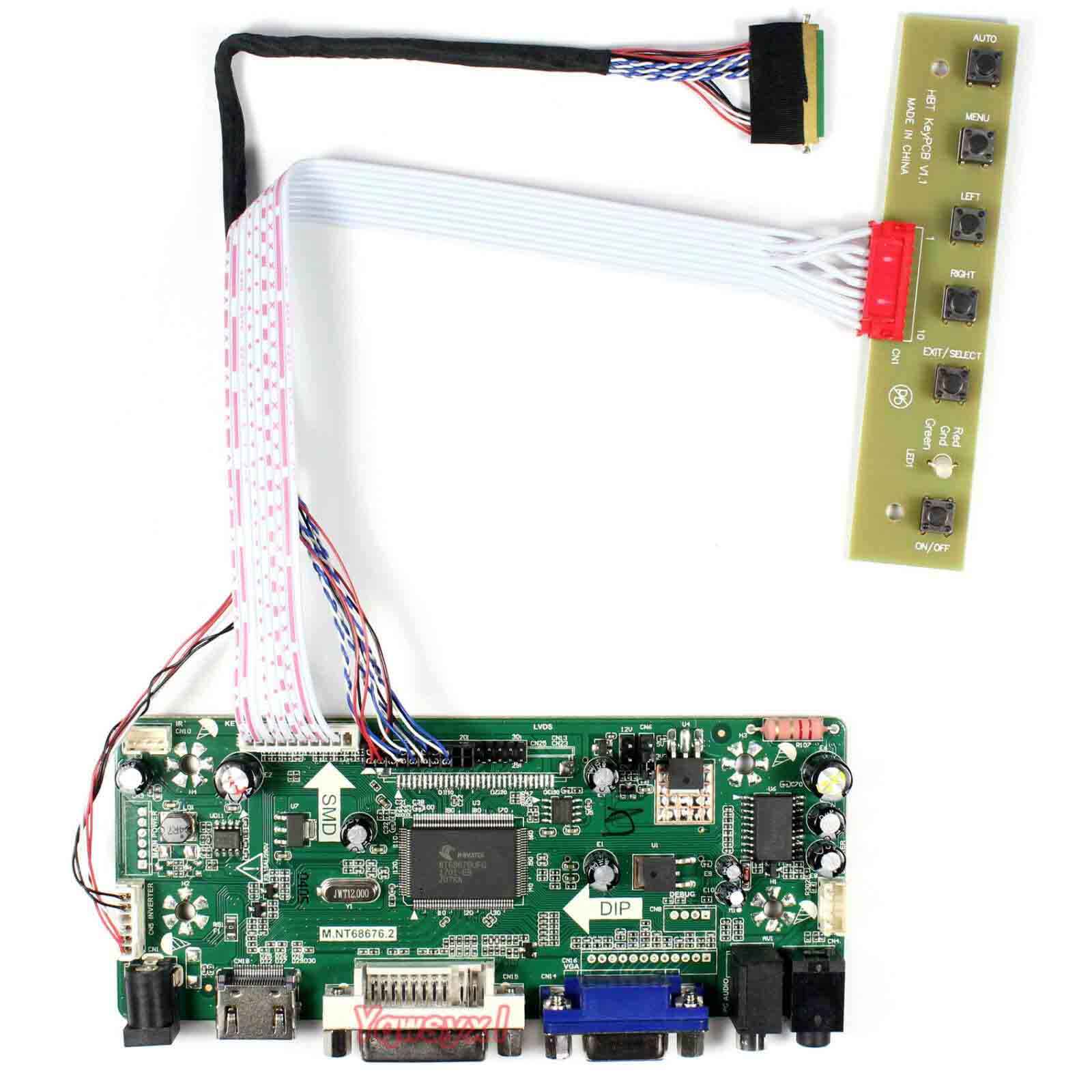

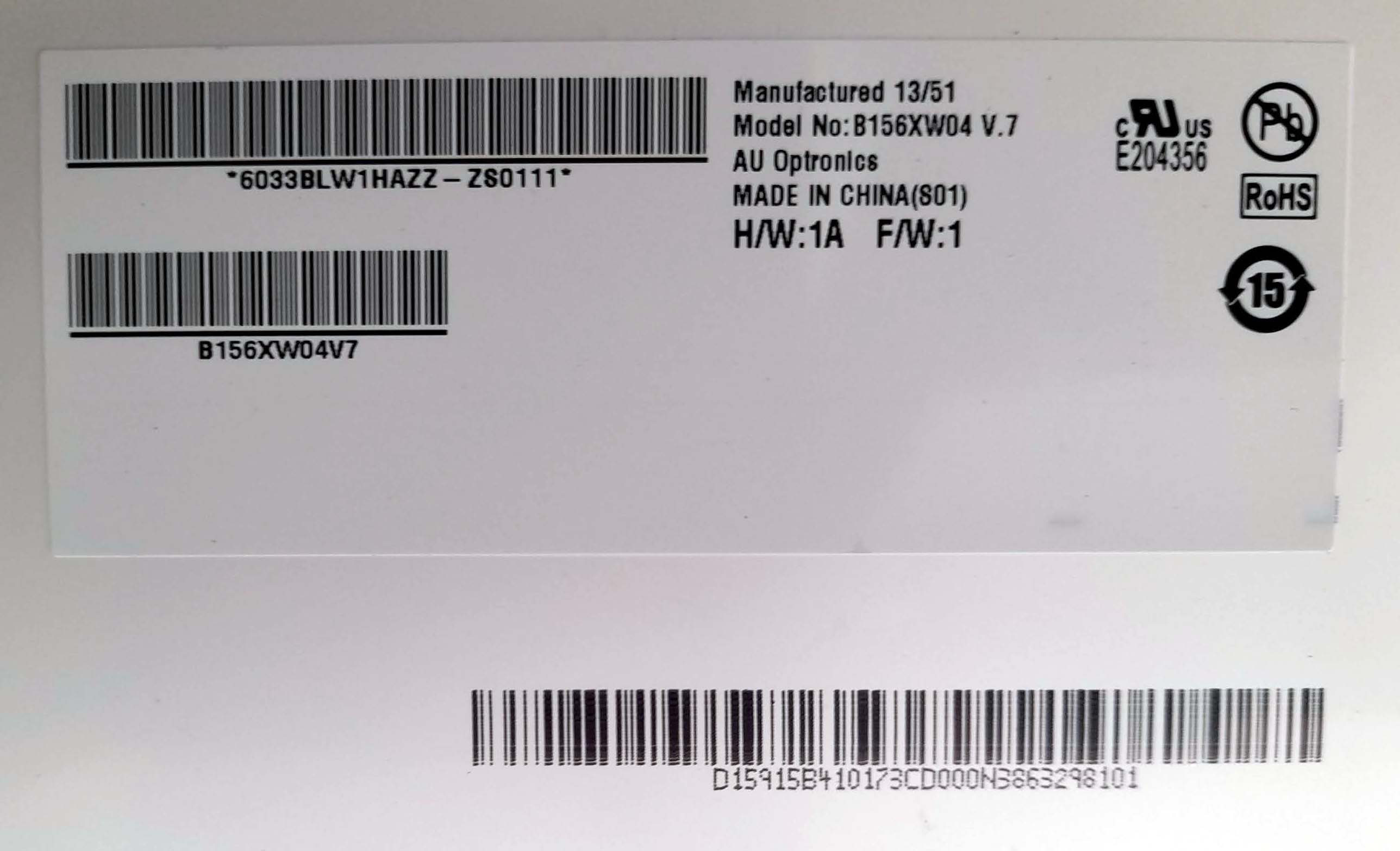

    I'm looking at reusing an old laptop screen with a controller board.
    Below is a picture of the screen and the link is to a controller board on Ebay.
    Does anyone have experience of doing this and could share a few words of guidance?
    One question: Does the power to the controller board provide illumination power for the screen?
    https://www.ebay.co.uk/itm/224299385461

    Re: Reusing an old laptop screen
    lcd or led ?

      Looks like the controller board also drives the backlight led, that's the separate (white) plug attached to the lvds cable

        I think it's a LCD with a LED back light.
          yes looks like a led lcd https://www.laptop-lcd-screen.co.uk/...5.6__35430.asp
          https://www.ebay.co.uk/itm/173951847017

            • 31247
            how do you program it?
            you have to tell these things the panel spec.
            some use jumpers - others use firmware uploads.
