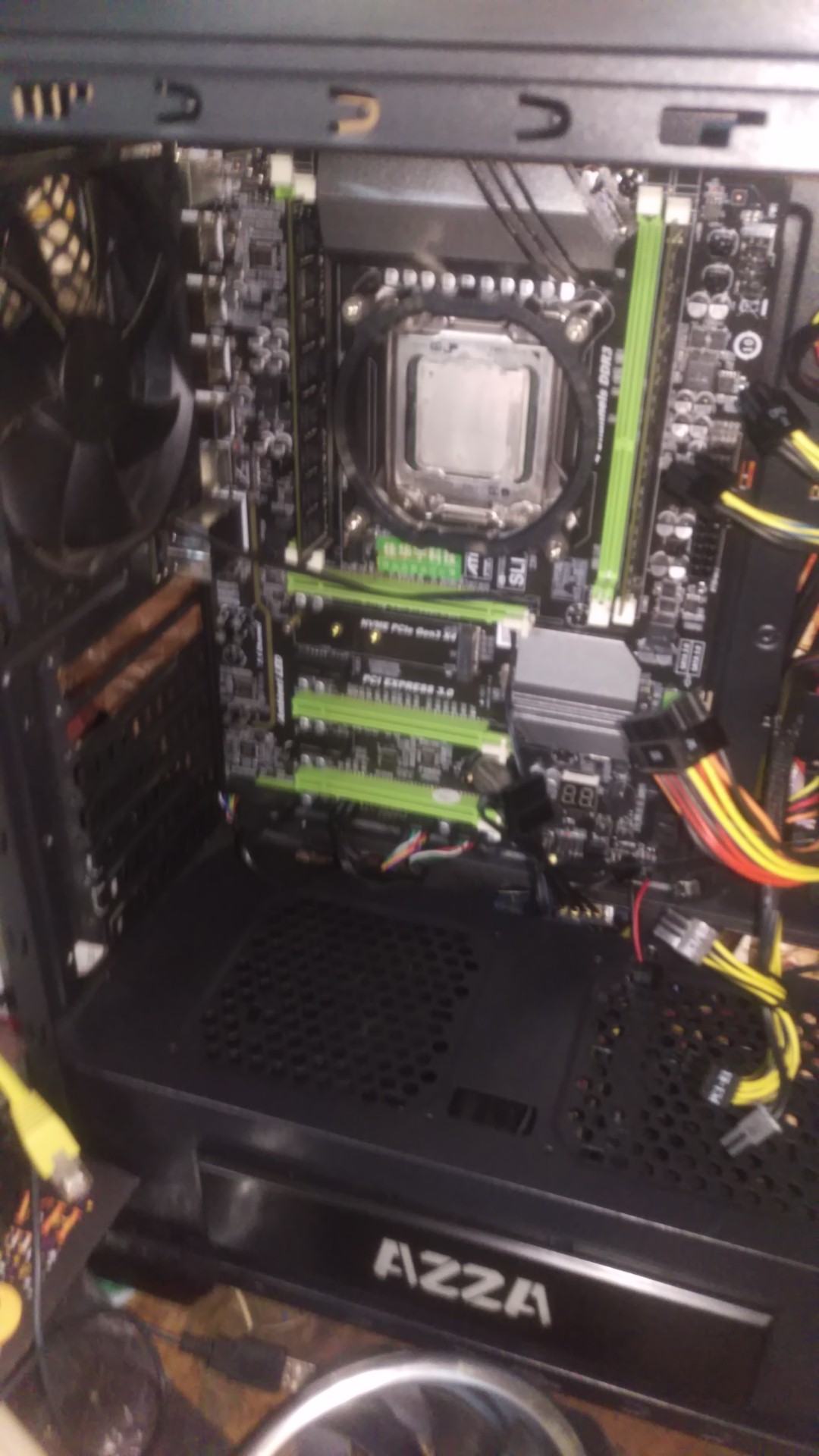

              Time for some crappy pics:
              Didn't get one of the case as a whole, but it's one of these:
              http://www.azza-tek.com/m/2010-1275-122655.php?Lang=en
              Specifically, the 250 version (3x USB 2.0, 1x USB 1.0).
              Feels cheap and flimsy. I've seen (and dealt with) worse (at least they fully hemmed any exposed sheet metal edges!).

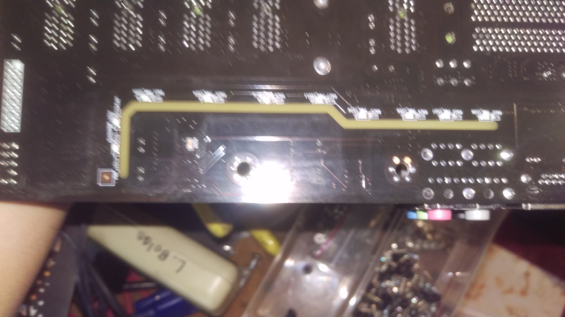

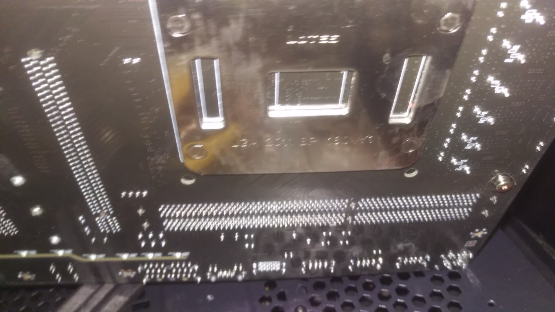

              Mobo before extraction:
              No brand name on the board, but is marked as "X79 turbo". Seems to be readily avialble on Aliexpress.

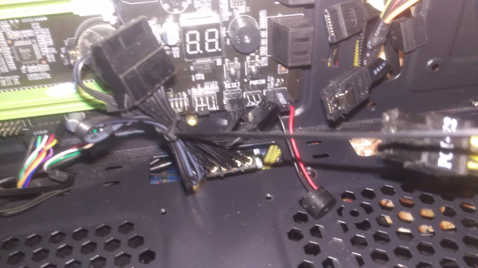

              Whoever built it wanted to be absolutely sure there'd be a working PC speaker:
              Blew money on that, but didn't invest any in a decent mobo???

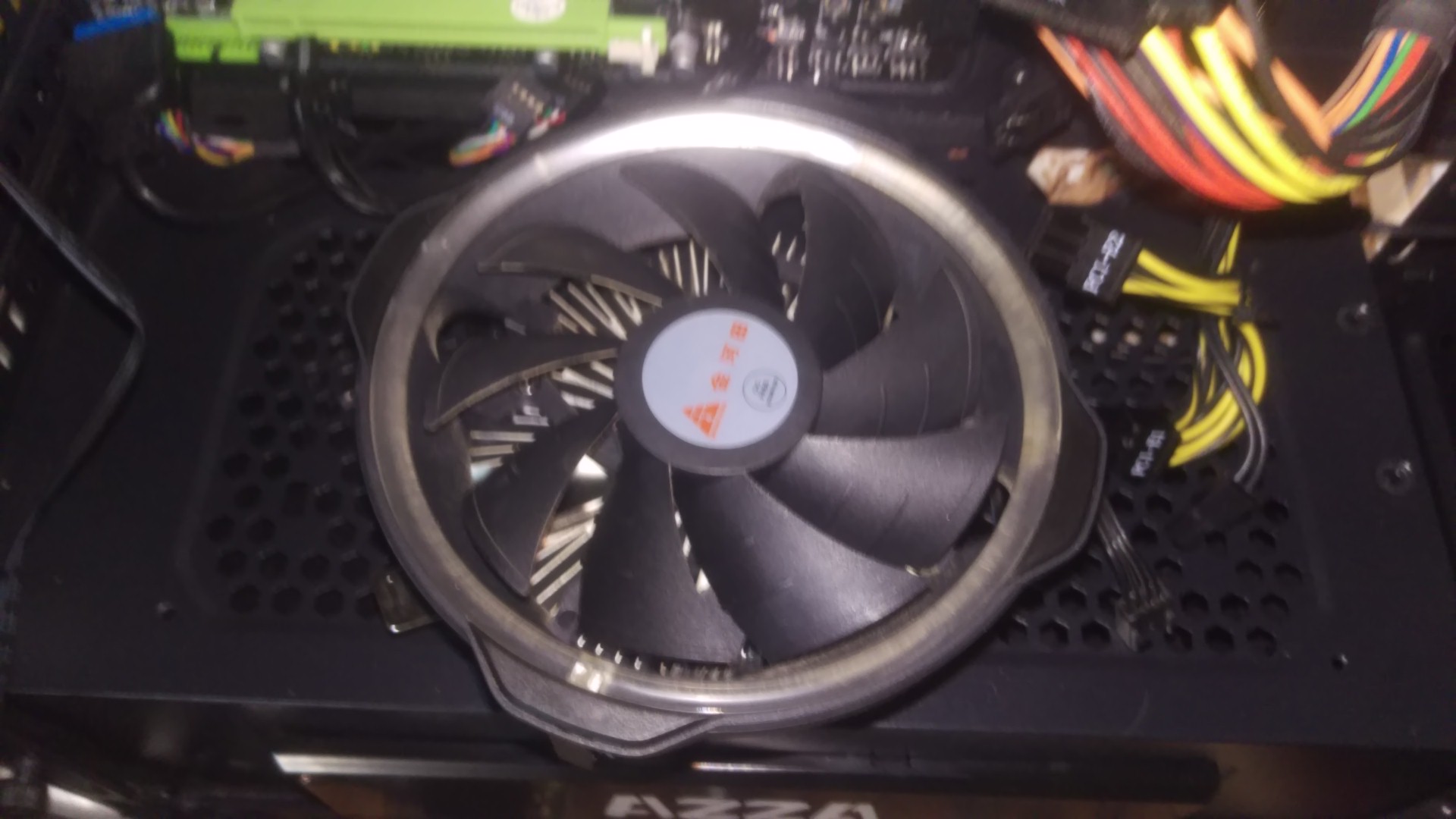

              Noname cooler:

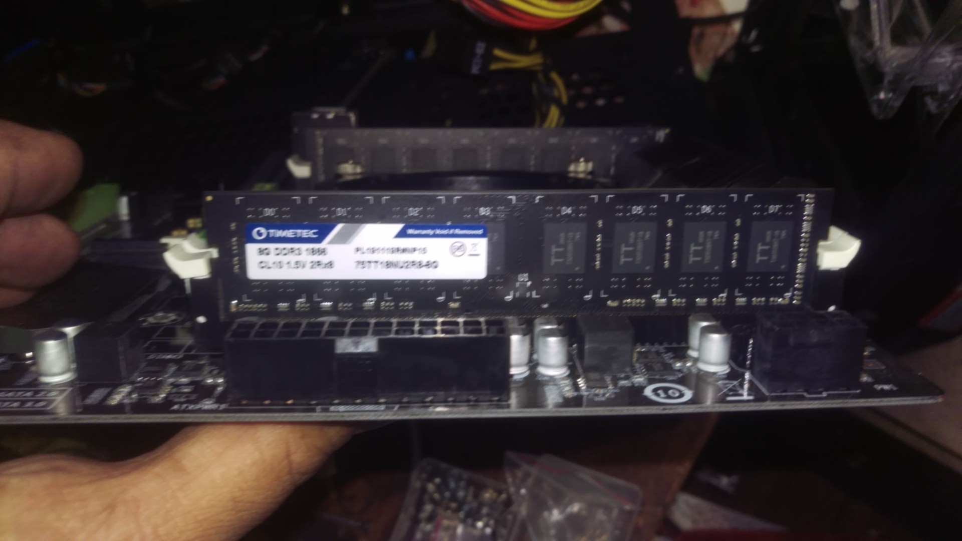

              Noname RAM to go with it:
              At least they used a brand name CPU socket:
              (as shown, it is indeed LGA 2011)
              I bench tested the board one last time... nada. no lights or activity.
              What I thought was an abnormally wide audio isolation slot is actually mobo bling bling... it's backlit!

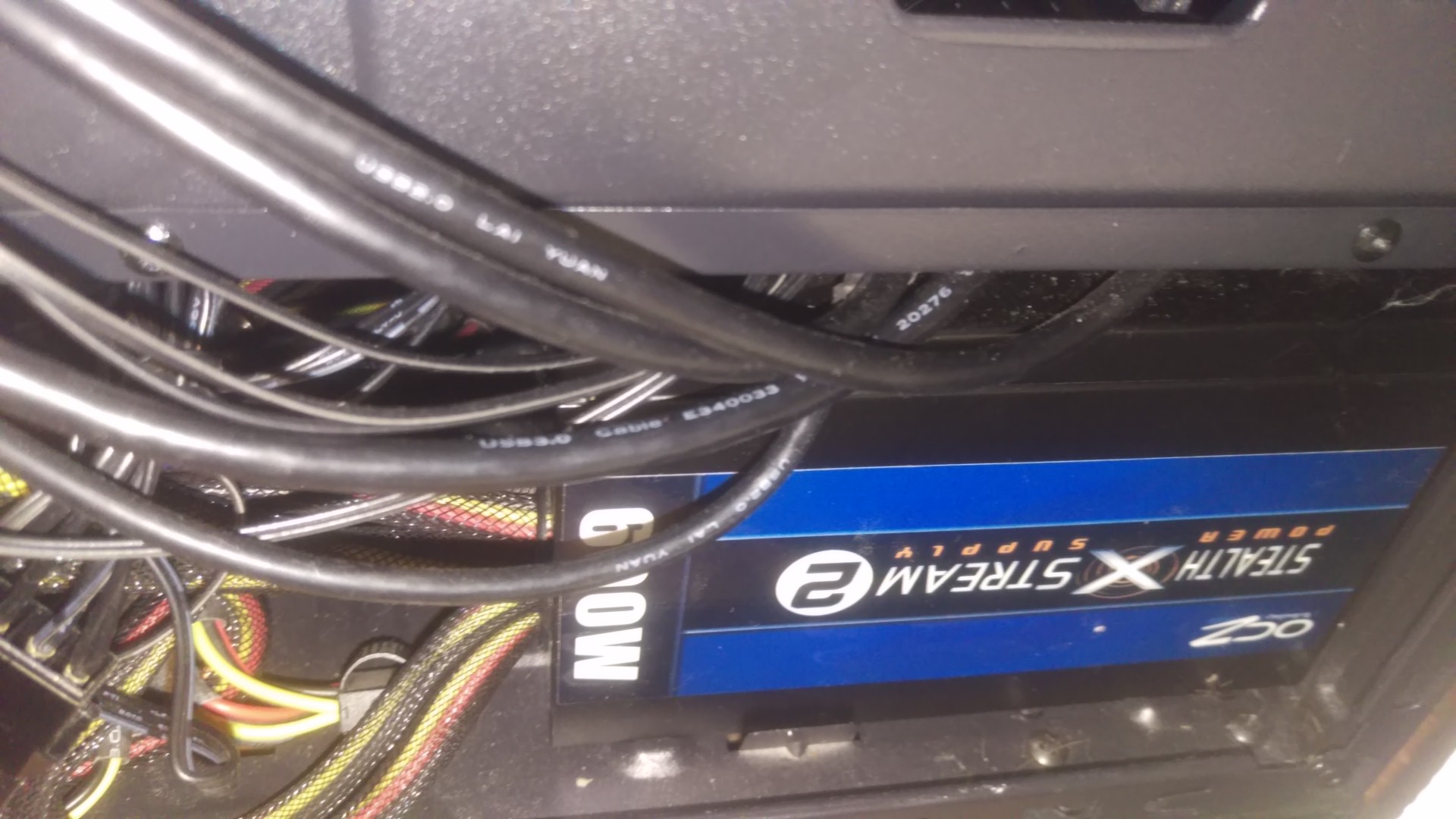

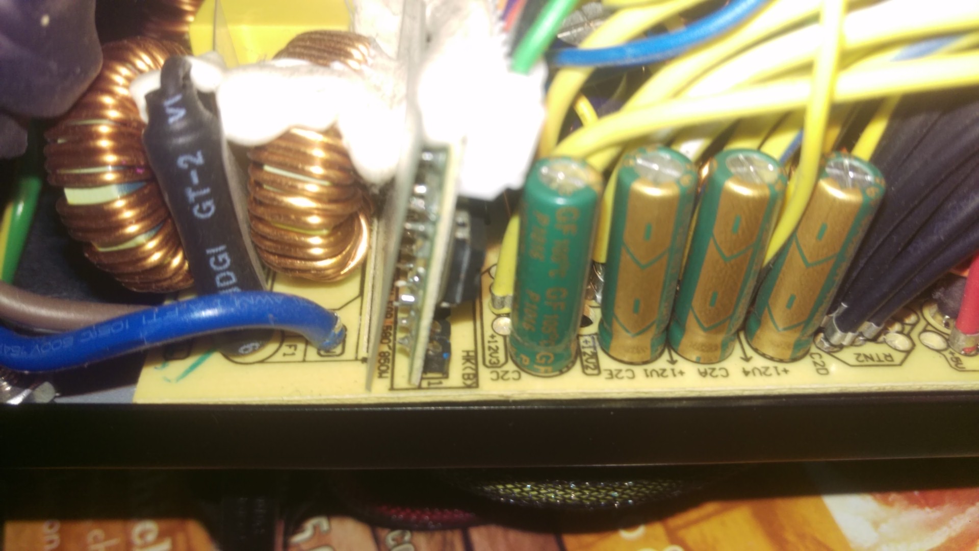

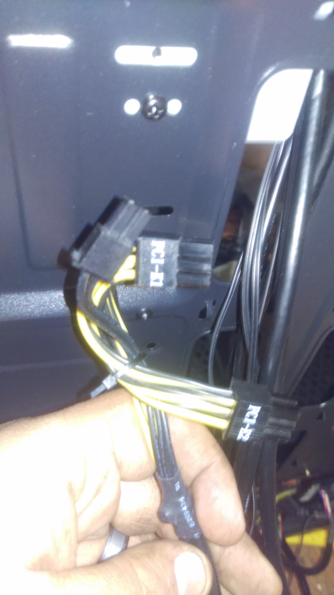

              Turns out the PSU is actually an OCZ, not a noname gutless wonder?
              Why I originally thought it had a noname gutless wonder was the use of jumper wires linking multiple GPU plugs together to save wire:
              Then again, it is an OCZ:

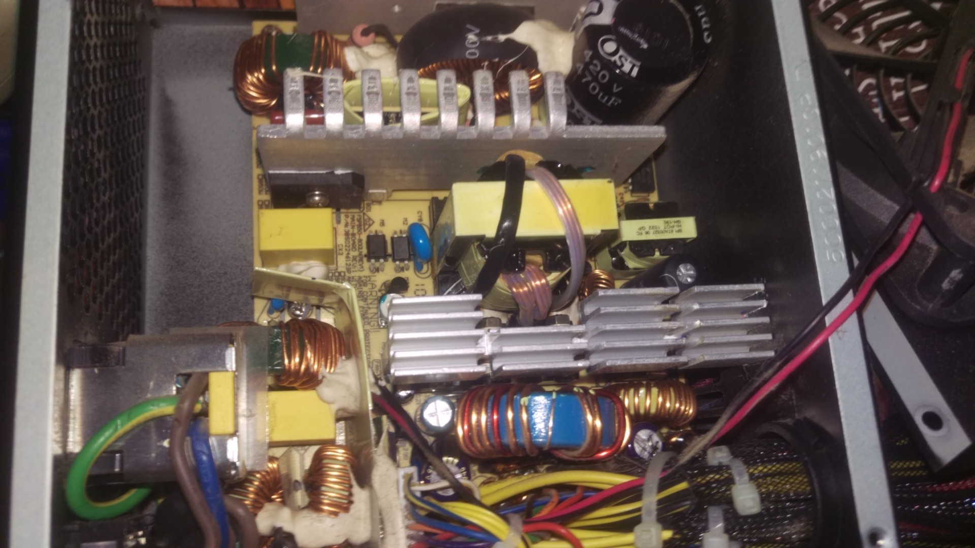

              ...full of Samxon GF caps:
              ...in impossible to replace skinny sizes. Now I remember why the two 800W OCZ's I have are still in the junk box in my parents basement
                Those two things are actually pretty common today. From your description, I thought it would have only two wires running to each connector and jumpers to the other pins. I saw that once on a cheap power supply.

                              Decided to look at the PSU closer... Those skinny caps are 6mm(ish) 470uf 16V Capxon's (Apparently they also make a GF series). Which, of course, literally nobody makes (at least on Digikey), let alone in a reputable brand rated for PSU usage and there isn't really room to go up in diameter. Thanks OCZ/FSP
                              I guess that makes the PSU scrap... Not sure it's worth the mess. Per a review I found, it dates back to 2008 (must have been NOS, the insides were very clean!), and was mainly praised for "value for cost"...
