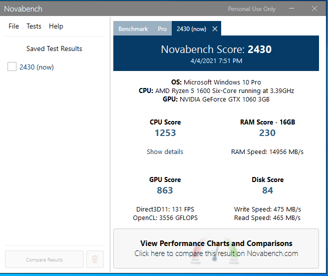

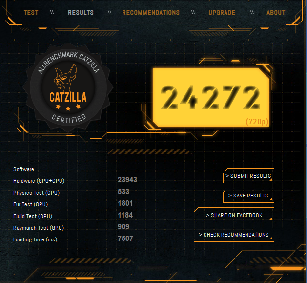

                                  Bought. Working on getting windows 7 to install (on the path to getting windows 10 running). AHCI driver bull puckey kicking my ass, but the system runs. edit- it's a USB3.0 driver issue... i'm sure AHCI is part of it too, but being a relative noob to newer systems, I haven't had this before.
                                  The PSU is better than advertised. 600W, I think it's a corsair?
                                    Quickly learning how USB support for windows 7 on these things is non-existent. Since it's a 300 series chipset, supposedly Crimson drivers will work. trying that... if not, I dunno.

                                        Which is what I was trying to do... miss the "7 as part of the road to 10" comment?
                                        Turns out AsRock had a .iso patcher for this... which I didnt' figure out until dicking with it for 3 hours (had installed with a PS/2 mouse/kb and a jerry rigged SATA DVD drive, but didn't work out).
                                        Installed and working. I have pics for later (too late, gotta drive home and get a bit of sleep before work). But I did benchmark the final setup. See attached.

                                          Poked around good old CL (which I forgot was still a thing), and among other "interesting" finds, I found this:
                                          https://cincinnati.craigslist.org/sy...296992170.html
                                          Not bad at all, especially considering the current situation with silicon shortages and whatnot. In fact, even those 1st gen Ryzen chips are very good performers. According to some tests I've looked up, it will stomp 6th and 7th gen i5 chips, and even better than most 7/8th gen i7s, IIRC. A dual-CPU Xeon setup with 2x mid-range Westmere 6-core CPUs will come somewhat close to this chip, but still not top it. So it's definitely good performance for the money there.
                                          With the GTX 1060, that should be pretty decent rig even today. Heck, you dad may be able to play even some of the latest AAA titles with lower settings, if he ever decided to go that route.
                                          The 600W PSU is probably overkill... but I guess it doesn't hurt to have it anyways. Otherwise, a system like that would happily run on a 350-watter, provided it's a modern(ish) PSU that has at least 22-24 Amps available on the 12V rail.
