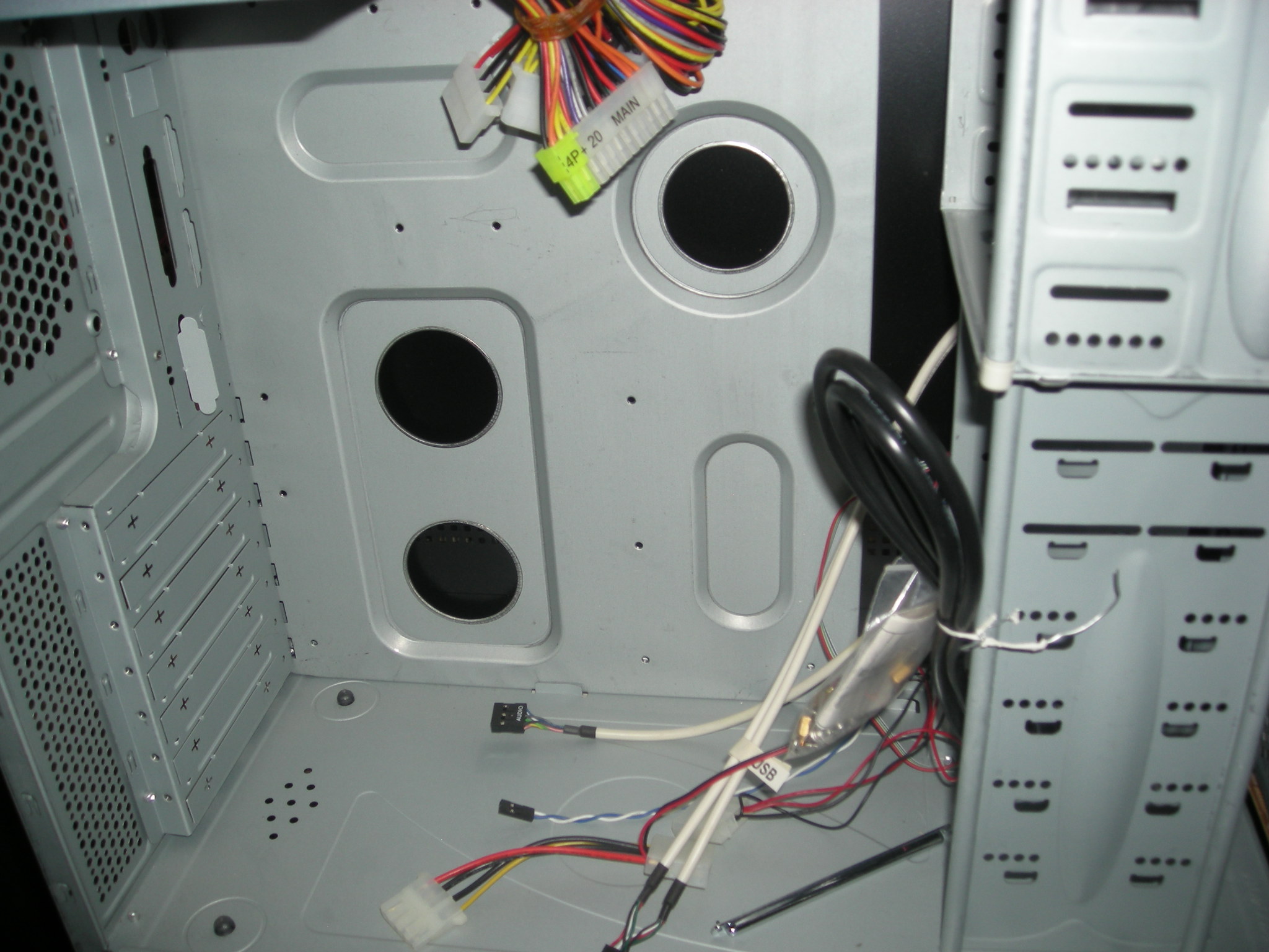

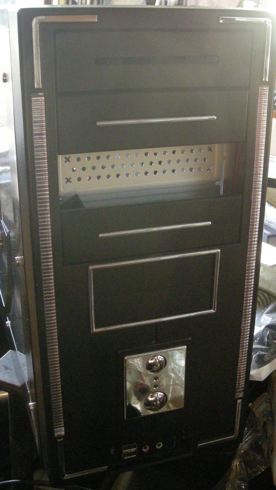

            Time for some crappy pics:
            Didn't get one of the case as a whole, but it's one of these:
            http://www.azza-tek.com/m/2010-1275-122655.php?Lang=en
            Specifically, the 250 version (3x USB 2.0, 1x USB 1.0).
            Feels cheap and flimsy. I've seen (and dealt with) worse (at least they fully hemmed any exposed sheet metal edges!).
            Typical modern case - cheap thins steel, but with enough bends and folds, it actually holds up OK for the most part. I still don't like them, though - especially because I'm tired of the all-black looks.

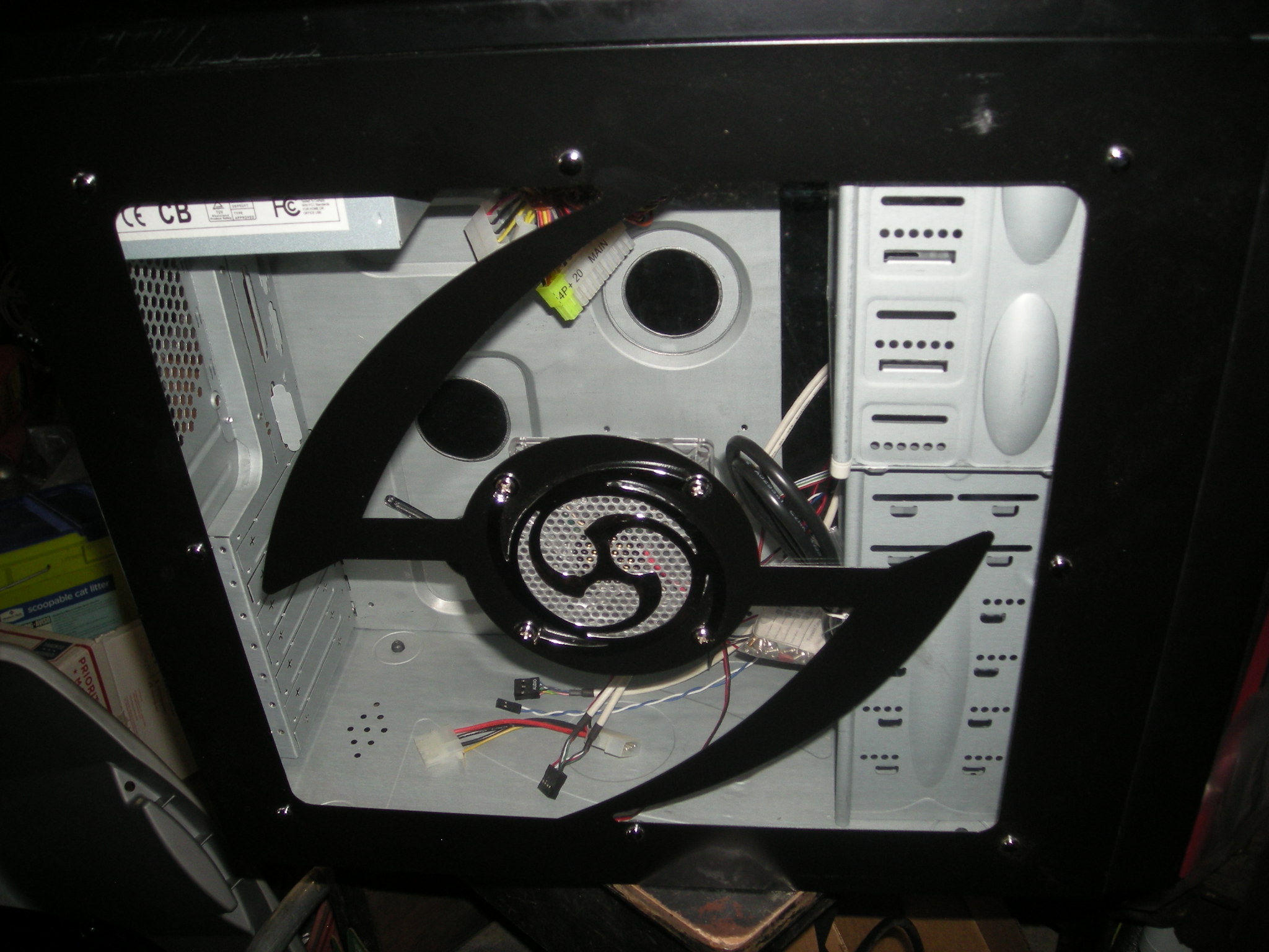

            What I thought was an abnormally wide audio isolation slot is actually mobo bling bling... it's backlit!
            https://www.badcaps.net/forum/attach...1&d=1614490287
            Welcome to modern day custom PCs... where it's all about form first and then function... like 2nd to last, with reliability being the last for sure.

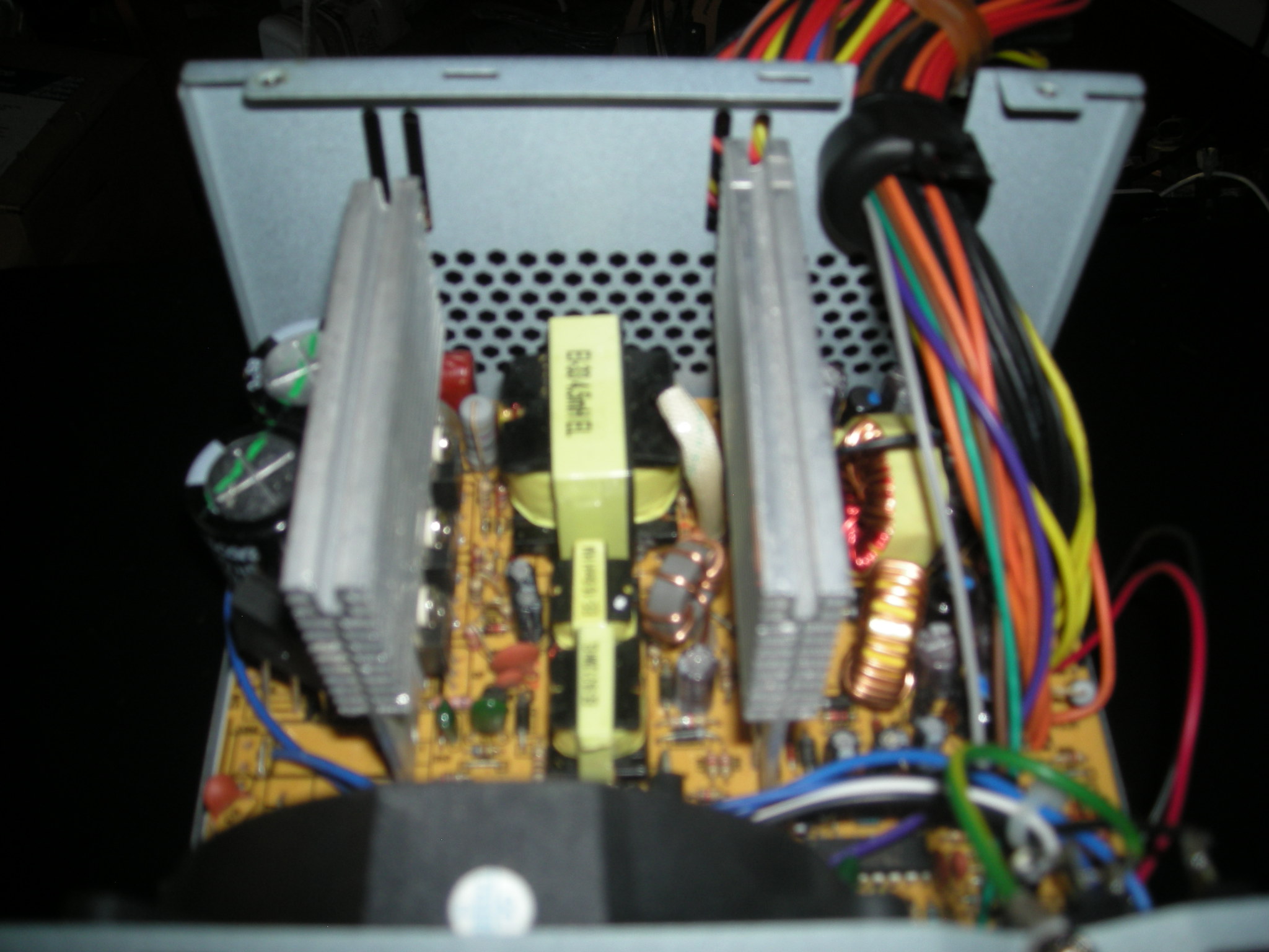

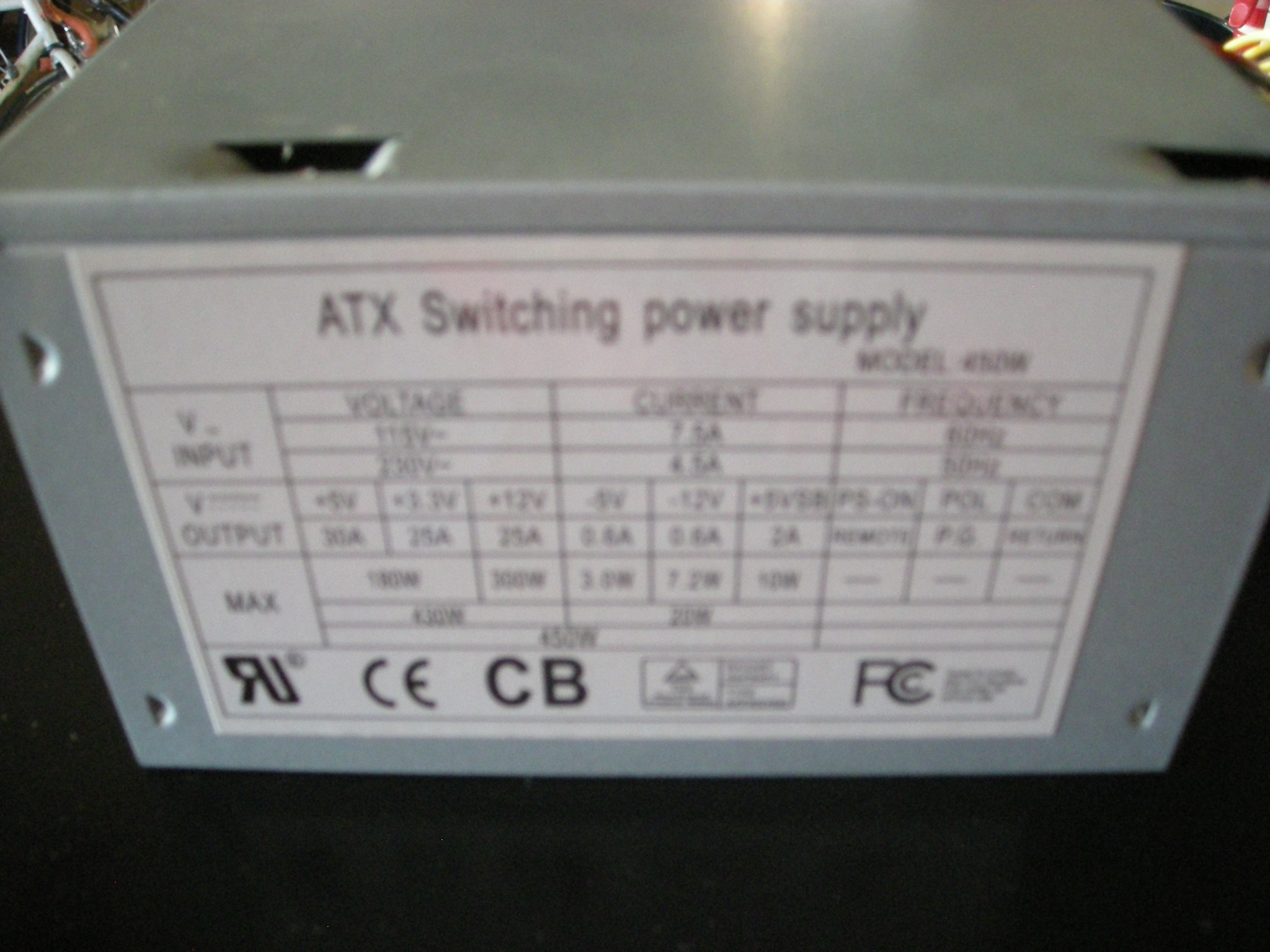

            ...in impossible to replace skinny sizes. Now I remember why the two 800W OCZ's I have are still in the junk box in my parents basement
            Looks like a Seasonic S12-II platform or similar.
            You can squeeze 10 mm caps on the output in place of those 8 mm ones if you raise them 3-4 mm off the board, which shouldn't be an issue here, as these are the last caps in the filter. The main filter for the 12V rail is that bigger 16V cap to the left of the main PS output inductor.
            Decided to look at the PSU closer... Those skinny caps are 6mm(ish) 470uf 16V Capxon's (Apparently they also make a GF series). Which, of course, literally nobody makes (at least on Digikey), let alone in a reputable brand rated for PSU usage and there isn't really room to go up in diameter. Thanks OCZ/FSP
            Check with Behemot, he might have some custom order for those FPS PSUs.
            But other than that... yeah, I hate PSUs that use skinny caps with no space for bigger ones.
            I guess that makes the PSU scrap...
            Well, not necessarily.
            Since none of the caps appear to be bad yet (you should always check, of course... though if the PSU is less than a few years old, you probably won't find any bad ones yet), you can use the PSU "as-is", but perhaps in some less-than-important PC until it croaks.
            Or, you could also try to do a partial recap for at least the caps that you can find substitutes for. Getting the 5VSB output caps replaced will generally be a huge improvement already, as those are usually the ones to go first. Anything more is bonus. And if you really don't like that idea, then do a full recap, but perhaps with smaller capacity caps that fit. As long as the drop in capacitance is only a level or two lower max, chances are the PSU won't care much... at least not if you don't load it to the max. Thus, even with smaller caps, if you "derate" the outputs accordingly, it should still be OK to use.
            So it's far from scrap, honestly. Just not a PSU I'd put on my "A-list". Better than this hunk of junk any day of the week!
