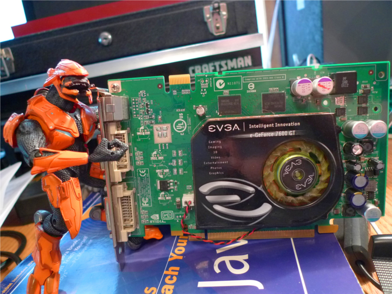

                    Re: EVGA 7600GT 256mb PCIe Poly Mod
                    Saw this thread when I first set up an account on badcaps and thought, "I have a dead 7600GT, maybe this will fix it!" But sadly looks like I have a very different revision, the factory beat me to the poly punch. Where fixing it is concerned, all the talk about these things dying isn't too inspiring either.
                    Fun needs a full tank of gas
                      master hoarder
                      • May 2008
                      • 12176
                      • Bulgaria
                      #30
                      Probably time to reflow the GPU, then. Tell that orange dude in the picture to use his superpowers to shoot some hot air on the GPU (or maybe just use a heat gun instead... or do an oven reflow ). May or may not fix your problem, though.
                          animal0307 had also just suggested an oven reflow over at overclock.net but last thing he tried it on epic failure. It was ram and I believe it went from getting errors in memtest to not being detected at all.
                          Oh man do I want a nice reflow station and soldering iron. I needed a new tip for my rat shack fire starter and of course they didn't have anything close to the right one.
                          @370forlife Don't mean to toot my own horn but, nice tut I wrote up before I was a member here; featuring your's truly
                          http://www.overclock.net/monitors-di...l#post12759917
                                    Personally, I don't recommend oven reflows because they are just way too ghetto and you can have components fall out of the PCB if you're not careful.
                                    But I guess it's still worth a try - better than a non-working video card anyways.
                                    A better alternative (IMO) would be a heat gun. If you don't mind cheap china made ones, you can get one for ~$20. I got mine for $18 from Micro Center. Then again, I got it to try a PS3 reflow, which I think was worth it even though it didn't work (I doubt this was my fault/reflowing technique though - some fly-by techinichian seems to have tried it before me... I know because there was thermal grease all over the motherboard, some of the screws were missing, and the BDROM connector was damaged). But anyways, I'm not quite sure a $20 heat gun would be worth it for a $20 (maybe?) video card. Perhaps for a learning experience.
                                    If you decide to do a reflow, though, get some liquid flux too. Increases the chance of the repair, and if it's successful, it will last longer too.
