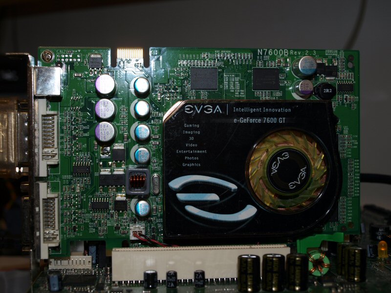

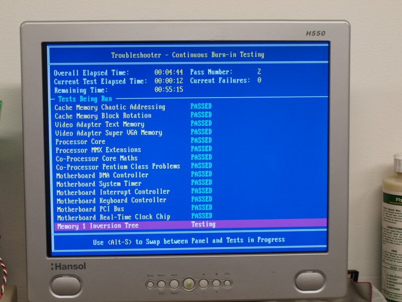

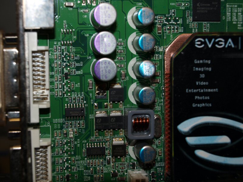

    Of that batch of 13 I got of these cards, I poly modded most of them. I recapped a couple in lytics, insured they were working properly, and then measured voltages to see what I could do as far as poly modding them. The pic below shows what voltage is on each, and what polies to use.
    These cards are drilled for both 3.5mm and 5mm lead spacing on all caps, so there was no cramming to make the 10mm polies fit in the positions for 8mm lytics, and visa versa with 8mm polies fitting into positions for 10mm lytics.
    Here's a few pics of the finished product:
    Good luck if you try this.

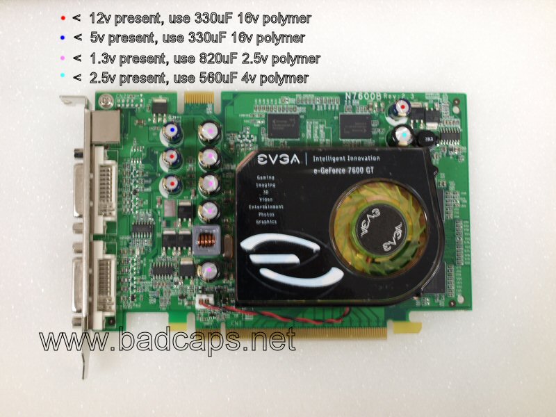

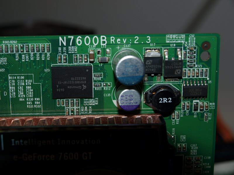

          on this card, 470uF 16v lytics were replaced with 330uF polies, and 1500uF 6.3v lytics were replaced with 820uF polies. The 560uF 4v poly went in place of a 1500uF lytic as well.

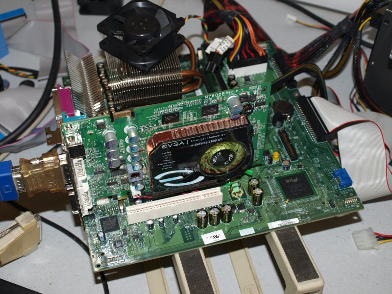

                  I dont blindly test this on customer's stuff either.....always do it to something of mine and then beat on it for a while. if successful, I'll recommend it as an option to those who ask.
                  I put one of these poly modded cards in a dell precision 670, been running without a hitch since I made this thread. haven't tried any overclocking experiments yet....but I will.
                            Any conversion between them? How do u know its ok with lower volt?

                              Why is it you use a lower uF on the poly's?
                              • ratdude747
                                Black Sheep
                                • Nov 2008
                                • 17136
                                Re: EVGA 7600GT 256mb PCIe Poly Mod
                                to maintain the right filtering. polys filter twice as well as lytics, so only have the value is needed.
