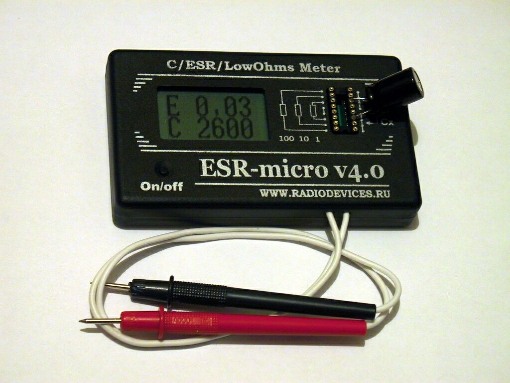

                      mike's email is on the bottom
                      http://preher-tech.com/esrmicro.aspx
                      also he's member of this forum, for example
                      https://www.badcaps.net/forum/showpo...3&postcount=71
                      there is a new version (esr micro 4.0..see attached image)
                      btw. did you just say you payed 25$ for 1000 pieces?
