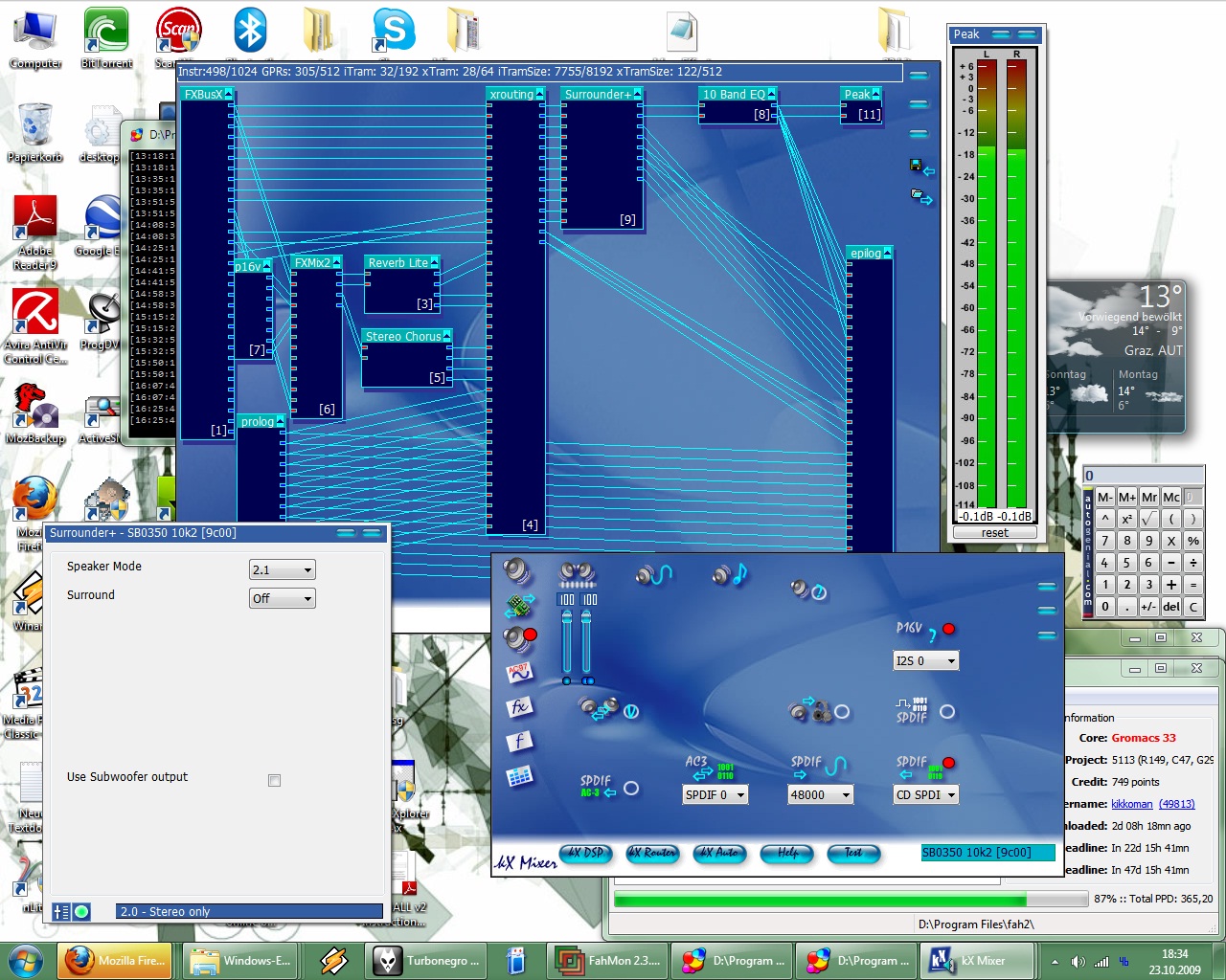

                  • kikkoman
                    • Jul 2007
                    • 691
                    #29
                    Re: Garbled audio
                    it's a driver package for EMU10k1 and 10k2-based cards that has been written completely from scratch.
                    the main advantage is the transparency and level of control you have over the DSP (compared to the Creative drivers) .
                    for instance you have full routing control over the I/O, plus a large database of addons and plugins that can be loaded into the DSP (and thus executed in hardware).
                    ASIO (which is far from reliable in the official drivers) is way better quality-wise IMHO than DirectSound even just for audio playback (and allows for ultra-low latencies if you need them).
                    for a good overview you should look into the official site:
                    http://kxproject.lugosoft.com/faq.php?language=en
                    (may be a bit outdated on some points, check the forums for the latest versions and updates).
                    as for EAX: one of the weaker points.
                    the drivers are not meant for gamers and EAX seems to be abitch to reverse engineer (besides legal issues) but i've used a 7.1 system with it for years and there were only two or three games (Assassin's Creed was the last one) that wouldn't work.
                    i've gone back to stereo a while ago and i don't regret it. spatialization is excellent with these drivers anyway, and the flexibility of the DSP outweighs the missing EAX by far.
                    besides that, surround sound (dolby, dts etc) work flawlessly.
