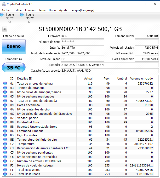

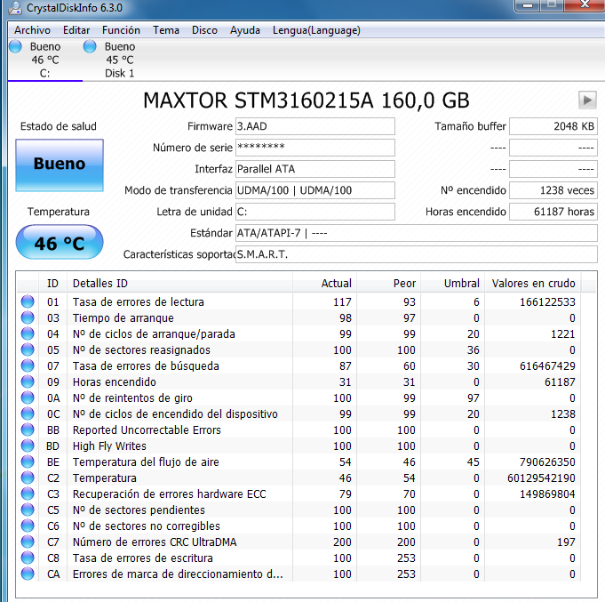

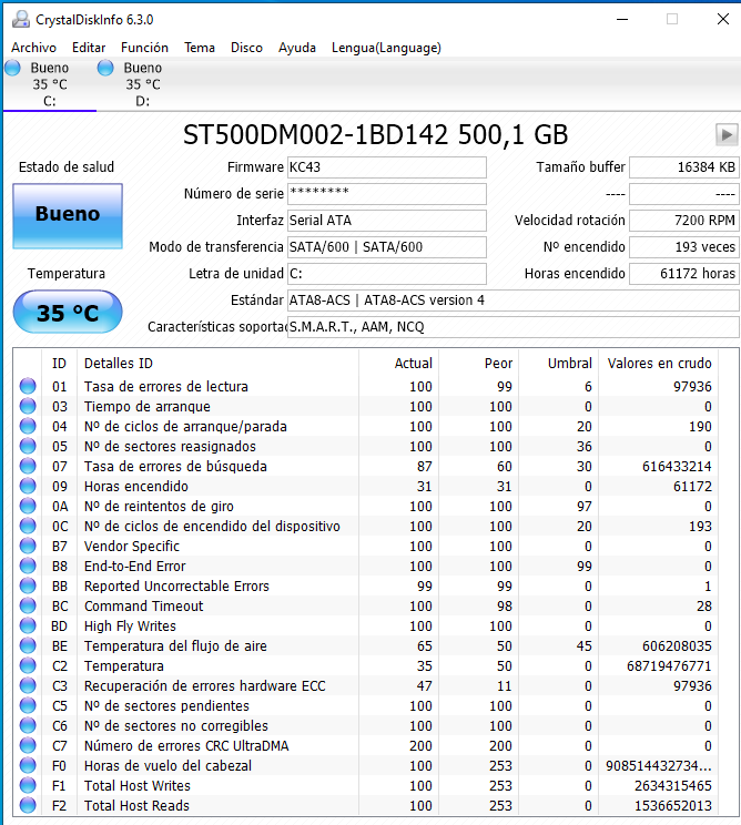

          Same - particularly with the Barracuda ATA IV/V and 7200.7 series. Some claim the 7200.9 are also very reliable, but I'm on the edge with that statement. The 7200.10 and later certainly weren't, though.
          The 7200.10 series are very reliable, although it also influences its useful life if it carries a quality power supply.
          I have had 7200.7, 7200.10, 7200.14 and they have not given me problems, even 7200.11 had the famous BSY bug and never affected it, I updated the firmware and it is about to reach 46,000h, although it has several reallocated sectors, but The HDD has always worked well.
          I leave these captures, of several seagates, one with 100,000h to withdraw, it was a 7200.7, then 2 7200.14, one with 61,000h and without any problem, I have Windows 10 pro installed on that hard disk, and it is placed on a fujitsu esprimo p420 computer e85 + I found and it goes great. It has very good health that even supports up to 117 MB / s in download by FTTH 1Gb.
          Then there are my 2 maxtors 7200.10 160GB ATA, one with 61,000h and another with 30,000h.

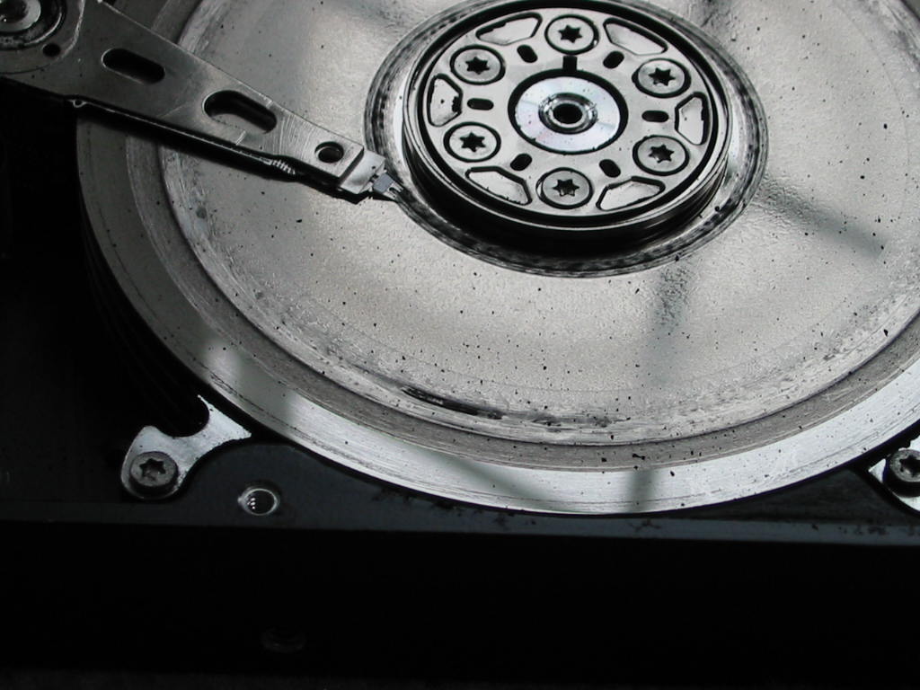

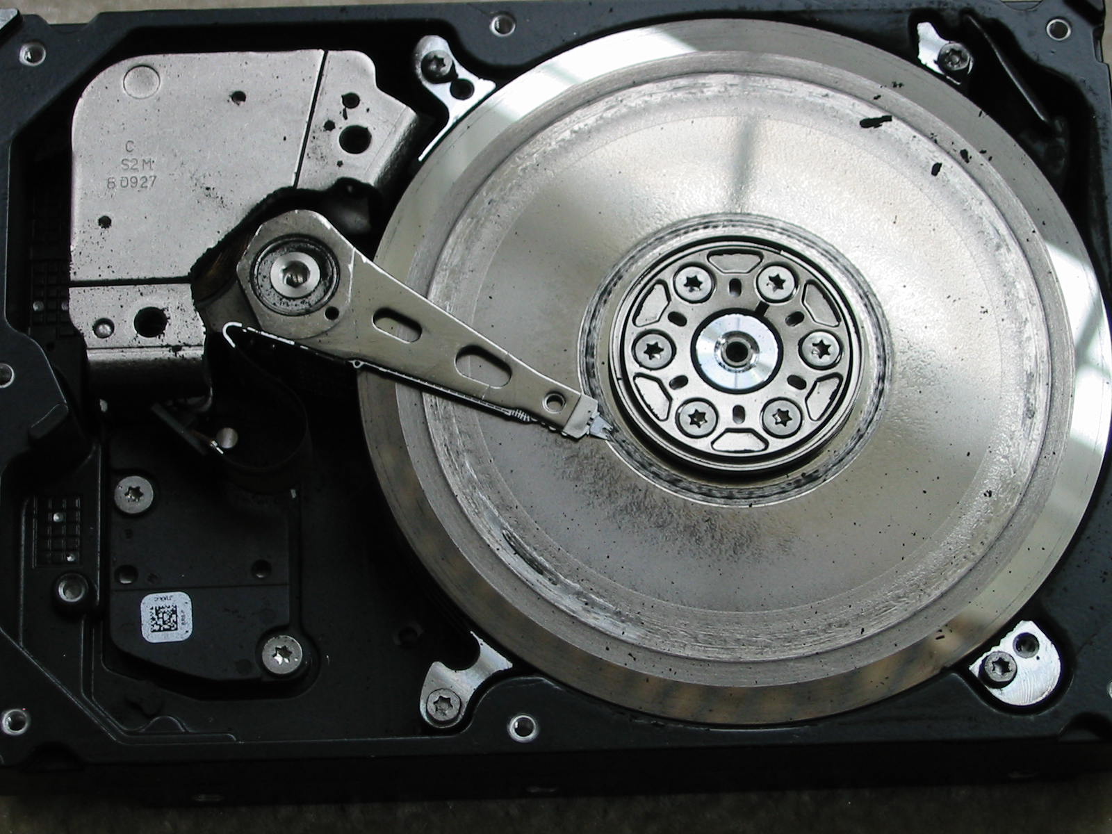

                                        I'm back with another colossal HDD failure.
                                        Same brand and model (Seagate 7200.11, model ST31500341AS.)
                                        This hard drive came from the same bin at work where I got the previously (badly) failed one. However, when I powered this one on my test PC, it actually sounded as if it's trying to seek / calibrate, and I could swear I almost heard it do it a few times. But after numerous power ups/downs and tries, while the HDD was running, all of a sudden I heard a loud clunk and the HDD jumped violently. After this, I heard the HDD try to spin back up, followed by that awful grinding noise again.
                                        What are the chances this one developed a head crash? Pretty HIGH! So without further thought I opened it up, and sure enough was greeted with the same mess again:
                                        Want the data back? I'm sorry, but you will have to pluck those magnetic bits off one by one from the head arm magnet and the filter:
                                        I think Seagate should write on the label of these HDDs "Certified Trash".
                                        I got several more 7200.10 and 7200.11 models from that same bin at work (though smaller capacities), and they all have various problems. Mostly bad sectors and slow reads. Not a single one over 50k hours, IIRC.
