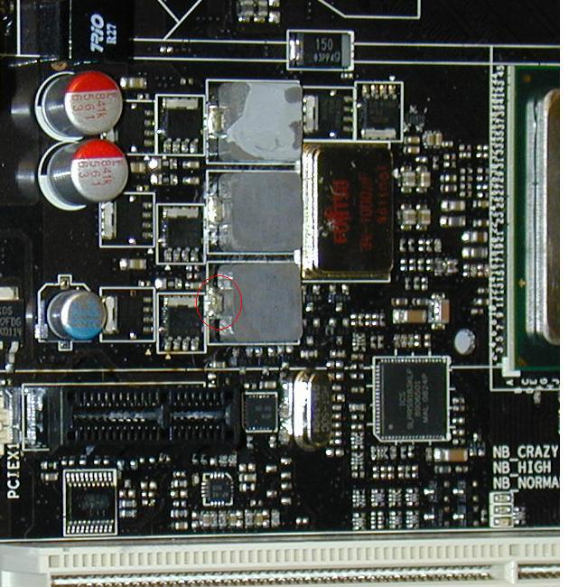

    Asus Rampage Extreme mainboard
    This main board is not working. I found a component lead that is broken off.
    Can you help identify the part and recommend replacement part numbers other info.
    With much effort I believe I can read:
    1R0
    830
    DAK
    Thanks.
    Here's a pic.

    Re: Identify part on Asus board
    I'm thinking it's a low profile inductor.
    • gg1978
      • Dec 2004
      • 431
      I'd agree with that assesment.. I believe the 1R0 means a 1.0 uH inductor. From the picture, i'm guessing that is right next to the x58 northbridge chipset?
        Quite interesting, what does that NB_NORMAL, NB_HIGH, and NB_CRAZY mean?
        • Wizard
          • Mar 2008
          • 2296
          Look again, there are 3 rows of LEDs, one LED for each line. NB means north bridge, and I think it have to do with overclocking a north bridge. This is 250-300 plus mainboard.
            I figured it had to do with those LED's and the North bridge being its right there. I like their use of the word crazy. Quite funny actually.
              Thanks, guys. Now to find a replacement and see if I can resurrect this nice board.
              It broke because the heatsink paste (gray wax base?) didn't let go when the board flexed a bit. It flexed cause UPS dropped it.
