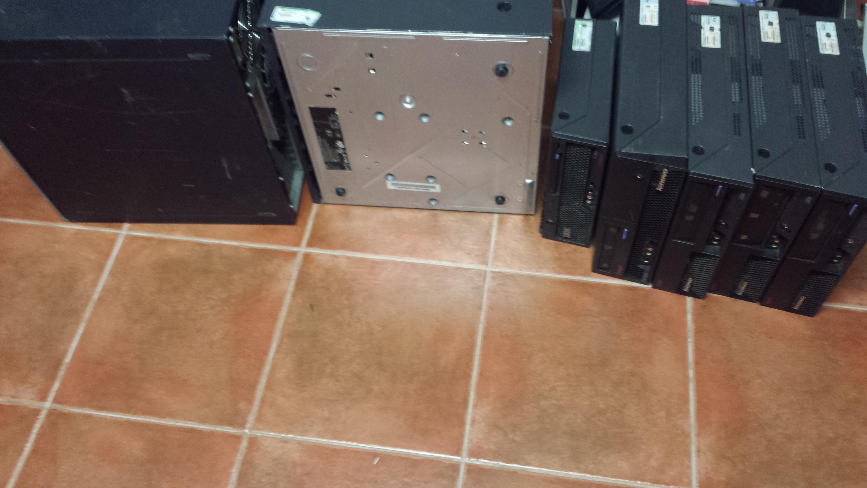

                        Yesterday picked up 7 computers scrapyard.
                        2 IBM (pentium 4) 5 lenovo (core 2 duo, pentium D), 1 HP (PENTIUM 4).
                        thinkcentre all had the bad capacitor, repair those that were better (others were in very poor condition motherboard) and repair 2 thinkcentre time, one with a core 2 duo, and one with a pentium d 930.
                        The core 2 duo, the voltage regulator of the ram had a capacitor bad and sometimes the computer is restarted a 6.3v sanyo 1800 microfarads, were two equal and Feds look 2 case for 2 Nippon Chemicon 16v 1800 microfarads.
                        PS: I am writing this from the thinkcentre core 2 duo hehe.

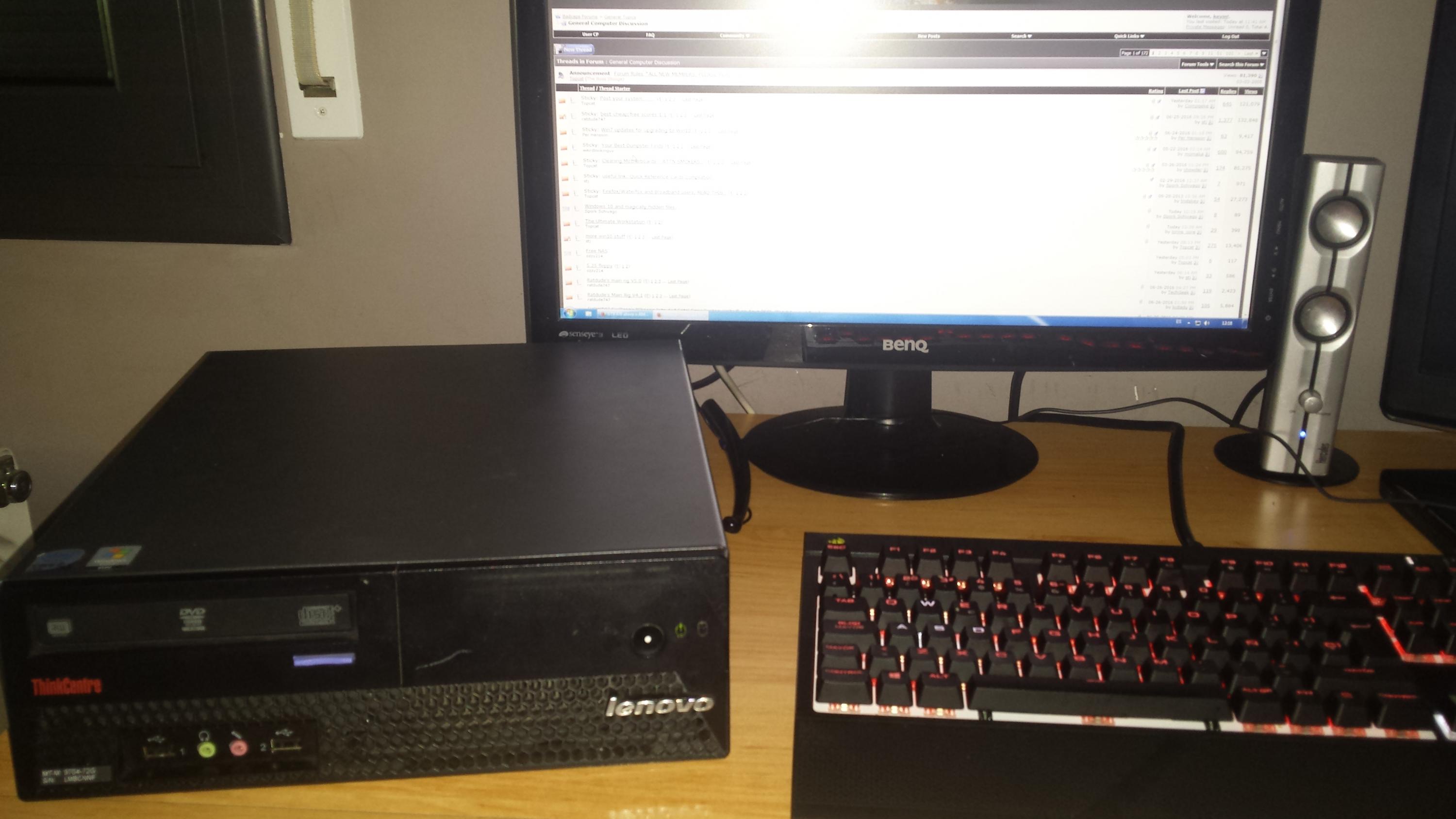

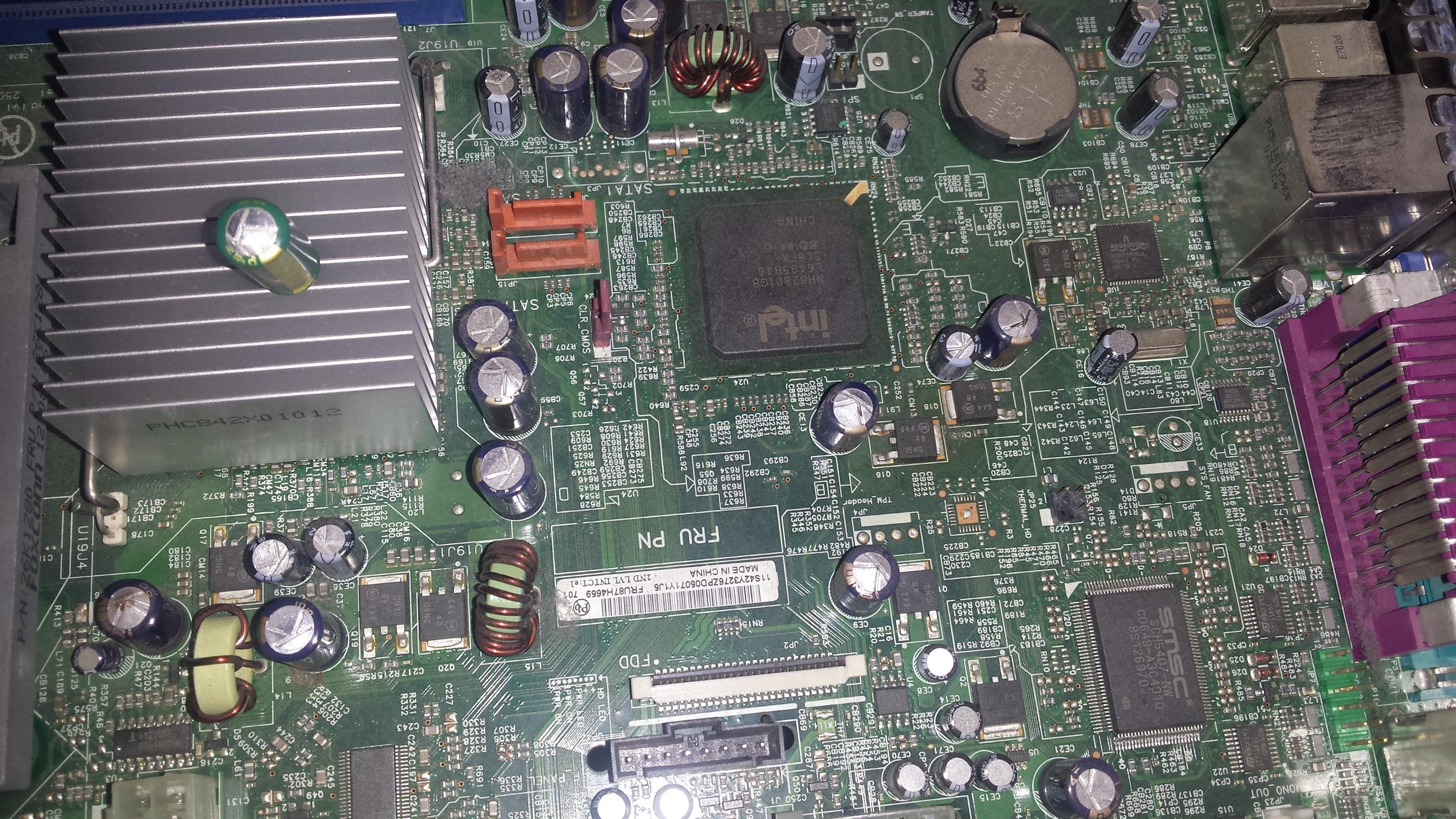

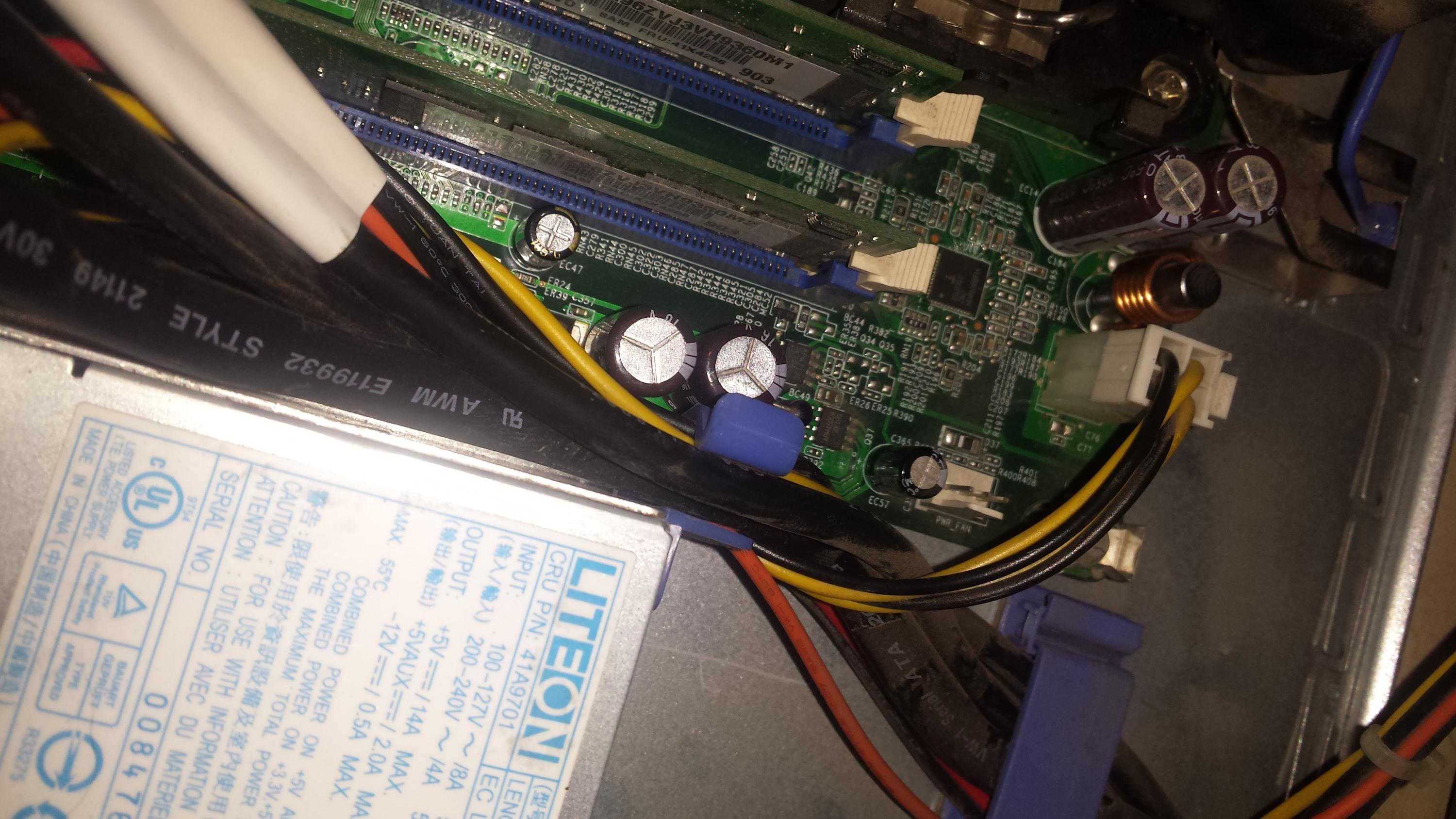

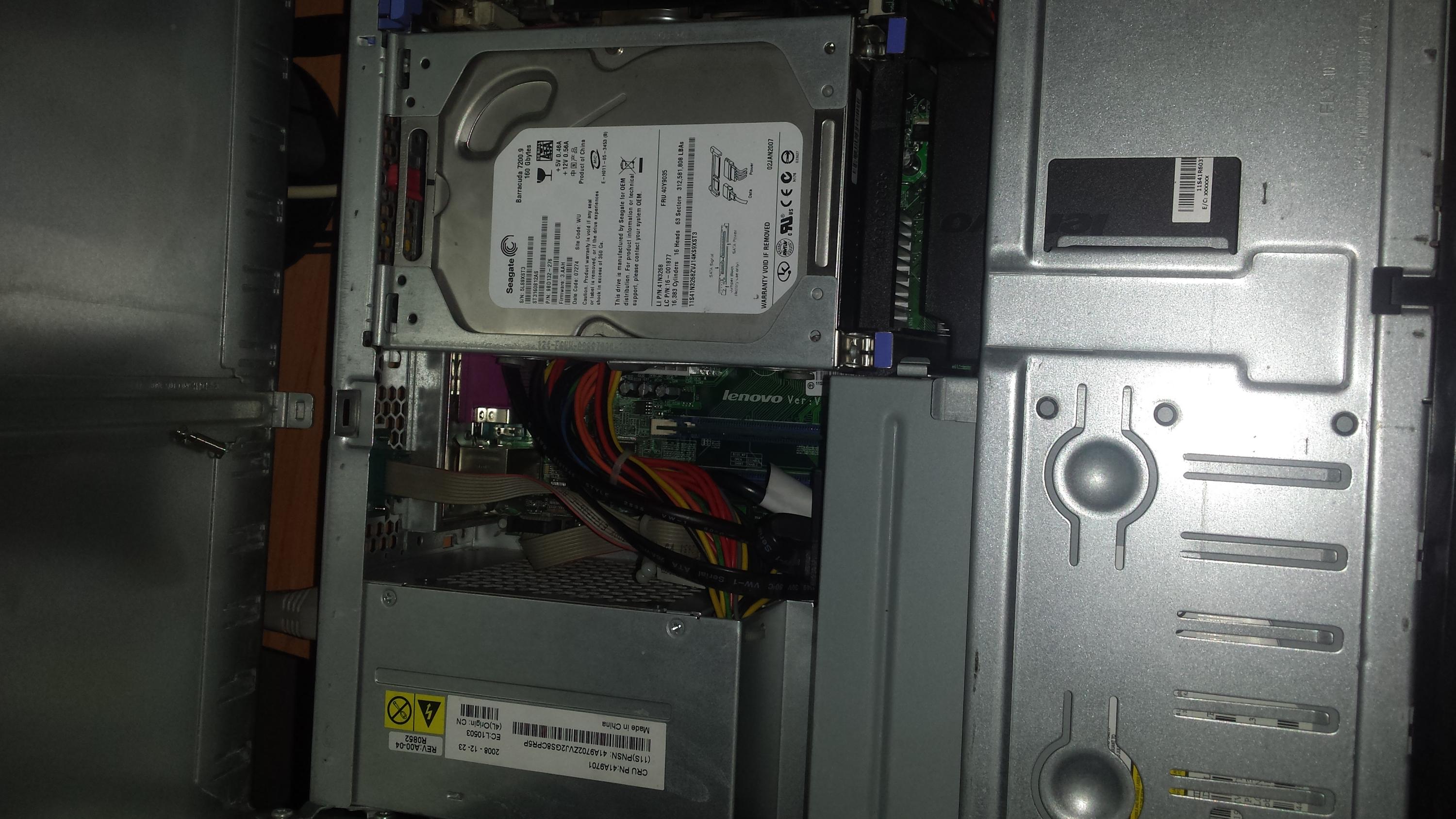

                                          #1980
                                          Re: Your Best Dumpster Finds
                                          A few days ago I picked up this:
                                          One is a core 2 duo (the best) only had to make 2 sanyo capacitors reccaping exploited by the heat.
                                          Go perfect!
                                          has:
                                          Core 2 duo e7200 (future upgrade Xeon 5430)
                                          ram: 2GB DDR2 (future upgrade 3GB ram)
                                          HDD 160GB
                                          GPU: Intel (upgraded to nvidia 610)
                                          What impressed me most about this computer is that it has integrated a speaker LOL
                                          The others are Pentium D, The others are Pentium D, 1 Pentium 4, I was able to recover 2 (Pentium D) more, also had bad capacitors.

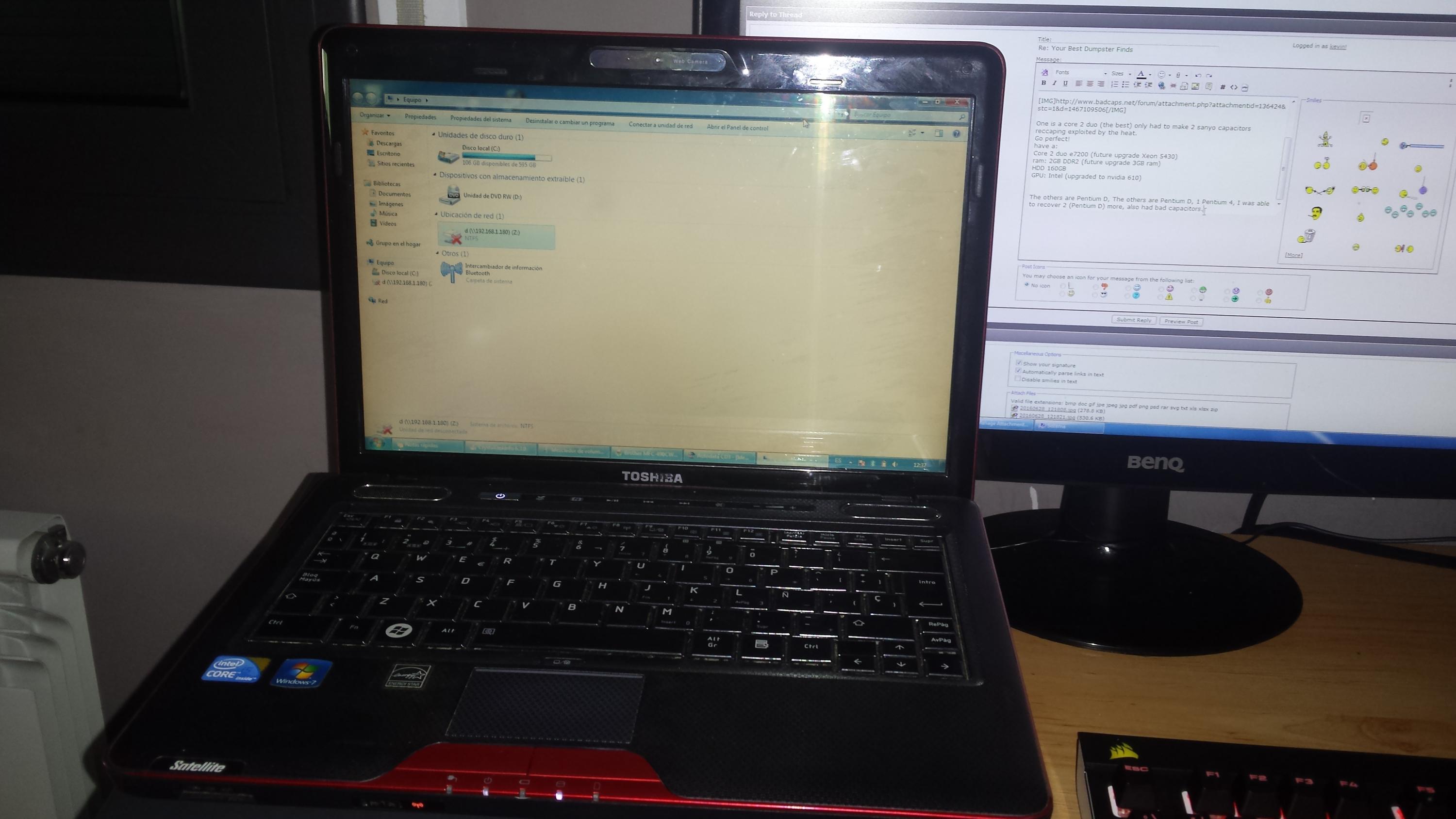

                                          Then I gave this brand new Toshiba U500 a great friend, had overheating problems, and the problem was needed is a thin heating pad and thermal grease quality, and now works perfect.
                                          has:
                                          Intel core i5 450m
                                          310 Nvidia 512MB (MXM Slot)
                                          4GB ram
                                          640GB HDD.
