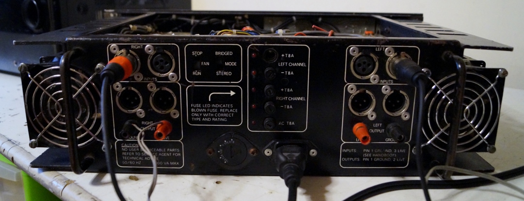

    Thanks, How come one input is female and one a male?
    The cable I linked to above Is 3.5mm to dual male xlr, wil the this work or will I need one with one female and male?

      You only need the 3.5mm to male. The male and female is usually used to hook the male for input (yellow) and output that same signal over female (magenta) to another amp or whatnot rather than using a bunch of runs from the source.
      Another reason would be for some odd setup that uses the inverse connections although that's fairly uncommon, usually would be doing something like hooking a microphone right into the amp bypassing a mixer or anything.

        Ta, could this amp be used as a power amp for a home theatre system powering a passive sub? I've just got a 7.1 hk amp and can use the b&o sub with it.
        So from hk pre out out to this power amp.

          That'd work. Big thing I'd do first is give it a good cleaning and get some output fuses. Do initial testing with sacrificial speakers and check dc offset.
          As for fuses, I don't see any markings stating what they are and a quick search doesn't pull anything up. Being a 500W amp I'd take a guess and say it originally used 250V, 2.5A fuses. I'd do more research and check to see if you can find what the originals were.

            It says T8A next to the fuse slots and original ones in there are T 8Amp Ceramic Fuses. There is one normal fuse in there too but that looks like a replacement and the should again be a ceramic one.

              So measured DC offset and getting 33mv on right channel and -20mv on left channel
              Is this within tolerance or is the 33mv too high?

                20 and 33 are fine, I'd be worried if it was above 50 myself. If it were above 100 you'd have to worry about it tripping into protection and sounding like crap.

                  Having some trouble getting a signal into this amp. Not getting any sound from speakers aside from the gentle buzz on power up. I think its something to do with how I'm connecting it rather than a problem with amp.
                  So this is how I have it wired up
                  3.5mm out from PC
                  to XLR Right Amp input and XLR Left Amp input
                  One speaker on right channel
                  Reading the pinout on the amp XLR inputs it says Pin 1 = Ground & Pin 3 = Live
                  Doing a continuity test pin out on the 3.5mm to Dual XLR is
                  • Red XLR Pin 2 = Tip of 3.5mm Left / Pin 3 & 1 = Ground or base of 3.5mm
                  • Black XLR Pin 2 = Middle of 3.5mm Right / Pin 3 & 1 = Ground or base of 3.5mm
                  Is that how it should be or something up here?

                    The 3.5mm XLR connector wiring is
                    pin 3 + 1 + shield are bridged ground

                      Check the left channel.

                        Yep was the way it was wired, from a quick google apparently some british amp manufacturers wired up their XLR connectors differently than normal.
                        So wired up the 3.5mm to dual xlr so right and left channels to pin 3 on each connector and ground to pin 1 (bridged with the shield) pin2 blank
                        and is working.
                        BUT
                        The right channel (which has the higher DC offset) seems to have static. When i mute audio from source and turn volume up on amp there is static cracly noise coming through speaker.

                          Do you have a schematic for it? Leaky caps in the RT channel output section can cause that symptom and account for the higher DC offset voltage at the speaker output.

                            I might be going loopy but it sounds like its picking up something like interference and the static has a beat to it? It does it for a few seconds then stops, then does it again and stops etc
                            Could a dirty pot cause it?
                            I think I do have a schematic, see attached

                              DC Offset rises to and levels off at +40mv, left channel is negative -20mv

                                Ok the right channel volume control pot is definitely scratchy and it feels gritty too. Not as smooth as the other. Up until about half way its just scratchy once I go past half way I get the static playing through speakers.
                                Tried some contact cleaner followed by switch cleaner but no luck.
