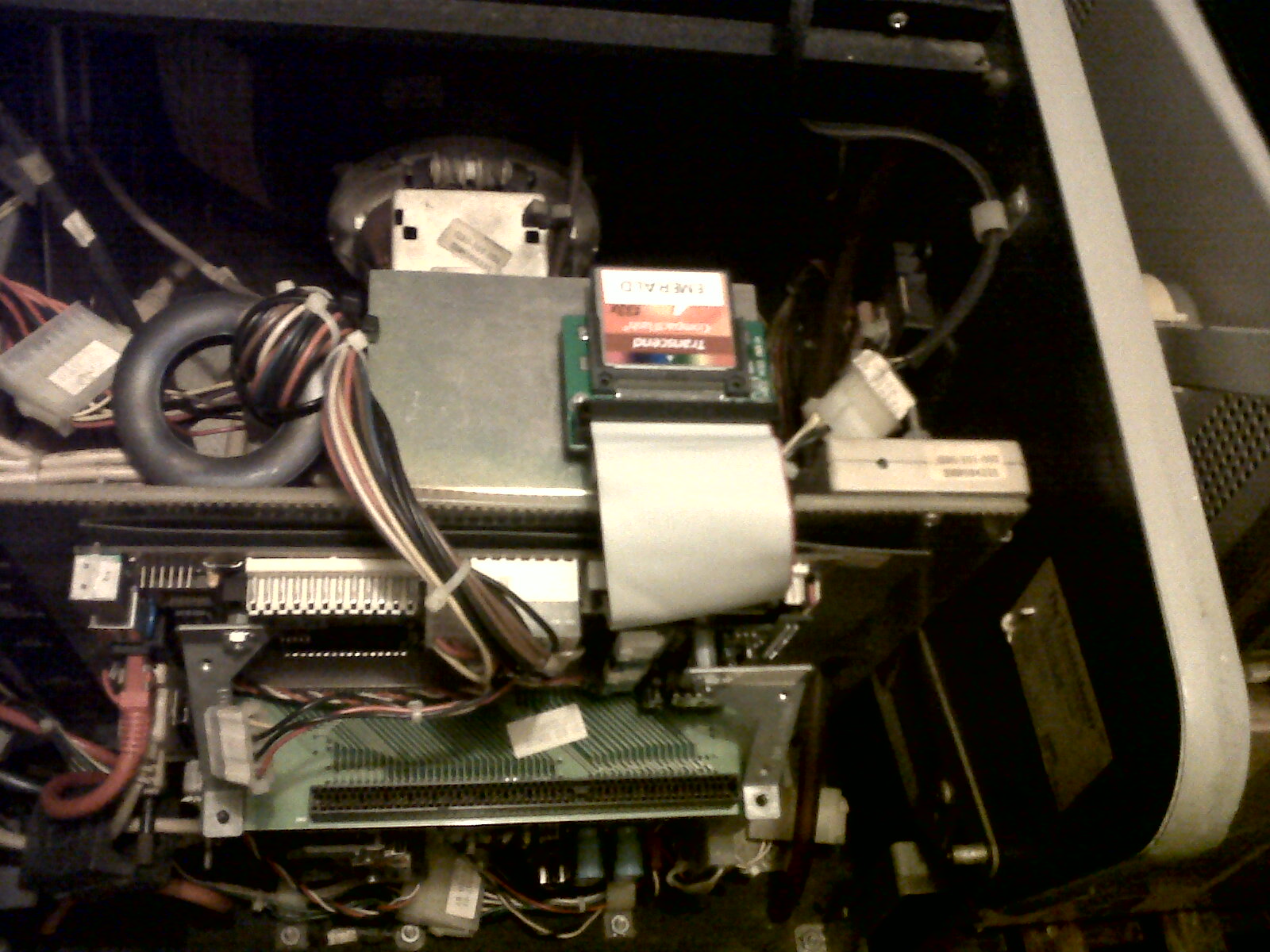

      Originally posted by xelectech
      stj:
      >if you need any info or manuals - just ask.
      >i may want a file or 2 from the harddrive in the future btw.
      Thanks, much appreciated, so far i have about 24 MBs of pdfs and info files.
      The motherboard only has 64Meg of memory installed so I've not yet been able
      to run any newer programs to get a look at what's on the HD. With it installed in another machine I briefly tried using clonezilla and boot it next generation to back it up, with no success. I think I tried Part Ed 3.0 as well, at least got a look at the partitions with that, not sure all the disk space was accounted for there.
      It would surely provide some peace of mind if one could transfer the system onto a newer HD; since it's the only maxx HD I have was kind of leery of trying too hard, and am wondering if getting another stick of memory for it would help with getting into the HD files via the Unicorn MB.
      How 'bout you, any success on that front? What kind of maxx machine(s) have you got?
      i'v got the same one as you pretty much.
      a maxx classic with unicorn board.
      i hacked the fuck out of the software, i have Emerald (older than yours) running from a compact-flash card.
      if you get a spare harddrive, sata is fine with an adapter, or a cf-card & adaptor.
      minimum size 8gig
      then download this:

          the maxx software was in 2 versions.
          upto and including Emerald, it was based on DOS and needed a quantum-fireball harddrive.
          after emerald it was based on Linux and should run on anything.
          the first link - msi file is a downloader you install on a windows pc.
          the second link is for a bunch of tiny files that tell the loader what to download from merit.
          the loader should download 4 iso files - these are your re-install discs.
          once you have them, hook your replacement harddrive or cf-card to the megatouch, along with a cd/dvd drive to the second ide port.
          plug a ps2 keyboard in and boot the system up - it may run the cd, if not you need o change boot priority in the bios to boot cd first before the hd.
          once it boots the cd - just follow the instructions on the screen.

              • xelectech
                retired tech
                • Nov 2014
                • 238
                #1607
                Looks like a nice fit - what size card is that?
                Have you figured any use for the usb capability of the mb?
                I need to do some more tinkering with mine, it's been awhile.
                  • 31283
                  #1608
                  that's 4gig but after Emerald you need atleast 7gig.
                  the usb cant be booted from, and afaik it's usb1.1 - it is used by Jade2 for loading updates if you have a usb header and a usb stick.
                  btw, keep an eye on the motherboard caps around the cpu - they are famous for bursting.
                  i did a full recap using NCC around the cpu and replaced *every* small cap with tantalum!!
