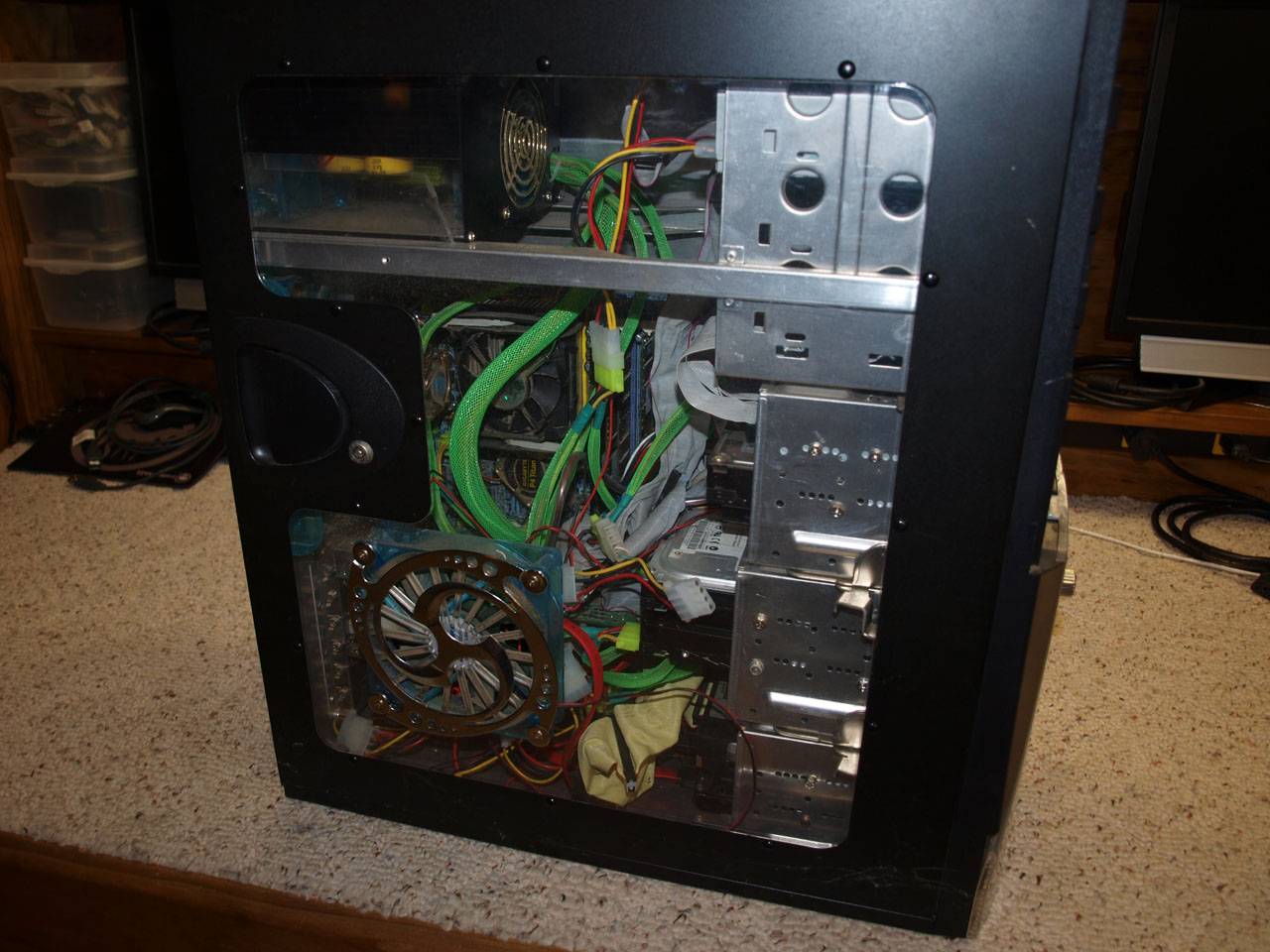

            Today's dropoff was a Gateway ESX-500X, complete with tower, monitor, KB & mouse, and the manuals.
            The GPU appears to be a LeadTek GeForce 6800 128mb. The heatsink on this thing is a solid copper monster!

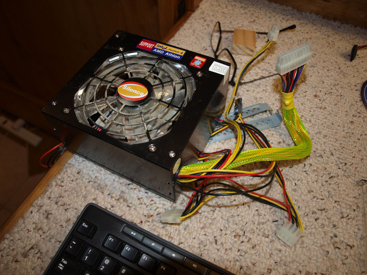

            It would not POST....this is why. Piece of junk power supply someone added. The brand name on it is "COLORSIT", I've never heard of it. The original obviously went bad, hence this....
            Has an 'alienware-ish' look with the fold-up door....kind of neat actually.
            The rest of it...
            The motehrboard is bad, partially. Caps are ok. NIC doesn't work, and it's not stable for some reason. RAM and GPU have been tested in another board, they're fine. The board is an Intel OEM; 845G/GL with a P4 @ 2.66/533 in it. I'll do a freebie resto on this, I have an Intel D865GLC which works, full featured BIOS, has 2gb RAM + P4 3GHz/800 Prescott in it, and best of all it fits the IO area of this case. The IO area of this case is not removable.....and I just don't want to cut this one out..... The untrained eye would never know this isn't the original board anyway.....ohh, and it came with an upgraded Audigy sound card....

              Colorsit PSU... I remember seeing the innards of one from Shroomie.
              IIRC their OEM was supposedly "Unitek Electronic Co.", but from what the PCB looked like, I'd go towards HEC being the OEM.
              A recap and some spare parts to complete the filtering and it should be good for 250W, if the heatsinks aren't absolute garbage, I guess.

                I don't think I'm really going to mess with it. It weighs less than a happy meal....I have far better here. I'll probably scavenge the 120mm fan out of it and pitch the rest in the scrap bin.
                    https://www.badcaps.net/forum/attach...1&d=1645491409
                    The rest of it...
                    Super!
                    I saved one of those as well. It really is a neat-looking machine, like you said. IDK why, but I too agree that the case definitely looks "classy" with the front door closed.
                    And you got all of the original hardware and peripherals?! That's awesome!
                    Looks like top-of-the-line build too, with that 2.66 GHz P4. IIRC, that's one of the highest 533 MHz FSB CPUs this motherboard supports. Mine only came with a 2 GHz P4, but I swapped it for a 2.66 GHz from my ECS P4VXASD2+, which can also do 533 MHz FSB with Northwood cores only... but being a cheapo ECS mobo with a single-ended VRM that powers the CPU from the 5V rail, it ran miserably hot around the CPU. So giving it the 2 GHz from the Gateway seemed more appropriate, even if the difference in TDP is only 10-15 Watts.
                    Funny. Mine also came with an extra NIC inside, which suggests the original one was giving problems. However, when testing that, I found it to be OK. What I found was NOT OK were the caps around the CPU. Mine came with Nichicon HM from the defective period. None looked bad, but all were showing out-of-tolerance capacitance. Replacing those got the board stable and onboard NIC working too. I see your board has KZG caps (likely 6.3V, 3300 uF ones?) If so, I suspect they may be bad or on the way out... hence the stability issues. Or it could be some of the small caps elsewhere on the board. But of course, IDK if it's worth doing that kind of work on such old board. Perhaps in a decade from now when AGP systems get even more rare, it might be? I say, stash it somewhere for a decade... and if anything has changed, fix and sell it then... or dispose of it then. These motherboards are nothing special indeed, since they can only do 400 & 533 MHz FSB with Willamate or Northwood CPUs. But they are made by Intel and quite well-made too.
                    Could they make the ATX power cable any shorter on that PSU?
                    At least mine came with the original PSU - still in working condition too. It's a 200 Watt Delta, IIRC, and not a whole lot of Amps on the 12V rail (maybe 10A or so.) I caught mine just as the 5VSB "critical" cap was starting to go high ESR, but not failed yet. The 5VSB was within spec, but I imagine it wouldn't have been for long. I replaced only that cap and it's on my to-do list to recap the rest of the PSU. It's full of Ltec, though none are bad it looks like. The older Ltec seem to do better in the older Delta PSUs. The one thing that worried/worries me the most about that PSU is the 12V rail rectifier - only a 12 Amp part, IIRC. Not sure how they (Delta) are rating the 12V rail for 10 Amps with that, given the PSU is a single-transistor forward design. But hey, it took my 2.66 GHz CPU just fine. In fact, remember those old full-height HDDs I sent you last year? I formatted those on this machine, along with all of the other SCSI stuff. It's a nice solid machine overall.
                    Thus, upgrading the 12V rectifier on my PSU is another item on my to-do list for it, as I plan on restoring the whole PC too.
                    Now it makes me curious: what kind of rectifier(s) that ColorsIt PSU has on the output.
                    Well, perhaps consider posting it in the gutless, bloated, and fried PSU thread before it hit e-waste heaven?
                    At least I'm curious to see what such cheapo units of today still look like on the inside. I'm sure I know, really... but sometimes these cheap PSUs find "interesting" and "innovative" ways to cut corners that I haven't seen before, and I always find that part amusing.
                    I'd also save more than the fan... but that's my master hoarder self talking here.
                    No, I likely wouldn't try to fix it either. I already did that with this KDMPower MIPC MI-X8775CD piece of crap and consider it enough.
                    However, if you do take it apart, grab the BJTs, secondary-side rectifiers, and output toroids. The output toroids are actually worth ~$1 or 2. Same with the output rectifiers. For the 5-10 or so minutes it takes to get them out, considering how easy these cheapo PSUs are to open, I never skip that chance. The ATX cable sleeving looks cool too (probably UV-reactive. )
                    I don't see any PCI-E power cables on this one (thankfully)... but if you do see any on other cheapo PSUs, save them for sure! A good number of modular PSUs usually use 6-pin PCI-E connectors for the modular stuff - from PCI-E power to peripherals. It doesn't take much effort to reconfigure one if you have a pin-extraction tool. I don't, and I still do it without too much effort.

                      What's even funnier, in the paperwork for this system was the paperwork for some late 90's era IBM Pentium2 system....hand written in the notes was 'slot 3 - monster 3d card'. I called and asked if he still had it (this guy drops off pretty regularly)....he says he thinks it's in his basement....he'll try and find it!! YAY! 3DFX!!
                      This guy is ex military, keeps everything, and in pristine condition....they've been downsizing and cleaning out the last 6 months. Everything he's brought in has been complete!
                      I won't pitch it as long as I still have the system....just incase I ever want to go back.
                      Excellent.
                      Make sure to add the extra 80 mm fan on the rear of the case then.
                      Already done. Here's the build post for this.
                      https://www.badcaps.net/forum/showpo...7&postcount=59
                      That's probably one of the top-10 best AGP GPUs out there, if not top 5. This one alone is at least $50 on eBay (selling prices, not bogus asking prices) - your's probably more with that cool heatsink and not some stock crap.
                      I played some Q3A and UT in 1280x1024 with all the candy on, played flawlessly smooth!
                      I tossed it out in the garage, but it hasn't made it to the bin yet. I will scalp the fan and autopsy it for you...and add it to the 'gutless PSU' thread if it qualifies....and I think it will.
                        I wouldn't be surprised if the OEM PSUs are normally better PSUs at the time that PC was made. Looks like another case of an OEM PSU being replaced with a super cheapo PSU. Like a PC that I saw, with what looked like one of the cheapest Coolmax PSUs!

                                          Friday's freebie is an absolute stunning one; I had some free time today (Sunday) to see what it was.... Someone called and asked if I wanted an old Pentium4 system.....naturally, I told them to bring it by.... Half expecting some old junk Dell system (the most common ones I get), I got this!!
                                          Some gamer rig in what looks like a Lian Li & Antec clone case....the case looks to be a Chieftec; solid aluminum construction. Naturally, the front door is missing....bummer....but we're not done yet!
                                          The guy said if I didn't want it, he was going to throw it in a dumpsite on his farm and bury it.
                                          Now, lets get inside it!! I counted 6 hard drives....no clue as to their sizes. Whoever assembled this would be fired if they worked for me....total rats nest and no attempt to manage cabling....
                                          A power supply with a clear case, I've never seen one....
                                          Motherboard is a Gigabyte P4 Titan submodel GA-8PENXP. This was actually a very high-end gaming board in it's day; sporting the heftier external VRM with fan and the 6 DDR1 slots; albeit 2 on each bank are shared, so it's still obviously only dual channel....but a neat idea for the time.
                                          I powered it up, on for half a second and immediately off. Given the PSU of this era, I didn't fire it again.....you know as well as I do what's likely wrong with it.
                                          Tested with a known good test supply.
                                          Now we're talking!!
                                          Now lets have a closer look at this "aspire" 500w PSU:
                                          Now for why the clear shell PSU is good....much like an oven door window, watching for your bread to rise...I'm sure they made this one so you can see when your cap vents rise!! It's a bit of an unusual looking PSU, I'm going to try and fix it.....
