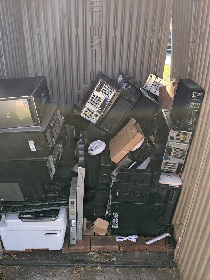

                              Our E-recycling shed at work is a gold mine. This fills up monthly. Just got two i5 6500, a bunch of RAM and a 4th gen 4570S.

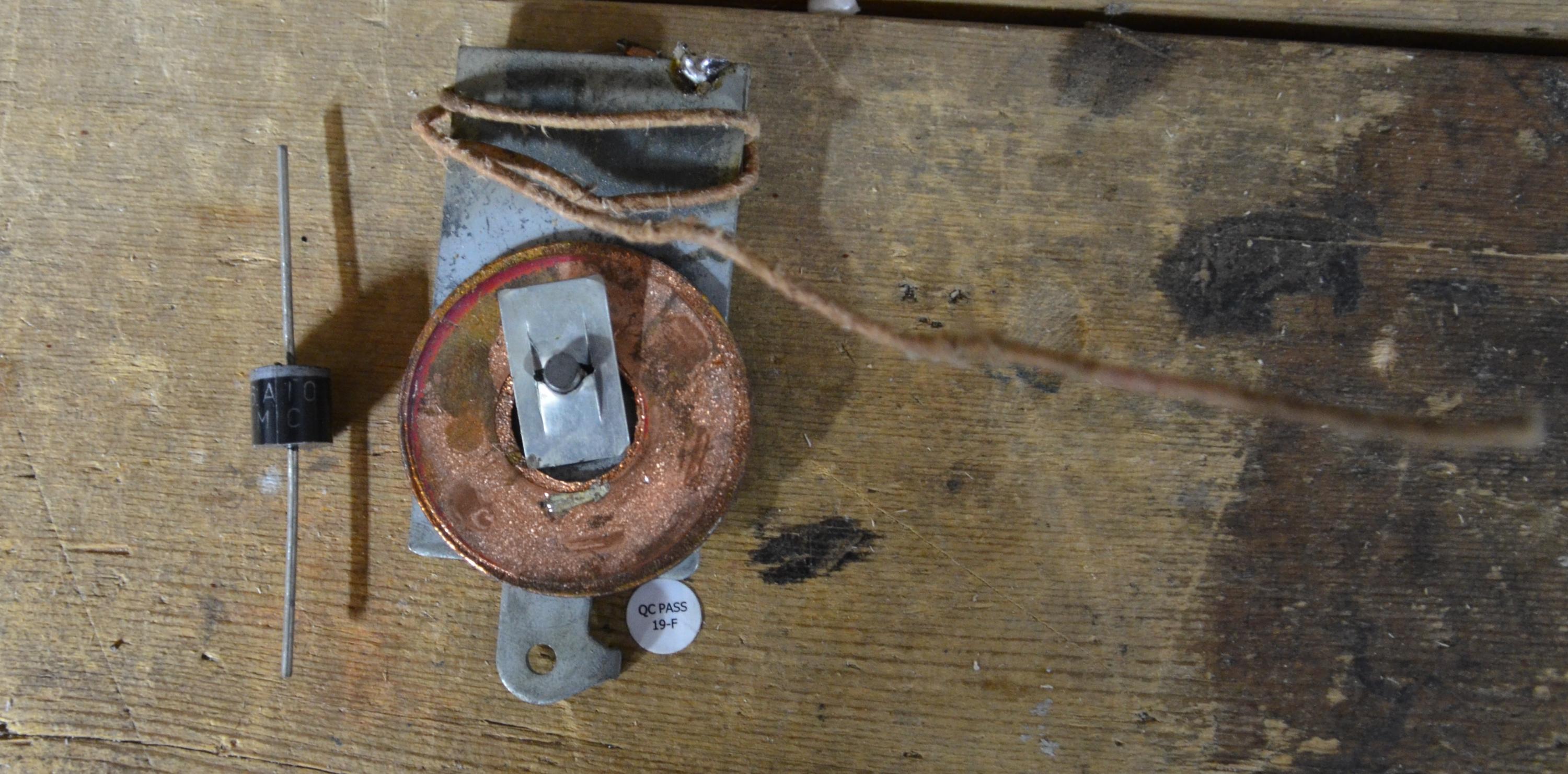

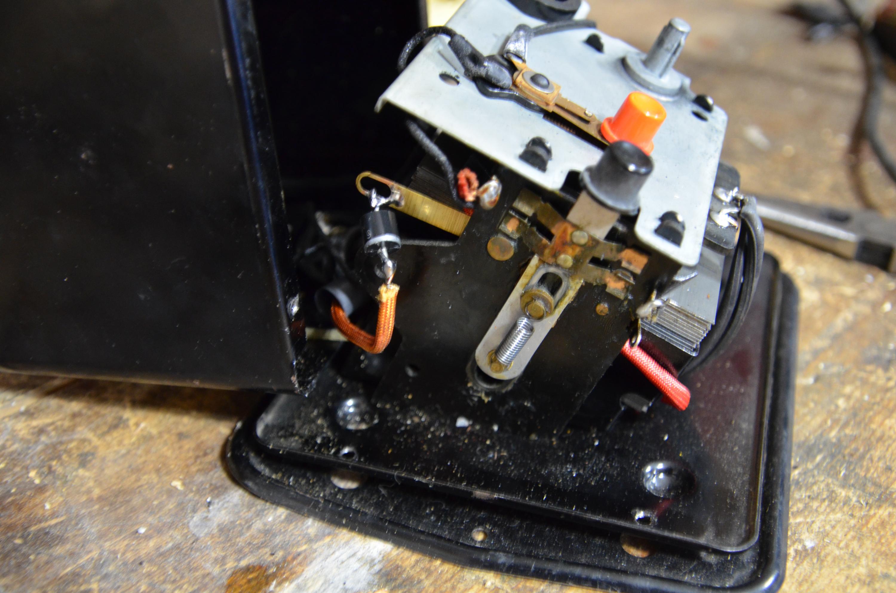

                                    A Lionel "RW" 110W transformer for $10. Everything works properly except the whistle button, a common issue with all older Lionel transformers as the rectifier discs become weak with age (for anyone not familiar most O-gauge trains are AC powered and inject DC to trigger the whistle), nothing a diode won't fix.
                                    Out with the old, in with the new (I know I'm stating the obvious to most on this site, but diode left, old disc rectifier right).:
                                    New diode installed:
                                    Nice simple 1950s electronics here:
