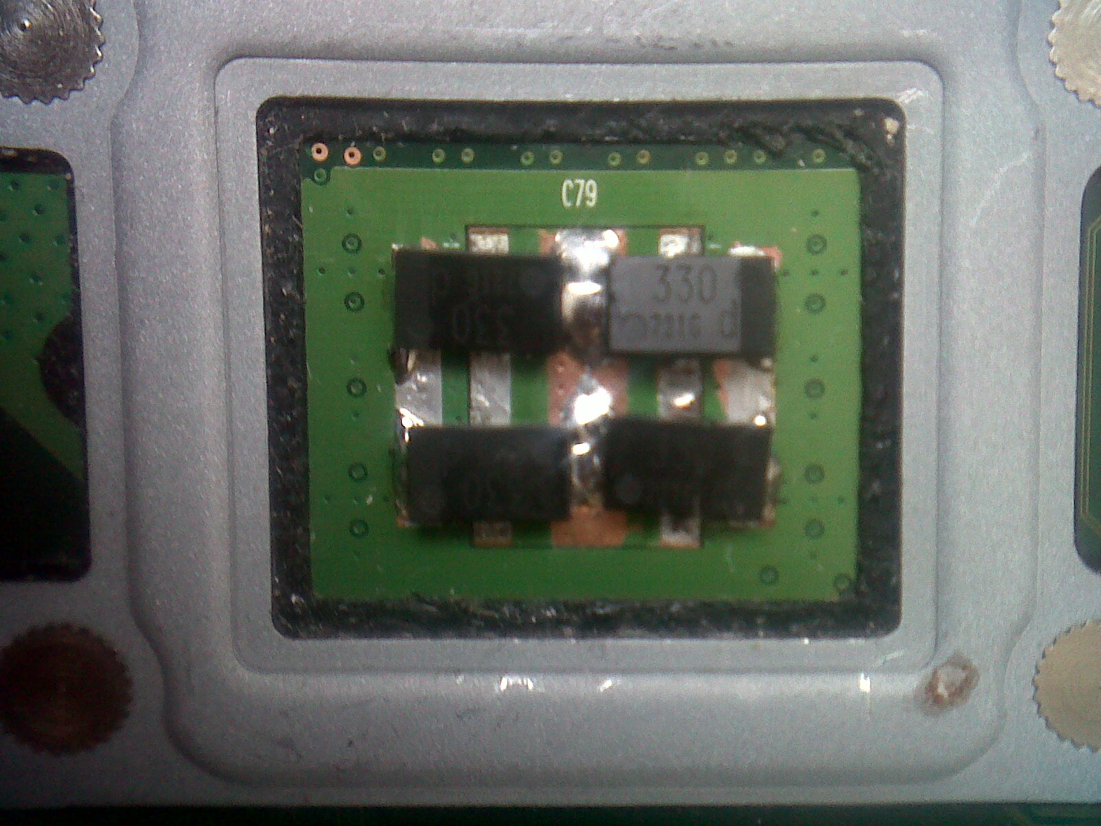

                  Scored a Toshiba Satellite A300, with bad NEC Tokin and bad LVDS port (bent pins, one broke when I straightened them, but thankfully it was a GND tab) plus charger.
                  Fixed it (somewhat - got it into a booting state, but still needs work) with a few classic 470uF 10v caps. It's too much for now, but at least it POSTs on battery.
                  Right now the symptoms clearly point to my caps being unsuitable (hangs with colors at boot, most have said it's the cap doing this and not the HD3470 GPU) and will not POST over charger.

                                  Slight update, managed to finally fix the Toshiba A300.
                                  I managed to do quite a contraption:
                                  - 1x 330uF
                                  - 3x 47uF
                                  - 1x 100uF
                                  - 2x 150uF
                                  Managed to cram all that in there because most caps were small, with the exception of the 330uF cap.

                                    • 31289
                                    #4557
                                    why didnt you just put it to one side till you could get a bunch of 330's from china or an old desktop board??
                                    • Dan81
                                      SNES-powered
                                      • Oct 2013
                                      • 1866
                                      • Romania
                                      #4558
                                      Because where I am staying on my trip for now (Arad), there's literally NO PLACE to find tantalums, let alone 330s.
                                      I managed to find some stuff on a broken L300 board (although the bigger tantalums were missing, don't ask why) hence why so many values.
                                      I will replace those with 330s once I get home, but for a temporary solution, it works. I did have to trade the T5800 for a T6500, and disable the 2nd core for now. No noticeable slowdowns at all for now.
