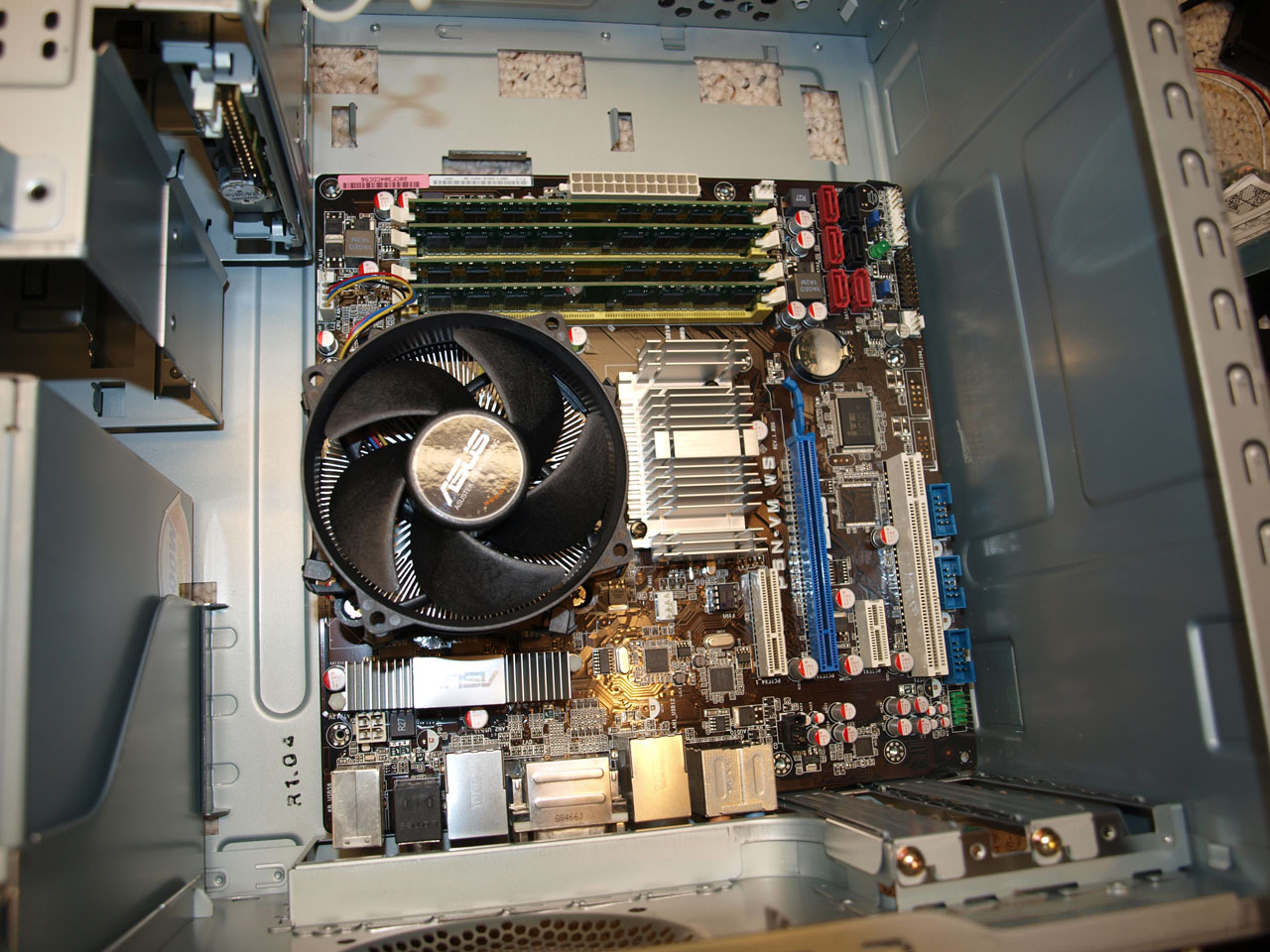

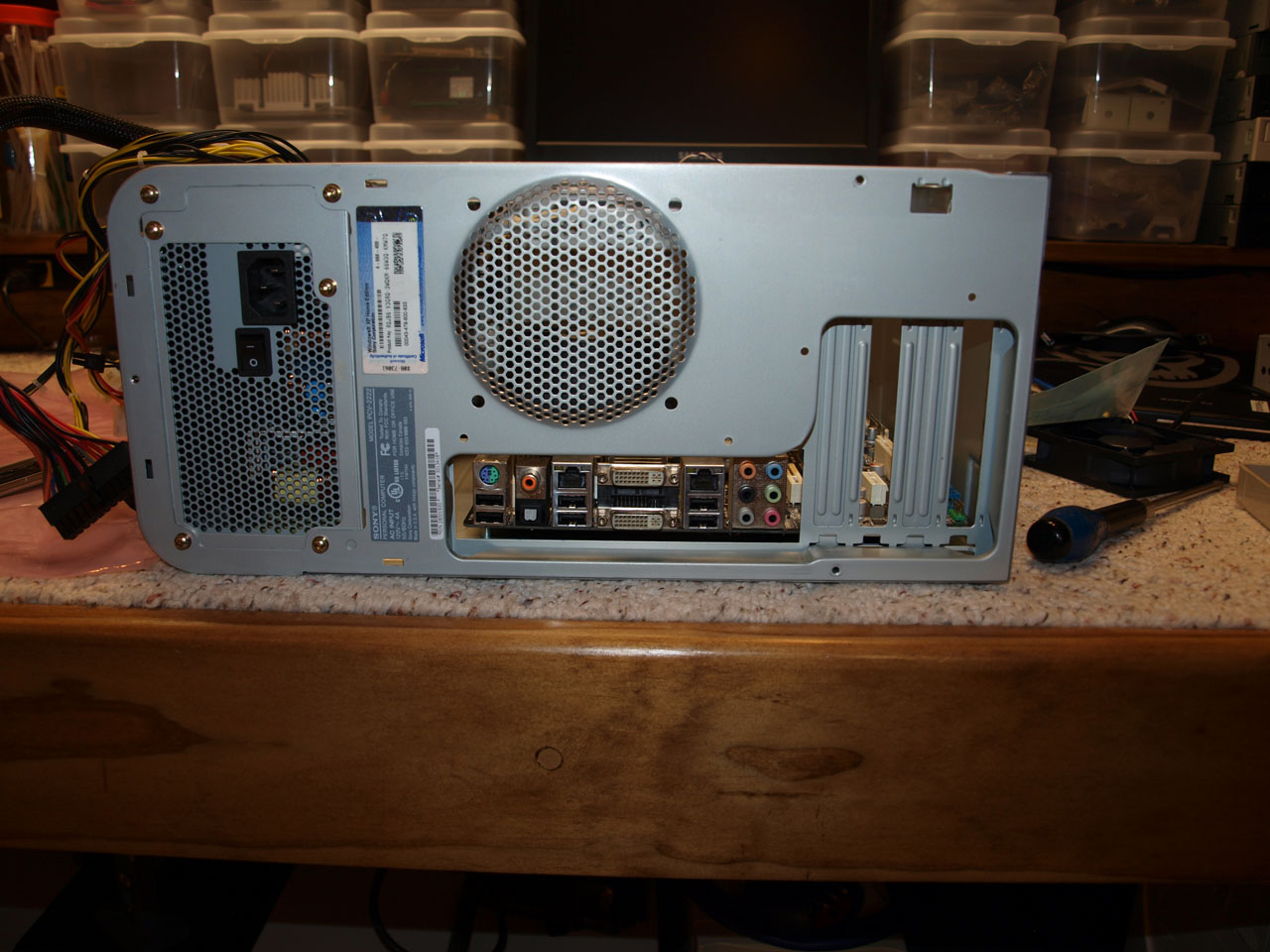

                    Remember that Sony Vaio from a page or two back? This is what it ended up getting....since its internals were all but useless. This build wasn't quite worthy of a thread of its own, but a little mention since it was built from random junk around the shop...and that Asus P5N-VM board momaka was asking about.
                    That old Vaio case cleaned up nice and is a very solid thick gauge steel....so kind of a sleeper build for as old as it is...
                    Test fit....and it fits the mounts....but that's about all that fit without some modification.

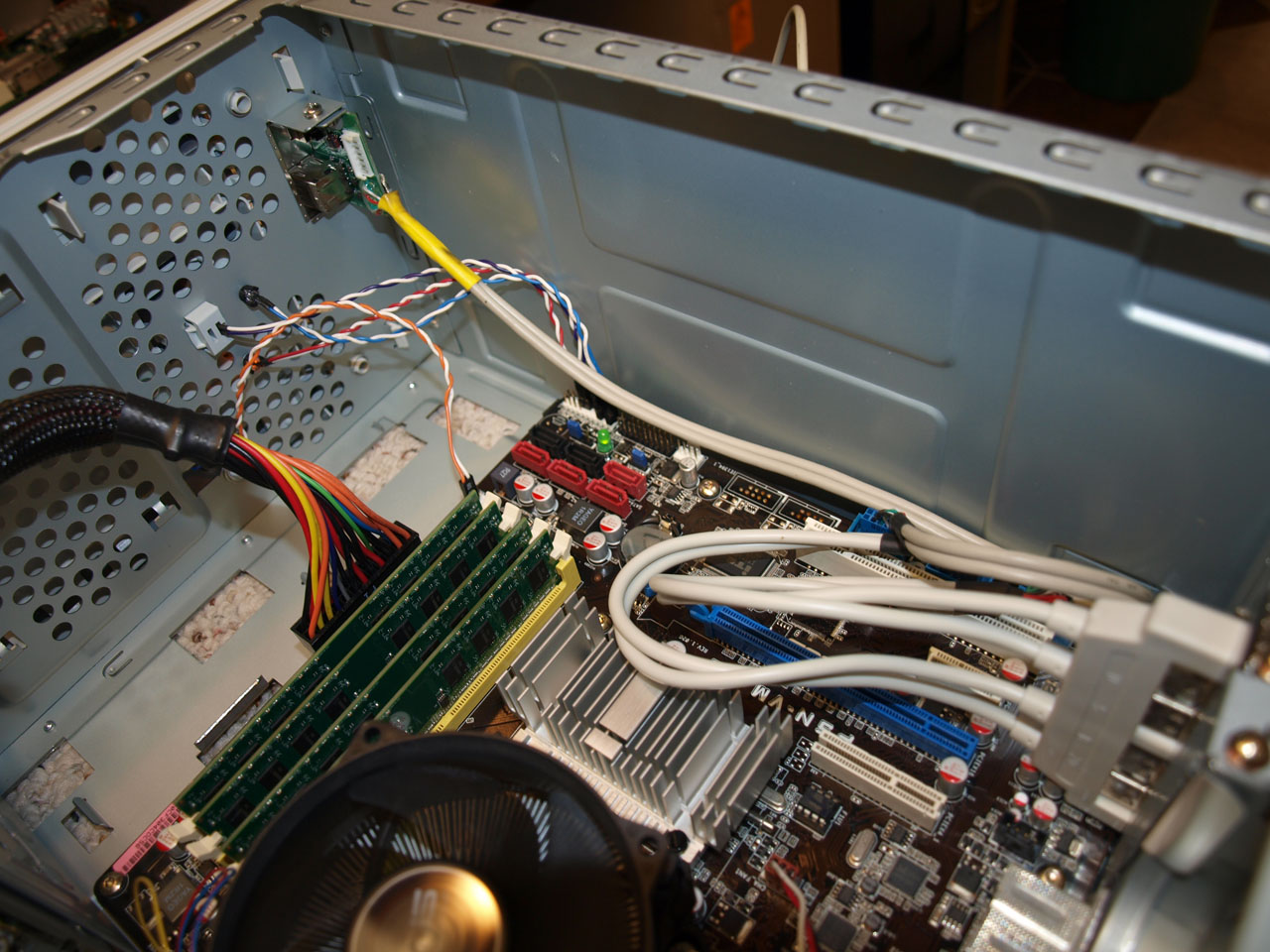

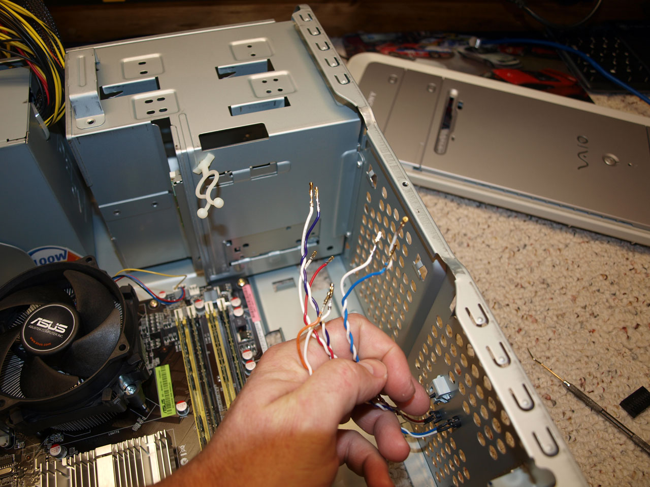

                    Of course it has a non-standard proprietary front panel pinout with a single-end connector....not for long!
                    Some individual FP connectors scavenged from a junk case.

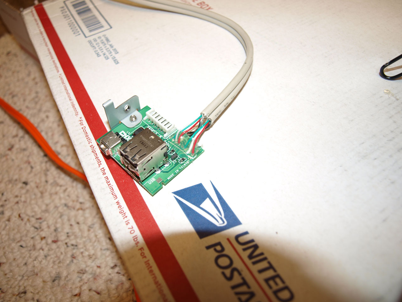

                    Now for this front panel USB with a super short cord and of course a non-standard plug...
                    A standardized longer USB internal cable stripped from a really shoddy junk case...and the end nipped off to be used on this goofy proprietary PCB.
                    Proprietary plug removed, mapped out, and soldered together.
                    Hot glue at the wire base to restrict movement and otehrwise prevent tugs & oopsies...
                    Plugged in...and working.
                    Wiring tied up and a 147gb 10k RPM SATA HDD added....I wanted to do a SSD, but I am fresh out of unused spares. Yes, this case was made for one of those 'shorty' ATX power supplies....but I didn't have one. The original PSU for this case was missing when I got it.

                    Like it was born there....

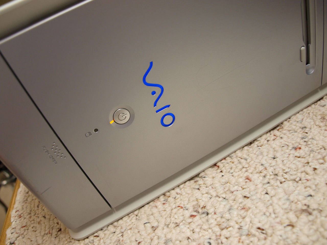

                    Super cool mod was done to maintain the illuminated the Vaio badge.

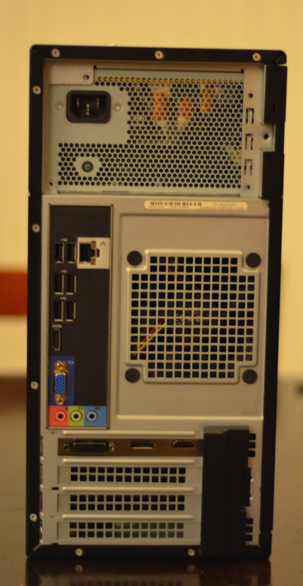

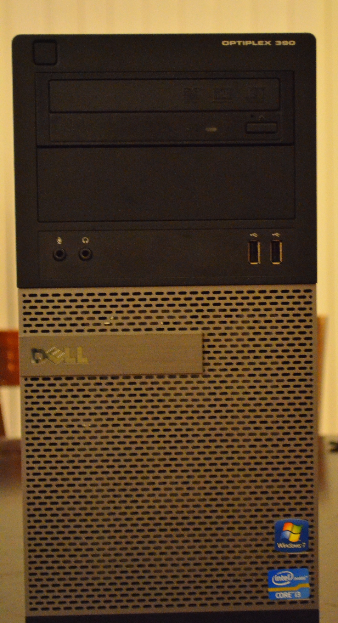

                      Dell OptiPlex 390 with a dead PSU for $1 (that's right a buck):
                      Specs as purchased:
                      CPU: I3-2100
                      RAM: 4GB DDR3-1600
                      HDD: Seagate Barracuda160GB 7200.7
                      GPU: Radeon HD6450
                      OS: Windows 7 Pro
                      Upgrades:
                      Replaced dead 265W PSU with a Dell (Delta) DPS-460DB-4 I had laying around
                      Upgraded HDD to a WD1600HLHX VelociRaptor 160GB 10K rpm drive
                      Upgraded the GPU to a Zotac GeForce GTX1050.

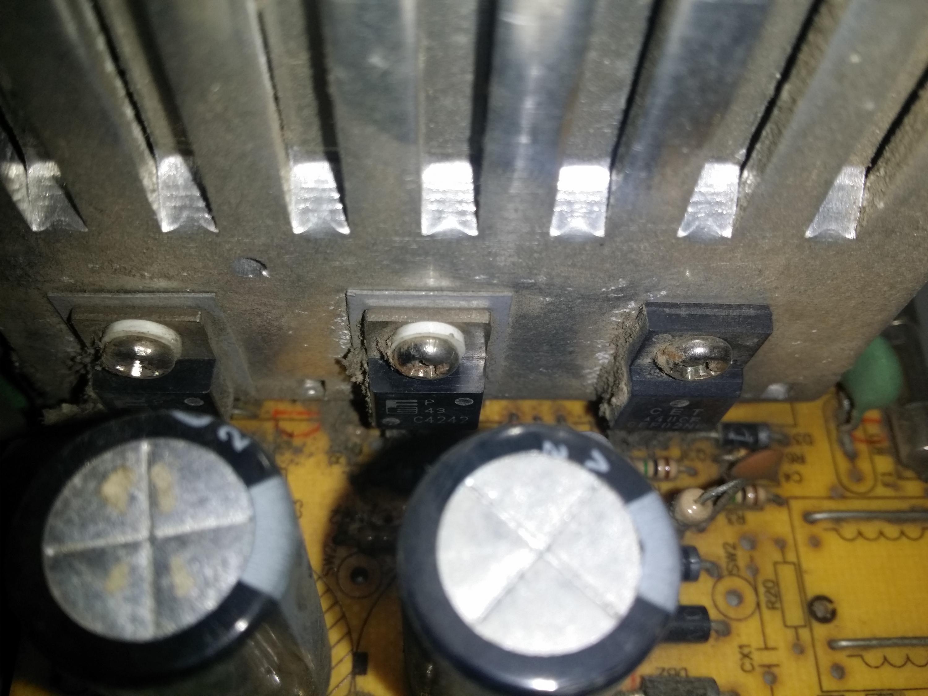

                                  Okay, so here are the pictures.
                                  If you wonder why there's no fan, it's because I took the one it had out (a Nidec Beta SL 80mm) for other projects.

                                      That's a great PSU if you need to harvest allot of jumper wires for a single sided PCB project!
                                        Well.... to be brutally honest, I don't see that much of a difference between this Linkworld and the Deer/L&C LC-B300ATX you posted.
                                        Perhaps the only thing that makes the L&C better is that its PCB has spots for two caps on each rail. On the other hand, I do remember reading some reviews of crappy PSUs a while back that showed that the custom Linkworld PWM controller that Linkworld PSUs use has working OPP and made it very hard to blow up the PSU. I think the review was by c_hegge here on hardwareinsights. Will have to look to find it, if you're interested. If I did remember that right, then the Linkworld PSU has a small advantage in therms of safety.
                                        In terms of efficiency, I don't know which one of these sucks more. But I can tell you that the L&C has pretty bad efficiency.
                                        Don't be so pessimistic now!
                                        I've used an even more gutless PSU to save/test a dozen of other PSUs with problems - namely, a 100W self-oscillating 12V PSU for Halogen lights, a CRT monitor, one of my 250 Watt HiPro PSUs (just needed a 1.5A fast recovery diode), and to temporarily fix a broken rectifier in a Behringer EPQ-1200 amp. I'm not even counting the 10's of breadboard projects I made with the parts from that PSU over the years.
                                        So yeah, even a gutless Deer can be useful.
