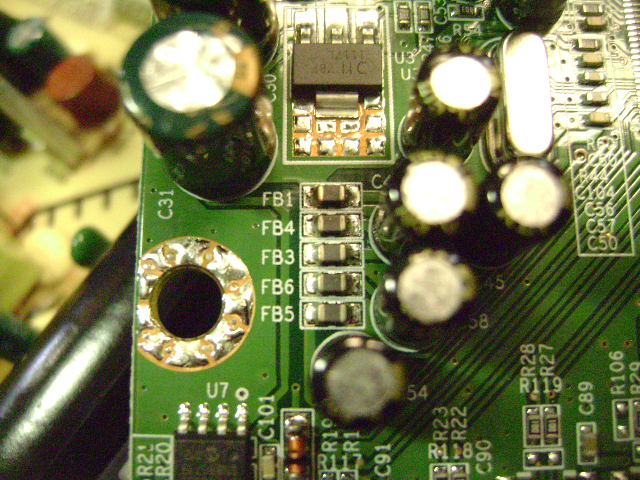

    Does FB mean fuse also?
    I have a board with fb01 fb02 fb03 ect. Fuse?

    Does it have continuity or a burn mark? Probably an smd fuse.

      Re: Does FB mean fuse also?
      here is a picture
        All fuses.
            Whoa!
            Dark grey SMD of this type are ferrite that has physical characteriscs that filters DC of (blocks) noise and is NOT a fuse. And does not have a marking on it to state the fuse current rating. Like a letter, or a number even a number with "A" on the end.
            Have to be careful with the location marks. I have seen different markings like FSxxx, etc, CV, QV etc, even TVxxx lately that could mean anything for component locations (transistor, resistors, diode etc).
            Cheers, Wizard
                http://www.garrettelec.com/div_detai...ite%20bead.cfm
                Like these? I stand corrected. They had continuity so I ASSumed.
