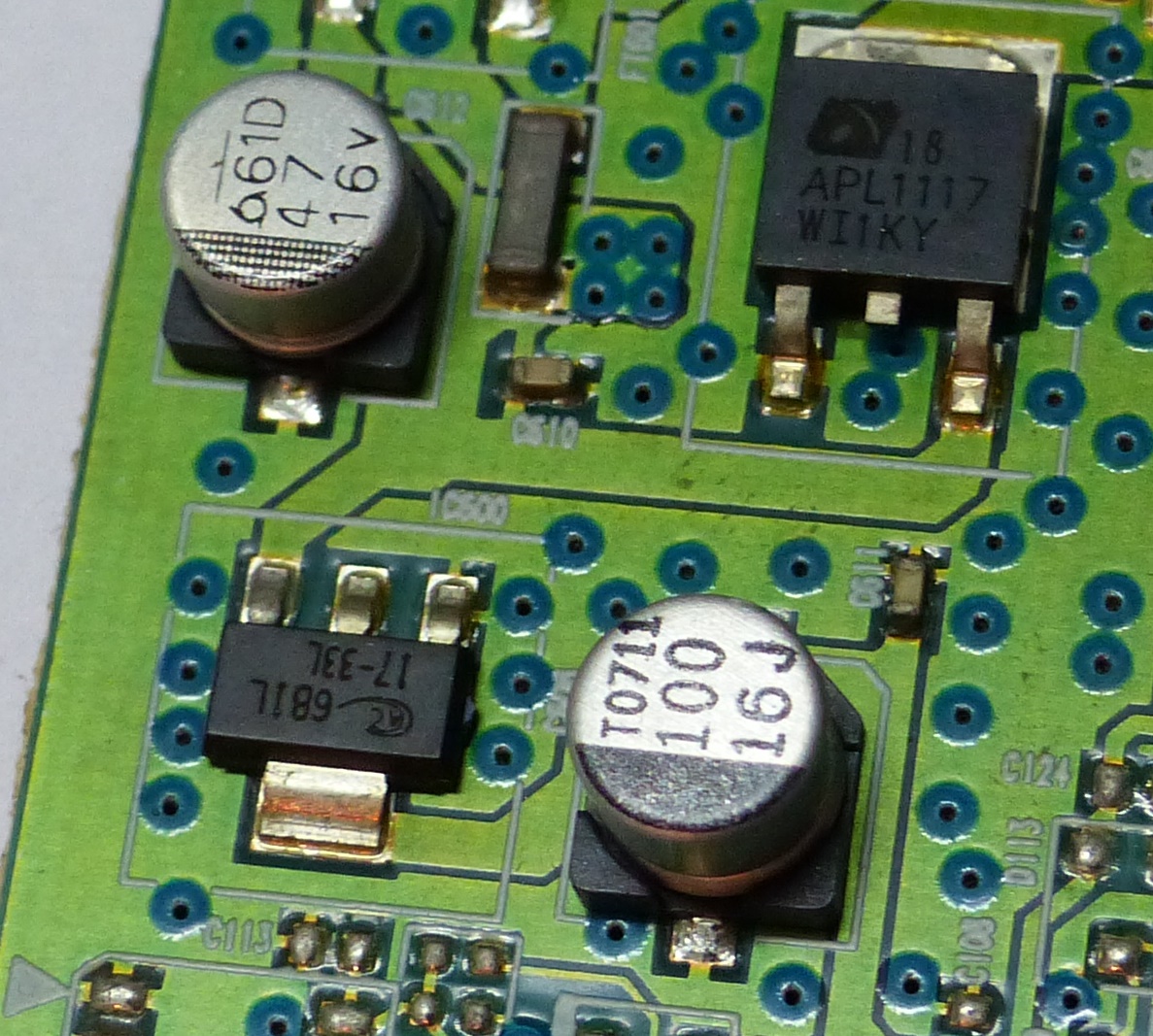

    I think I found a good replacement for the vrm - 6BIL / 17-33L, but I dont have my tools to finish the job. I must waiting until thursday.
      master hoarder
      • May 2008
      • 12164
      • Bulgaria
      Re: Corsair K70 RGB dead
      ^ Yup, that should do the job. Looks like it's from a CD/DVD drive board.
      Some motherboards may have these as well. And Xbox 360 motherboards have a ton of them. So that's why I always keep all dead motherboards around.

                    Sooo. I opened up my keyboard earlier during my lunch break and the K70 is not quite the K70 RGB (see picture of the USB connector here. )
                    1) Should I open my own post to get help about my keyboard instead of hijacking yours ?
                    2) Can anyone help me and tell me what to test on my board ? The USB input reads at 5.12V from the red wire to any ground.
                    EDIT2: Ok seems like you can edit for a short time.
                    Here is a close-up on what could be the VRM (Q1) ? Q11 on the left of the first picture is the same component. Any idea of how I can find the datasheet with only "N51S" written on it ?
                    EDIT3:
                    I went forward and took some more measures, assuming Q1 (on the right) and Q11 (on the left) were VRM. My electronic skills are very limited so I might have done stuff wrong but I feel there is something abnormal about those measures.
                    For the sake of clarity, here is how I named things:
                    M#: Measure numer #
                    G: The ground of the keyboard (big screw in the middle coming from the usb connector)
                    Q1S: The solo pin of Q1 (upper on the picture)
                    Q1P1: the lower pin of Q1 on the left
                    Q1P2: the lower pin of Q1 on the right
                    Q11S: the solo pin of Q11 (left side)
                    Q11P1: bottom one (to match Q1P1 position)
                    Q11P2: upper pin

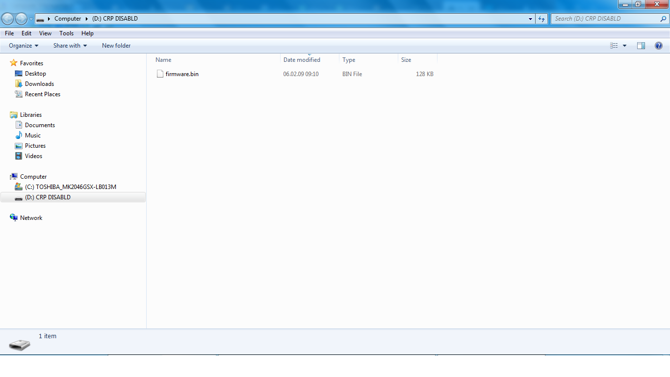

                                Sorry , I mean CRP_disabled
                                This is the procedure to activate the firmware location and write new firmware:
                                1: Unplug your keyboard from the computer.
                                2: Locate the small pinhole underneath your keyboard. For some, this will be located near the polling rate switch by the cable. On others, it will be located underneath on the tilt legs on the bottom of the keyboard.
                                3: Using a small paperclip or push-pin, press down on the button inside the pinhole.
                                4: Plug your keyboard back into the computer, while holding down the pinhole button.
                                5: Once it is plugged back in, your computer should recognize a drive called CRP_Disabled. Please open this.
