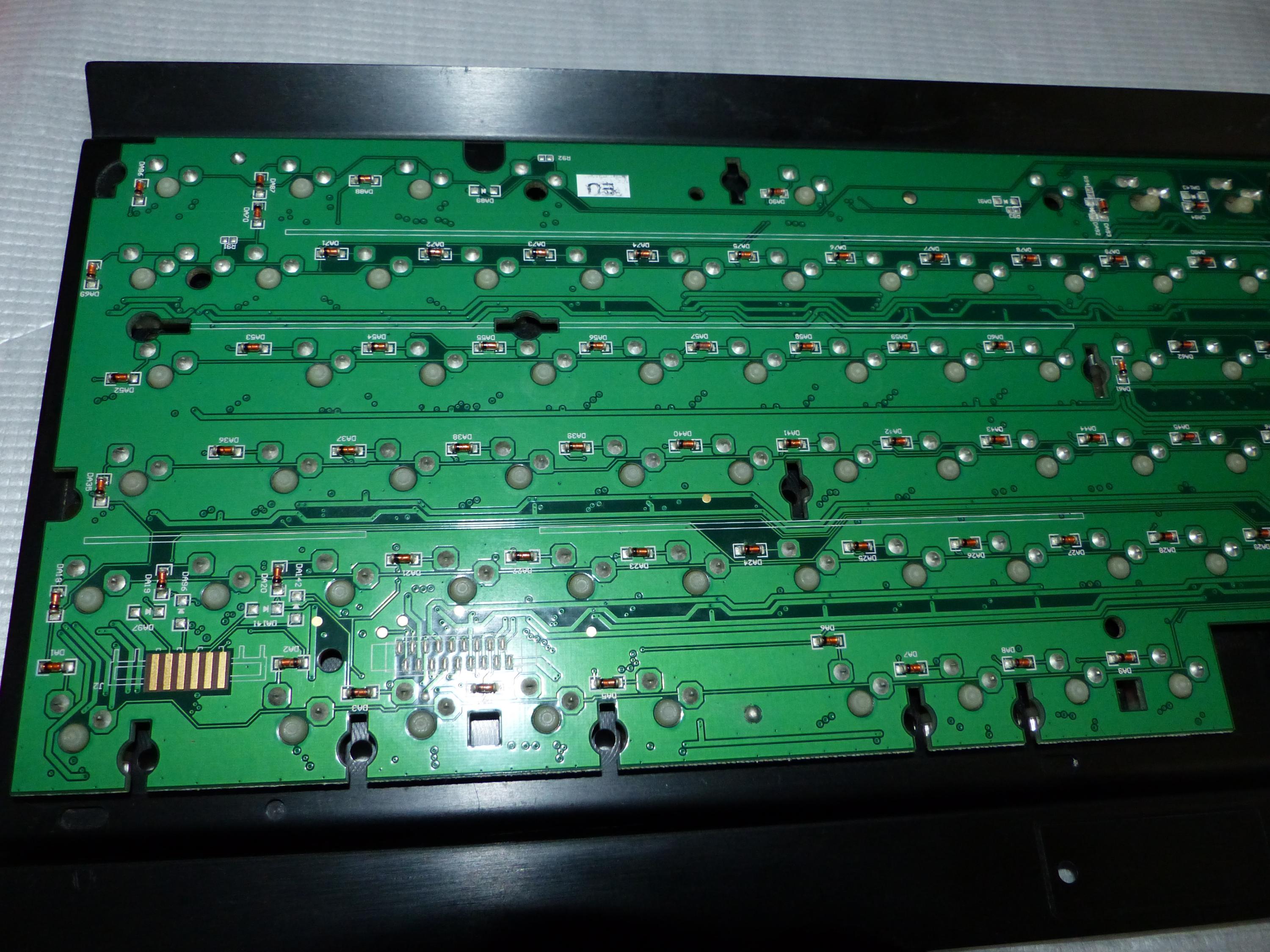

    In new times, new problems . It is understandable here, being a forum dedicated to repairs.
    So my problem is with one Corsair K70 that I received from my brother-in-law.
    Initially it started normally but after installing the Corsair software it started to trouble: keyboard lock, computer lock, restarts and finally dead...

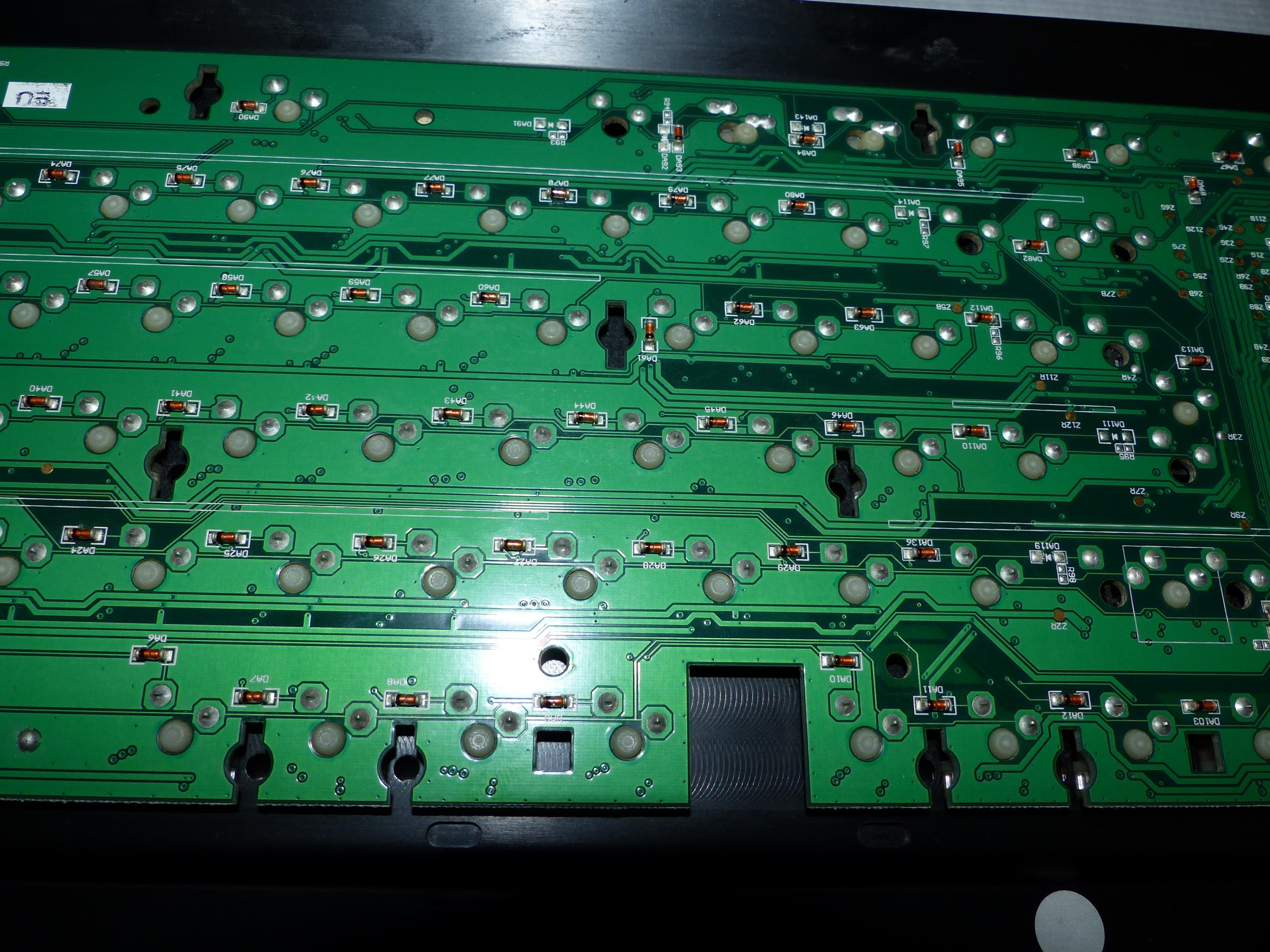

    I opened it and I found that there were a lot of coffee grounds
    I thoroughly cleaned with a brush and isopropyl alcohol and re-assembled.
    After 3 attempts to start, it was not recognized by any computer.
    I tried to research but I did not have a chance, so I appeal to your guidance and advice.

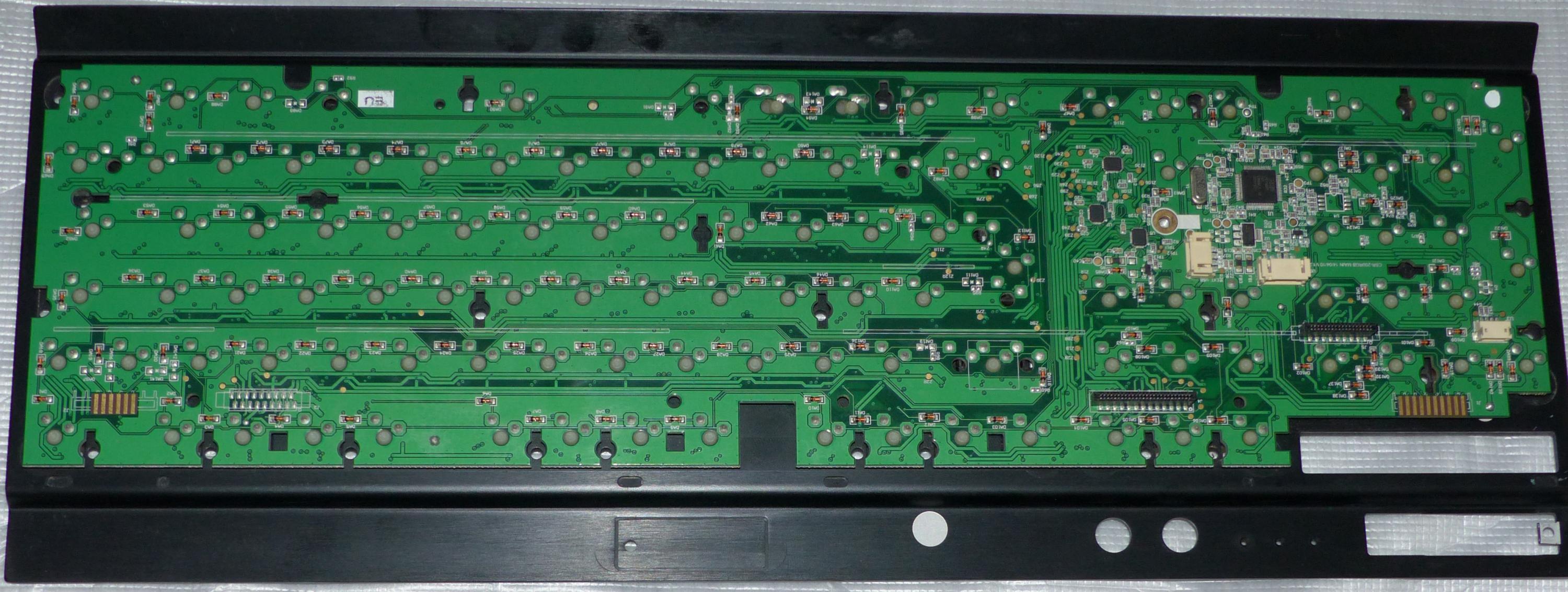

        I just said I cleaned with isopropyl alcohol. Right now I'll upload some pictures.

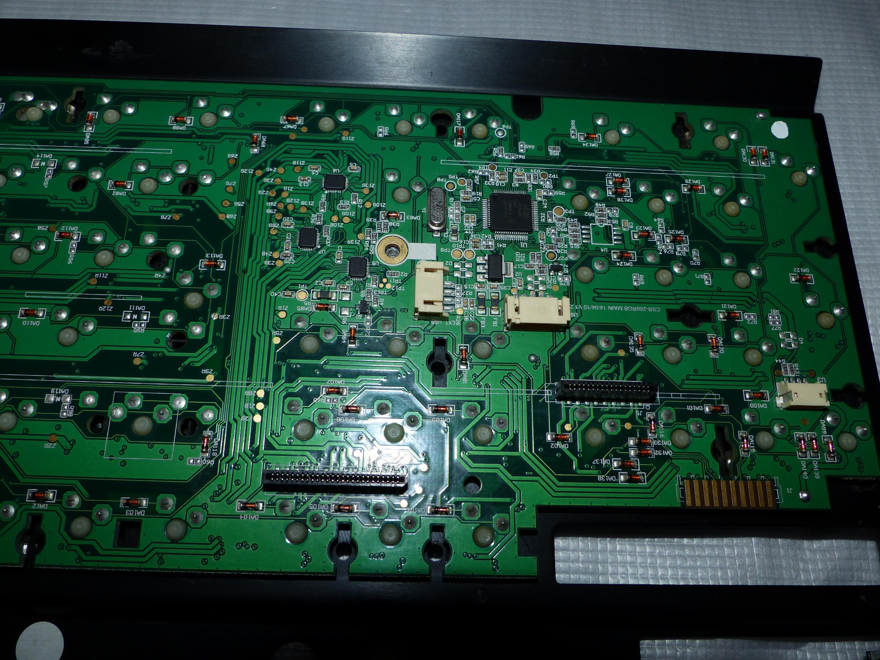

          Maybe start by checking wires between USB connector and keyboard's PCB. Then, when plugged into a USB port, make sure the keyboard is getting a steady 5V supply.

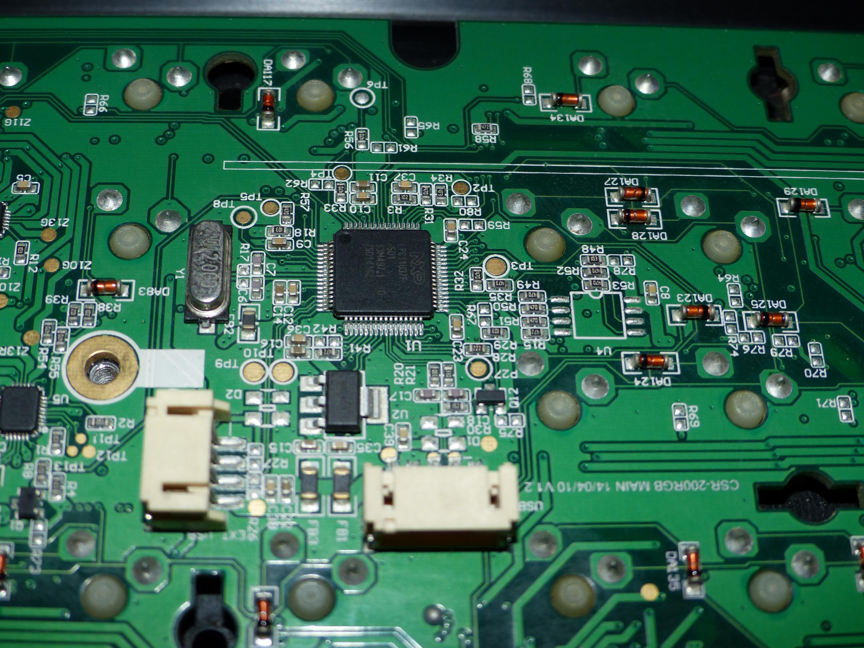

            Yep, the voltage is 5V at the terminals on the keyboard pcb, unfortunately I studied too little the NXP LPC11U3X datasheet to check the voltages.
            Besides, I do not have so thin terminals to risk measuring pins.
            And there would be a VRM, or something like that ...

              If the power and data lines are okay, then next check the input and output voltages of that SOT-223 voltage regulator.
              If good, I would take the entire PCB out and give it a good wash with soap (dish detergent) and water. The let it dry completely and try the keyboard again.

                  Last night late, tired and in a hurry, I checked the VRM. It's a typically L1117S33 .
                  The measurements was made with both USB cables (keyboard and RGB) connected to the computer and the sockets on the keyboard's PCB.
                  The voltage on the input pin is ~ 5.1V, but the output voltage on the output pin quick tends to zero.
                  Hardly unpleasant ...
                  Is it relevant to measure the voltages only with the keyboard cable, ie without the RGB cable connected? Could there be any additional clue?
                  What happened and how do you explain that such a solid VRM can creep so easily?!

                    Yes, should be fine, unless the RGB backlight cable has some type of feedback (which I seriously doubt).
                    It could be that there is something shorted on the output of that voltage regulator or it could also be that the regulator went bad (rarely happens, but not impossible).
                    If there is anything shorted on the regulator's output (you should check resistance from the regulator's output to ground with your multimeter), I would most likely suspect a shorted ceramic capacitor somewhere. Reason being is because ceramic capacitors like to become short-circuited when flexed or vibrated too much - something that isn't too hard to do on a keyboard PCB (think about all that slapping and hitting the PCB takes as buttons are pressed).
                    So if you do identify that there is a short-circuit on the regulator's output (I would say any resistance of less than 50 Ohms is certainly suspect), you should check the resistance of ALL the ceramic capacitors on the board. The ones that appear shorted should be removed until the shorted one is found (tedious annoying process, I know :\ ).

                        0.857 kOhms is the resistance value of the voltage regulator from output to ground.
                        Capacitor values are here, but nothing under 850 Ohms.

                          Sounds like there is nothing shorted then and possibly only the regulator is bad. If you have a small breadboard, you can pull the 1117 regulator out, solder some leads to it, and built a basic circuit on the breadboard to test it.
                          Thank you @momaka, I'll try to check today all this.
                          Yesterday I searched for a VRM L1117 and found a LD1117ST C413 but I'm not sure that it covers the minimum requirements for the replacement part.
                          Well, if your regulator really is a L1117S33 as you stated in post #9 above, then you need a 3.3V *fixed* voltage regulator. Technically, you could adjust an adjustable one to output 3.3V or "tweak" the circuit for a 1.8V fixed 1117 regulator... but for a direct replacement, find a 1117 with a fixed 3.3V output (usually you will see it labeled as 1117....33). As for the current rating - as long as it's in the same package (looks like SOT-223), it should be okay. Most 1117 regulators have a standard rating of 800 mA of current. You can also use a TO-252 part if that's all you can find and don't mind a small "bodge job" on the PCB. (Been there, done that... got a 19" LCD monitor working fine again ).

                                  Because I kept some of the experience gained over time, I managed to desolder but also the soldering almost perfect. I cleaned with IPA at the end.
                                  I put that one ST LD1117 C413 because I did not have another one ready.
                                  The voltage measured after that on pin 2 is Vout=5.07V and on pin 3 Vin=1.343V
                                  Still not working and no lights .

                                    Your V_out pin cannot measure higher voltage than your V_in pin. Either you're measuring something incorrectly, or there is something very wrong with the circuit. Try re-taking those measurements again, and make sure you are measuring the correct pins.
                                    Also, like I mentioned in post #13 above, you cannot use any 1117 regulator you like - it has to be one with a *fixed* 3.3V output. If you use a regular adjustable 1117, then you have to add a resistor network on the ADJ pin to set the output voltage at 3.3V. Otherwise, it's not going to work.

                                      I wrote the message from my cell phone and I tangled Vin with Vout. And I could not even correct it.
                                      I actually realized that you are right about using another type of vrm, different from the specified one.
                                      It's hard to find quickly that vrm with a fixed 3.3V Vout. I await the moment when someone to make an order to put that vrm, which nevertheless has an insignificant cost of $0.45.

                                        Well, if the replacement 1117 regulator you have now is an adjustable one or fixed for 1.8V, you can turn it into a 3.3V regulator with a few small resistors. A picture of it would help to see what it is.
