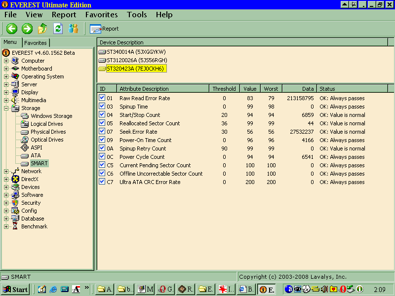

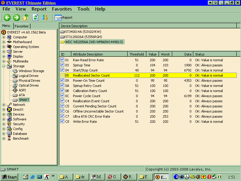

                  Re: current status on HDDs?
                  here's the smart of 2 dying hdds(attached images)
                  both wd and seagate made in 2000...
                  after certain time(few minutes) wd starts to tick...
                  then you can't access it etc.
                  smart shows no pending or realloc. sectors...
                  seagate has 44 reallocated sectors...if i remember correctly it's problem is that it sometimes works, other times not...

                        #91
                        Try some other programs on it and see if they report the same
                        Seems like the vendors don't use any standardised design for this stuff because I get different readings with different programs
                        I like HDD Health v2.1 but it's still hit and miss

                          #92
                          this was via usb hdd tray and only program supporting it is everest, i think.
                          will see if hdd health does it, but i doubt....
                          no, i won't be putting these dying hdds in any of my machines just to see if smart is the same on every interface...
