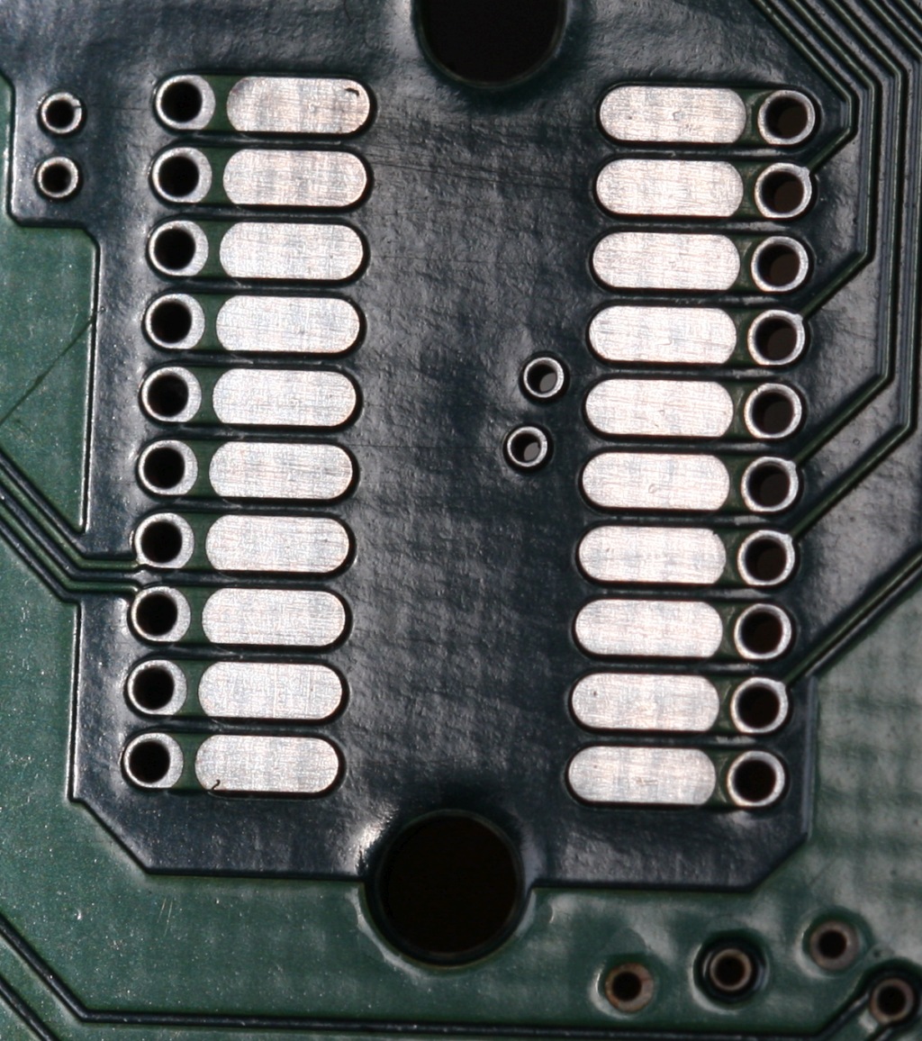

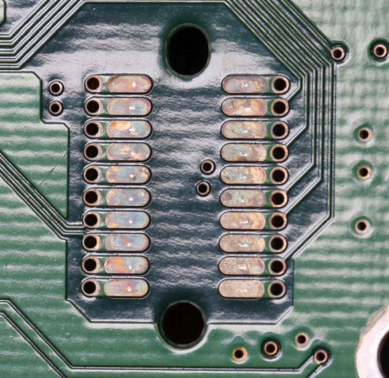

    Was reading the thread "<plays taps> 500GB bites the dust..."
    There it was mentioned that oxidation of the HDA contacts on the PCB is a common mode of failure on modern hard drives.
    As I had never heard of this before I went through my pile of dead drives.
    They have already had all data recovered and are just in storage before being destroyed permanently as I don't want to risk customers data being adrift...
    One drive in particular stood out, a Samsung Spinpoint F1 1TB model HD103UJ
    But there where more drives like a HD501LJ and several Western Digital drives with the same issue too.
    This Spinpoint F1 was decommissioned because it was racking up on bad sectors, it was up to 30MB at this point, I even posted about it in the hard drive failure thread.
    When I tried running Samsung ESTOOL on it back in 2011 it stopped with a message asking to RMA the drive if it was within warranty due to bad sectors.
    As you can see from the above the oxidation was really bad.
    I cleaned it with a rubber and then some IPA.
    After this ESTOOL passes, only complaining about bad sectors in one area of the drive.

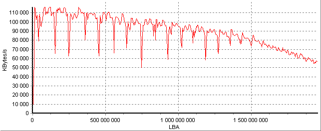

    I ran HDD Scan after this, and there are some drops in speed.
    I'm thinking this is where the drive has reallocated sectors.
    So the drive has to seek while doing the sequential test, thus creating those spikes...
    So it would be interesting to delete the drives list of reallocated sectors and then make a new scan, but I don't know how to do that.
    I also went through my box of decommissioned drives not due to problems but old age.
    It's all the same here, extreme oxidation on pretty much all "modern" SATA drives.
    But my old SCSI and IDE drives are fine because they where not victim of the RoHS directive!

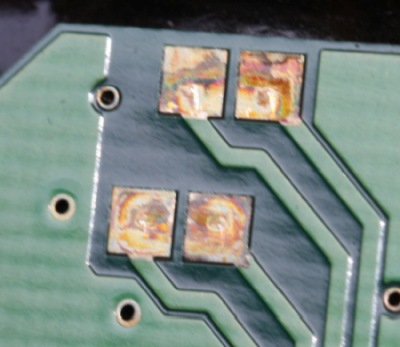

                I had a WD like that... A green line so i didn't have much hope, but i tried anyway.... Tin the pads. Use Good flux like Rubyfluid. After i did a SMART test, cleared the reallocated sector table, then zero'd the drive and ran a SMART test again, it came back with only 3 bad sectors. It only took 5 years to run the SMART tests too! Damn greens.
                Telling by the gouges in the mask of the headstack interface pads, he used one of those abrasive arse pink erasers on the back of a pencil.

                                      Had the same issue with one of my WD Drives recently. It was a 640GB Blue one that just didn't want to start...
                                      The connectors did indeed seem suspicios...
