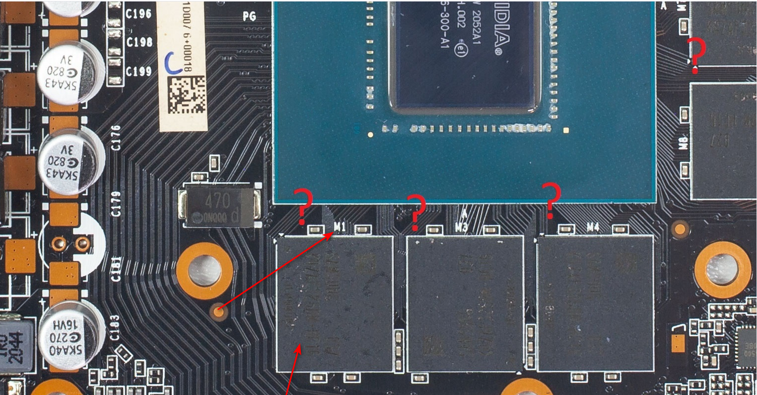

    Hello, one of the vrams of my palit rtx 3060 model graphics card is showing as faulty. I will replace the faulty vram with a new one, but I could not find out the locations of the vrams. Does anyone know the location map such as a0, a1, b0, b1?

    VGA diag can detect bad bit , A00-A31 correspond to memory M1Click image for larger version

      I am trying to continue with it. Can someone who knows m1 mark the locations on the pcb photo?

          I removed it from another card and changed the m1 location and the one right next to it 5 or 6 times but it still didn't work. Are you sure that the M1 location is A0?
          • tarikabak
            • Jul 2020
            • 7
            • Türkiye
            I found and learned the vram order by disassembling the vrams one by one and testing the vram each time. For the Palit RTX 3060 12 GB model, the bottom left A1 side goes as A0, B1 and B0, the last vram is D0 and I repaired the video card.
