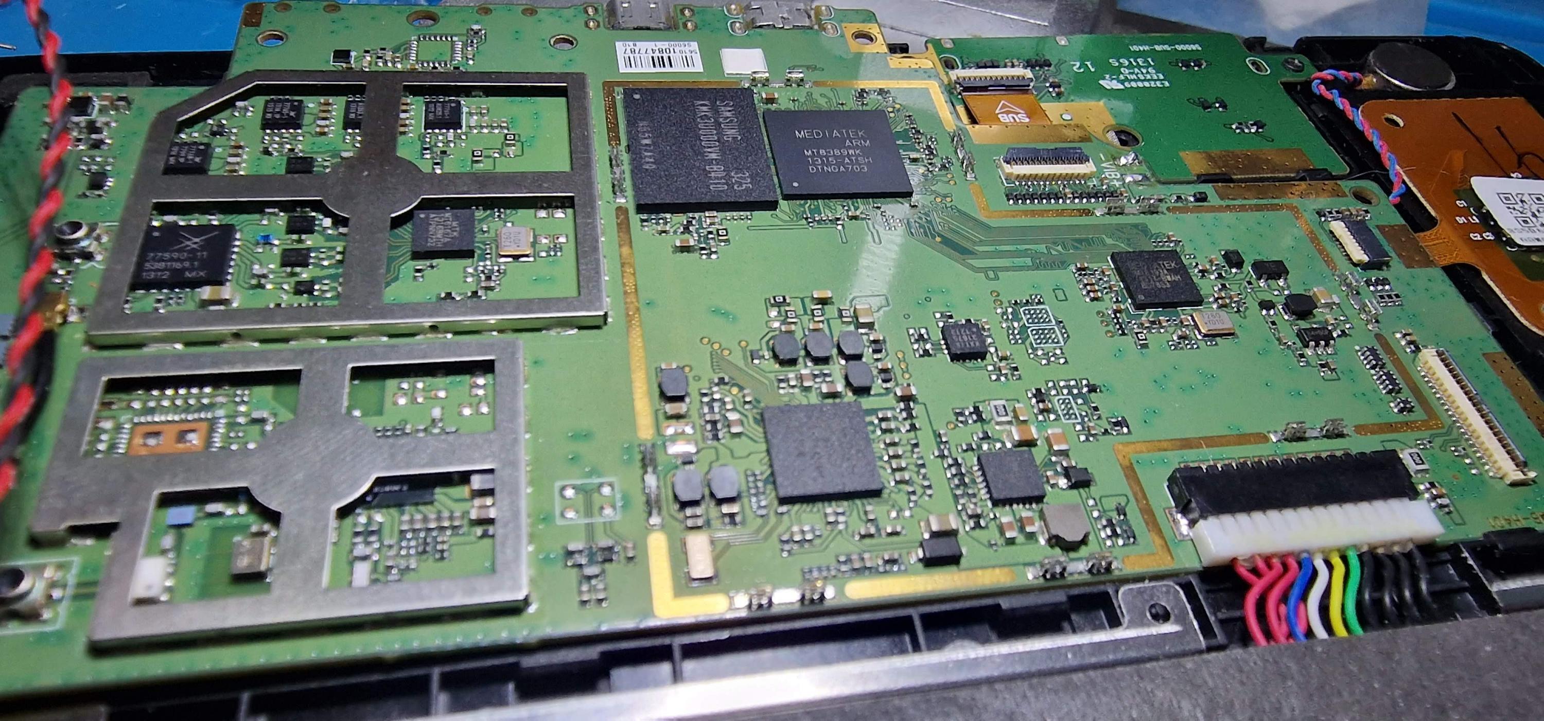

    Here I have the mentioned tablet with motherboard s6000-mb-h401. The tablet won't turn on, no display, charging normally. I manage to connect to UART port and got this output when I try to start it:

    Seems like preloader problem, but I'm not sure how should I proceed? The main task is to recover the data from it. When plugged to a computer while off I hear a tone and that's it. Is it possible the data to be recovered in that state? And the secondary task is to fix it, if possible.
    What do you think? I have the same model in a fully working condition, provided by the person who want's the data back if that helps.
    Thanks.

    Is there a removable SD card on this thing? It appears the fault starts at [SD0].
    Respectively, search for this same sd card on the working machine.
    What is the log status of the working machine? Any issue with the [SD0] section of the boot?

      SD card connector is placed on a daughter board which is not connected while testing.
      This is the log of the working one (again the daughter board is disconnected, but the tablet is fully working):

      [PLFM] Init PMIC: OK(0)
      [PLFM] chip[CA00]
      [BLDR] Build Time: 20130906-141630
      ==== Dump RGU Reg ========
      RGU MODE:   6D
      RGU LENGTH:  FFE0
      RGU STA:   0
      RGU INTERVAL: FFF
      RGU SWSYSRST: 0
      ==== Dump RGU Reg End ====
      RGU: g_rgu_satus:0
       mtk_wdt_mode_config mode value=2D, tmp:22000030
      PL P ON
      WDT does not trigger reboot
       mtk_wdt_mode_config mode value=70, tmp:22000071
      kpd register for pmic set!
      mt_usb_calibraion: input_reg = 0x0
      mt_usb_calibraion: term_vref = 0x0, clkref = 0x0, vrt_vref = 0x0,
      [RTC] bbpu = 0x1, con = 0x8407
      rtc_first_boot_init
      [RTC] get_frequency_meter: input=0x0, ouput=5
      [RTC] get_frequency_meter: input=0x0, ouput=3967
      get frequency time out
      [RTC] get_frequency_meter: input=0x0, ouput=0
      [RTC] irqsta = 0x0, pdn1 = 0x0, pdn2 = 0x201, spar0 = 0x40, spar1 = 0x800
      [RTC] new_spare0 = 0x0, new_spare1 = 0x1, new_spare2 = 0x1, new_spare3 = 0x1
      [RTC] bbpu = 0x1, con = 0x424
      pl pmic powerkey Press
      power key is pressed
      [PLFM] Power key boot!
      [RTC] rtc_bbpu_power_on done
      [SD0] Bus Width: 1
      [SD0] SET_CLK(260kHz): SCLK(259kHz) MODE(0) DDR(0) DIV(193) DS(0) RS(0)
      [SD0] Switch to High-Speed mode!
      [SD0] SET_CLK(260kHz): SCLK(259kHz) MODE(2) DDR(1) DIV(96) DS(0) RS(0)
      [SD0] Bus Width: 8
      [SD0] Size: 14910 MB, Max.Speed: 52000 kHz, blklen(512), nblks(30535680), ro(0)
      [SD0] Initialized
      [SD0] SET_CLK(52000kHz): SCLK(50000kHz) MODE(2) DDR(1) DIV(0) DS(0) RS(0)
      msdc_ett_offline_to_pl: size<2> m_id<0x15>
      msdc <0> <HYNIX > <K3U00M>
      msdc <1> <xxxxxx> <K3U00M>
      msdc failed to find
      found:1,i:0
      [EMI] DDR2
      [EMI] eMMC/NAND ID = 15,1,0,4B,33,55,30,30,4D
      [EMI] MDL number = 0
      [MEM] 1066 MHZ
      rank 0 coarse = 15
      rank 0 fine = 56
      10:|  0  0  1  1  1  0
      opt_dle value:8
      rank 1 coarse = 15
      rank 1 fine = 56
      10:|  0  0  1  1  1  0
      opt_dle value:8
      byte:0, (DQS,DQ)=(8,9)
      byte:1, (DQS,DQ)=(8,B)
      byte:2, (DQS,DQ)=(8,8)
      byte:3, (DQS,DQ)=(8,A)
      [EMI] DRAMC calibration passed
      [EMI] DQSINCTL:50000
      [MEM] complex R/W mem test pass
      mt8193_init() enter
      mt8193_i2c_init() enter
      [I2C][PL] [i2c2 set speed] Set sclk to 99 khz (orig: 100 khz)
      mt8193_i2c_init() exit
      [I2C][PL] [i2c2 write] i2c transaction complate
      [I2C][PL] [i2c_read] read byte = 0x2
      [I2C][PL] [i2c_read] read byte = 0x0
      [I2C][PL] [i2c_read] Done
      [I2C][PL] [i2c_read] read byte = 0x82
      [I2C][PL] [i2c_read] read byte = 0x1
      [mt8193_i2c_write] Reg[0x1254]=0x182
      [mt8193_i2c_write] Reg[0x121C]=0x0
      set_CKGEN_NFI_PIN_GPIO
      [I2C][PL] [i2c_read] read byte = 0x49
      [I2C][PL] [i2c_read] read byte = 0x92
      [mt8193_i2c_write] Reg[0x1204]=0x49249
      [mt8193_i2c_write] Reg[0x121C]=0x8000000
      [I2C][PL] [i2c_read] read byte = 0x9B
      [I2C][PL] [i2c_read] read byte = 0x24
      [mt8193_i2c_write] Reg[0x1220]=0x1249B
      [I2C][PL] [i2c_read] read byte = 0x7F
      [mt8193_i2c_write] Reg[0x1258]=0x7F
      [I2C][PL] [i2c_read] read byte = 0xFF
      [mt8193_i2c_write] Reg[0x1260]=0xFF
      mt8193_init() exit
      [PLFM] Init Boot Device: OK(0)
      ============func=load_pt_from_fixed_addr===scan pmt from 700000=====
      find pt at 700000
      next pt 0
      64bit parse PMT
      find pt
      part PRELOADER size 0000000000000000 0000000000600000
      part MBR size 0000000000600000 0000000000080000
      part EBR1 size 0000000000680000 0000000000080000
      part __NODL_PMT size 0000000000700000 0000000000400000
      part __NODL_PRO_INFO size 0000000000B00000 0000000000300000
      part __NODL_NVRAM size 0000000000E00000 0000000000500000
      part __NODL_PROTECT_F size 0000000001300000 0000000000A00000
      part __NODL_PROTECT_S size 0000000001D00000 0000000000A00000
      part __NODL_SECCFG size 0000000002700000 0000000000020000
      part UBOOT size 0000000002720000 0000000000060000
      part BOOTIMG size 0000000002780000 0000000000600000
      part RECOVERY size 0000000002D80000 0000000000600000
      part SEC_RO size 0000000003380000 0000000000600000
      part __NODL_MISC size 0000000003980000 0000000000080000
      part LOGO size 0000000003A00000 0000000000300000
      part EBR2 size 0000000003D00000 0000000000080000
      part __NODL_EXPDB size 0000000003D80000 0000000000A00000
      part FAC size 0000000004780000 000000000C800000
      part ANDROID size 0000000010F80000 0000000040000000
      part CACHE size 0000000050F80000 0000000007E00000
      part USRDATA size 0000000058D80000 0000000349FA0000
      [PART] blksz: 512B
      [PART] [0x0000000000000000-0x00000000005FFFFF] "PRELOADER" (12288 blocks)
      [PART] [0x0000000000600000-0x000000000067FFFF] "MBR" (1024 blocks)
      [PART] [0x0000000000680000-0x00000000006FFFFF] "EBR1" (1024 blocks)
      [PART] [0x0000000000700000-0x0000000000AFFFFF] "PMT" (8192 blocks)
      [PART] [0x0000000000B00000-0x0000000000DFFFFF] "PRO_INFO" (6144 blocks)
      [PART] [0x0000000000E00000-0x00000000012FFFFF] "NVRAM" (10240 blocks)
      [PART] [0x0000000001300000-0x0000000001CFFFFF] "PROTECT_F" (20480 blocks)
      [PART] [0x0000000001D00000-0x00000000026FFFFF] "PROTECT_S" (20480 blocks)
      [PART] [0x0000000002700000-0x000000000271FFFF] "SECURE" (256 blocks)
      [PART] [0x0000000002720000-0x000000000277FFFF] "UBOOT" (768 blocks)
      [PART] [0x0000000002780000-0x0000000002D7FFFF] "BOOTIMG" (12288 blocks)
      [PART] [0x0000000002D80000-0x000000000337FFFF] "RECOVERY" (12288 blocks)
      [PART] [0x0000000003380000-0x000000000397FFFF] "SECSTATIC" (12288 blocks)
      [PART] [0x0000000003980000-0x00000000039FFFFF] "MISC" (1024 blocks)
      [PART] [0x0000000003A00000-0x0000000003CFFFFF] "LOGO" (6144 blocks)
      [PART] [0x0000000003D00000-0x0000000003D7FFFF] "EBR2" (1024 blocks)
      [PART] [0x0000000003D80000-0x000000000477FFFF] "EXPDB" (20480 blocks)
      [PART] [0x0000000004780000-0x0000000010F7FFFF] "FAC" (409600 blocks)
      [PART] [0x0000000010F80000-0x0000000050F7FFFF] "ANDSYSIMG" (2097152 blocks)
      [PART] [0x0000000050F80000-0x0000000058D7FFFF] "CACHE" (258048 blocks)
      [PART] [0x0000000058D80000-0x0000000018D7FFFF] "USER" (-2097152 blocks)
      [ROM_INFO] 'v2','0x2700000','0x20000','0x3380000','0x2C00'
      [SEC_K] SML KEY AC = 0
      [SEC_K] SBC_PUBK Found
      [SEC] AES Legacy : 0
      [SEC] SECCFG AC : 1
      [SEC] read '0x2700000'
      0x0,0x0,0x0,0x0,0x0,0x0,0x0,0x0,
      [LIB] SecLib.a '20121226-155014'
      [LIB] CFG read size '0x4000' '0x1860'
      [LIB] Name =
      [LIB] Config = 0x22, 0x22
      0x31,0x41,0x35,0x35
      [platform_vusb_on] PASS
      [TOOL] <UART> wait sync time 150ms->103ms
      [TOOL] <UART> receieved data: ()
      [PART] Image with part header
      [PART] name : LK
      [PART] addr : FFFFFFFFh
      [PART] size : 255900
      [PART] magic: 58881688h
      [PART] load "UBOOT" from 0x0000000002720200 (dev) to 0x81E00000 (mem) [SUCCESS]
      [PART] load speed: 16660KB/s, 255900 bytes, 15ms
      [SECRO] Don't read
      [AUTHEN] rsa.N length = 1024 bytes
      [AUTHEN] rsa.E length = 20 bytes
      [LIB] NS-CHIP
      [LIB] Don't check
      Device APC domain init setup:
      0:dram_rank_size:20000000
      1:dram_rank_size:20000000
      [PLFM] boot reason: 0
      [PLFM] boot mode: 0
      [PLFM] META COM0: 0
      [PLFM] <0x800A0008>: 0x0
      [PLFM] boot time: 2490ms
      [BLDR] jump to 0x81E00000
      [BLDR] <0x81E00000>=0xEA000007
      [BLDR] <0x81E00004>=0xEA00713C
      [PROFILE] ------- i2c init takes 0 ms --------
       mtk_wdt_mode LK config mode value=71
       mtk_wdt_mode_config LK mode value=30, tmp:22000030
      UB wdt init
       mtk_wdt_mode LK config mode value=30
       mtk_wdt_mode_config LK mode value=79, tmp:22000079
      [LEDS]LK: leds_init: mt65xx_backlight_off
      [LEDS]LK: mt65xx_backlight_off
      [LEDS]LK: lcd-backlight level is 0
      [LEDS]LK: backlight_set_pwm:duty is 0
      [PROFILE] ------- led init takes 3 ms --------
      [LEDS]LK: isink_init: turn on PMIC6320 isink
      DISP/disp common log enabled
      DISP/lcd log enabled
      DISP_Init, 593
      [DSS]disp_path_ddp_clock_on
      DISP/DISP_Init, 597
      DISP/DISP_Init, 602
      DISP/DISP_Init, 608
      DISP/DISP_Init, 631
      DISI_MODULE_DPI0
      RDMA: w=1280, h=800, pitch=3840, mode=0
      [DDP] disp_bls_config : gBLSMutexID = 3
      DISP/DPI_Set_DrivingCurrent not implement for 6575[LK/LCM] lcm_init()
      [DISP] - uboot - DSI_PowerOn. 0x    0,0x    0,0x    0
      [DISP] - uboot - DSI_PowerOff. 0x    0,0x    0,0x    0
      DISP/DISP_Init, 636
      DISP/DISP_Init, 651
      [PROFILE] ------- disp init takes 9 ms --------
      ... And So On ...

        Re: Lenovo S6000 won't turn on. Data recovery needed.
        Any suggestions, anyone? How would you proceed?
