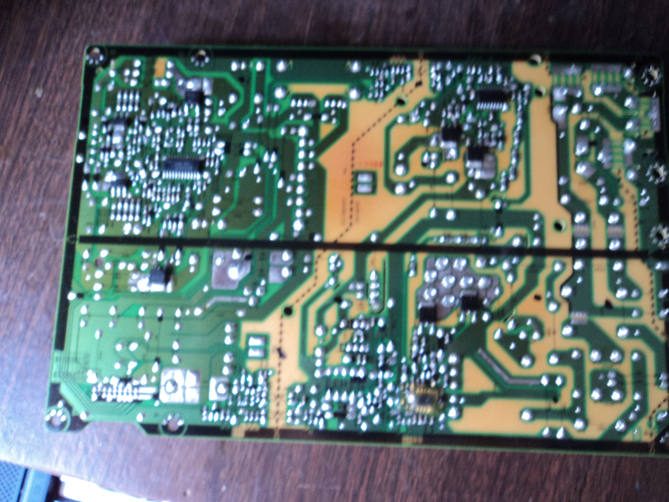

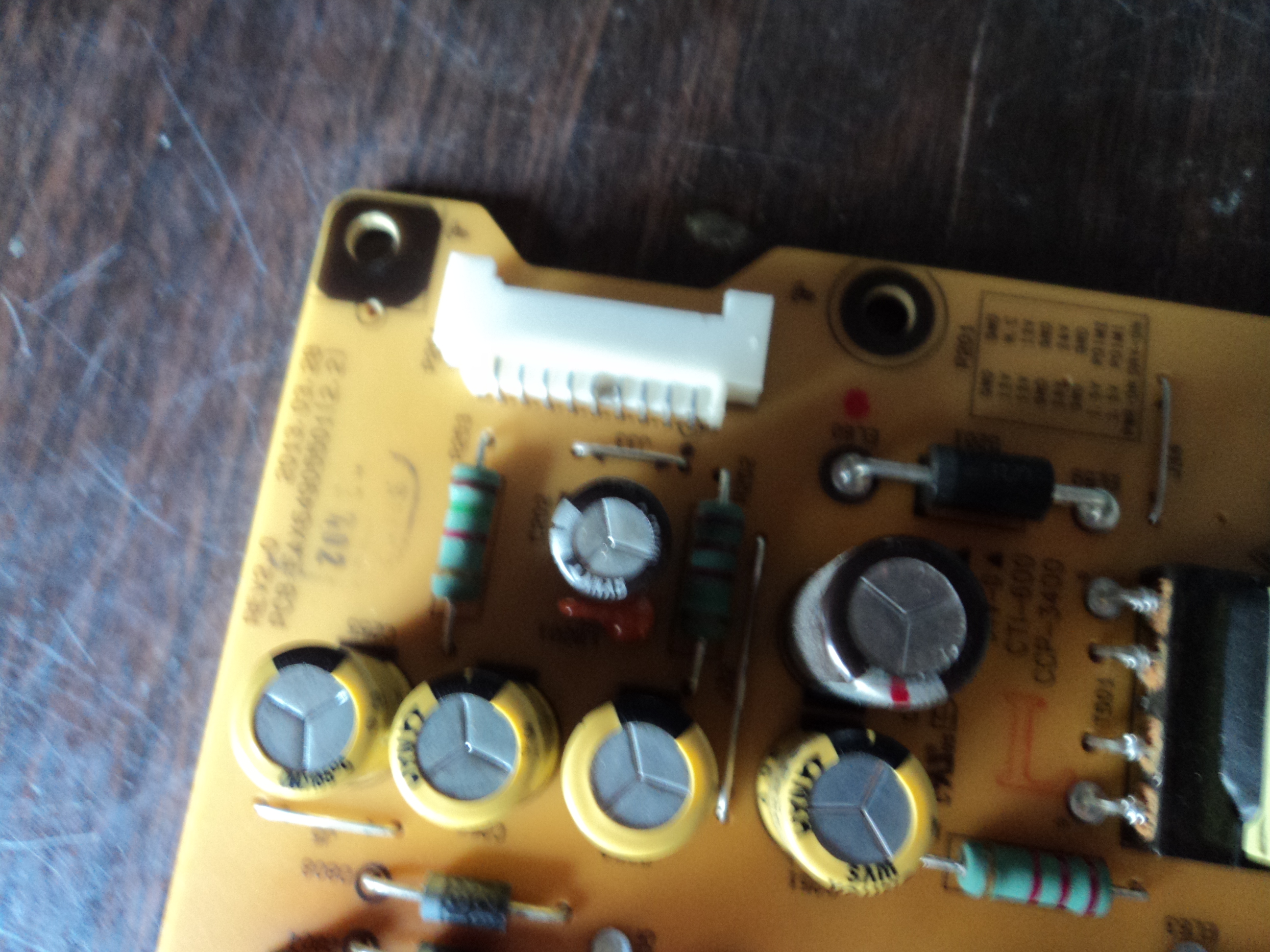

    Hi guys i found this Lg 50LN5100 out in the curve,and powered it up and there is a red light and i push the power button and i have a quick glow of the screen and turns black,i was checking P201 pins and i have 3.5v pin 1 i had the 12v 24 v but i was shaking when measuring volts and skipped toughed pins 5 6 at same time gnd and 24 v i had a small short i notice a little black on both pins,it mean whatever that was bad on the tv maybe now has more damadge, tv still shows standby red light and when pushing power on it glows the screen for second and goes dead.Any advice please thanks.

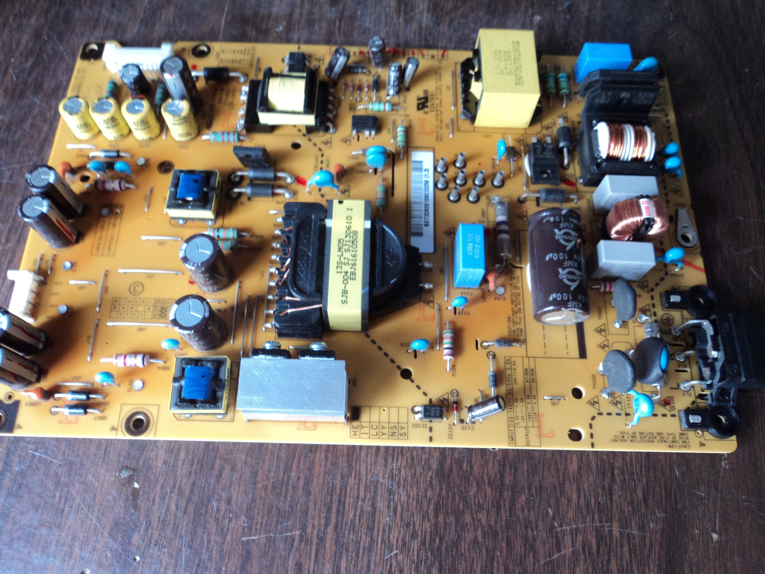

    Images of the boards I cant get on SJ ? Also check how to test the Led backlight voltages sounds to me like a failed Led.

      Thanks reeceyBurger; well i send some pic of the power supply and showing the 2 pins that i tripped and toughed together making a small burn,on the 24v and GND,before i open panel to check for any burned led ,i would like to know what to check for the 24v that were there before i shorted these connections,where is the 24v regulator,i checked all the regulators in circuit with Diode check and they seem to be ok any clues before i go to led panel will be welcome and appreciated, sorry for the pics that are not very good due a crappy camera.

        Here a missed pic of the Power board
