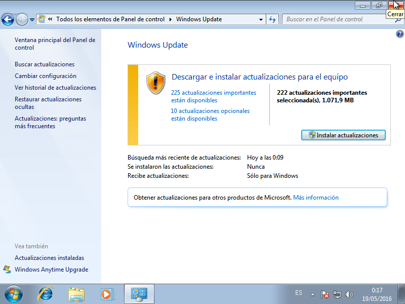

                              After integrating the update in a clean W7 SP1 DVD this is what i get, 222 updates and more than 1 Gb to download WTF

                                Re: MS releases "unofficial SP2" Windows Update pack for Win7 SP1 and 2008 R2
                                Click on that and see what's actually left to download.
                                My guess is that they're .Net updates that showed up because after you installed Windows, you installed drivers (like the AMD crimson video card driver) that have .Net based applications ... and possibly a whole bunch of Internet Explorer updates and killbits for ActiveX crap (only in IE).
                                ps. or could it be that the packs are ENGLISH only and you're using a Spanish language ISO or something like that? - i don't know, i didn't test this pack yet.
                                  By default .NET 3.5 is part of W7 so there are a few updates of it, but many security and optional updates too, i haven't installed any driver since it's a virtual machine, i have attached the complete list of installed updates by default (GWX included of curse ).
