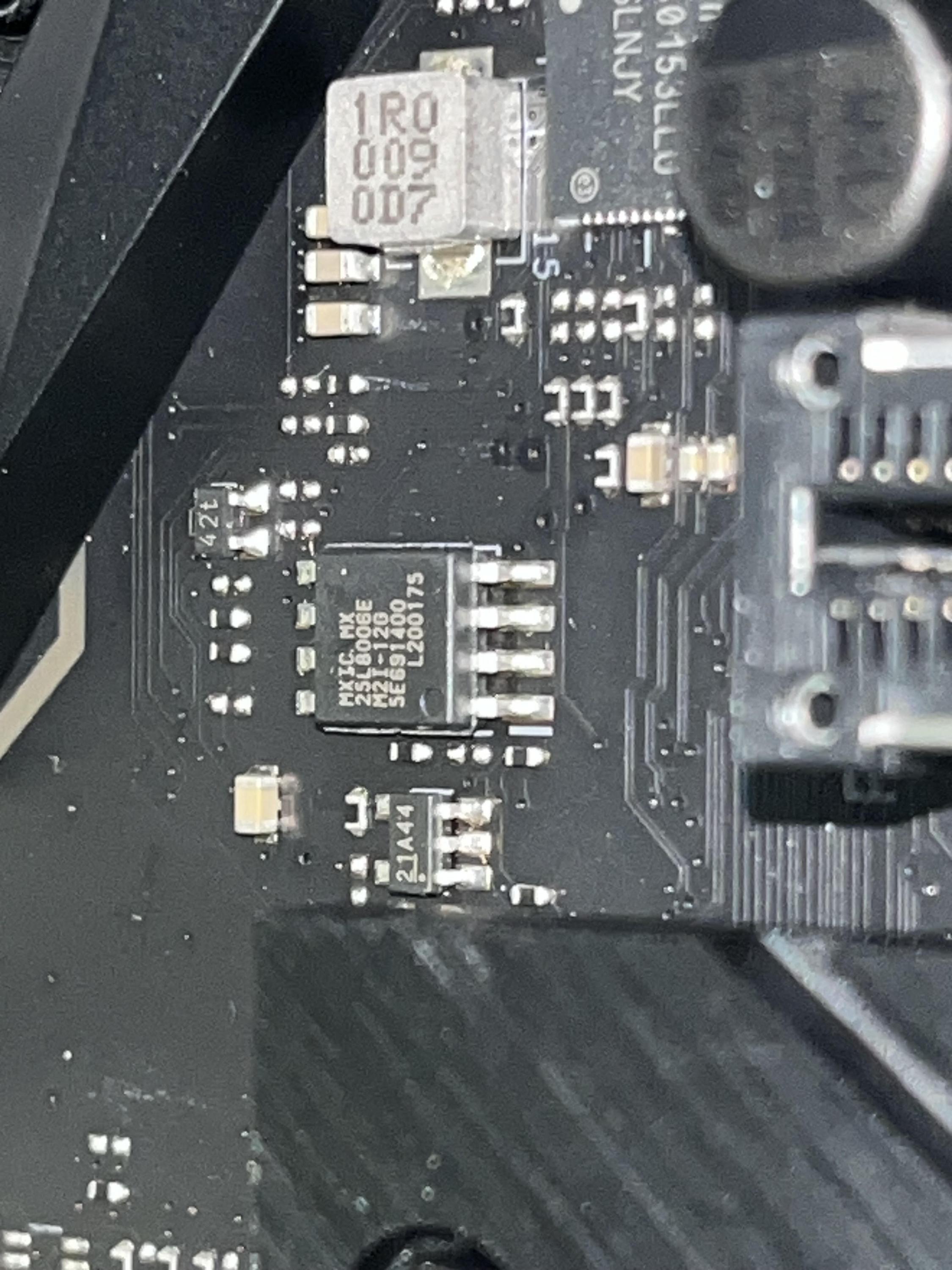

I had to assemble a PC with this Z490-F Gaming motherboard and an i7-1700K CPU. Upon the first boot, the CPU LED was red and flashing. I realized that I needed to update the BIOS. I didn't read the ASUS notice that said, "Before BIOS update, please download Intel ME update tool from ASUS support site, and update ME firmware to Version 14.1.53.1649V1.1 to ensure optimized system settings." I updated the BIOS without doing this, and everything seemed fine until the system performed an Intel ME update and shut down permanently. My attempts to reflash it were unsuccessful. Searching online, I found several people who had the same issue, and some of them resolved it with a ch341a.
z490-f gaming bricked after bios update
Re: z490-f gaming bricked after bios update
I had to assemble a PC with this Z490-F Gaming motherboard and an i7-1700K CPU. Upon the first boot, the CPU LED was red and flashing. I understood that I needed to update the BIOS, and I performed the update using the USB flashback method. I didn't read the ASUS notice, which said, "Before BIOS update, please download Intel ME update tool from ASUS support site, and update ME firmware to Version 14.1.53.1649V1.1 to ensure optimized system settings." I updated the BIOS, and everything seemed fine until the system executed an Intel ME update and shut down permanently. My attempts to reflash it were unsuccessful. Searching online, I found several people who had the same issue, and some of them resolved it with ch341a. -

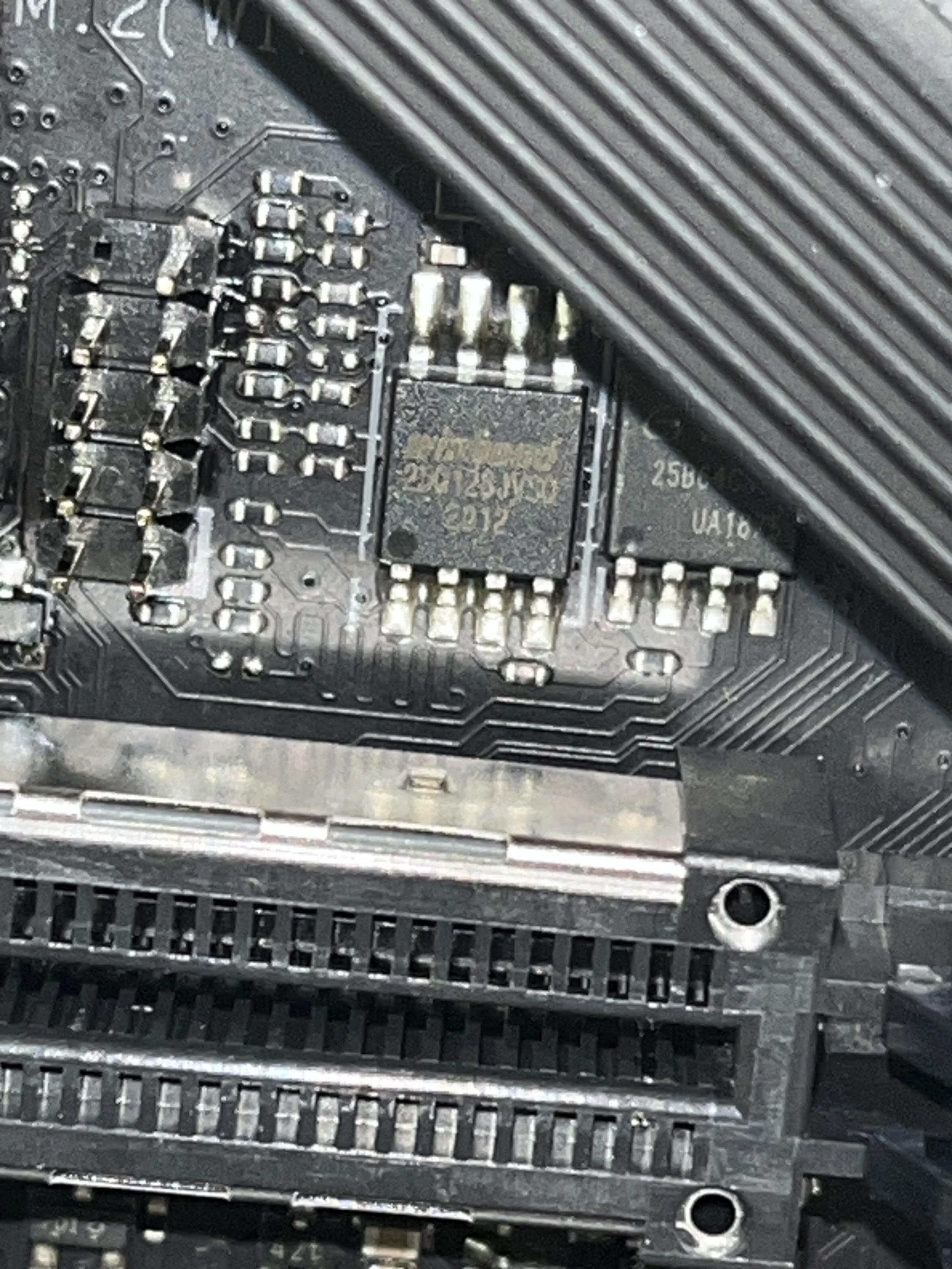

z490-f gaming request extract fd from capsule
I have this bricked card, and I need to extract the FD file to write to the small 64 MB flash, the card got bricked during an update by IntelComment
Re: z490-f gaming request extract fd from capsule
Download UEFITool https://github.com/LongSoft/UEFITool..._A59_win32.zip
Open the bios with UEFITool and choose "Action" -> "Capsule" -> "Extract body"
Save as *.rom or *.bin
.Comment
