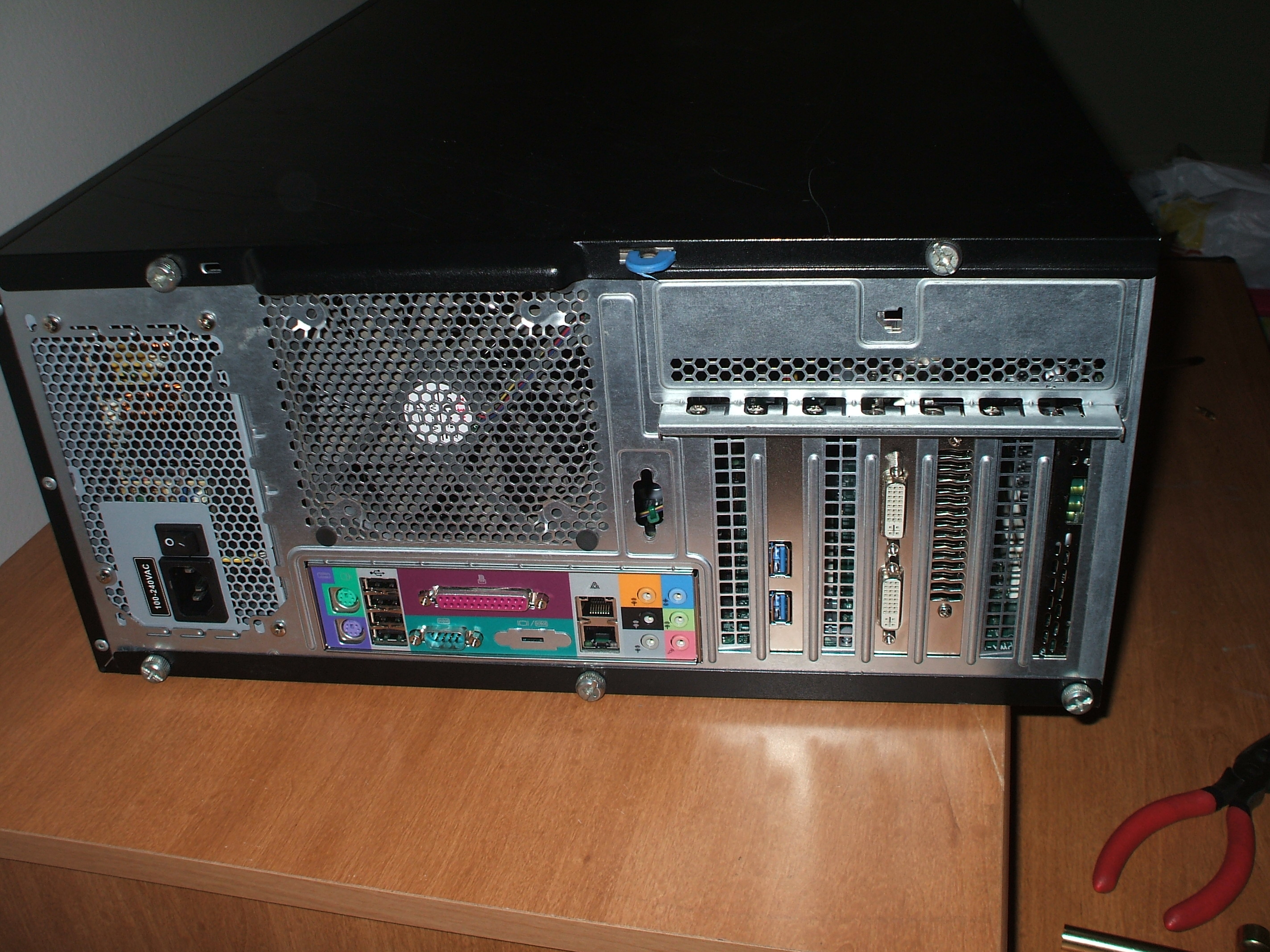

      I found some standoffs yesterday so I went ahead and built it up.
      Some pictures and specs:
      Front (with new card reader):
      The guts (just doing an overview due to free time... I wanted to get it running!):
      -Supermicro X7DWA-N motherboard (I won't say where it came from, that's Topcat's story to tell)
      -Twin Intel Xeon E5472 (3.0GHZ, 1600FSB, quad core)
      -32GB DDR2 Fully Buffered
      -Supermicro Socket 771 coolers
      -Supermicro SAS RAID card (Adaptec based). Array is RAID 0.
      -USB 3.0 Card + AFT Pro-37U USB 3.0 Card reader
      While it can't do SLI, its in pretty much every other way a massive upgrade compared to the old (and now dead) Tyan K8WE. Once I get a better GPU (and beefier PSU if necessary), it will really fly.
      I'll novabench it and post the results.
      Question: Windows 7 says only 24GB of my 32GB of ram is usable... and I'm on Ultimate x64. The other day it said 28... Supposedly 7 Ultimate x64 can do up to 192GB?

                  #48
                  Re: Ratdude's main rig V5.0
                  Reseat all the RAM sticks.

                  • ratdude747
                    Black Sheep
                    • Nov 2008
                    • 17136
                    #49
                    No, all 32GB is shown, it's just not usuble.

                    • RJARRRPCGP
                      • Jul 2004
                      • 6304
                      #50
                      I heard that a RAM malfunction may cause Windows Vista and later to falsely report the RAM being "reserved".

                        #51
                        Run memtest on it.

                            • Topcat
                              The Boss Stooge
                              • Oct 2003
                              • 16956
                              #54
                              Strange about the memory....IDENTICAL setup in my office running S2K8 R2, which is win7. All memory shows up and is usable.
                              It was fine when it was here.....I'd memtest it for sure, after re-seating everything.

                                    • ratdude747
                                      Black Sheep
                                      • Nov 2008
                                      • 17136
                                      #58
                                      Found the issue... Lack of cooling!
                                      Apparently one does indeed have to actively cool the RAM... I wasn't and noticed HW montor reporting RAM temps over 100C! eek!
                                      I bodged a 80mm fan from a dumpster find for now... LOUD but effective, all 32GB showing. I may try using one of the 92MM cooler master fans from the 3.5 coolers as it's PWM and will be quieter hopefully.
                                      sigpic
