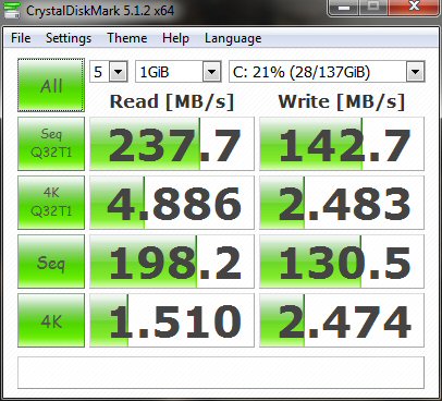

            Go figure. I couldn't get it to work for me... I'll look into it. I'd be curious to see what crystaldiskbenchmark has to say about your speeds.
            I'm not using any right now, but when I was I used the stuff from Adaptec directly.
            Nothing spectacular compared to SSD, but not the worst I've seen.

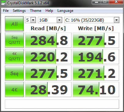

            Just for grins, this is what the Paxville system scored running the same tests:
            ...and this was the same test on a SSD on the RoG Maximus Formula:

              Obviously RAID 10 doesn't read the same way RAID0 does. Assuming 4 drives on your end. I ask because technically one CAN read 4 drives in a RAID 10 at once in the same way you can read 4 drives in a RAID 0. Write, obviously not.
              I'll probably go back to RAID 0 purely for performance reasons:
              Yeah, awesome sauce.

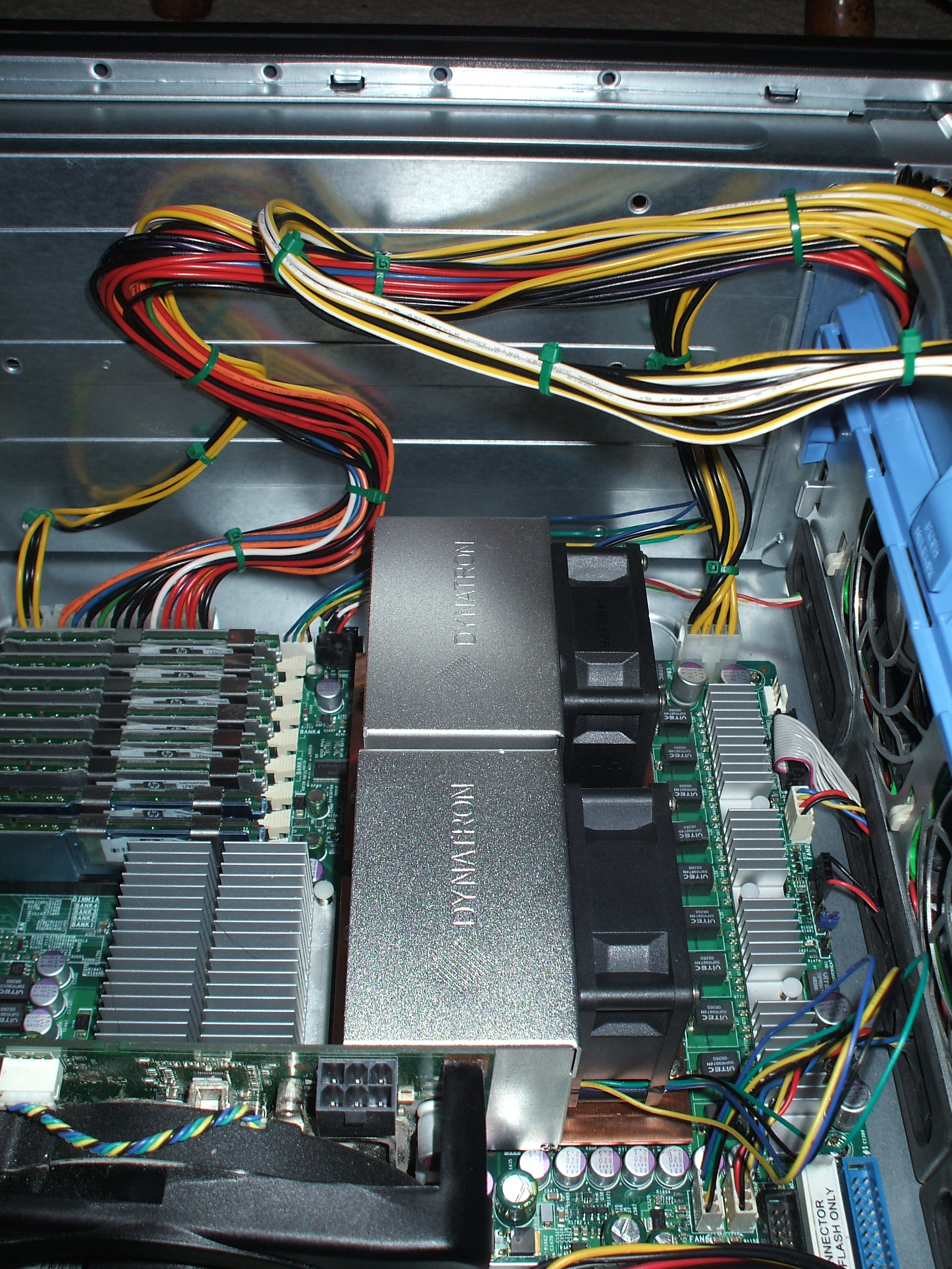

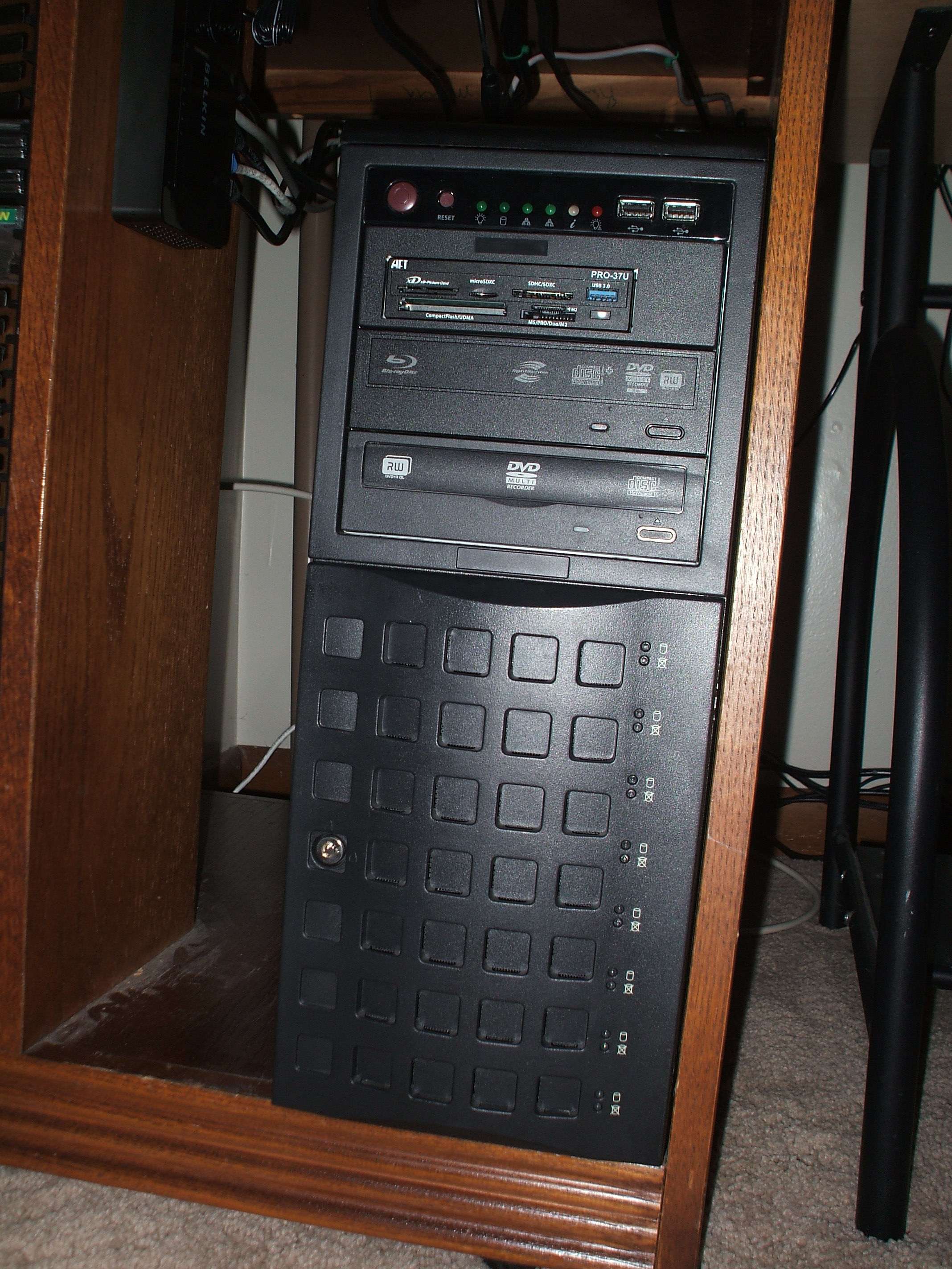

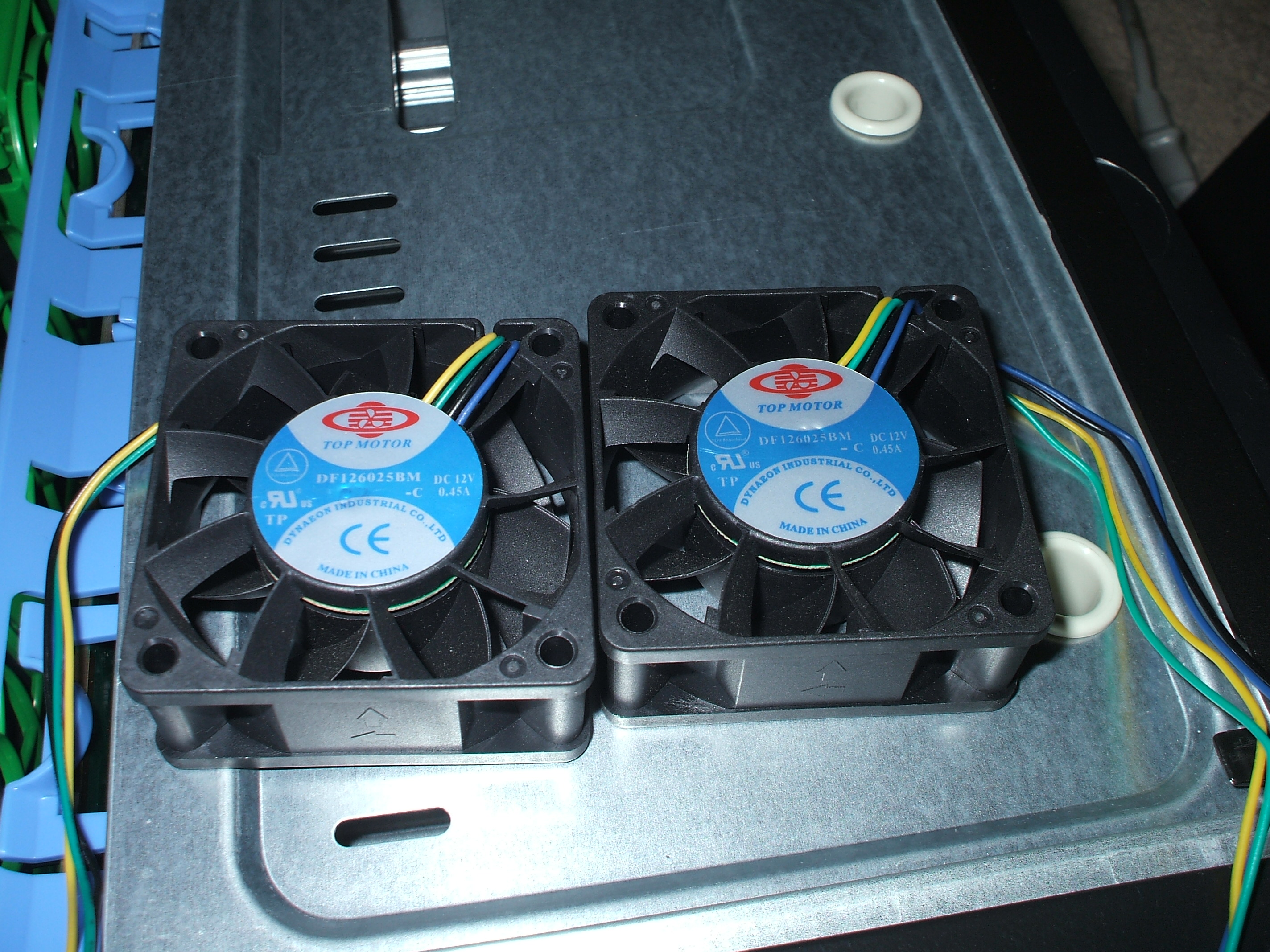

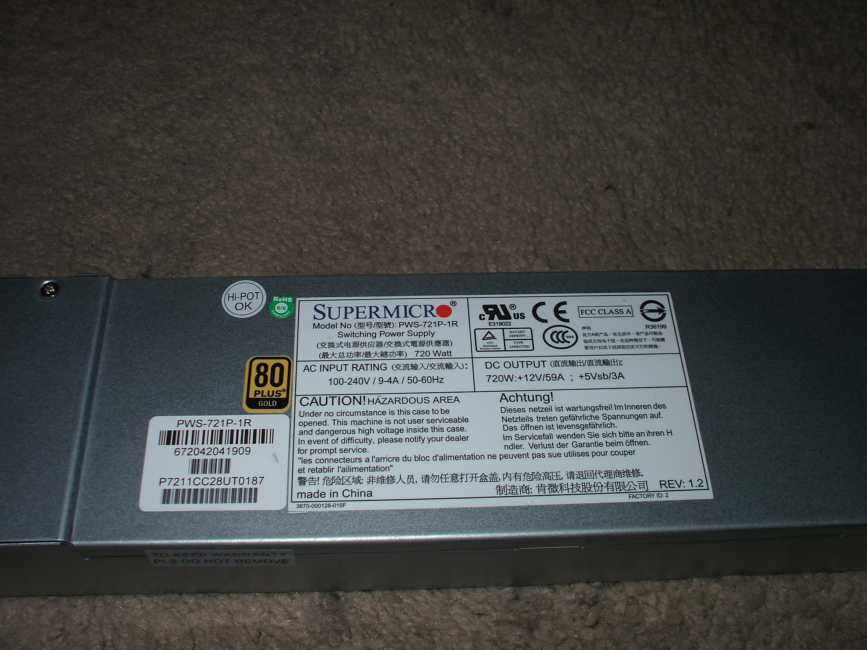

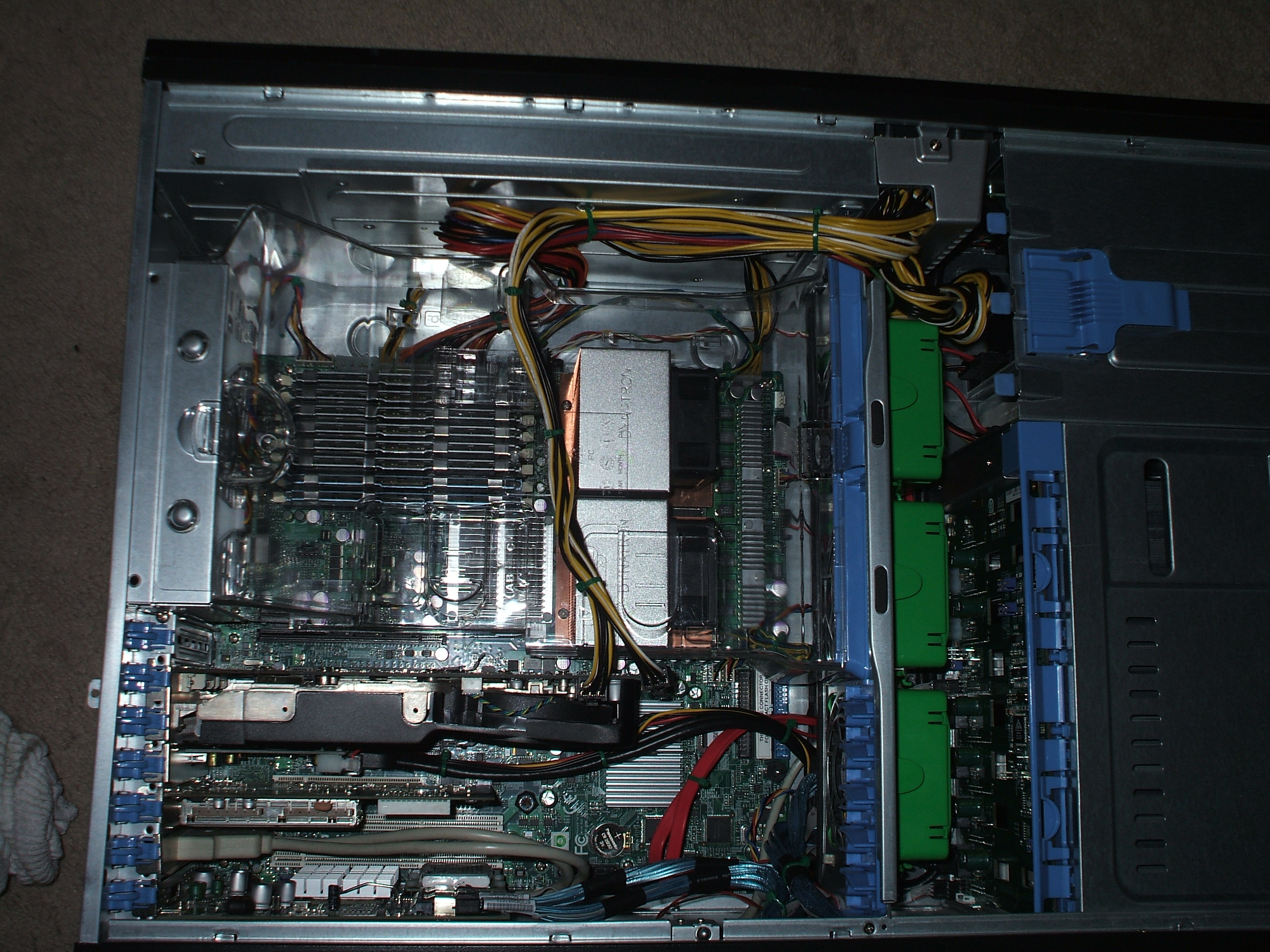

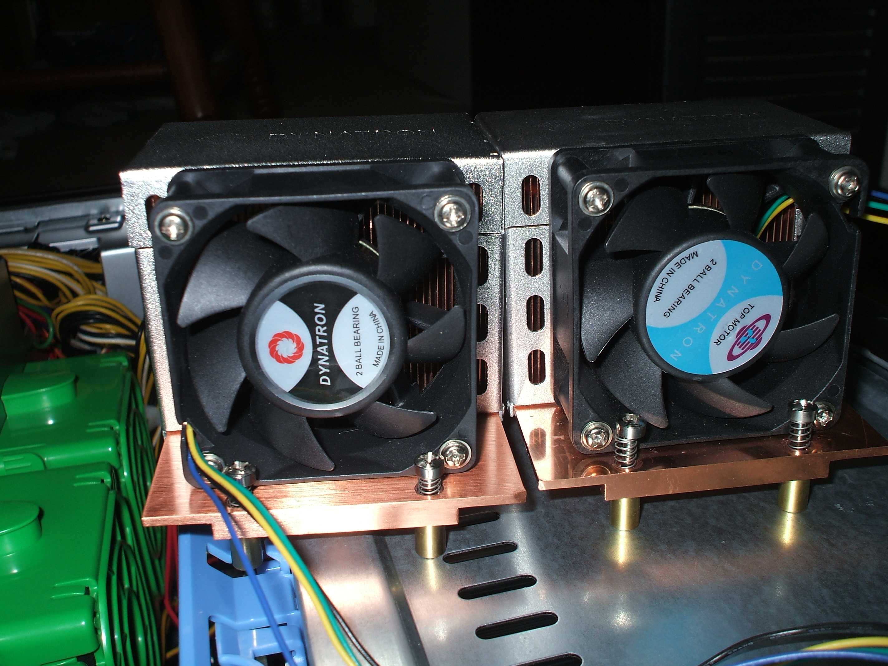

                    PSU and fans came in. The good news is that the temps are down... the bad news is it will still be loud... And you in the back whose screaming "look how easy my i5 was to set up and it's faster...", this thread isn't for you
                    New PSU:
                    New Cooler fans:
                    Fans installed (the front stickers don't match but they're the same fans):
                    Coolers installed:
                    Air dam installed, final shot of the guts:
                    Not sure if it shows, but the case included a molex extension that was perfect for zip tying to the USB 3.0 cable... less mess that way.
                    Butt Shot:
                    Front of the unit (yes the drive order is odd, it made the cable lengths work out better)

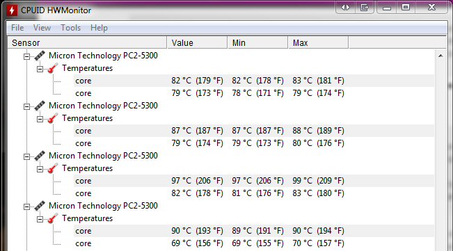

                    It's running cooler but on "superquiet" mode the temps are climbing a bit high... it's finally settled out with the hottest FBDIMM running at 89C. Not sure if it's bad as it's neighbors are running about 6C cooler:
                    What is a safe running temp for FBDIMMs?
                    I'm out of here for a bit... better reboot and turn up the fans a notch...

                        I'm running mine in the 'superquiet' mode, its makes no more noise than any 'off the shelf' system. What util are you using that reports RAM temps? CPUID doesn't display that info.
                        HW Monitor by CPUID.
                        Shows temps for 4 of the 8 Modules.
                        V4.1 runs in superquiet mode... Even in superquiet it was a bit whiney from the PSU. The PSU is quieter when it's off (standby) but when running it climbs a bit. I hear the 920W fixed that issue but it's not worth $90ish to play with.

                          Re: Ratdude's main rig V5.0
                          Mine are nice & toasty too....

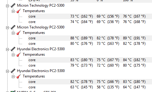

                            Holee Sheet!
                            Have you run them that hot w/o issue? I've read that the max case (of the hottest chip) temp is 85C to 95C.
                            That said the temps seem better on the "quiet" setting. I'll run that for now and see.
                            All I know is around 98 or so I had RAM dropping out.
                              I've never had trouble. I noticed theres some brand mis-matches in yours...or maybe you cooked a stick...but when it was here, it ran fine.... I didn't run them very long before the X8 motherboard came along. If the dropouts didn't cause instability or crashes, I may not have noticed.
