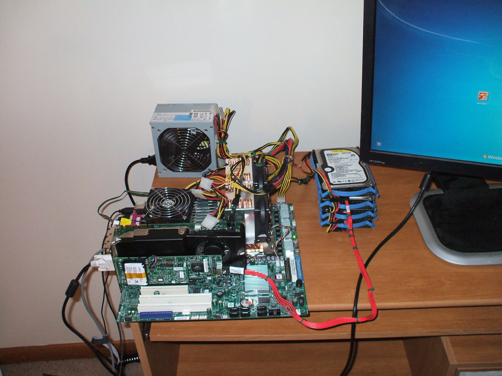

                        If worried about the PSU, bear in mind I ran one of these boards for over a year with 6x 10k HDD's on an Antec HE550. I had no issues at all. The CPU's are the "E" series, I've always been a fan of them. They run cool and use a lot less power.

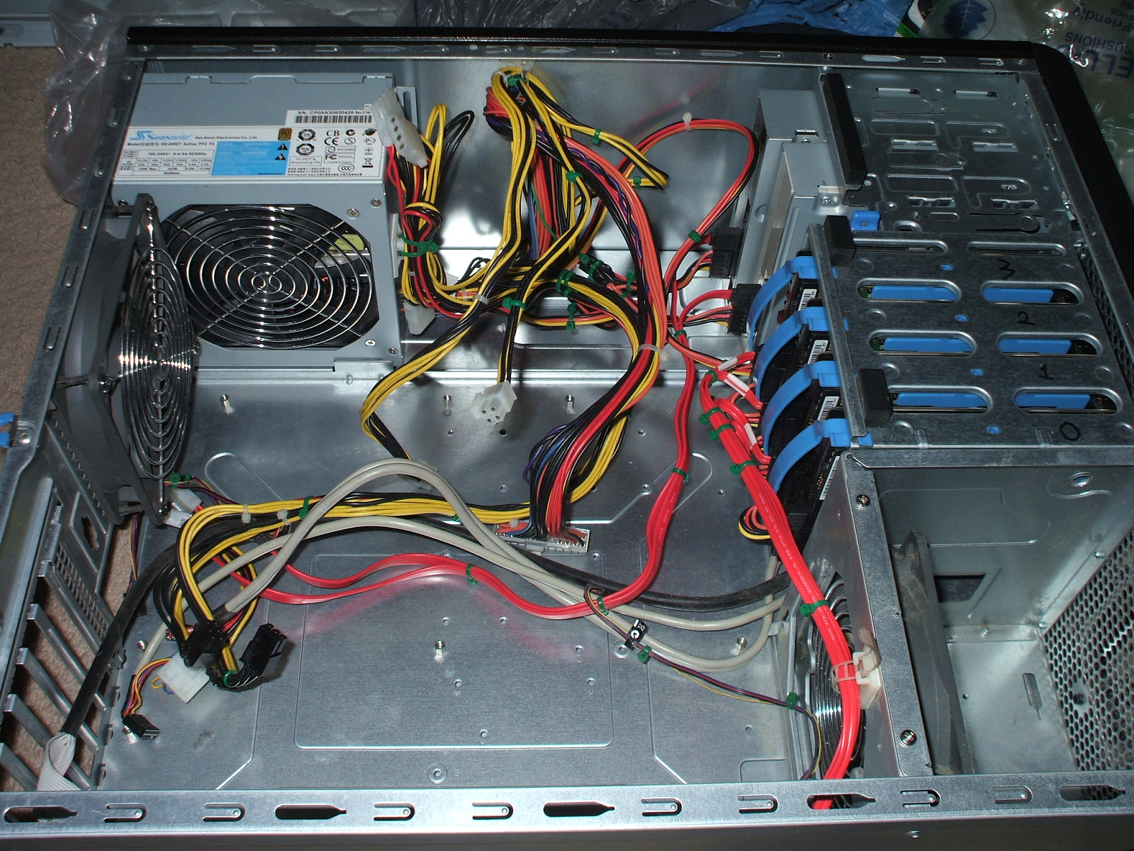

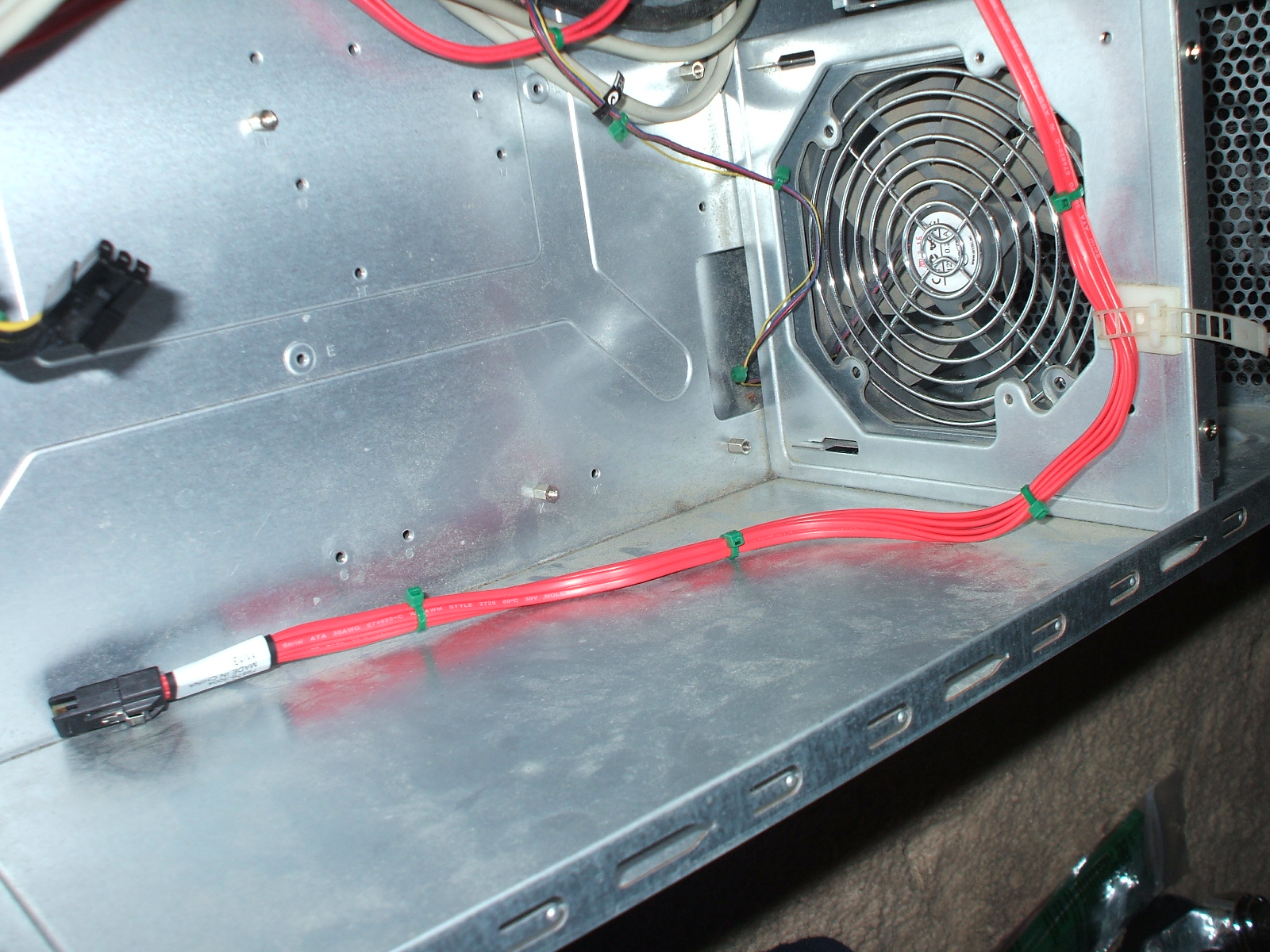

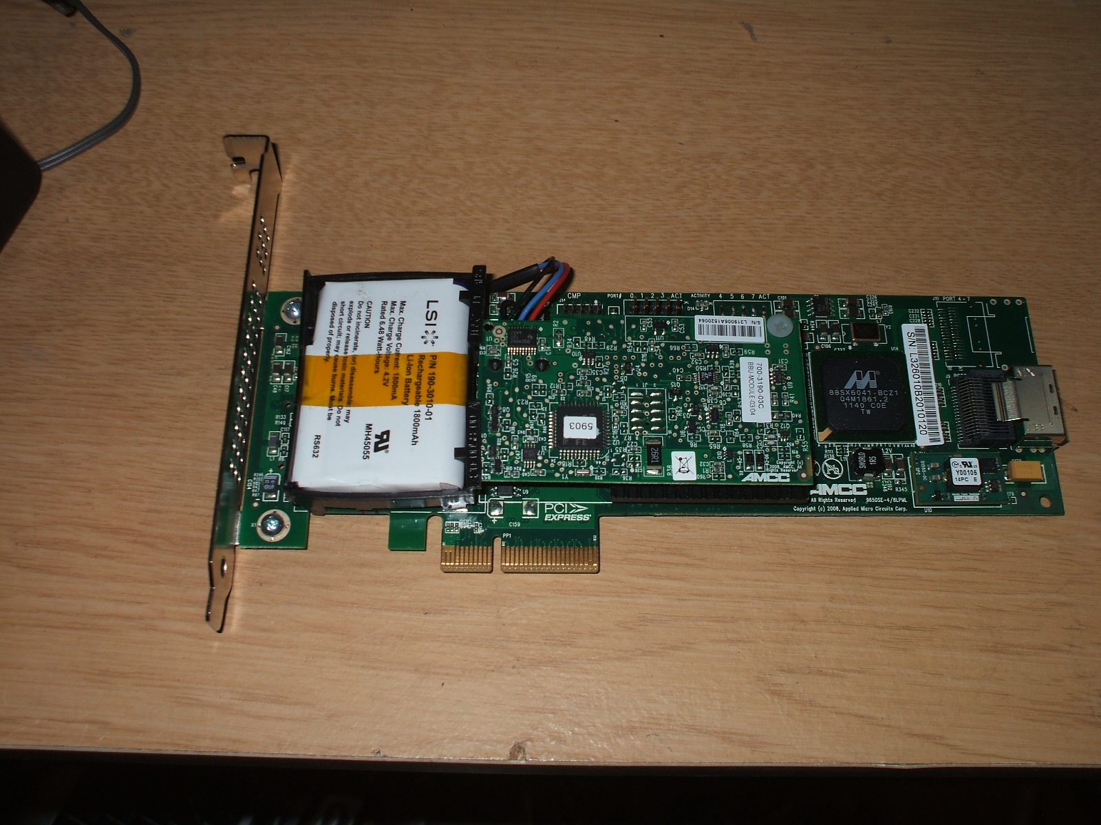

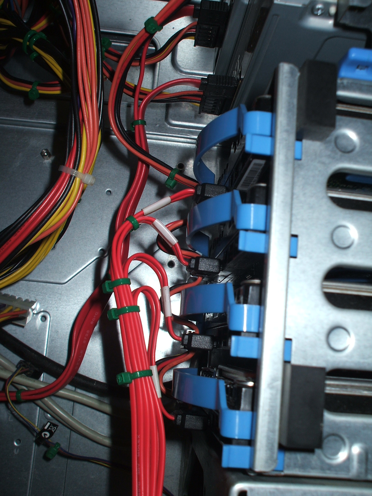

                            My first new part came in today... AMCC 9650 card with breakout cable. Since I bought that UIO card, I won't acutally need the card but I will need the cable. So, out came the zip ties
                            Some pics of my current progress:
                            Stripped out inside:
                            Man, my rig suddenly feels kinda gutless... (sorry, I had to)
                            I rebundled the PSU wires to roughly match the new guts. I kept the old dual PCI-E power setup as I may end up with a card that needs two six-pin power feeds (IDK). Luckily it looks like everything will fit.
                            Newly bundled SATA harness:
                            I think that looks a lot cleaner than the old setup.
                            Finally, the RAID card I won't be using:
                            I don't have a use for it so it will be a spare I guess. Unless topcat finds this post and wants it... and replies before I leave for STL tomorrow morning. (I'd put it up for sale but these cards sell so cheap these days...
                                That interface is actually called miniSAS aka miniSAS cable. I went through that when I got a controller with that interface but without the cable. I didn't know what they were called in order to obtain them....so a little googling answered that after some naughty words.

                                  Re: Ratdude's main rig V5.0
                                  Cya Sunday!
                                  Yeah, I had the same fun when setting up the 9650 in V4.1...
                                  Cya... I'll bring the HDDs, you bring the board, lol.

                                        Made it back from missouri... with board, CPUs, RAM, and spare BIOS chip in hand. The latter is because Topcat had a dead one to pull from and he thinks I'm going to brick it trying an SLIC mod... more on that in a bit.
                                        The bad news: I can't mount the board in the case yet. I don't have enough standoffs for the coolers to mount to... DOH! So for now, I'm running it on the bench:
                                        The UIO card and USB 3.0 goodies aren't in yet either, but at least I have the coolers.
                                        Anyway, it's bench tested fine (posting from it now) using the 9650 card and my old 7 install (also good for pulling my files; I may have to re-install to make the new RAID card work).
                                        There is one notable change from the X5 and X6 series boards, and thats the use of Phoenix BIOS instead of award. That means SLIC modding takes a different process... but still doable!
                                        I did just that... luckily, like the tyan boards, all I needed was the rom and a RW everything ACPI report... wham, bam, done. SLIC modded, no hotflashing or spare chips required!
                                        Since it is phoenix I may look into custom splash images (like I did on the k8W in 3.0) although it boots so quick that its probably not worth the effort...
                                        Anyway, that's all for now!

                                          USB3.0 gear and the UIO card came in.
                                          I copied all of my hard to-find (read: used to be on my server till the WD green took a shit this weekend) and redid the array... and re-installed windows 7.
                                          Here's the good and the bad about the Supermicro AOC-USAS-S8IR card:
                                          Good:
                                          -Adaptec chips, officially licensed (foil sticker included)
                                          -Has a BBU option (which I have)
                                          -Supports SAS and SATA I/II
                                          -Seems pretty fast
                                          -Has drivers in 7 from the start (SP1 at least).
                                          Bad:
                                          -Slow to boot up! Just like any Adaptec with the "kernel intializing" wait screen of doom.
                                          -No provisions for front panel LEDs. It was clearly designed for people with backplanes, not people with internal drives. No, it isn't routed through the UIO slot either.
                                          (Topcat, you wanted a report, there you go).
                                          Seems like a pretty slick card once booted up. The LED part sucks but whatever.
                                          I'll report on the USB 3.0 bit later.
