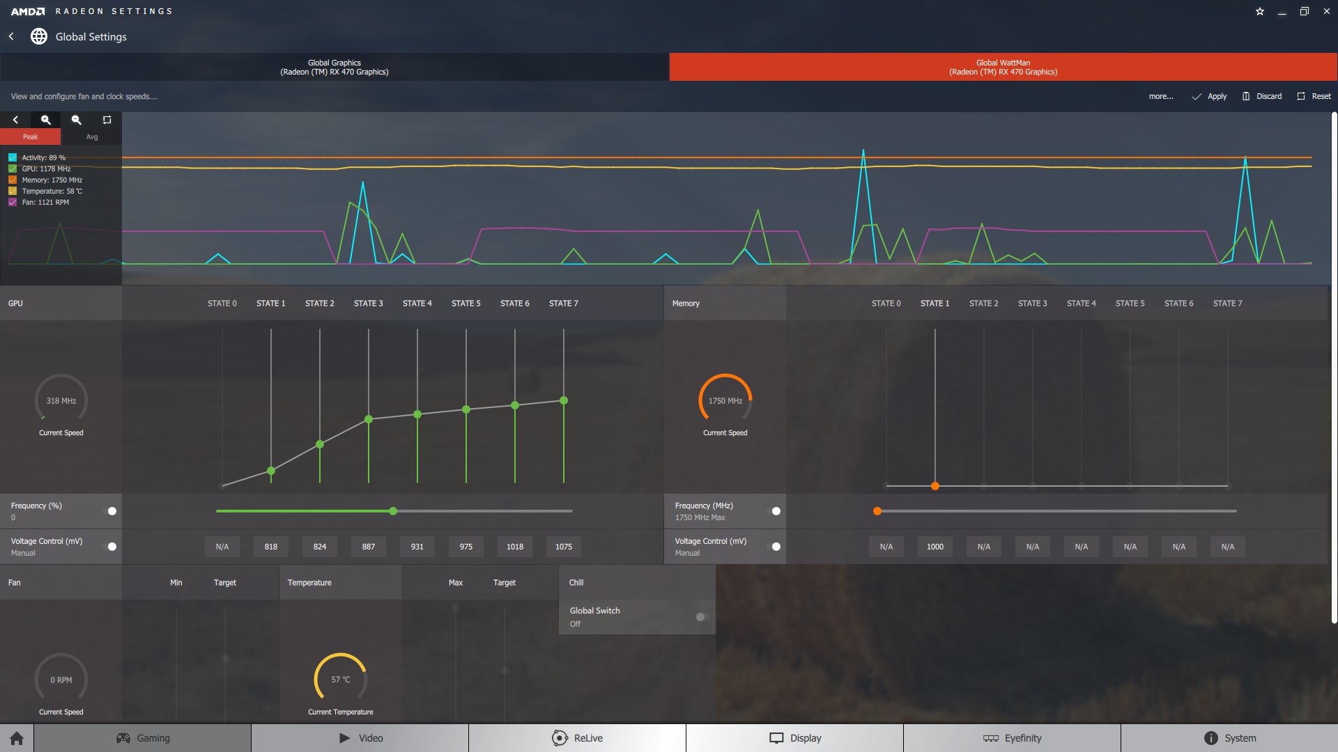

                                        GTX970 eats up to 180 watts, RX 470 uses up to 145 watts. RX 460 is down to 110 watts.
                                        In time, you'd save money on electricity and the RX 470 may also be less noisy.
                                        With some tweaking (for example lowering the default voltage by 0.05v..0.1v because it's set high by almost all manufacturers) will get about 5-15 watts off the maximum power consumption and potentially give you even higher frequencies (it overclocks better with slightly lower voltage)
                                        Also, the newer cards have more states, so the cards will go to lower power consumptions more often.. for example the RX 470 i have has 7 power states.
                                        Oh .. and they also added Chill mode .. if you enable it, on games they tested and whitelisted, in some areas where there's no motion or you're looking at something static, the card detects that and reduces the framerate to 40-60fps (from 120-150fps) to reduce power consumption : http://www.anandtech.com/show/10894/...rofessionals/7
                                        My particular card is the single fan XFX RX 470 because it was cheapest... so because it has only one fan they kinda use a more basic bios... for example there's only one power state for the memory and it runs all the time at 1750 mhz, on other cards it downclocks to save power based on what you do with the card (for example when watching movies i think it goes down to about 400 Mhz). It's not a big deal, the memory chips use about 14 watts.
                                        I know the memory chips are the same hynix 2000 Mhz ones and I could manually overclock them to 2000 Mhz but just I don't see any point to it.
                                        All games i try to play at 1920x1200 (main 24" lcd monitor) on high-ultra settings run at over 60fps so I'm happy.
                                        I finally was able to enjoy The Vanishing of Ethan Carter Redux (really nice graphics) and next I'm going to play Witcher 3 probably (on the 7770 got maybe 10-15fps on average due to only 1 gb gddr5)
ID:	1994275 <-- click to zoom it , that's how my card looks ( wattman keeps the card running enough to keep the fan spinning), if I close the app the fan stops (it stops when temperature goes below 55c automatically)
                                          [ATTACH]147713[/ATTACH] <-- click to zoom it , that's how my card looks ( wattman keeps the card running enough to keep the fan spinning), if I close the app the fan stops (it stops when temperature goes below 55c automatically)
