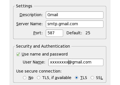

        Re: Outlook 2002 and Gmail issue
        Microsoft proprietary software!
        I use the Linux version of Thunderbird. Here are the settings for my Gmail account.
        Put your email account in the "User Name" section. I replaced mine with x's, for obvious reasons.
          Well it's not the settings.
          I have thunderbird setup with the EXACT same settings and it can receive and send mail. They should be like this.
          I first tried port 25 but it was slow and while port 465 did work, it would still fail in sending the test email.
