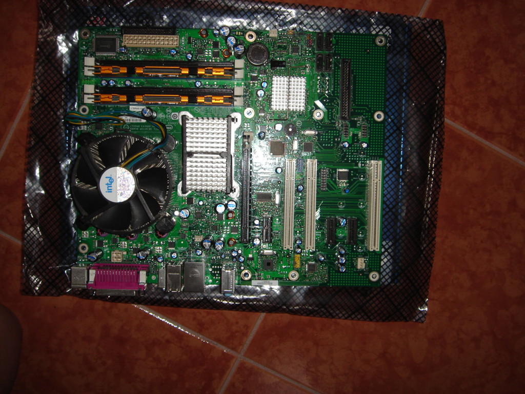

    I assembled a computer for my brother yesterday and by today it keeps bootlooping and shutting down at random times. Sometimes it can run for a few hours without shutting down but sometime it only takes a minute after bootup to suddenly shut down.

    I also inspected the Intel motherboard for bad caps and there aren't any bad caps on it. The caps on the board are:
    * Nichicon HM(M) [still fine, no bulging or leaking]
    * Rubycon ZL
    * Samxon RS
    and a few polymers around the CPU.

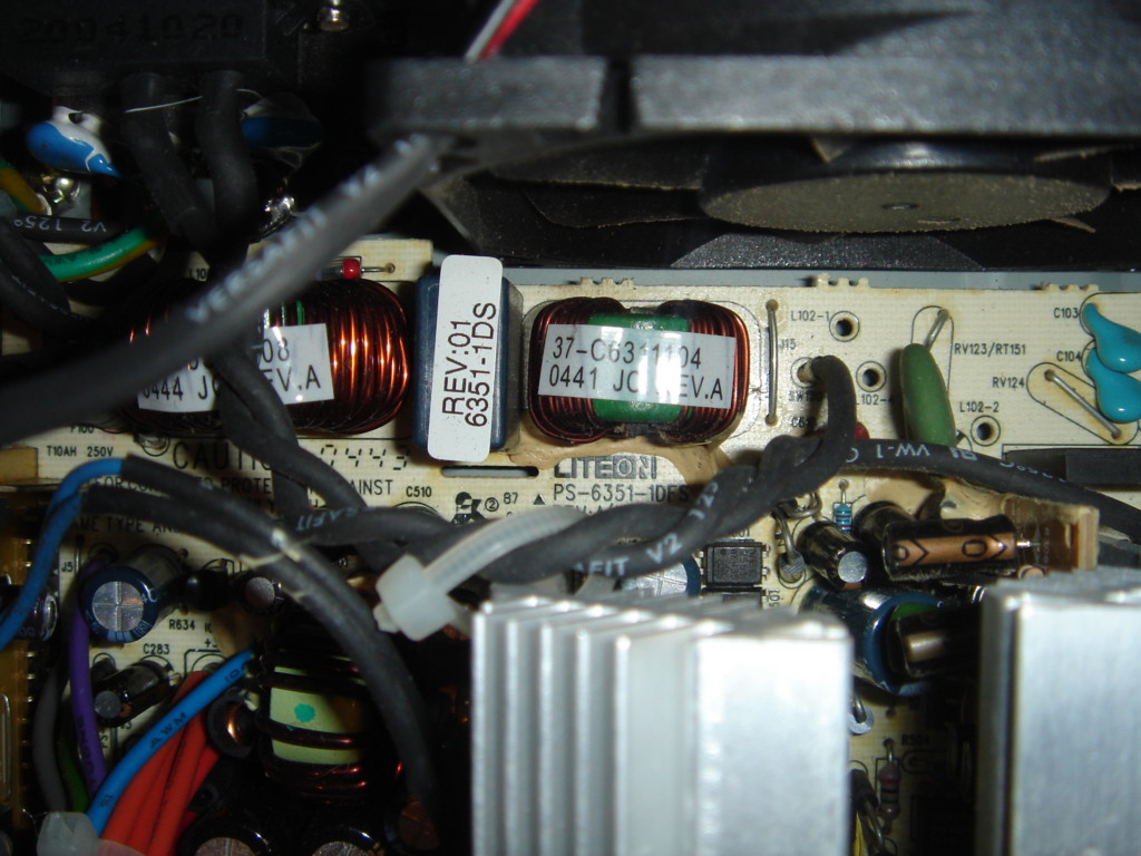

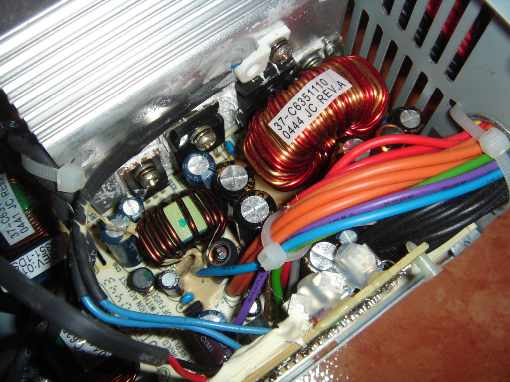

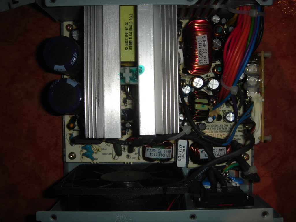

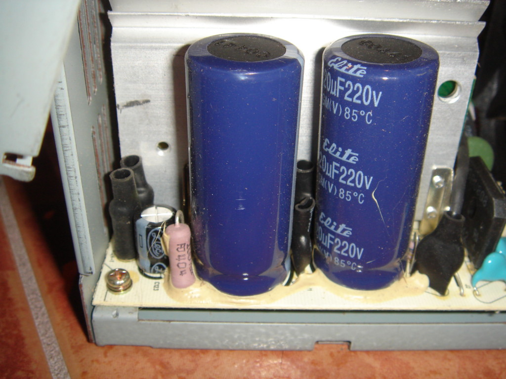

    The Dell PSU also weighs much more than the Thermaltake XP550NP. The caps in the Dell PSU are also larger and have a higher capacitance.
    I've enclosed some pictures of the Internals of the Dell PSU as well.

    I just left the system in the BIOS hardware monitor and the 12V rail dropped to about 11.46V and after half a second, the system just shut off and bootlooped continuosly.
    My brother also said that yesterday when the PC was still OK, he could hear a very small clicking type of noise from the area where the PSU is. I'm trying to figure out what the faint clicking noise could have been.... any ideas??

              psu is bad.
              change out the hn/hm caps too.
              btw ost are crap too.
