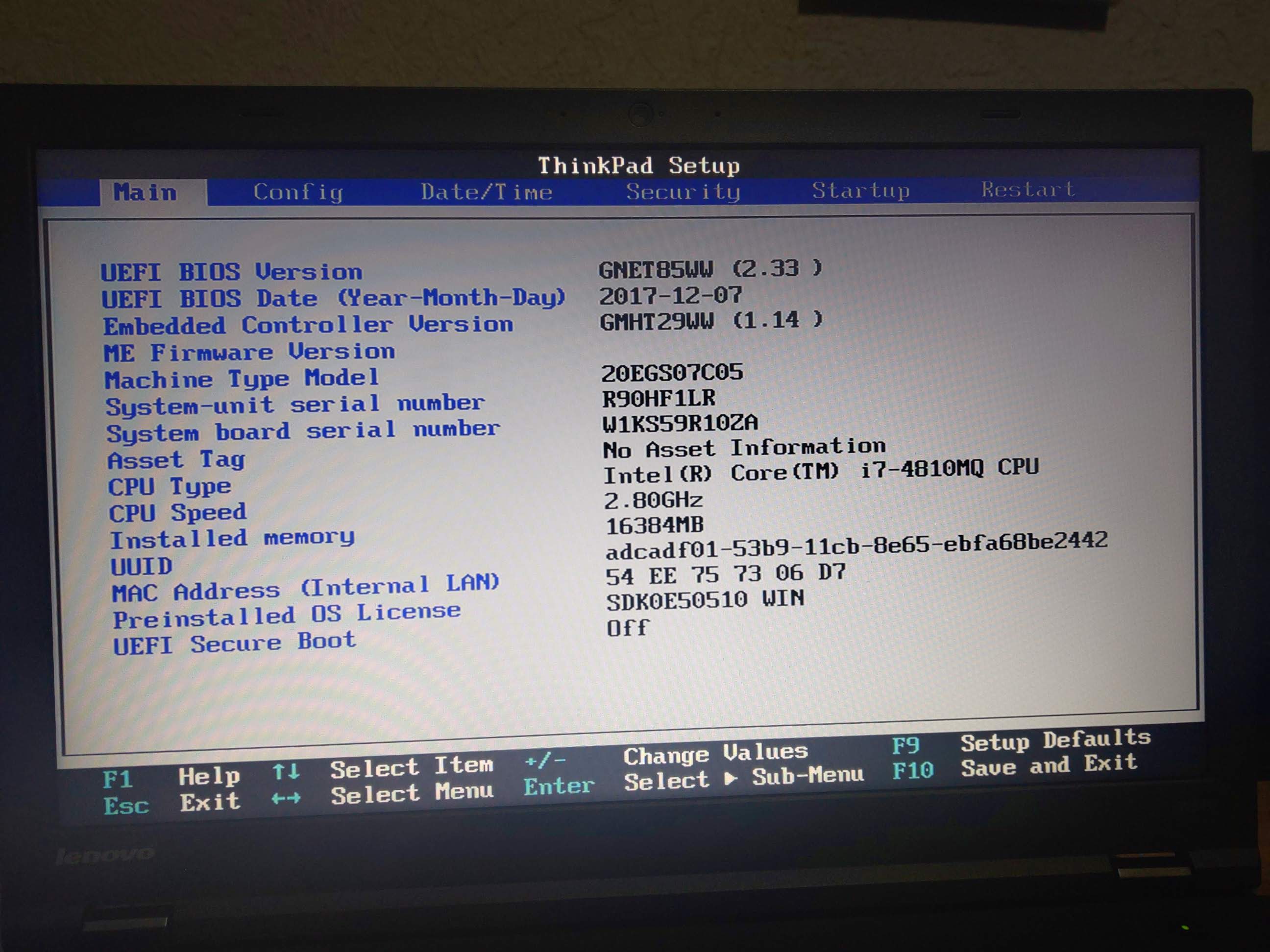

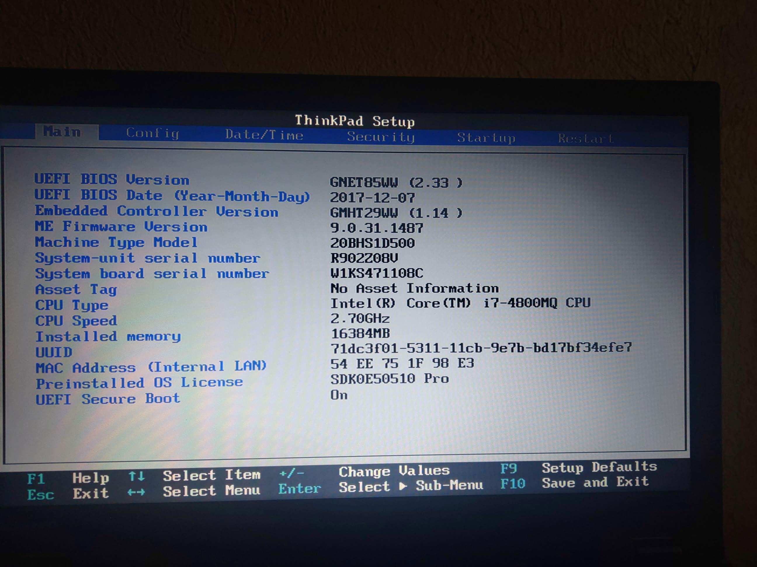

    Hi. I have a Thinkpad W541 that i was trying to remove the Bios Supervisor Password using this guide. https://www.badcaps.net/forum/showthread.php?t=87588 LENOVO BIOS AUTO-PATCHER for Supervisor Password Removal
    I have the old bios backup but when i restored the original bios the laptop shutdowns after a few seconds and can´t load Windows.
    - Using a CH134a + SOIC 8 Clip + Colibri 1.0.1.61 i backed up the original bios 3 times and verified all of them were the same.
    - Used the Lenovo Bios Auto Patcher applied the patched file to the chip and verified that writed ok.
    - Assembled the laptop and booted it up, after a few tries the patch applied, disasembly and restored original bios file, restored bios to defaults (no password now) but computer shutdowns and can´t load windows OS.
    Maybe my initial backup was corrupt (i verified it 3 times) but now i need help to recover it.
    I extracted the same bios 2.33 from the lenovo website but when i trim it i end with a file larger than 4mb so i need your help and instructions how to procced and merge the bios extracted with my backup or a working one to recover my bios.
    I have
    TW541_1_BACKUP.BIN (my original backup)
    LENOVO_W541_4MB_MICRON_25Q03213_PATCHED.BIN (file i found in this forum)
    $01E2000.FL1 (bios extracted from Lenovo Update Bios 2.33 same version as my old bios)
    Thanks every one.

    bios extracted from the update posted by you.

        So far no luck but will try with another programmer.
