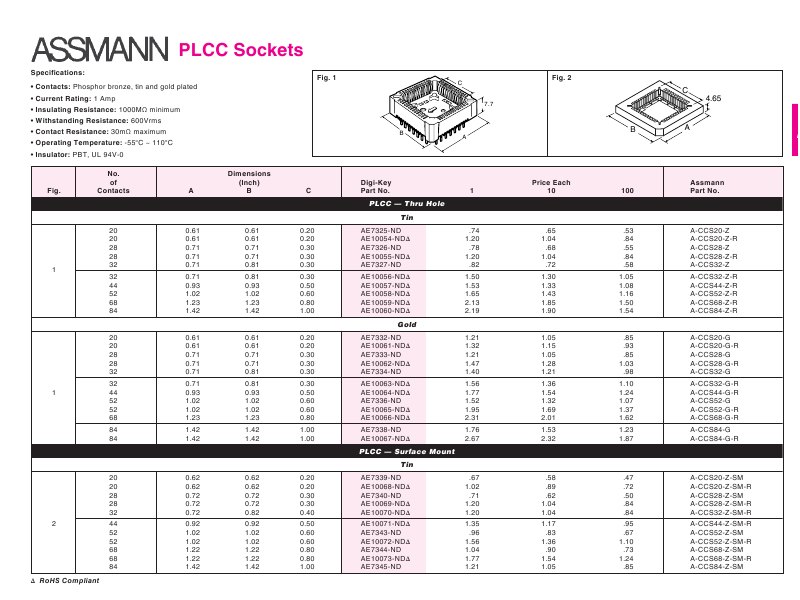

                            I was looking for a place to get PLCC sockets, when I came across this supplier in the Digi-Key catalog. ASSMANN!
                            I just had to share it with you guys.
