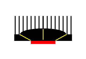

                            #73
                            Re: Big Heatsinks
                            Heat transfer rate is affected by both mass flow rate (of the air) and the surface area of the heatsink exposed to the air flow.
                            Mass of the heatsink doesn't mean much unless the mass is used to create more surface area.
                            There is a limit to how much heat air will pull off a surface so more fins won't (might not) do any good if the heat doesn't get to ALL the fins. In a poor design the extra fins might not actually be acting as heat transfer area.
                            Referring to my goofy little drawing.
                            In those designs where the center of the block is thicker to the fins what the designer is doing getting the heat to the outer fins too by keeping the distance (yellow lines) from the CPU (red) approximately the same as (or at least closer to what) it is to the center fins.
                            - Designs with a copper core probably use this shape for the core for the same reason.
                            Running fans at 1/2 speed will reduce cooling capacity by 1/2.
                            [Heat Transfer Rate] = [Mass Flow Rate] x [The rest of the equation]
                            - About fans what matters for heat transfer the fan's 'mass flow rate'.
                            Mass flow rate is volumetric flow rate adjusted for the density of the air.
                            Many things affect the volumetric flow rate:
                            RPM, diameter, number of vanes (blades), pitch (angle) of blades, how thick the fan is.
                            Colder case air means air is more dense (there is more 'mass' of air in the given volume) and so the given volume can carry more heat away with it.
