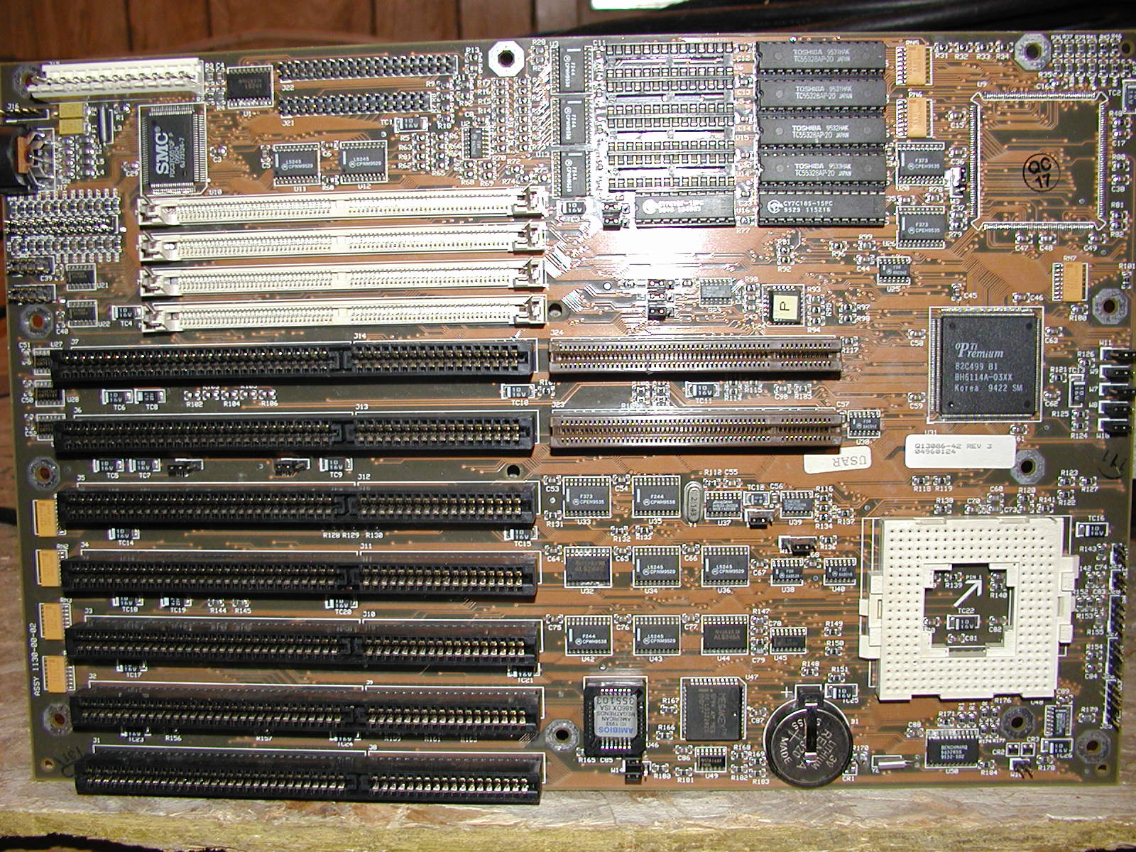

    The other day I found an old computer that had one really nice 486 AT motherboard and two really interesting cards.
    The first one was called a T19146-G and had an additional card attached to it called the T19550-G2
    The second one was called the T19137-G and it too had a second board attached to it but I could not find a number on it.
    Both had Cat 5 connections.
    They were both connect to a motherboard that had no identification marks other than Q13086-42 and one of the cards said Gilbarco on it which leads me to this site but I can't find any mention of the boards. What on earth are these things?

    I think they were part of a Gilbarco system, perhaps communication boards of some kind.
    I've found some reference to G-Site systems for gas pumps administration, point of sales control and similar applications: http://www.benfordfueling.com/shop/page92.html
    I suggest posting more detailed photos: the chip onboard seems to be Zilogs, but I can't see more.

      If you want to know, both baords are fitted sith six Zilog Z85's but in all honesty there are no actual markings on the boards that tell what the jumpers and connectors are for. Same goes with that motherboard.

        fuel pump interface for a p.o.s system.

            Zilog Z85xxx seems to be a serial controller family according to their datasheets, so you are out of luck - no multi nic solution , maybe a multi serial card.
            Gilbarco doesn't seem friendly (in order to contact them, you have to agree to a no disclosure license!), but its techs surely know what these cards are and if you can use them [I doubt].

              I think you have an "G-Site ISA I/O Console Board" (and system?) there.
              Basically interfaces 'the computers' in several gas pumps to cash registers at a G-Site (gas station).
              http://cgi.ebay.com/Gilbarco-Assy-T1...mZ280193629807
              http://cgi.ebay.com/Gilbarco-Assy-T2...mZ360014584964
              I found a "Q13086-48" PN listed as a P5 motherboard.
              Also found a listing for a Pentium upgrade CPU for a 486 based Q13086.
              T19550-G2 is aka a "Two wire strip board" [what ever that is...]
              Rest is just links that might have clues that I can't see because I can't se what all you have there.

                So, we now know that they are just interface boards. This is one of them and this is the other one.
                I also attached a quick photo of the motherboard.

                  The mobo is a mid 486 period Baby-AT one, late 1994 or first 1995: the chipset is an old good OPTi 82C499, there are two VLB slots and a flashable Ami Color bios (the flash was expensive at the time, the Ami bios the best at all) but the socket 3 isn't a zif one and it lacks clear jumper serigraps. The manifacturer skimped on cache size (128 KB) and quality (20 ns vs the more expensive 15 ns variety) too.
                  So, it was a motherboard sturdy but not intended to be expanded and not the best for performance: I think the computational load was quite low, but reliability was in first place. If I guess correctly, there was an Intel DX 33, because the DX2s were too expensive, Cyrix ones had a bug (later corrected) and Amd had a good reputation for clones used in cheap computers, but not as a first choice cpu.
