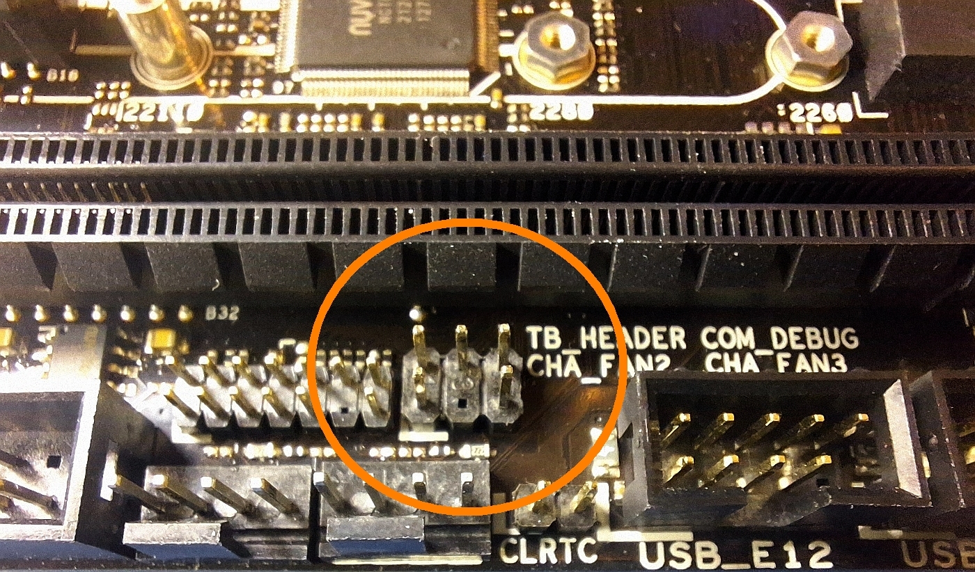

      Hi, I just made an completely astonishing discovery 😀!
      The TL631 works on LGA1700 Gigabyte and ASUS boards the following way:
      Gigabyte:
      • the TL631 must be inserted into the las PCIe slot (farest from CPU) - using the short PCIe connector
      ASUS:
      • the TL631 must be inserted into the 5 pin com debug port as on the picture below - using the bigger LPC2 connector (pin 1 into pin 1):
      Click image for larger version  Name:	20240621_010400.jpg Views:	1 Size:	958.4 KB ID:	3294241
      I was looking how to do it for a long time, will not disclose for how long, because it's a shame 😁.
      I confirmed this now on one Gigabyte Z790 UD and one ASUS PRIME Z690-P board, but most probably it will work also on other boards of these vendors.
      This means that maybe there is also a way to use it also on other vendor boards, will have a look on it.
      The older TL611 does not work on the ASUS PRIME Z690-P board, did not check it on the Gigabyte Z790 UD.
      Let me know if anybody can confirm this, and if other vendors LGA1700 boards work.
