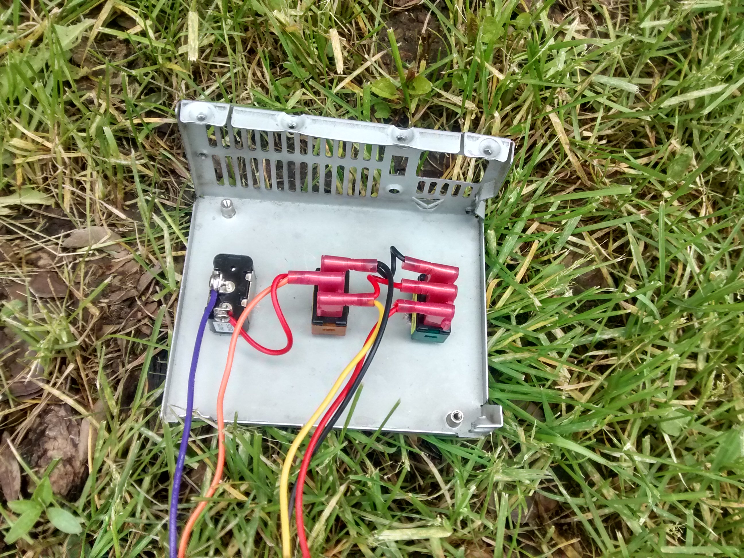

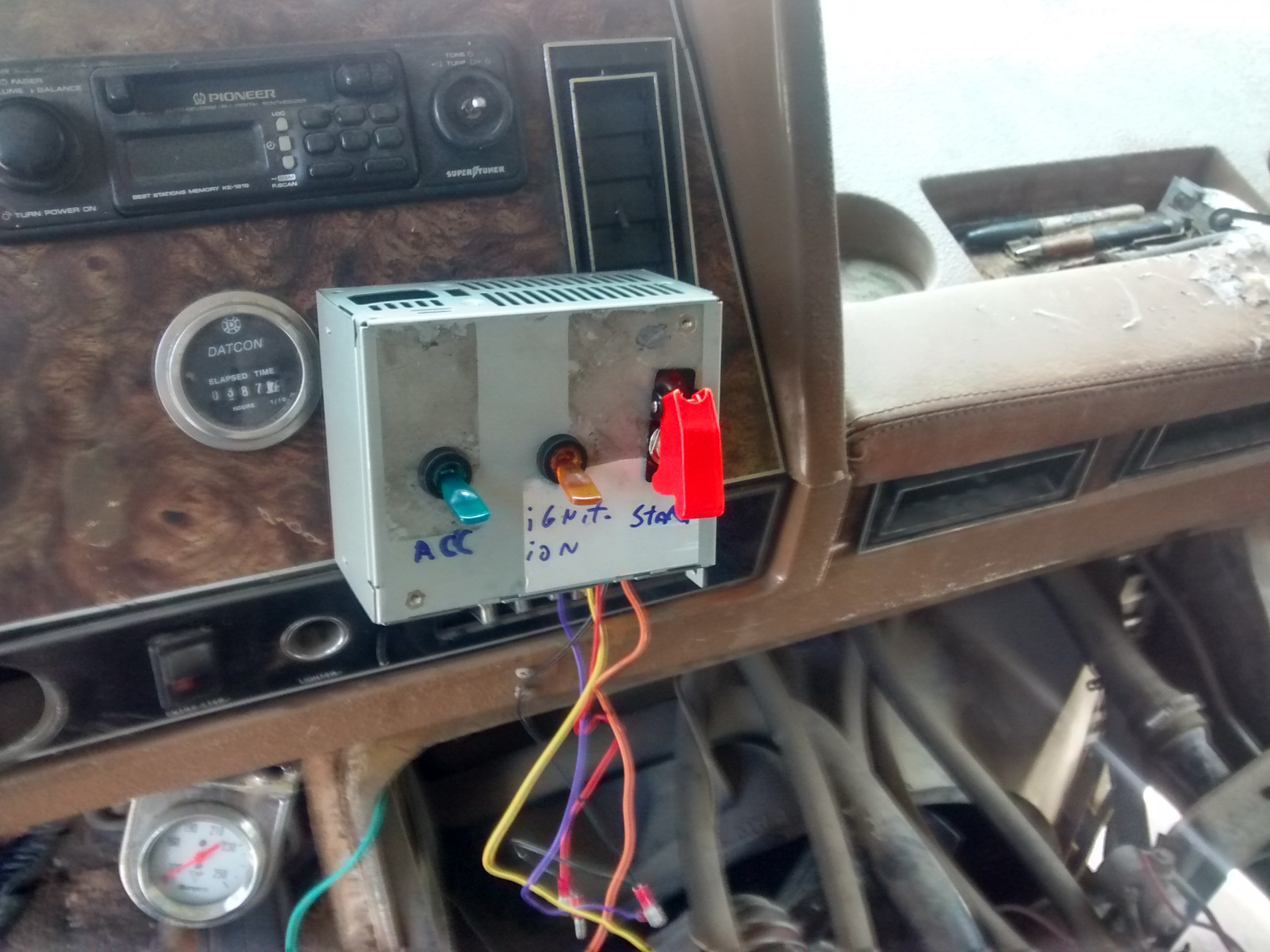

    Or "what ignition switch? all i see is a box with three switches in it!"

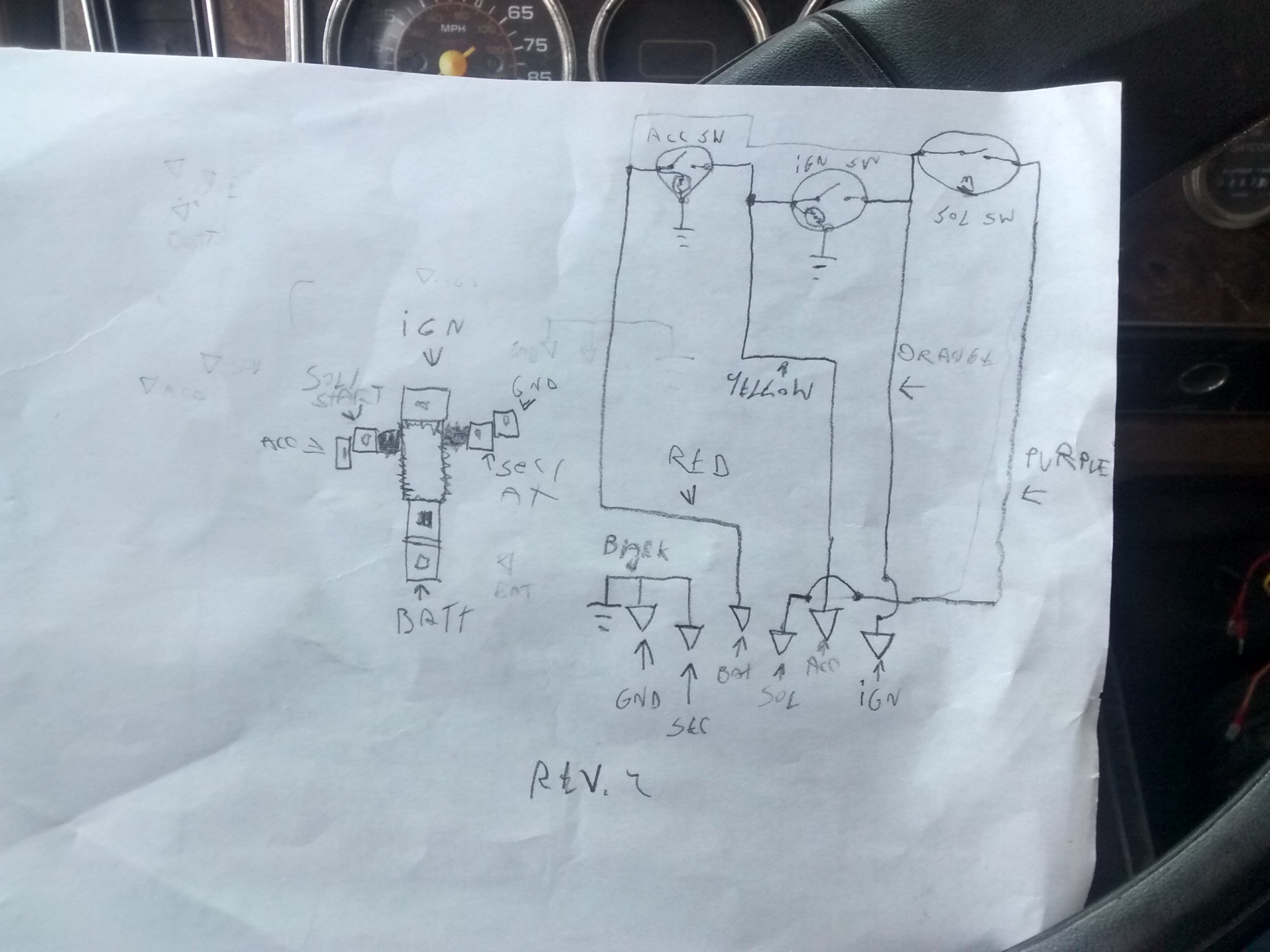

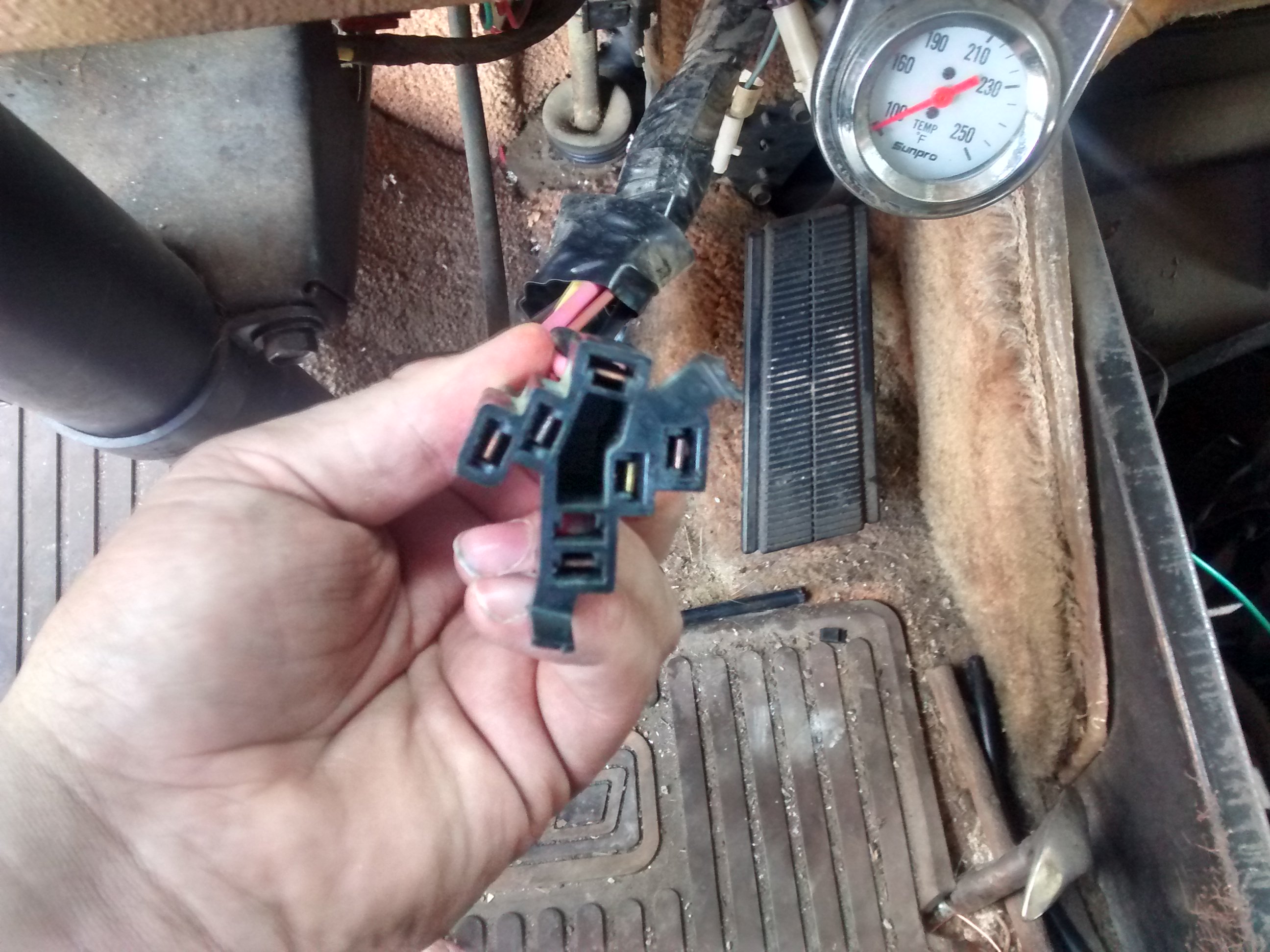

    i have the title in hand and have no keys, so i look up replacements, it's not made anymore! hmm, what to do..... a universal replacement doesn't fit, so that won't work. what's left? Build my own!!!! and that's what we got here.

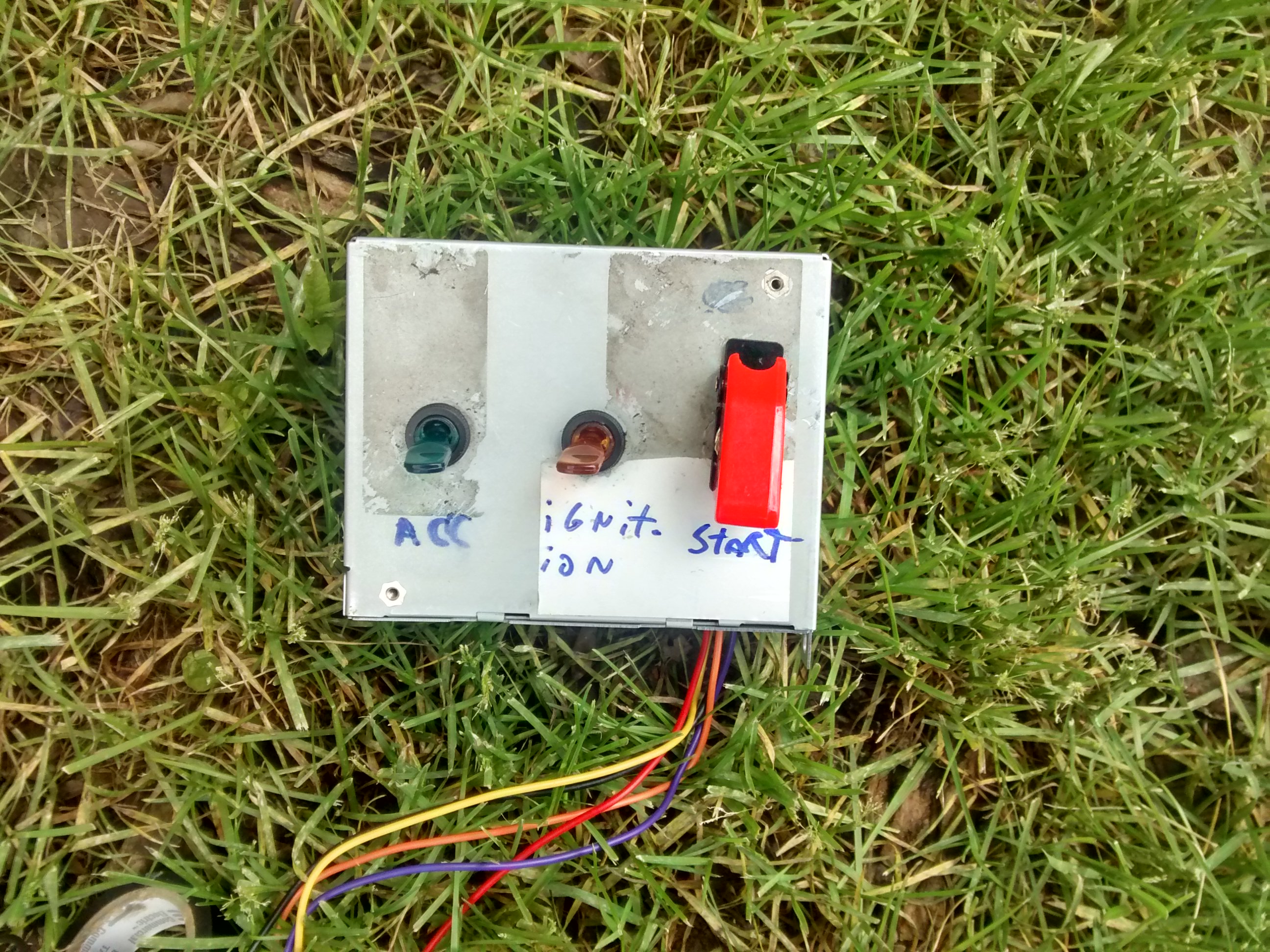

    old turds worth of a PSU case gutted and holes drilled for the switch. wiring traced and pinned out. $14 worth of parts, a scrap PSU and time and we have this monstrosity! BTW, i did wrap the wire in electrical tape so it looks better.

      i did that, it didn't work. on autopsy the spring holding the main contact was bad and the bakelite holding it was broken too.

          I think it looks kinda cool! Definitely different!!! Very creative I'd say!
