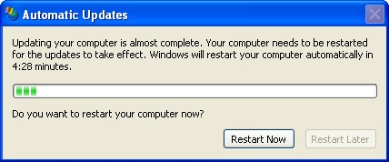

    RANT warning: $@#$#$#@% Windows Update crap.
    I HATE Windows!! Specifically the lousy Update interface.
    That stupid and annoying pop-up Reminding you to restart Windows to complete the update process. Every couple minutes.
    It causes so much damage!!!!!
    I lost all my running apps and a long write-up I was working on when I went to click on something and just that moment the @#$@$ pop up appears and the click get directed to its Restart button.
    I'm sure this has happened to others out there.
    Any of the experienced and talented members here know of a fix to kill that damn silly reminder once and for all?

            Re: RANT warning: $@#$#$#@% Windows Update crap.
            What I find rather annoying is that when the 'must restart' dialog comes up, the option to 'restart later' is grayed out! There's also a countdown timer showing when your computer will automatically restart.
            If you're in the middle of something and have just gone away from your computer to do something, you might find when you get back that it's restarted and you'll have lost everything. Imagine also if it was like that on a server that a lot of people were using at the time!
                  davmax,
                  Supporting 30+ home users can be a task in itself given their scope of computing knowledge, but many home users are not pushing their systems and configurations to their limits either.
                  My personal XP system is also very tightly controlled. XP has come a long way toward stability compared to the days before SP-2. But my rant is purely a Microsoft Windows internal shortcoming, not a third party driver or app. Not a user's poking around where he or she shouldn't be. It's simply the nature of what Windows Update deems as manual mode.
                  I leave my system running 24/7, likely others here also do. I may at any time require the system to complete a task ie. compile, simulation, design verification test runs, or simply typing away on a specification doc.
                  Like Spacedye69, Udpate is set to notify when updates are made available, but manual intervention for download and launch is selected.
                  Sadly, not all descriptions show which updates require restart. If there is a critical update, you'd want it, launch it.
                  But the typical Windows annoyance creeps in when a restart is required. After selection of restart later, it persists in reminding you every x minutes by popping an active window over your work. There is that small chance when you're pressing your mouse button on what you thought was your active app, but is actually the pop up.
                  'God' help you if that coincidentally was the spot as the Restart button.
                  Strike 1.
                  And the Restart is highlighted too, not the Later button as it should be.
                  You could be hitting the ENTER key for line breaks and suddenly, you hit Restart!
                  That's 2 strikes.
                  Given that a user's environment could have been vital at that time, no verification window is coded to double check the selection too.
                  3 strikes, you're out!

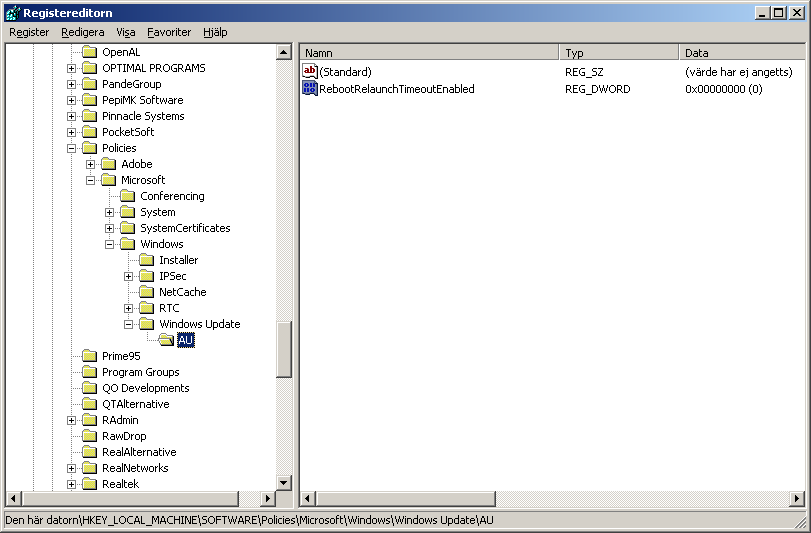

                      I've had allot of experience with setting up Windows Update Servers
                      All of the aspects of the windows update agent can be controlled nowdays (wasn't so when the windows update server was at version 1.0 )
                      Here is a copy paste from; http://www.windowsnetworking.com/art...ate-Part2.html
                      All keys he talk about are under HKEY_LOCAL_MACHINE\Software\Policies\Microsoft\windows\Windows Update
                      They are case sensitive and should be DWORD values.
                      Have you ever applied an update to a server and then had Windows prompt you to reboot the server at a time that just wasn’t convenient? Personally, I’ve always found it annoying that Windows Update keeps prompting you to reboot your server every few minutes while you are trying to work. You can however change the reminder frequency. To do so, simply create a registry key named RebootRelaunchTimeout. The value that you assign to this registry key should reflect the number of minutes that you want Windows to wait between reminders. For example, if you wanted a reminder every half hour, then you would set the value to 30. You can set the RebootRelaunchTimeout registry key to use any positive integer from 1 to 1440.
                      Of course you also have the option of getting rid of reboot reminders completely. To do so, create a registry key named RebootRelaunchTimeoutEnabled, and set the value to 0. If you decide later that you want to re-enable reboot reminders then just change this key’s value to 1.
                        Yo Momma!
                        Ok, under here, stupid forum garbaging my post :P
                        Code:
                        HKEY_LOCAL_MACHINE\SOFTWARE\Policies\Microsoft\Windows\Windows Update\AU
                        EDIT; Ok, Yo Mamma x2!
                        Try fucking this one up;
                              Per, you're my hero!
                              Thanks.
                                Aww, in my pic above, there isn't supposed to be a space in the name WindowsUpdate
                                MS has a whole page somewhere that describes what all settings does...
                                Also check out www.wsus.info
