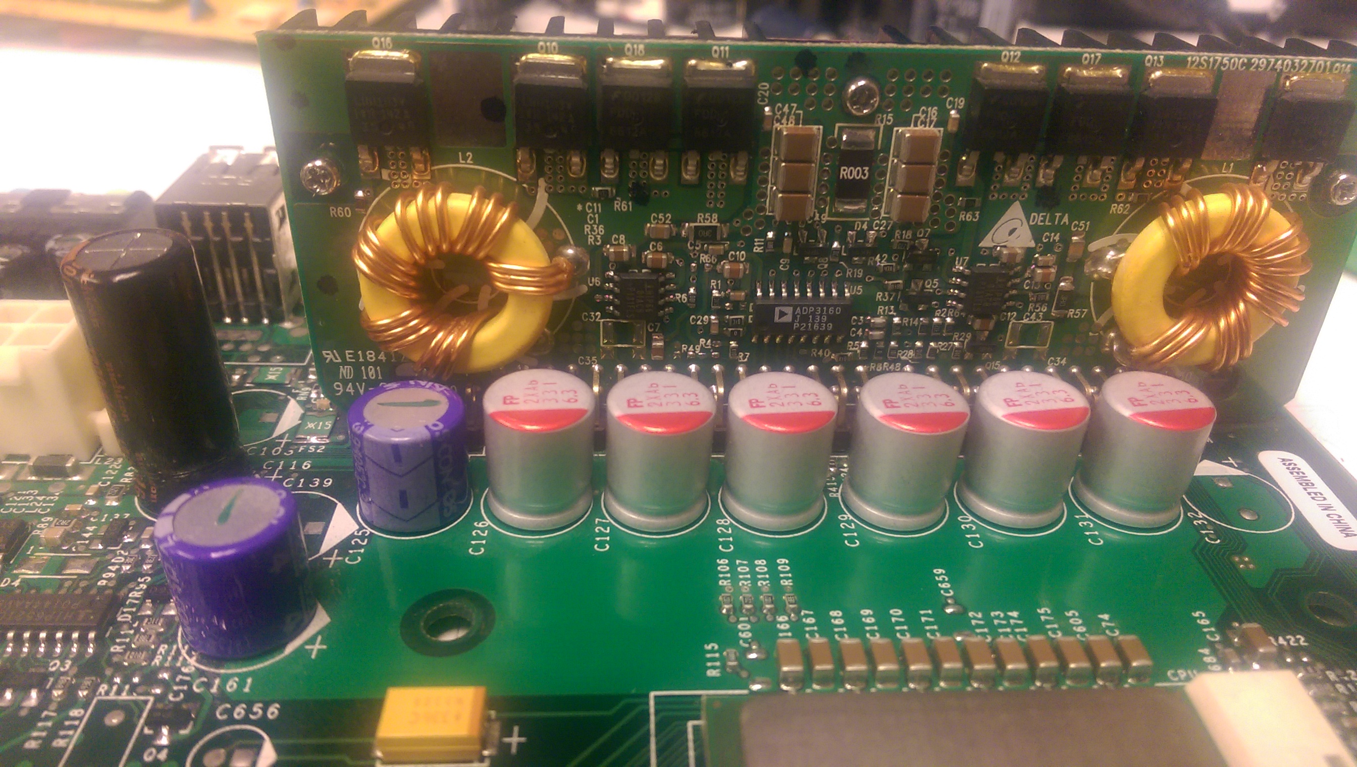

                                Loving the suggestions, thanks guys. But first things first, recapping the stuff As you can see, the caps are definitely bulged. Here's the crazy thing though. There were a total of 12 nichicon HM caps, 9 of them were 2200uF 6.3V, 2 were 1000uF 16V (on VRM high), and one 1800uF 16V (on VRM high). The remaining black nichicon cap left unchanged is nichicon HD. Every single 2200uF cap was bad. Their ESR ranged from 0.08-0.12 but all of them read over 6,000uF ranging from 6,076uF-6676uF. Seems typical of suspect HM caps. But the VRM high caps were fine, even being so close to the heat sink. The 1000uF caps were within 5% spec on capacitance and the 1800uF was within 15% spec on capacitance. Replaced 9/12 with polymers. It looks good now Interesting, the board was made by Foxconn but the VRM daughterboard was made by Delta. Pretty cool. PSU was made by Delta, more pics to come.
                                I also got rid of the shitty bubble-gum thermal paste on the CPU and NB heatsink.
                                So I understand that this computer is obviously lacking in horsepower, but how much better do you think it will be with all fresh, in spec caps now? I also found a 512MB PC133 Patriot RAM stick. I got lucky that it worked, because this mobo will only accept low density RAM modules. I may put a heatsink on the SB chip just for the hell of it

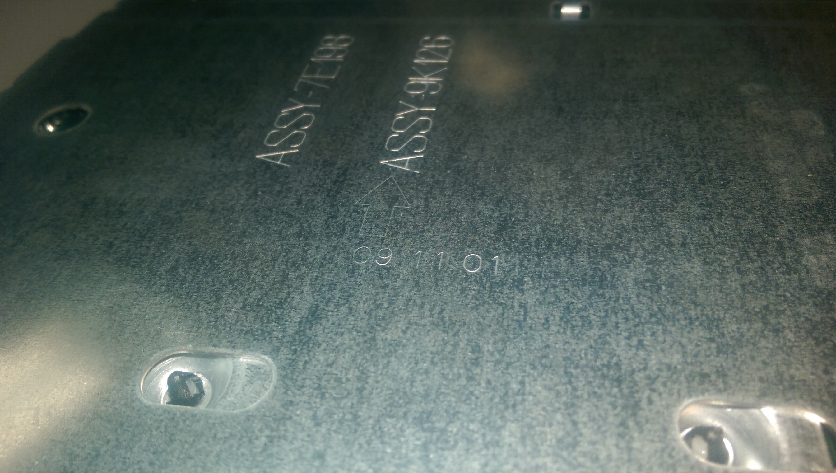

                                Ouch, this thing was made on 09/11/01

                                  Nice. Are those polies only 330uF? I'm surprised it works with them that low. I wouldn't normally go any lower than 820uF there. If it works, then it should be fine.

                                    Yeah they're only 330uF. I really wanted to use 820uF 2.5V Fujitsu but the lead spacing was a little much for them, so I used those. I know the capacitance is a lot lower than originally, but I've seen 4 or 5 470uF polymers be used to filter the VRM low for Pentium D's. This one has a pretty low TDP for a Pentium 4
                                      That's very characteristic of failed HMs, HNs, and HZs. But the fact that they read so high in terms of capacitance and so low in terms of ESR very likely means they developed high internal leakage which means they were fooling the ESR/capacitance meter. They were likely more out of spec than that.
                                      That is because the higher voltage (+12V) of the VRM input preserves the oxide layer (keeps it thicker) much faster than the lower voltage of the VRM output (1.7V for that Pentium 4 1.5 GHz Willamette?). That is another reason why crap brands that don't do well on motherboards hold up alright in well cooled and ventilated power supplies. Compare the very low voltage of the VRM output to the higher voltages found in PSUs (+3.3V, +5V, +12V, etc), and it makes sense. That being said, the capacitors in the VRM input do handle ripple directly from the power supply (either the +5V or +12V rail), so it doesn't hurt to make sure they're of decent quality.
                                      I believe those older boards were designed by Foxconn but that they were actually manufactured by Flextronics for the most part. To the best of my knowledge, Foxconn doesn't actually manufacture all their motherboards. They are a vast original design manufacturer, and despite the fact that they do own certain motherboard assets, they themselves don't quite have the capacity to fulfill and manufacture the huge volume that Dell, Gateway, Intel, etc, often mandated, so they used other manufactures such as Flextronics, Celestica, and Winstron (sometimes even Pegatron?) to manufacture their motherboards (particularly the Xbox 360 motherboards, but Foxconn does have the say on the final design and component assembly). The motherboards you see from Foxconn, sold at retail and by their lonesome, on the other hand, are manufactured by Foxconn themselves. I say these are probably Flextronics boards because they are littered with 85*C capacitors most of the time (the original Xbox motherboard also had a very similar design and those boards were also manufactured by Flextronics). Your board has a daughterboard made by Delta so the manufacture of this one might (emphasize the might) actually be Delta, though, given the lack of 85*C capacitors (if I'm not mistaken).
                                      If they didn't use that, they would use very appalling thermal tape between the CPU's heatspreader and heatsink that would not be very good at transferring heat.
