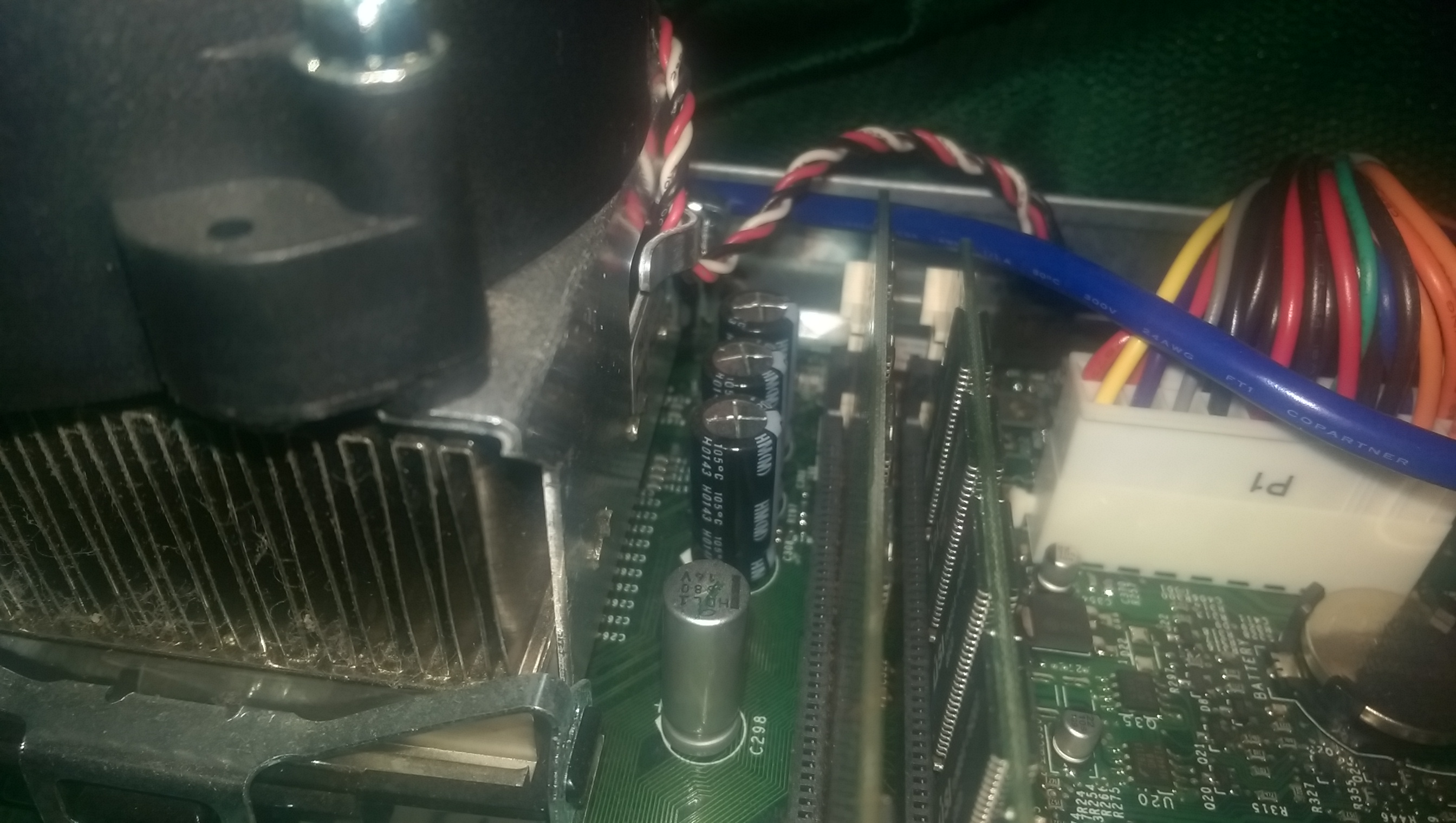

    So, the sentimental side is getting the best of me here I have a very old Dell Slim PC from 2001 that I want to keep going. Don't ask me why but this PC is very special to me and I want to keep it going. Specs are as follows:
    Pentium 4 Willamette 1.5GHz
    384MB PC133 RAM
    Radeon X1050 256MB
    Foxconn LS-36 motherboard
    The board is full of bad nichicon HM, date codes on them: 43rd week of 2001. I thought these were safe? I will post pics later.
    I am going to upgrade the RAM to 768MB or 1GB, because I have some at work, and I have a 200GB IDE drive with more cache that I will use to replace the 20GB drive. So besides some caps, I'm not spending any money on this thing, just time.
    So basically, I'm looking for a very light Linux OS that I can use. All it will be doing really is streaming 480i/480p video through S-Video onto a 27" tube TV. Would much appreciate some input. I believe this is doable because it worked fine as it is with Windows XP, but I don't want to use Windows XP anymore.
      If that board was in a SFF case, perhaps heat got to them if you have many hours on it. This is somewhat off topic so I'll keep my thoughts on the matter as terse as I can, and I might get a lot of flak for saying this, but... I know the "consensus" is that only 2001-2005 HMs/HNs are bad (people used to think 2005 capacitors were safe...). Regardless, I am no longer convinced that the problem was ever rectified or that Nichicon even knew about it. Some articles from 2005 that are still on the web state that Nichicon refused to comment on the matter and I tried emailing them without a response some time ago - I don't think they'd want to disclose anything about it even if they did know. I can't find any announcements from Nichicon directly or indirectly regarding HM/HN, even with the wayback machine. The "overfilled" comment that was deemed "official" was made by someone from a university from Iowa whose article was deleted at Dell's behest. That person probably assumed they were overfilled ("filled with more liquid than required") because they stated thereafter that electrolyte was overflowing onto the motherboard after 300 hours (yes, 300) of 100% CPU usage at a temperature of 64*C. It was also stated that the problem was possibly limited to a specific shift, but I'm not sure if that's necessarily true. It was also stated that the "defective" capacitors were placed on motherboards from 2003 to 2004...
      I honestly think an issue that results in so many millions of capacitors failing so prematurely is more complex than just "overfilling". Many things could have gone wrong. They could have been capacitors from an unauthorized, chinese distributor, they could fail for similar reasons that KZG/KZJ fail, etc... Nichicon made an announcement regarding the warning against use of certain disinfectants, but nothing was said about the HM or HN series there either. And again, people used to think capacitors up to 2005 were safe, but HNs still failed prematurely w/2005 date codes and sometimes even HMs w/2006 date codes. I don't know if Nichicon reformulated the electrolyte by the time the HZ series went into production as I haven't heard of or seen nearly as many failures since. As for Dell and HP announcing the problem would be fixed sometime in 2004? All that could mean is that they specified the use of capacitors other than HM/HNs in critical places (VCORE input and output), such as Sanyo WG/WF, Chemicon KZG/KZJ, Rubycon MBZ/MCZ, Panasonic FJ/FL, etc... and that announcement was only made for Optiplex GX270 machines. The quickest failures were also reported in SFF machines (as well as G4s/G5s) and on motherboards with hot running linear regulators, so perhaps heat did tip the bad HM/HNs over the edge quicker than not.
      I am not trying to scare anyone into thinking that HM/HNs are unreliable now adays. If your HMs/HNs with recent datecodes are lasting, more power to you. But given how unreliable and sensitive to heat very low/ultra low ESR capacitors seem to be even from good manufacturers, I would keep a wary eye is all. I suppose it is no longer an issue because HM/HN/HZ were discontinued a couple years ago.

            Are they bad caps because of the brand and type or because they test bad? I'm not afraid to use reputed inferior caps if they test ok but I'm weird and a cheapskate. I figure they are like anything else, I use it till it doesn't work and then fix it if possible.

                They're nichicon HM date code 43rd week of 2001.

                        Are those three Nichicon HMs in that picture bulging slightly? It looks like they are in the picture, but I've seen caps that looked like they were bulging in a picture and looked fine in reality.
