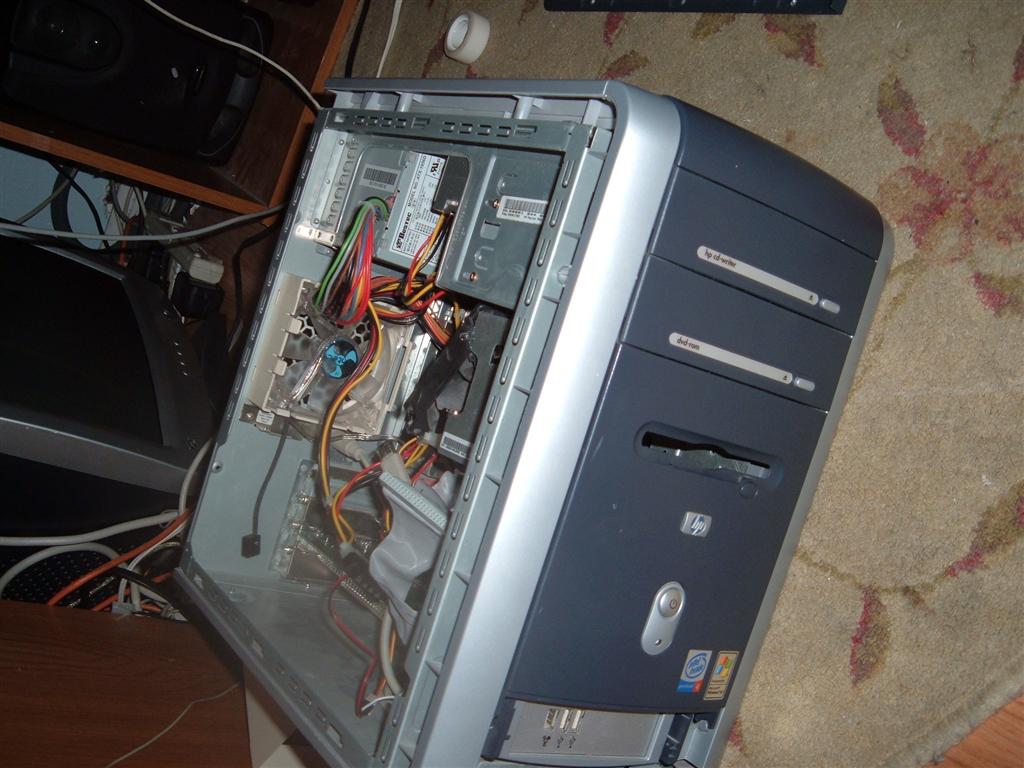

    I'm typing this from my trusty HP Pavilion 753n PC. Here are the specs:
    MSI 6577 Motherboard

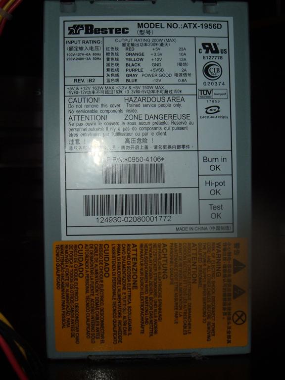

    Bestec 200W PSU
    Pentium 4 2.53Ghz
    1GB (2x512mb) RAM
    300GB Seagate HDD
    Generic TV Tuner
    ATI Rage 3D Pro (yeah, I know...) driving my secondary display
    Integrated Intel 845G graphics driving my main display.
    This has been my main machine for 4 years and it's never given me any trouble at all, has always been very stable and trustworthy, for the first 2 years I pretty much ran it 3-4 hours a day, the 3rd year 5-6 hours, and now on the fourth year I pretty much run it all day and sometimes let it torrent stuff overnight. Like I said, it's never given me any trouble but it does have a Bestec PSU and after reading these forums, it's kinda worrying me as they seems to have a bad reputation. It's a 200 Watt model. According to SpeedFan, these are my voltages:

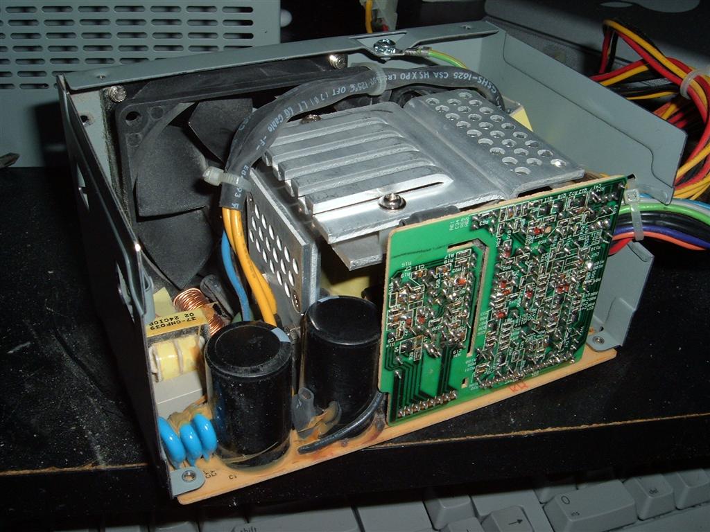

        bestec psu needs a recap.
        check the +5 stby from cold.
        bet its way high.
        post a pic of it with the cover off.

          OP: a 200w supply seems awfully thin to support everything running in that box.
          I have several machines die complete deaths caused by Bestec power supplies. To quote Topcat, "once junk, always junk". Why not ditch the Bestec and get something more stable?

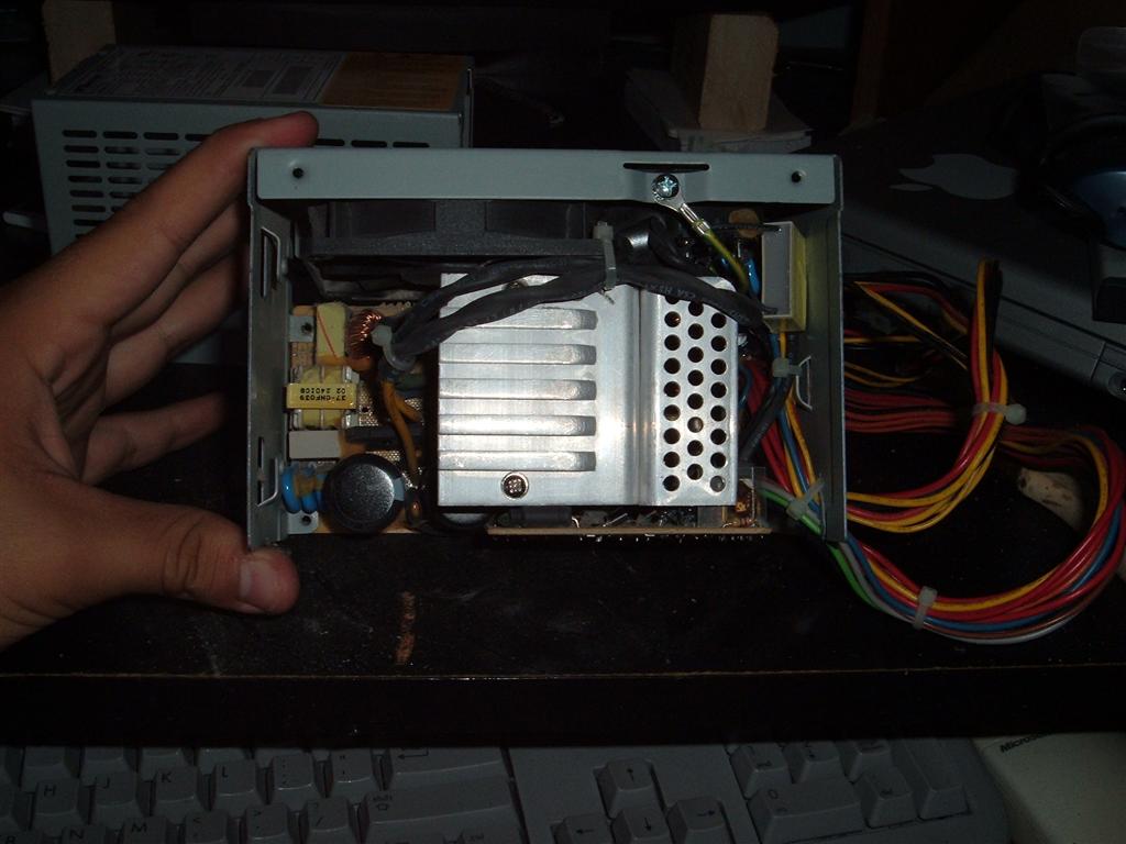

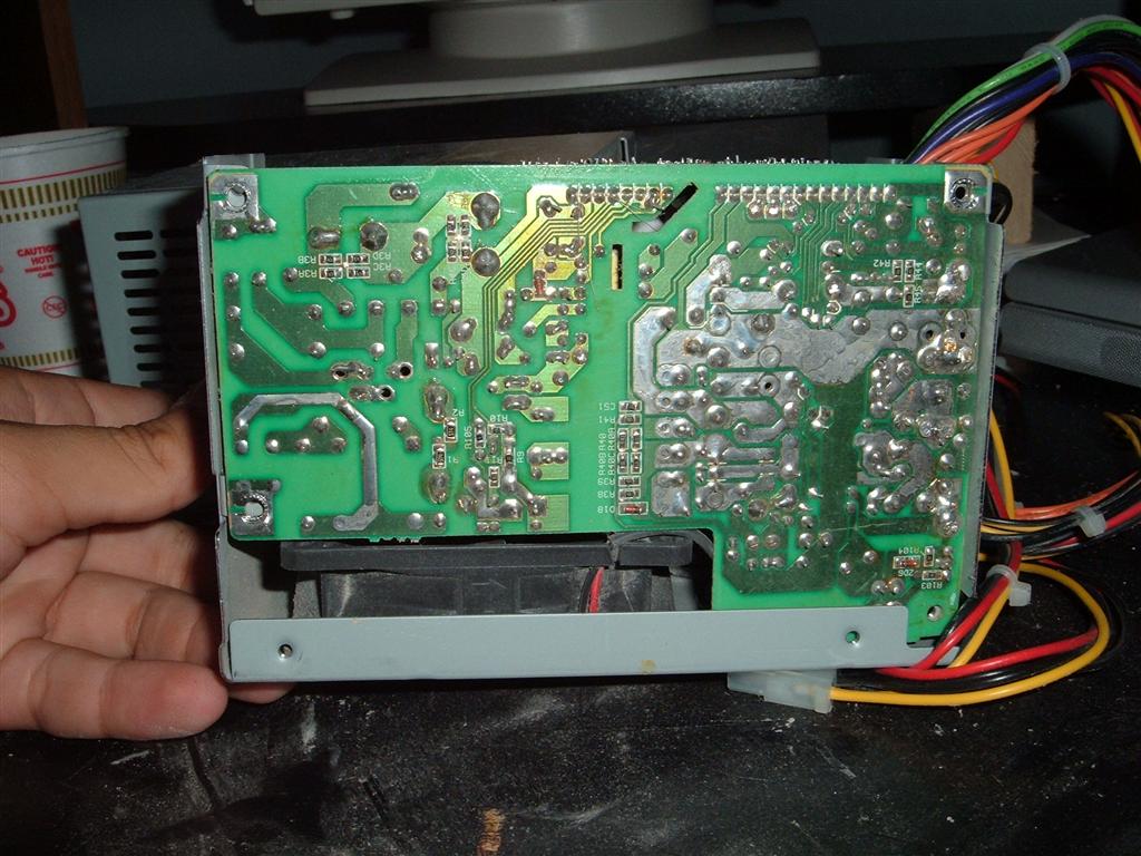

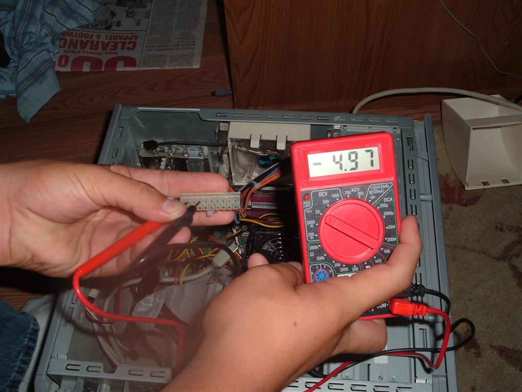

                Well I got a multimeter (cheapie from Harbor Freight Tools) and opened up the case to take a look. I've attached what the multimeter reads from the purple wire Standby Voltage, looks like the speedfan readings were way off. I also have some shots of the Bestec opened up - that thing was dirty!

                  Never trust:
                  • Voltage readings taking from a PSU that isn't actually running a load. Although its OK to do a quick go/no go test, you'll never get accurate readings without something like 10%-20% of the rated load.. which simply means you need a working motherboard/cpu/etc. and a hard drive or something similar connected before testing.
                  • Bestec PSUs. I've seen more motherboards killed by Bestec PSUs than I care to mention, and 99% of the time testing said motherboard destroyer always gives readings that are perfectly within tolerance.
                  • Voltage readings from motherboard sensors according to Speedfan etc. Mine currently are; 3.3V is 0.00V, -12V is -16.97V, and -5V is -8.78V The BIOS generally reports them more accurately, but not always.
                  Oh, and your pushing a 200W PSU to its limit with that setup, and with it being a Bestec.. well.. don't say I didn't warn you when your mobo gets fried

                    That is a POS PSU! I see whimpy heatsinks.
                    Bestec power supplies are better off being replaced.
