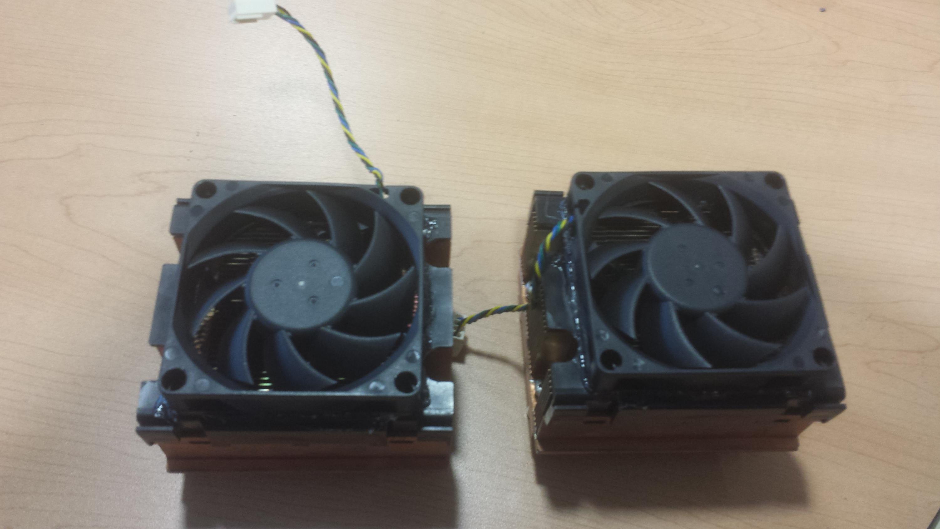

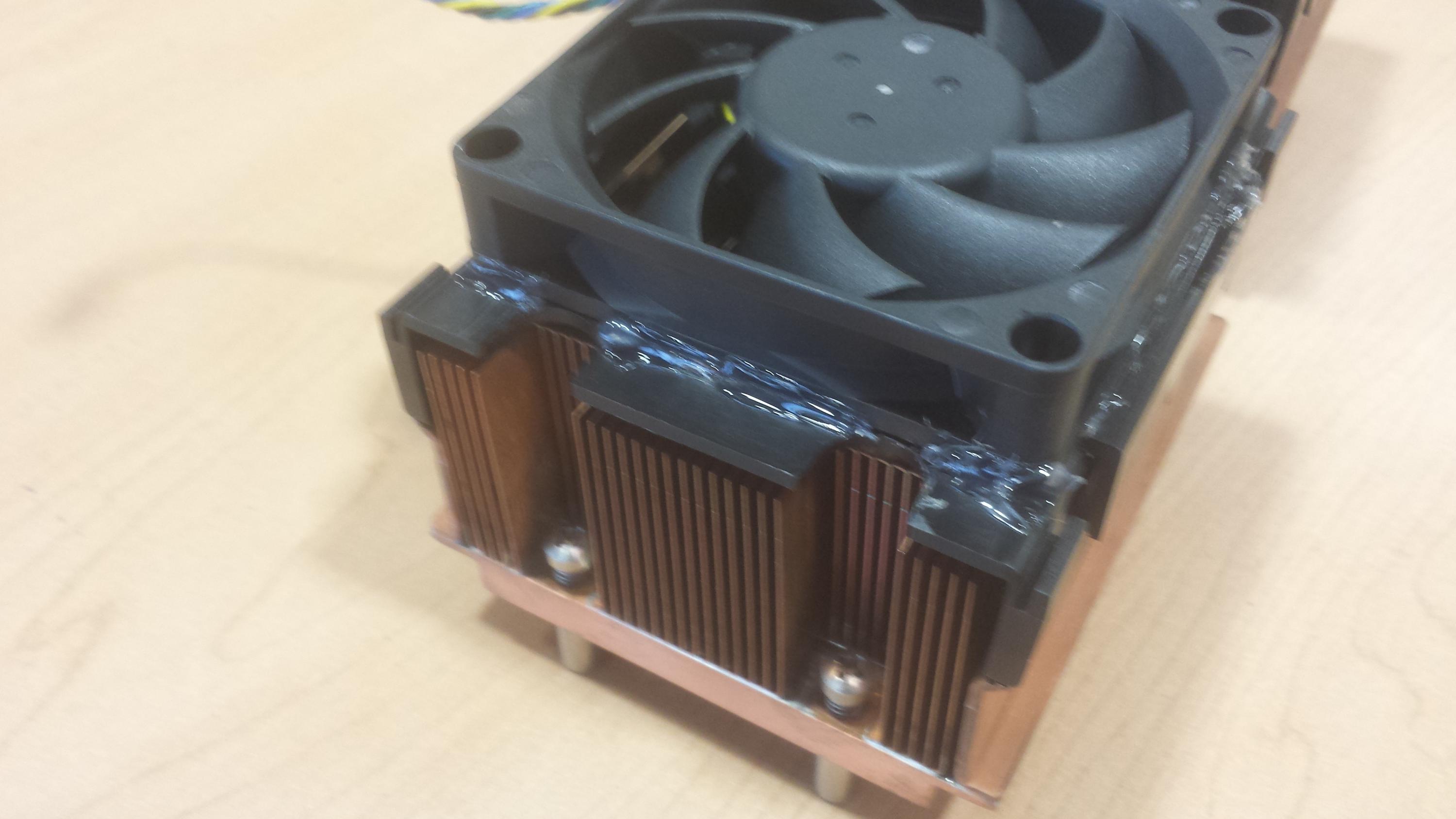

        Coolers came in, the stud length is weird. No good.
        Plan B (to be worked on tonight) is to cut off the ild fans from the intel fan assemblies (already done) and hot glue/bolt the fans from the other coolers onto the brackets, which can be re-clipped to the heatsinks. The stock heatsinks are good (soldered copper) and my beef was the fans. A hack, but hopefully a good successful hack.
        My alternative would be to swap the studs, which I tried but would require countersinking the new heatsinks to a precise depth... I'm a good machinist but honestly that'sa bit more than I'd like to do here. likewise, I would also swap the screws and lathe down the new studs, but again, I'd rather not go there (the only lathe I have access to is a bit big for that, I need a mini-lathe to do what needs done).

          Mod complete, see pictures. I'll install them tonight after work.

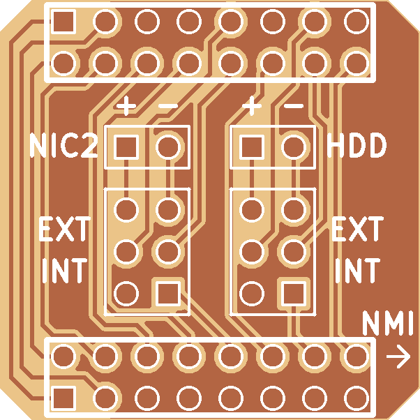

                            whipped up some PCB design files, it's a 1" by 1" board. see attached files.
                            I also added a jumpered breakout for the NIC2 LED, which on this board is unused. I had the space, so why not?
                            AFAIK the only thing SM makes that does this is a breakout header (like my other SM case came with) which is good for non-SM boards (lets you use any pinout) but for this is kinda dorky and lame. sure I could have made one of those with all the mobo ones on a header with hanging leads (like I did with V2.5) but IMHO that would have been a major pain to make up...
                            this, on the other hand I can make since I happen to have PCB router access right now... and single sided material is both cheap and readily avaible (I bet I could make it from some scrap)... and if I have to buy my own, If anybody wants one (obviously no silkscreen or solder mask), I'd be willing to make a few/bunch from the sheet.
                            BOM: (all are 0.1" pitch)
                            1x 90 degree male 8x2 header
                            1x 90 degree female 8x2 header
                            2x 2x3 male header
                            2x 1x2 male header
                            4x jumper
                            8x2 placement:
                            The female header side goes on bottom, the male to the top. The current orientation (for most/all SM boards) places the connections towards the front of the case for cleaner wire routing (in my case through the midplane and back)...
                            I kinda wanted to do it the other way around (back facing) but once I realized my error to me it wasn't worth the effort to redo it (if it bugs me, I could always mirror the copper/drill layers since I'm not doing silkscreen). But as I stated, it isn't a complete fail and from an "out of the way" cable point of view it's a a win... at the very least it's less likely to get in the way of RAM and the like.
                            Thoughts? Comments? Am I as crazy as I feel ?

                              Talked with a professor, they say the board is perfect for doing a tesslation test on the PCB router (which has been restored and is being tested). That means I get as many of these as they can fit on a US letter sized piece of single sided PCB as a "payment" for going through the trouble.
                              I did make a minor tweak to the design, cutting the corners (to make it a little more "interesting" than a square, and ensure decent clearance.
                              What to do with all of these? I've already asked one person who I know may want one... but if you have an SM board in an SM case with a RAID card, let me know and I'll mail you a board (if the deal works out, which they want sooner rather than later).
                              Edit- They're going to try it tomorrow. Here goes nothing... I better order parts.

                                  Updated files attached (if anybody want's the KICAD/gerber files, let me know and I'll post 'em)
                                  Here's a simation of what it will look like:
                                  Only w/o silkscreen and the copper on the back of the board (mirror image).
                                  Ordered the connectors, I was going to build up three of these but due to finances at this time (between paychecks, grr) I only ordered parts for one.
                                  I will also note that in this configuration, shrouded keyed connectors DO work for the ribbon cable connection... had I gone with the original layout, the key would have been on the board side with AFAIK nobody makes a 90 degree connector for (although a straight could have been used in such case; the cable will flex obviously).
                                  Cool hack or lame gimmick?

                                    made 4 of the boards tonight; 3 turned out and one of the three is on loan as a sample.
                                    Until the machine is more figured out, I'm not making any more... but to the one who was promised a few, you will get one of the three.
                                    (PSST: T-tech PCB routing machines SUCK. thier software is a $1000+ POS as we've found. Finicky as hell).
                                    Once parts come in and I have soldering access I'll build one up (monday or tuesday most likely)

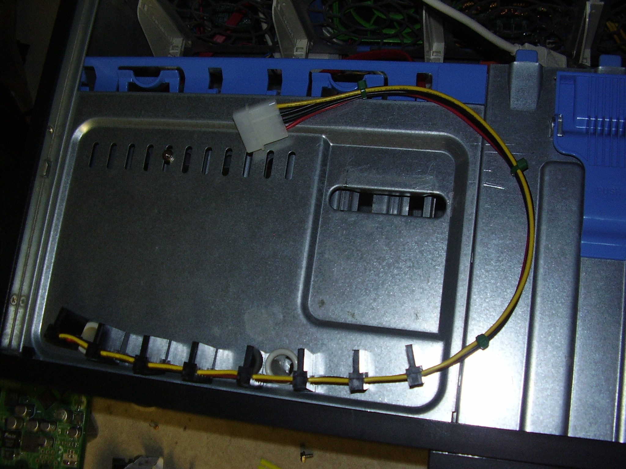

                                      I made up the 8 port SATA to molex adapter:

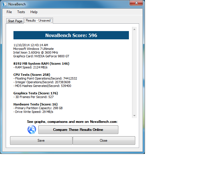

                                      V3.5's novabench from awhile back:
                                      Here's what this rig is getting:
                                      Clearly two SLI'd 8600's isn't cutting it in the other rig... I'll have to see what I can get over xmas to beef it back up, but that' for that rig's thread.
