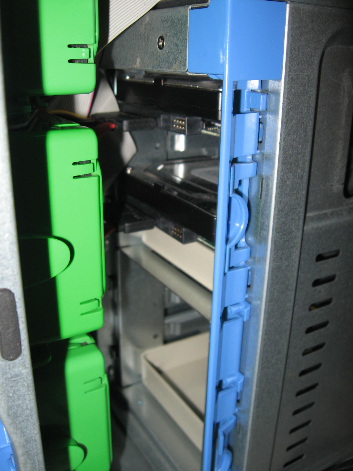

    -I have no idea on getting the PCIe to unlatch.. same for removing the drives/caddies.

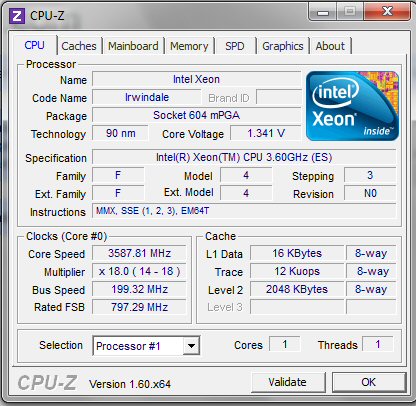

                                      Here's the CPU-ID screenshot of these CPU's... I put some different (less but 1-rank) memory in this old tub of a Dell, and it hasn't been bitching memory codes at me....this board/chipset really hates 2-rank DIMM's.

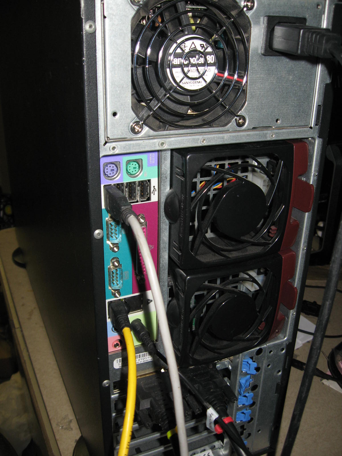

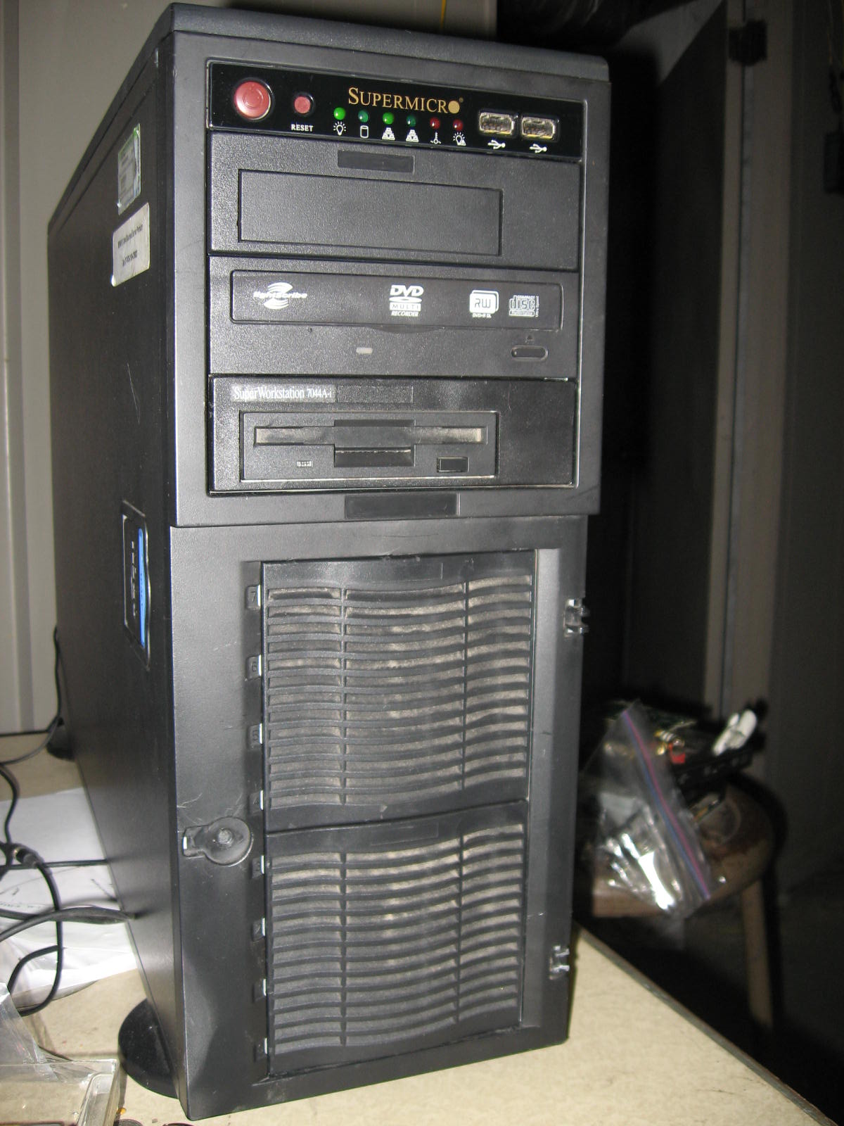

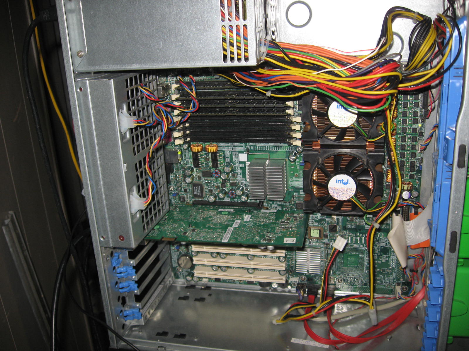

                                          Picture time... (bless my mess, I've barely had time to clear a spot for the beast + 2 LCD's)
                                          An overview in my current setup:
                                          The upper bay is empty but I plan to add a card reader there. More on that later. The middle is the DVD Burner out of V2.5, which was swapped for a similar but uglier HP burner I had (I've scored a few lightscribe PATA burners lately). The lower is an all-handy floppy drive... because why not... and for some reason it booted slow/inconsistently with two PATA optical drives.
                                          The COA:
                                          I blurred the codes, but that's what I have codes for. Not that I'll use any of them, but if somebody else cares, let me know.
                                          Inside the case:
                                          I swapped GPUs as it was easier to toss in a crap Quadro FX 1400 than it was to swap cables on one of my LCDs. I do have different (HP pulled foxconn) coolers on the way (I managed to break one of the fans, so that sealed it long term). I also have some Irwindale CPUs on the way, but I won't elaborate on them until I have them.
                                          Yeah, it has some broken card clips... Anybody know if I can order replacements?
                                          And yes, I know the wiring needs cleaned up... once the parts are more finalized I'll get zip tying.
                                          The two 160GB HDDs:
                                          Right now I have 7 on one and nothing on the other since intel/MS didn't make a win7 driver for the ICH5r's raid function... While I'd love to run a massive 10K array with a 3ware card, it's not economically feasible. Suggestions for a better (and somewhat low cost) setup? I do have space for 8 drives.

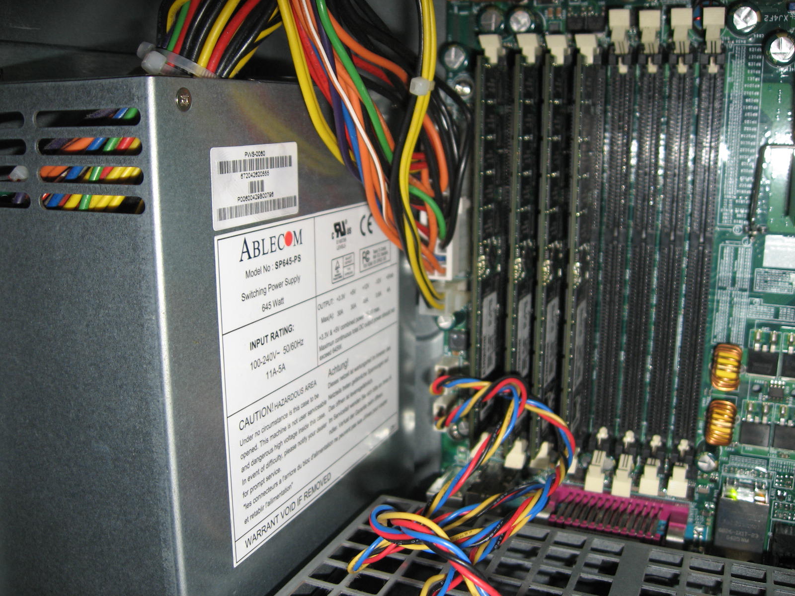

                                          PSU info:
                                          I looked inside the PSU last week, it's beefy. What's unfortunates is the lack of plugs, as I only have 3 non-motherboard strands. One is the only one long enough for the DVD drive (2 molex), one is for the FDD and HDDs (2 molex and a Berg, with a 2 port SATA adapter), and the last is hanging for a PCI-e adapter. I know one is suppossed to use two strands for said adapter, but what am I supposed to do here?
                                          The back:
                                          Card reader wise, I'll probably go with another AFT 3.5" of some sort (tried and trued), since every 5.25" reader I've seen is either USB 3.0, has fan controllers or the like (BS I don't need), or is a cheesy POS. That being said, I'm all ears for suggestions.
                                          Otherwise, suggestions on the PSU situation, the HDD situation, and/or GPU upgrades is appreciated.
