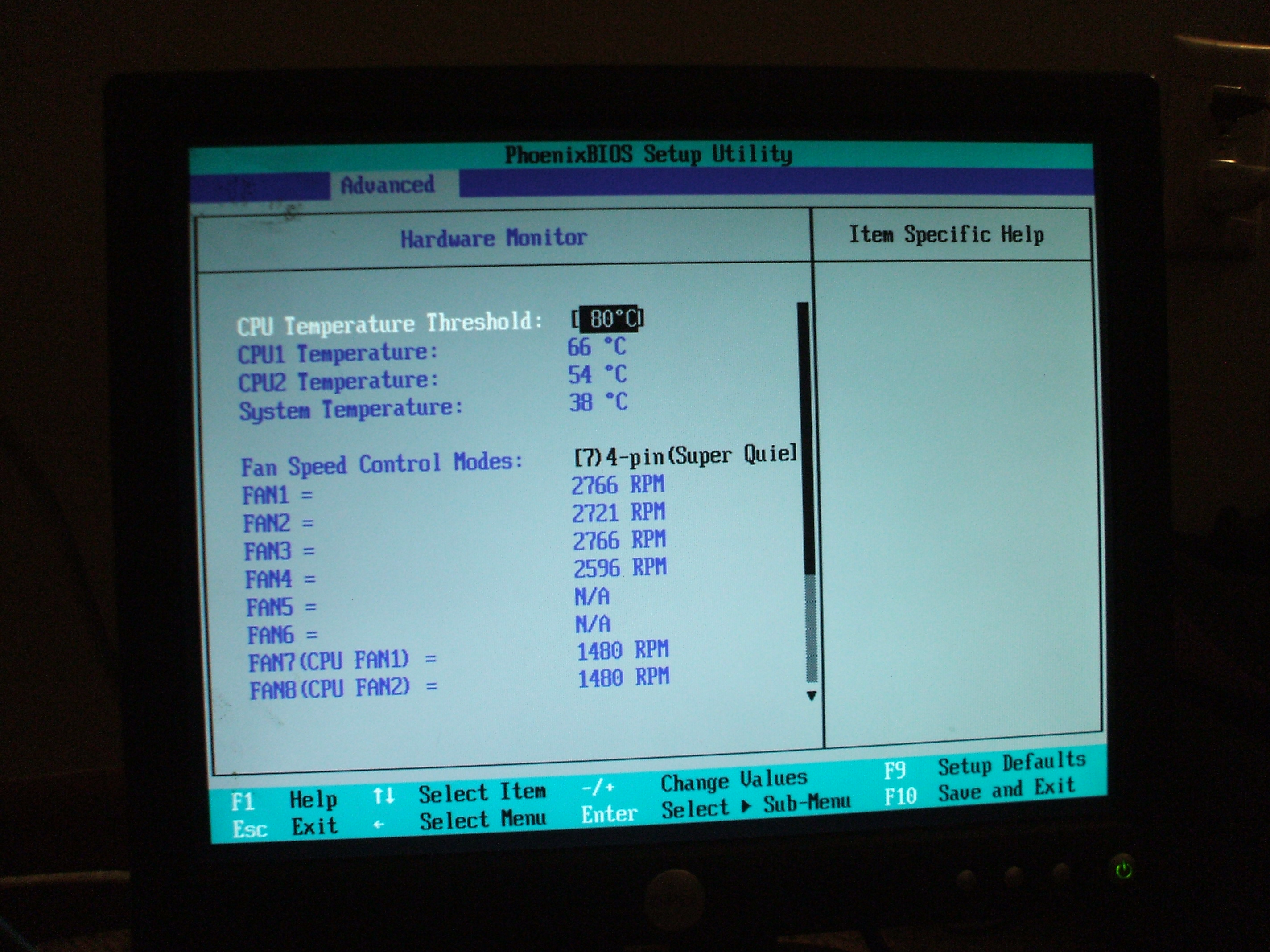

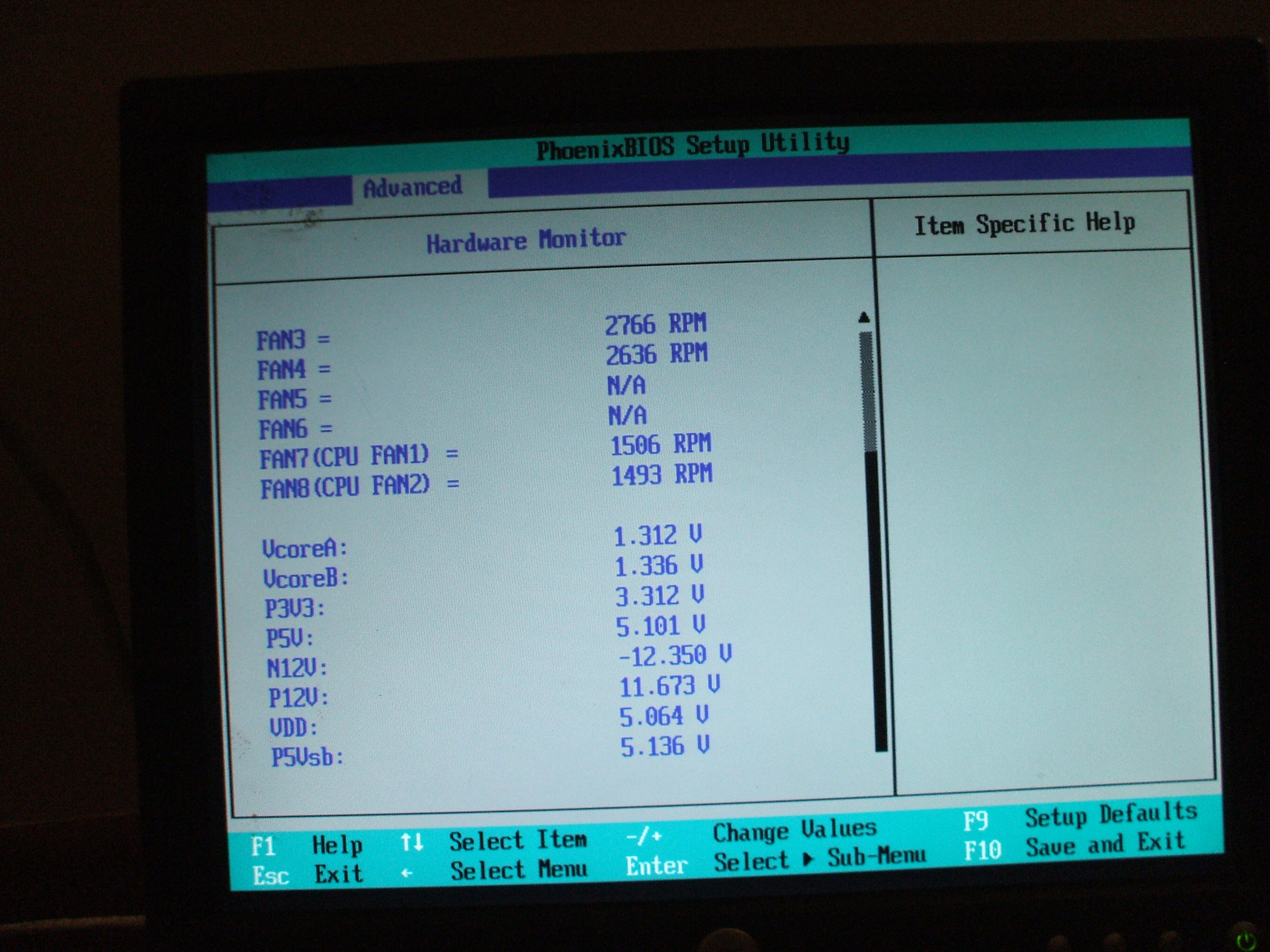

                                Whatever caused the blue screen also nuked my fresh install, as it instantly BSODs on bootup. Before it crashed during testing Windows activation would crash. Something isn't happy, that's for sure.
                                Here's what I got from the BIOS hardware monitor after trying and failing with the various startup repair utilities built into 7:
                                (clearly startup repair only used the first CPU)
                                Vcore looks good? I didn't see much in the way of fluctuations, and all the caps are good on the mobo (It's a freaking supermicro after all). FWIW the nominal Vcore for Irwindales is 1.25–1.3875 V.
