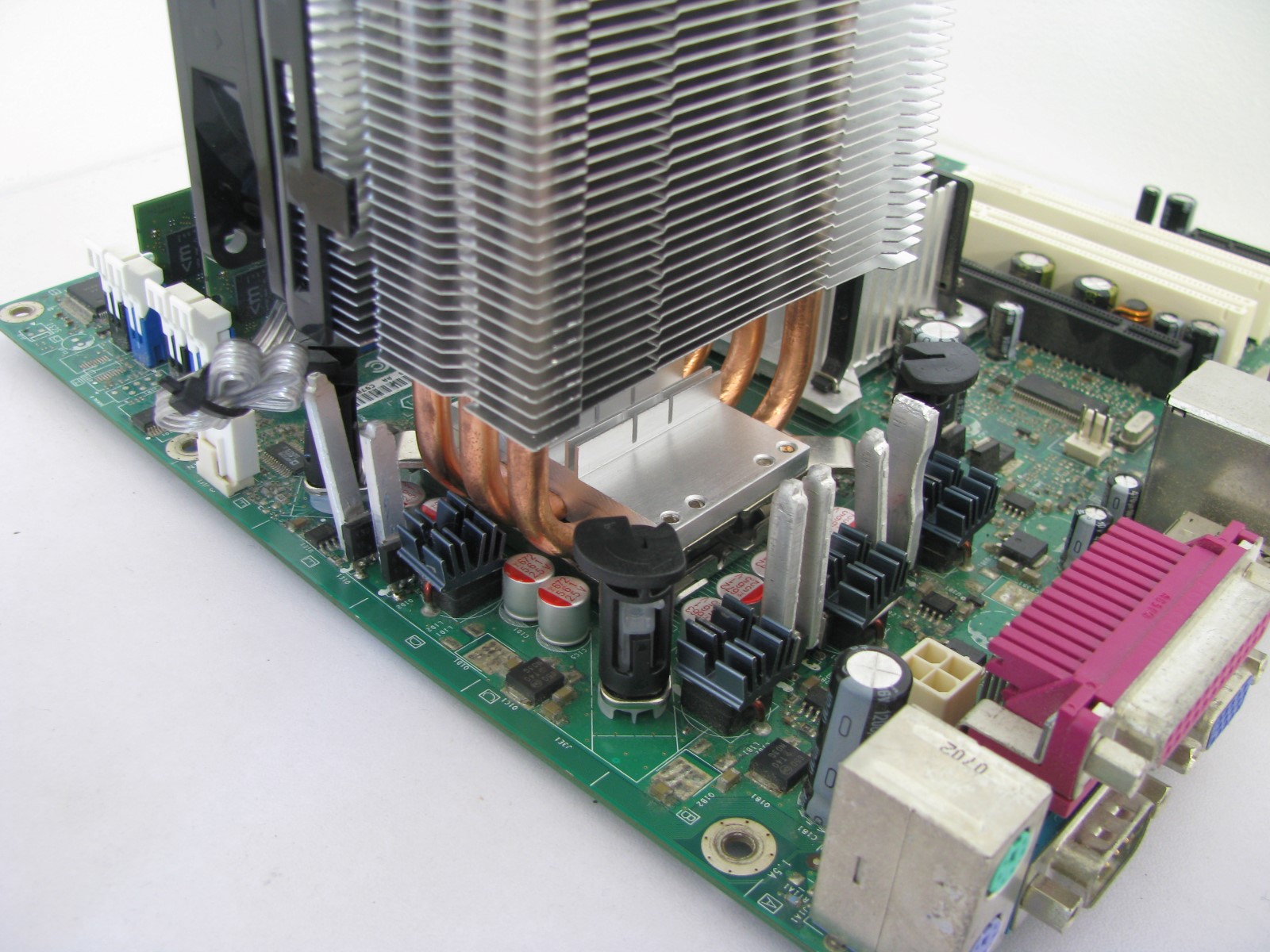

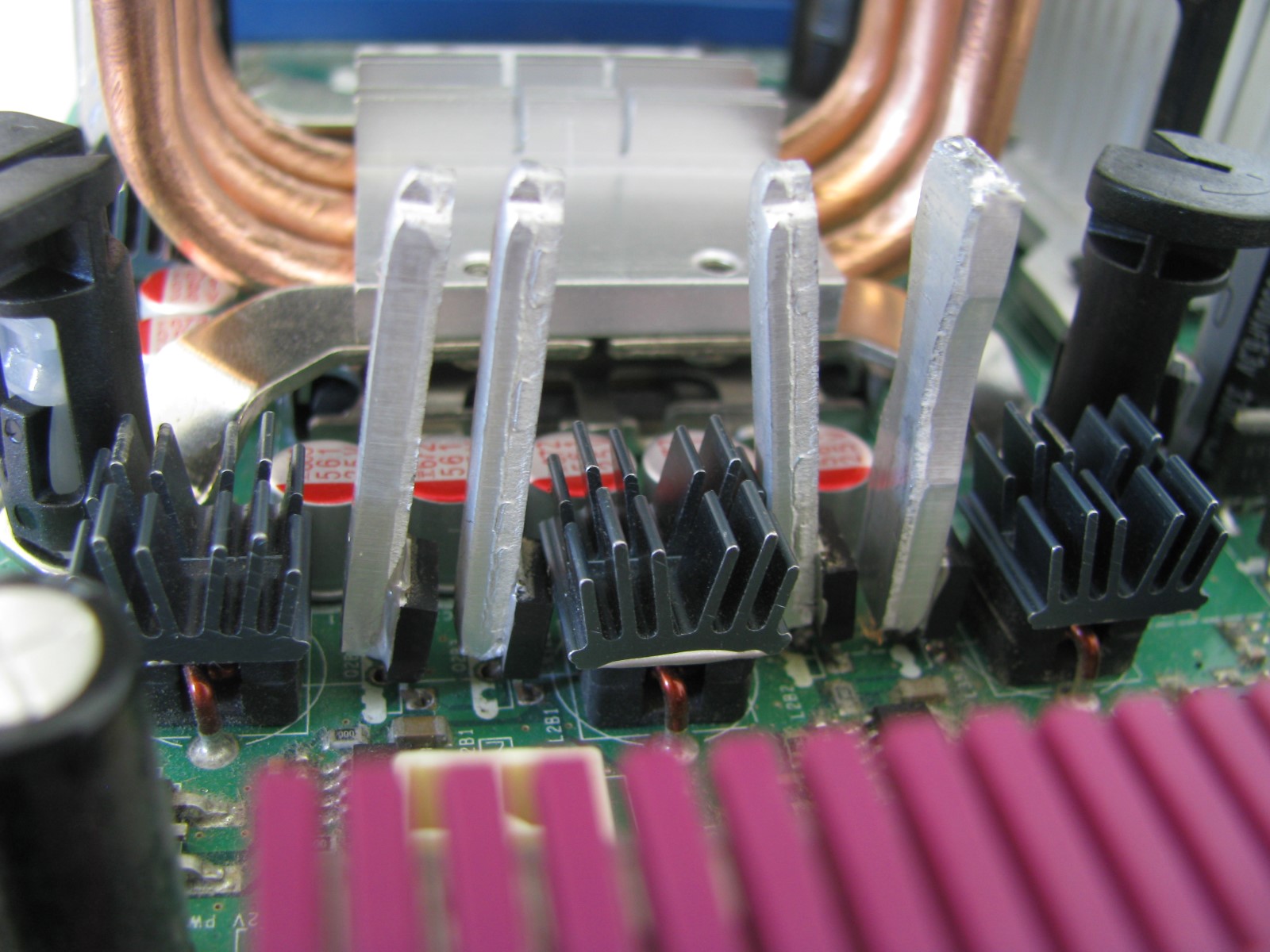

    While I have generally had pretty decent luck with C2D and newer Intel boards, some of the P4 era boards, like my D945GTP, had problems with hot-running VRMs - especially when using 125W Pentium D CPUs, like the one in this board. Standing the FETs up certanly doesn't help with this, but - it does make it kind of easy to fix.
    I found an old PSU heatsink in my stash and broke off some of the fingers. I then used some thermal epoxy to stick them to the FETs. I then used some RAM heatsinks (which came with a GPU cooler, but didn't get used) on the coils - which also get quite toasty on this board. The next step is to do something about the 12V side FETs. Those are soldered to the board, but also get hot. There are blank spaces next to them all (which are in parallel). I'm thinking that, If I can find some identical ones, I might solder a few more in parallel (and maybe stick some RAM heatsinks to them as well)

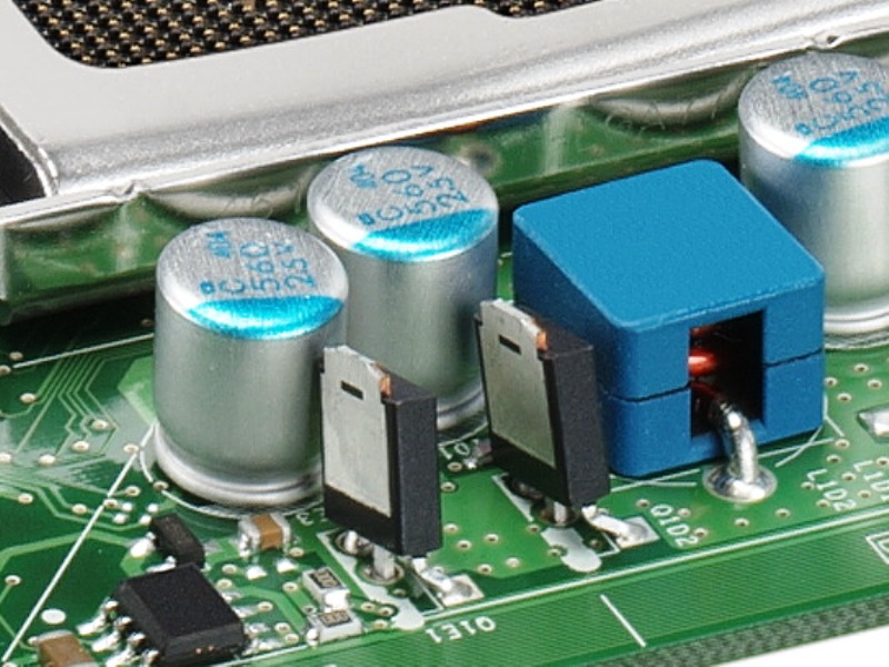

                That does all contribute, but the root cause of the problem lies with the VRM itself IMO. Most other motherboards have no problems with the VRM cooking itself - regardless of the CPU used, the cooler or the fan settings.
                • Majestyk
                  • Nov 2013
                  • 96
                  Re: Intel D945GTP VRM Cooling mod
                  Originally posted by c_hegge
                  ...the root cause of the problem lies with the VRM itself IMO. Most other motherboards have no problems with the VRM cooking itself - regardless of the CPU used, the cooler or the fan settings.
                  Everyone else has their MOSFETs soldered flat to the PCB and allows efficient cooling by the copper-layers.
                  When unsoldering the MOSFETs or even capacitors from larger copper-layers we get an idea about how efficient this cooling can be.
                  Intel has chosen a different - inferior - way here and solderd the MOSFETs upright without any cooling except for the airflow.
                  I would consider this a thermal-design fault.

                      Awesome mod, c_hegge. These boards seem to last a long time with high TDP CPU's as it is. So even without adding additional FETs, those heatsinks should make a significant difference.
                      • c_hegge
                        • Sep 2009
                        • 5219
                        The blank spaces I was referring to are on the VRM high side (see the picture). It was the low side that got the heatsinks.
                        I ended up scavenging some FETs from another dead board and replacing them, as well as adding the extra ones. I forget which parts I used but they have a slightly lower RDS-on than the originals, and they seem to run cooler.
                        • c_hegge
                          • Sep 2009
                          • 5219
                          And as a final mod, that lone 1200uF Nichicon HD on the VRM high side got replaced by three 470uF 16V OSCON SEPC polies. Pics coming soon...
